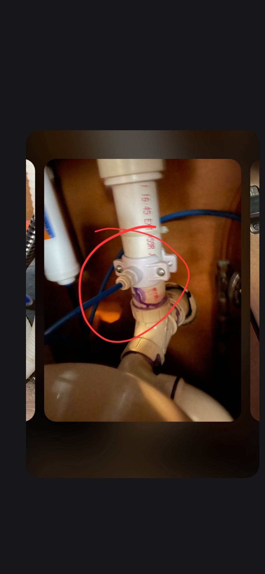

    "You're the only plumber that ever pointed this out...its been this way for 40 years!!!" Ha Ha....It ain't easy when you're the only pointing serious hazards out, but never be bullied in to keeping more mouth shut. Mad Dog

    @Mad Dog_2 what is that?

    Backwash from a water filter going into a drain with no air gap?

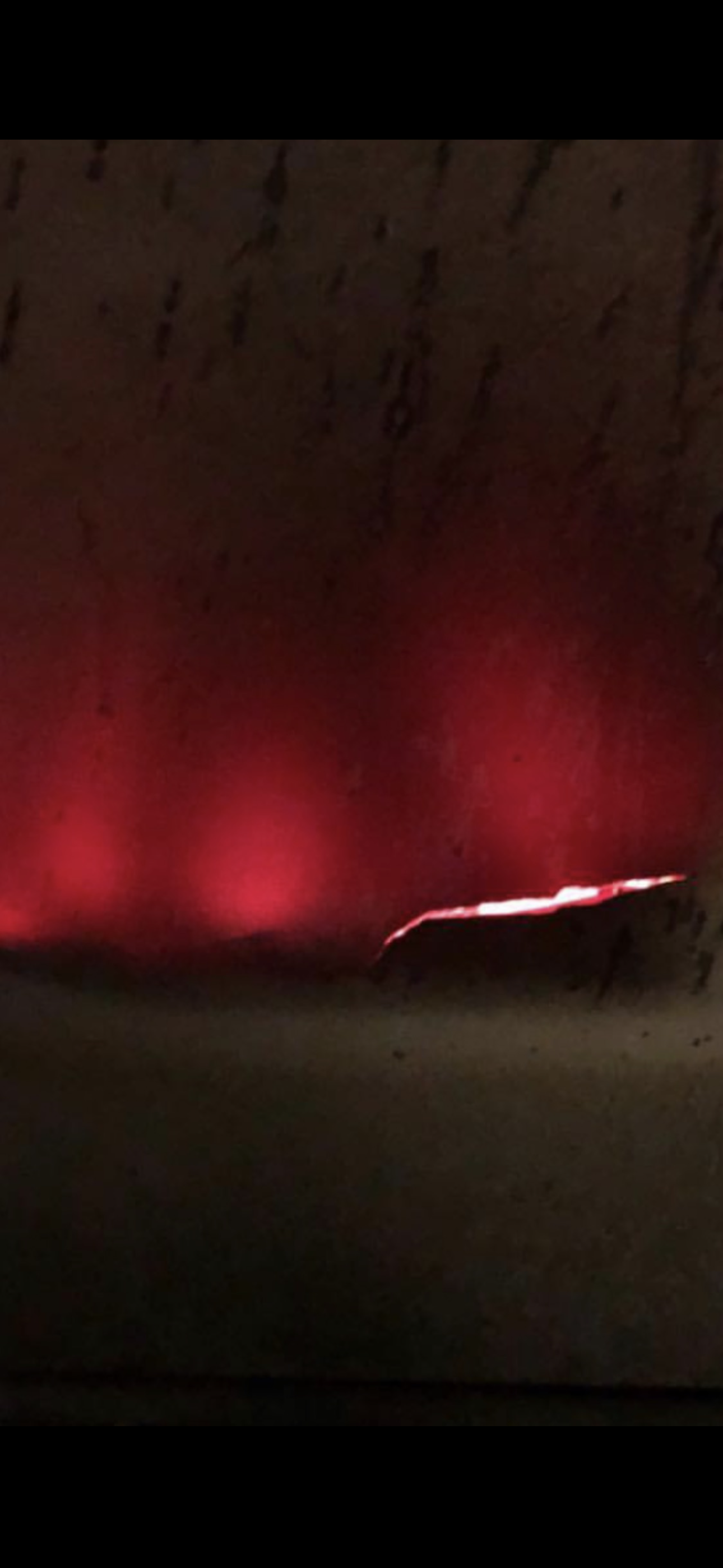

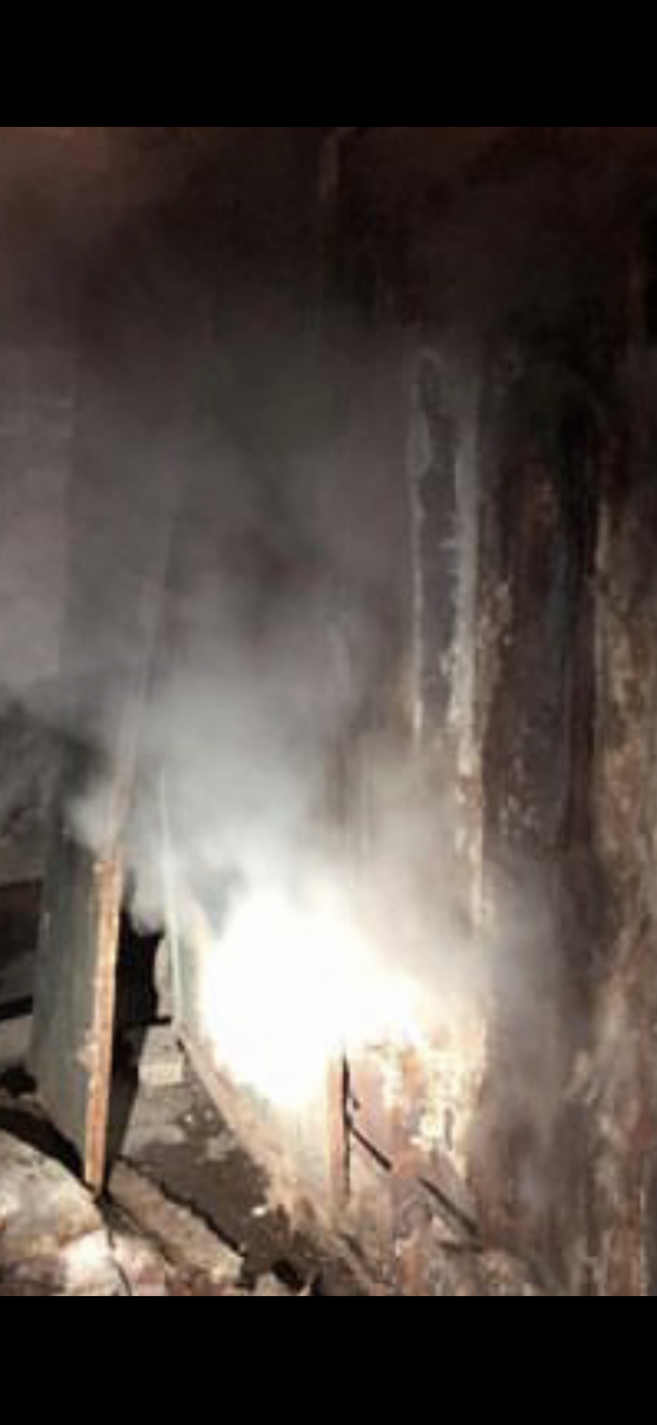

    Well said, Ray. It’s a shame it even has to be said. I shut this steam boiler down, met the owner in the back of this apartment building, told him what I did, and he said, “no we’re not doing that”, and he went back in and fired it back up. Warned and documented. In hindsight, I should’ve called the fire department

    @Steve Minnich wow that's scary Thanks for that

    Was that a Repco boiler? I had one in my first house that was like that.
