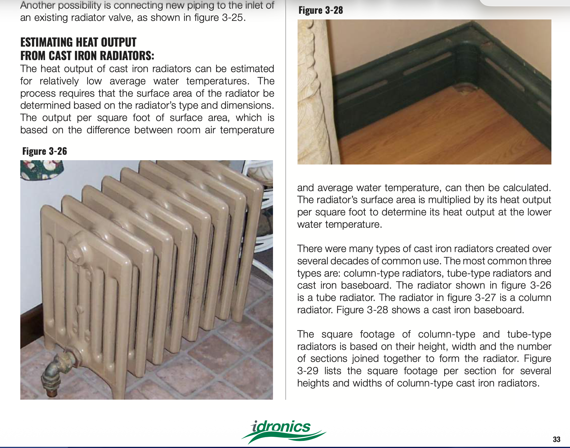

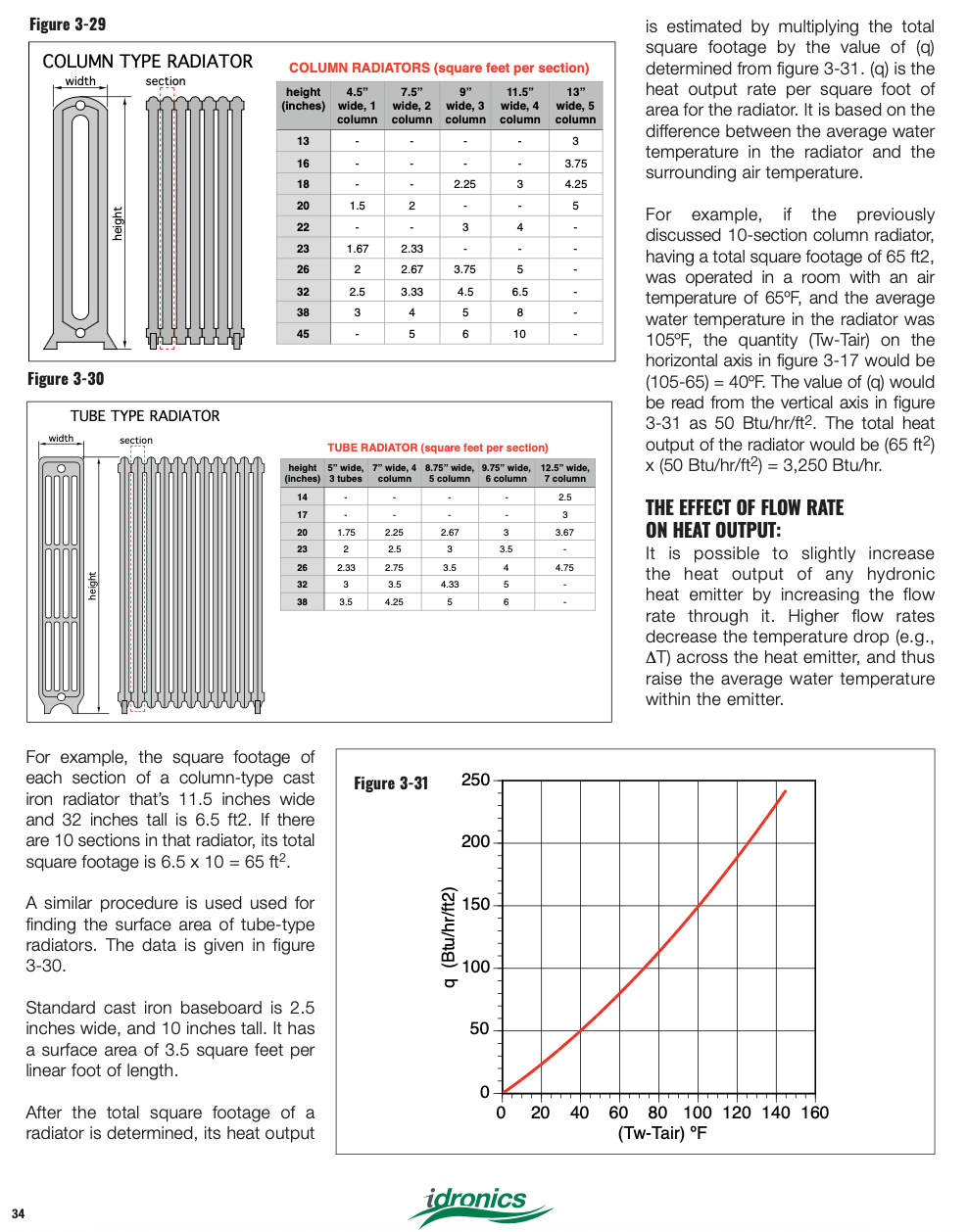

    Running a 75° ∆ through the radiator loop? The radiator needs to be warmer than the ambient to give off heat.
    Here is a generic derate sheet for CI radiators. The example shows a 32" tall, 10 section radiator at 105° in a room with 65° ambient air condition.
    Screenshot 2026-07-16 at 7.18.25 PM.png Screenshot 2026-07-16 at 7.19.07 PM.png
