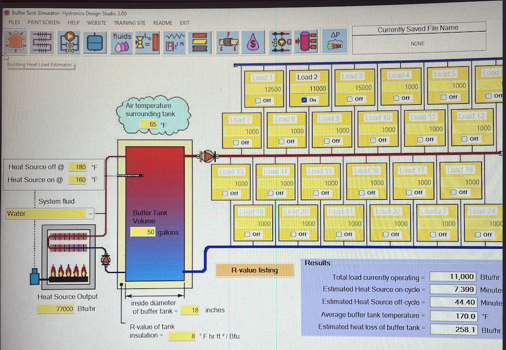

Never used a buffer tank before. So this is a little bit of an experiment/ looking for advice. 3 zone home ~12500, -11000, ~15000, so roughly 38,500BTU design load. I want to install a 50gal indirect. Boiler will be Trio P4 106,000 BTU Net.
Can I use a 3 pipe buffer tank configuration for this set up, or am I looking for trouble?
I’ll control buffer tank temp and indirect off the hydrostat 3250 plus with outdoor rest for WWSD.
3 sentry zone valves and an taco 0015 low pump.
Im not worried about head and flow rates, I can figure that out later. What I’m worried about is the short cycling the boiler will be going through because of how over sized it is compared to the heat load, but I need the domestic HW above 2 gpm.
Or am I over thinking this, and a VT2218 on delta T mode alleviate the short cycling issue for the heat demands?
help, criticisms, and insults are appreciated.

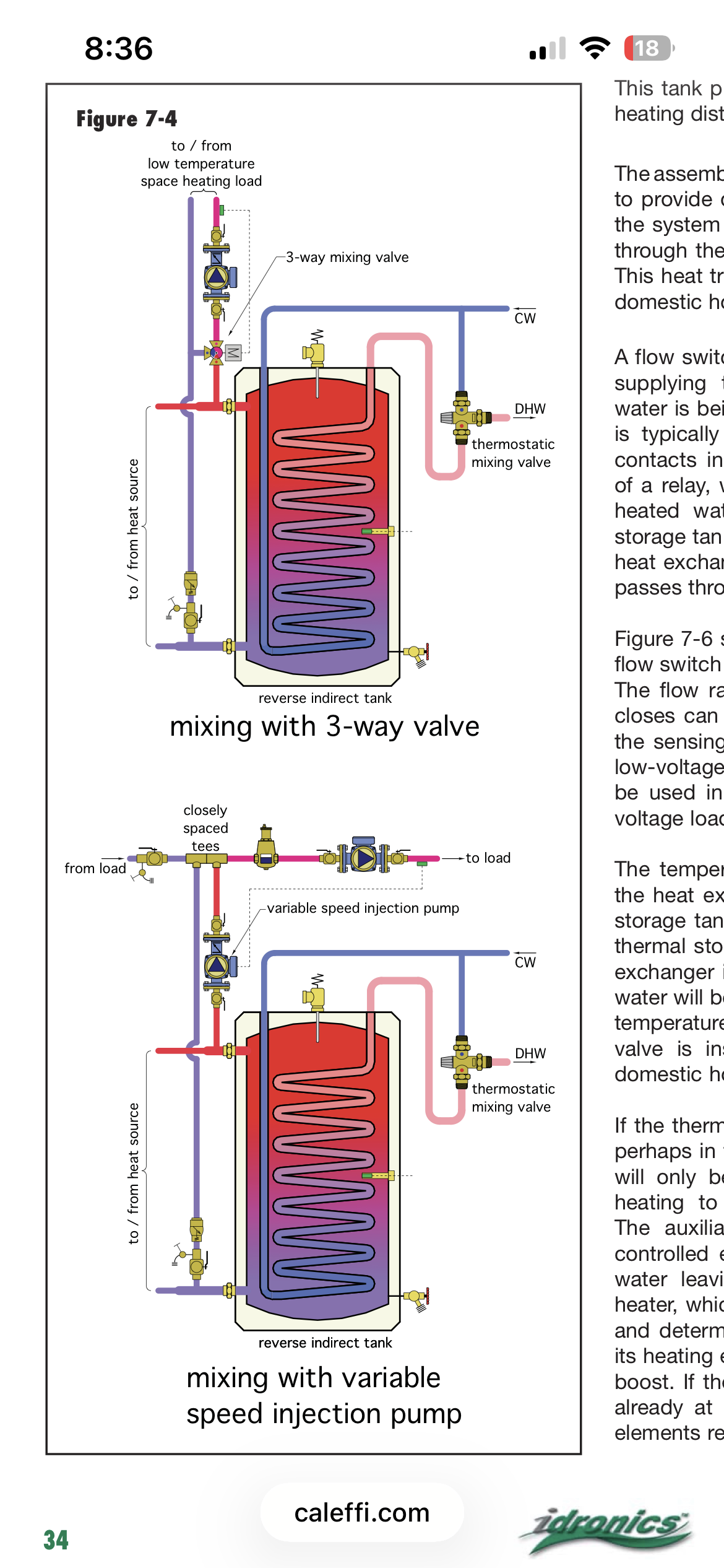

    This is a two pipe buffer, reverse indirect.

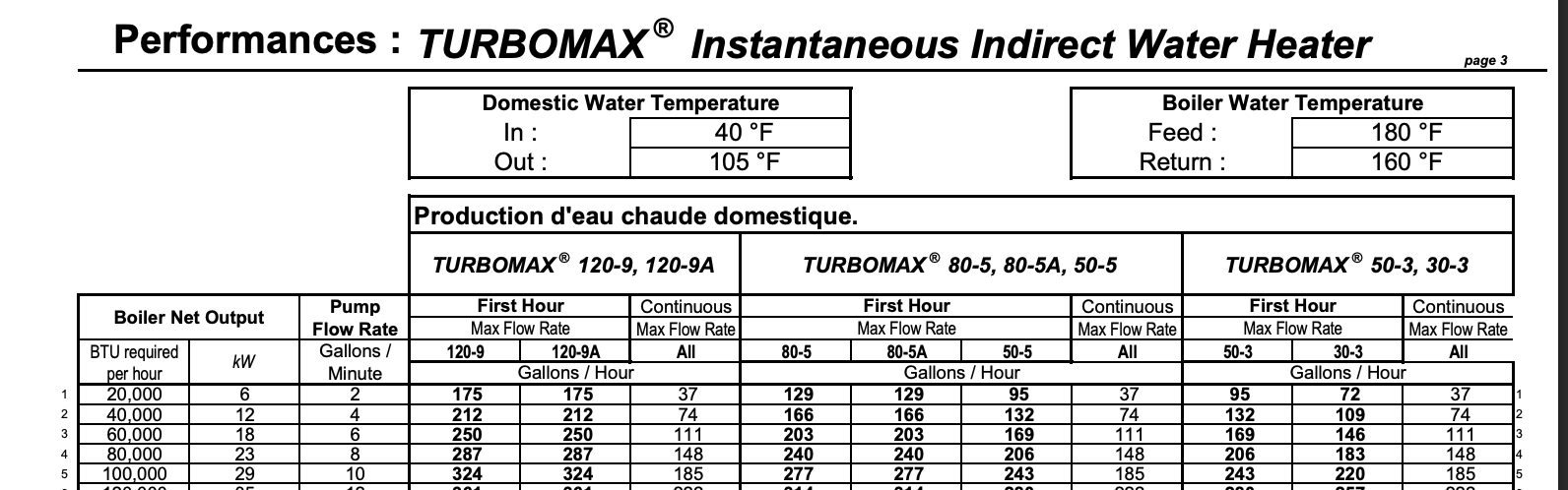

    500x flow x delta
    500x 2 x 77=77,000 btu to provide 2 gpm
    So you might want a 100k if you use reverse indirect

    Here is what a 11,000 load looks like.
    Rule of thumb you want a minimum 10 minute run time every time a boiler like that fires.
    So a 50 gallon buffer gets you close at 7 minutes. 44 minute off cycle is great.
    With ODR if you pulled down to 145F you get a 13 minute run.

    this is a reverse indirect. the tank is filled with boiler water and the dhw flows through a coil and is heated by the boiler water. it is sort of a combo of an indirect and a buffer tank so the boiler water serves as the mass to store the energy to cover the dhw load instead of storing dhw water directly:
    the odr maybe doesn't make so much sense with fin tube and a ci boiler. you could make the heating more even with odr but the boiler would still have to cycle to provide it and fin tube needs a rather high minimum on the odr curve to have any appreciable output.
  • I had no clue tanks like that existed. I just looked the reverse indirect tanks up. Again, first time doing something like this.

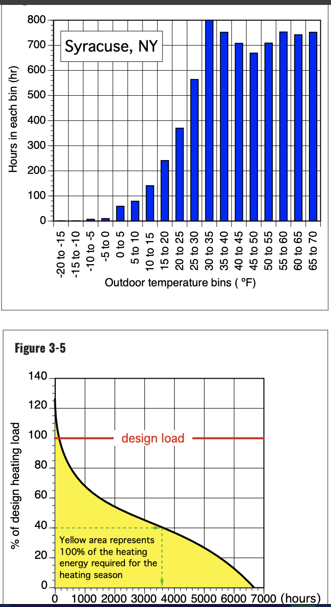

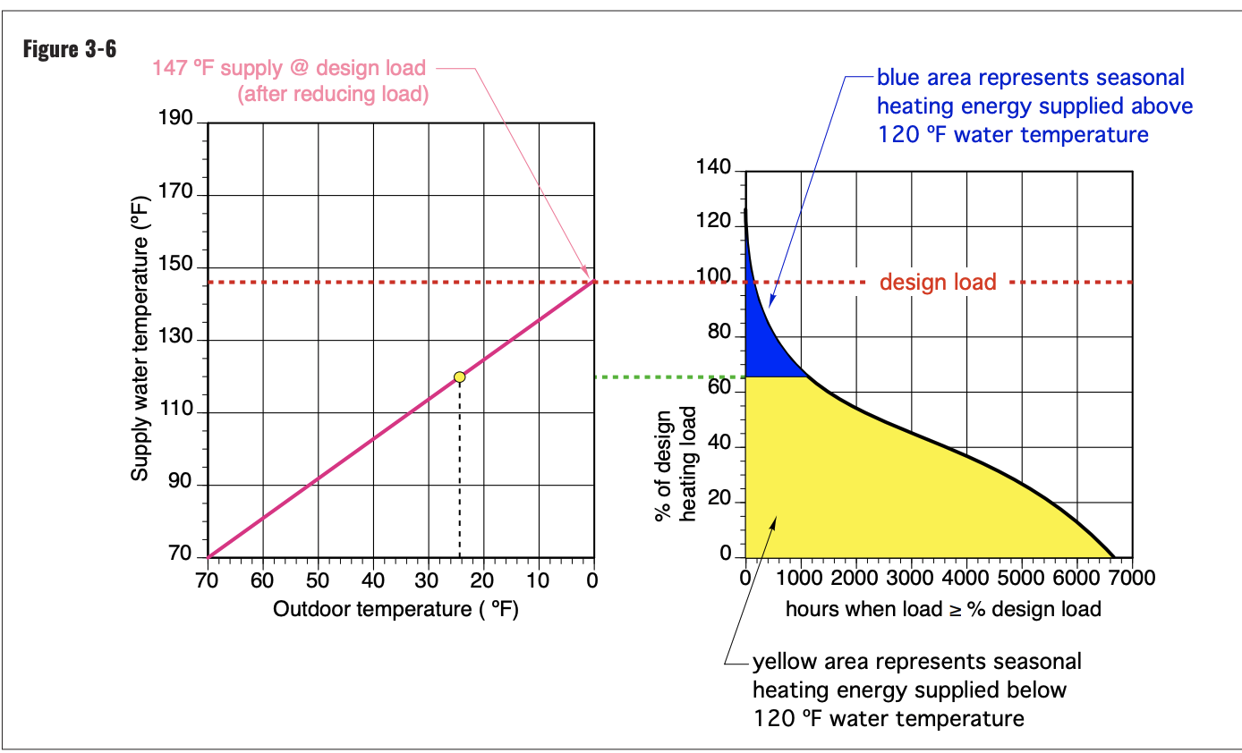

    If you want to do more number crunching, determine how much fin tube in each zone. Compare it to design load. Then determine how often and how low you could run the fin tube on less than design days.
    Probably 80% of the heating season you are below design. That data is available also.
    The tank will run 160- 180, so the boiler is protected from cold return. The key is to pull off the buffer via ODR, also have enough boiler capacity for DHW.
    With a control logic, you could drop heating load with DHW call. So a 177K boiler coiuld supply 2.5 gpm or so. Check with the TurboMax output chart to confirm DHW output at various boiler input and incoming water temperatures.
    An example of BIN temperature data
    Screenshot 2026-07-15 at 9.31.49 PM.png Screenshot 2026-07-15 at 9.32.12 PM.png
    I think SlantFin output charts went down to 120 SWT.
    This Idronics has some ideas and formulas for lowering SWT.
    https://www.caleffi.com/en-us/magazine/25-lowering-water-temperature-existing-hydronic-systems

    the reverse indirect is well insulated, it is more or less the same as maintaining the indirect temp. the temp is higher than an indirect so there is somewhat more loss but it isn't a huge difference. you could also probably lower the temp in summer if the municipal swt is warmer.
    control logic is just referring to the control logic, could be tekmar or others.
    to do odr you would need either to do injection mixing with a variable speed circulator or a modulating 3 way valve, there are pros and cons to each, either will work. others know much more about this than i do.
    on the dhw supply you want a fixed thermostatic mixing valve to bring the dhw temp in the coil or tank to safe temps and to keep the temp consistent as the tank temp varies.

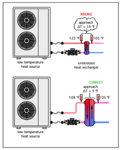

    I have dome a few of these FPHX off a buffer tank. At my own shop I could generate 110F DHW with 120 SWT on the hydronic size.
    Using a close approach sizing method you can get A & B sides of a FPHX within 3° of one another. This method gets used with A2WHP also

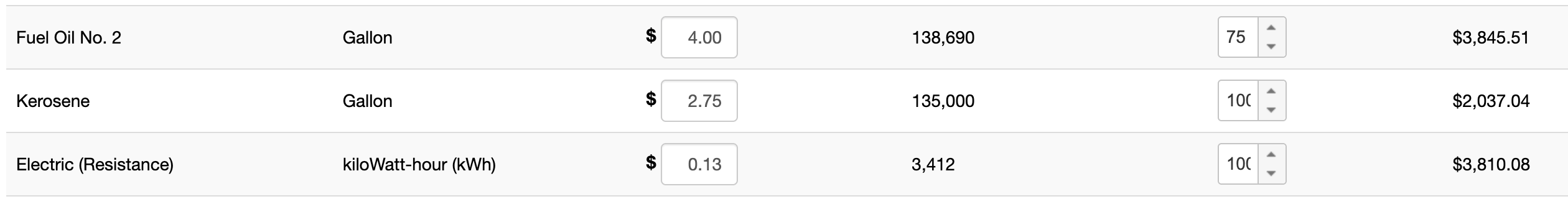

    Fuel oil at 4 bucks a gallon, electricity (resistance element) needs to be around .13, delivered cost, to compare.
    A HPWH changes that if you can run 2, 3 4 COP or better.

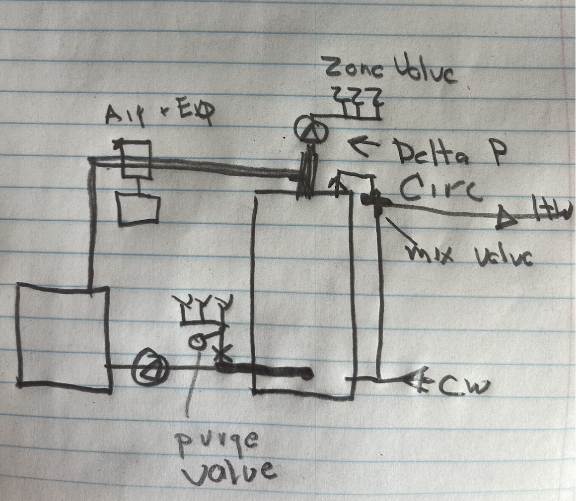

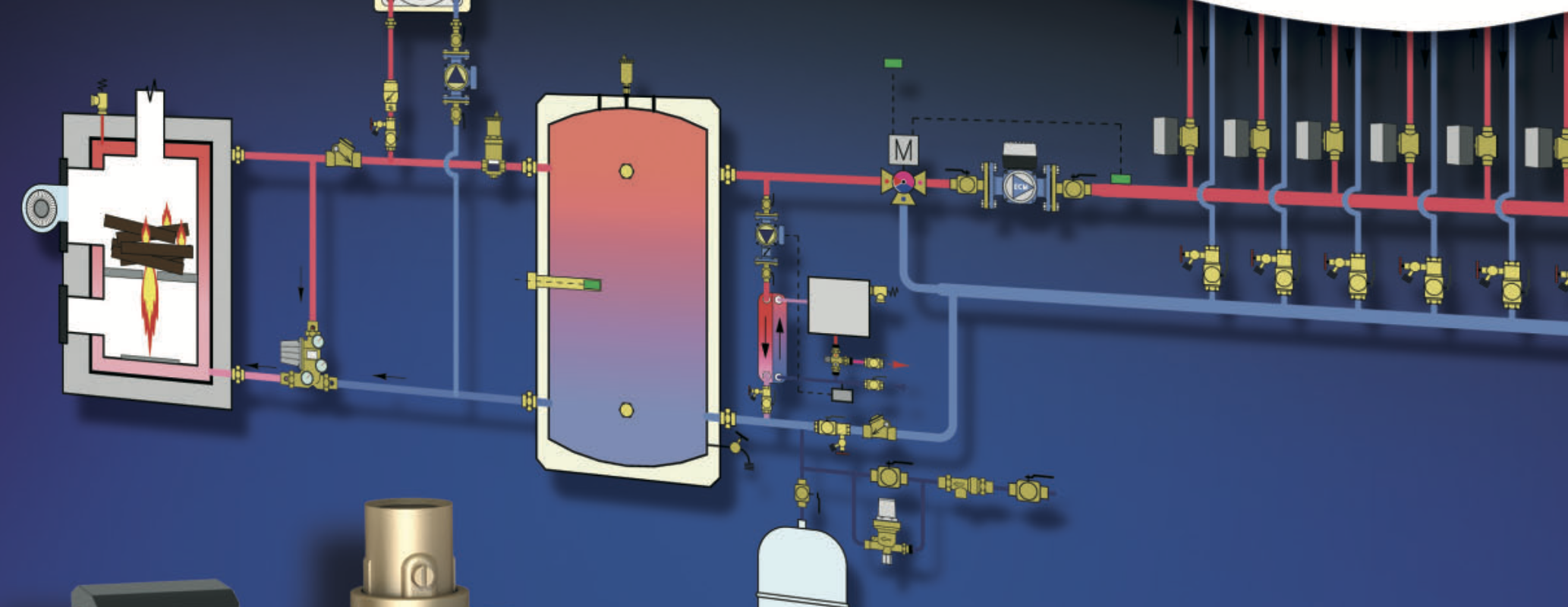

    It can be this simple. Boiler pipes to top of TurboMax, supply circ and zones connects there also. Zone valves on supply to prevent ghost flow.
    Large piping, 1-1/4" at the tank where the boiler and zone piping connects. That serves as the hydraulic separation function between boiler and zone circs.
    Air sep and exp tank in that pipes somewhere. TurboMax comes with high point float vent also.
    A delta P circ modulates with ZV opening and closing, Grundfos Alpha 15-58 for example.
    Isolatiopn under system pump, ZV are top isolation.
    Isolation valves at boiler pump.
    Purge valve, like a Webstone at the return from the zones
    Thermostatic mix valve at dhw connection from tank.
    You will just need to use trial and error as far as tank operating temperature, if you don't have dhw requirement numbers. Basically start at 180, crank it down until dhw doesn't provide what you need. Lets say it can run as low as 150- 170. Now you have the points to set the boiler ODR. The "blue" 1.8 curve may be a good start:. You tune the curve to what works for you and the family, there is no "right" number.
    The perfect system would have the zones open on first heat call and never shut down. The boiler water modulates to the load condition, pump always runs for constant circulation. ODR can get you close to this condition if you play with settings for a heating season.

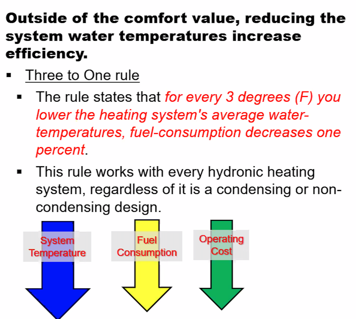

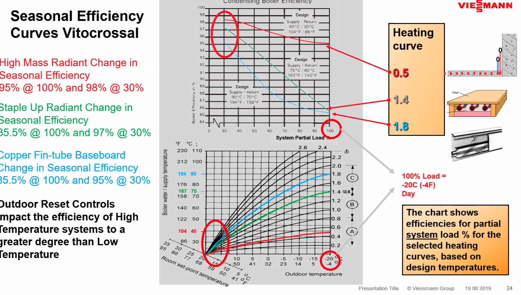

    The bottom graph shows fin tube at 194°F on design day. That may be too high. Unless they skimped on fin tube 180 or lower should get er done.
    The goal is to lower the operating system as low as possible and cover DHW and heat loads. Basically the 3-1 rule, see below.
