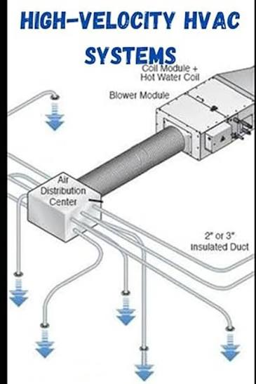

    HVACNUT Posts: 7,784
    @Sweet_Lew , is a few years, three? Does it get a yearly maintenance? Is the air filter clean? There should be an 18-22 temperature split between the supply and return taken at the air handler. If the system doesn't keep up when temps are higher than a Chicago design day, that's normal. If the system can't maintain on a design day or cooler, then it needs to be checked.
    an ir camera on the ceiling could give you a good idea about if the supply is dumping a lot of cold air in the attic too. I suspect it would be really easy for something to go awry at one of those escutcheons and send the air back in to the attic instead of out in to the room.
    Sweet_Lew
    Space Pak ductwork and braches are pretty hard to screw up. Its based on high velocity, so the design prevents air leaks.

    PC7060 Posts: 1,980
    edited July 16
    Hi velocity systems are straightforward if you've done your homework to determine room by room CFM/Cooling requirements based on a Manual-J and follow the rules for max/min tube length and takeoff placement on the main plenum.
    The systems require the installer to read and follow the the layout instructions and verify static pressure versus the data sheet. Should be simple as piping a boiler but we've seen plenty of those installed with no regard to the manufacturer drawings.
    Some installers think its a matter of running tube where ever you want. Hint, this is not the way to do it.
