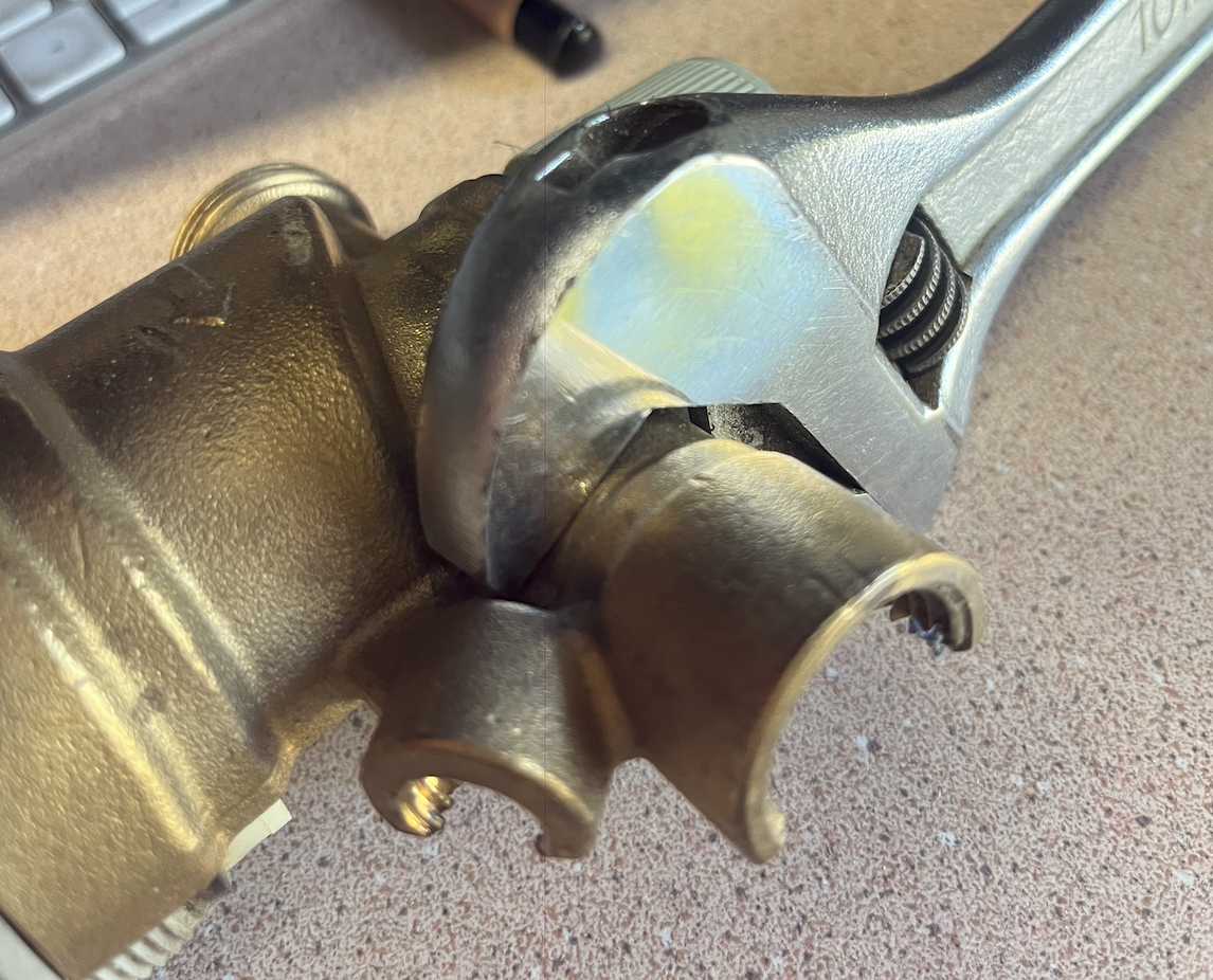

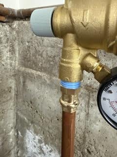

I love Caleffi products and these pressure reducing valves are great, but would like to see some wrench flats to help with installation.
STEAM DOCTORIntplm.
    hot_rod Posts: 28,699
    good point!
    A 10" cresent grabs well in below the gauge port.

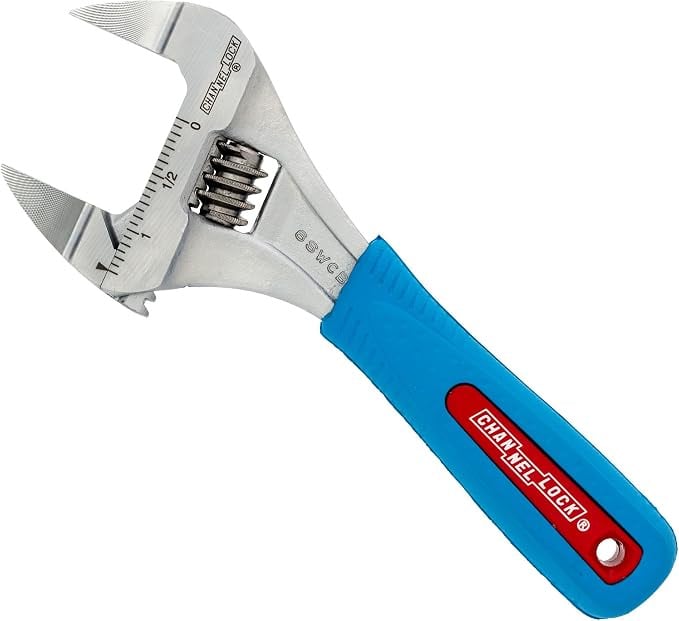

    This is one of the 2 wrenches I use for stuff like this. Wide-thin jaws.
    EdTheHeaterMan Posts: 12,940
    I have the complete set of those wrenches in both SAE and Metric sizes. Great for all types of work.

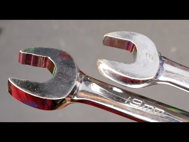

    Decades ago I saw a set of thin stubby wrenches with convex faces. I think at Northern Tool. Never saw them again. I regret that I didn't buy them.
    the convex faces are gearwrench. not sure about a stubby version.

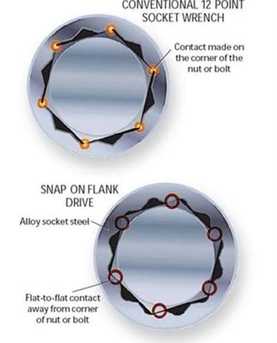

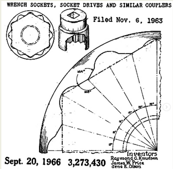

    109A_5 Posts: 4,759
    @jumper, Convex faces ? Are you referring to where the box wrench (and sockets) contacts the fastener ? If so I believe Snap-On Tools called it Flank Drive and they had the original patent on it. When the patent ran out many other tool companies copied the technique.

  • jumper
    jumper Posts: 2,625
    I think so. If wrench applies force to faces rather than corners then fit can be less precise?
    there is more material behind the face vs the corners. you can apply a lot more force to the face before it deforms vs to the corner before it shears off.
    109A_5 Posts: 4,759
    @jumper Less precise ? I suppose it is all in the way you looked at. Maybe less precise in the conventional 6 or 12 point way. However it may be more precise in other ways to make the Flank Drive work correctly.
    How about Flank Drive Plus for open end wrenches.
  • ratio
    ratio Posts: 4,344
    The first time I saw one of those open ends, I thought "Man, they really let QA go to $h!t."
    I'm still not convinced that the open ends are any better. I think it's possible for the sockets & box ends to actually be better, but I've yet to come across a place where I looked at it & said "Yup, shouldda used something that grabbed the flats."
    it lets the sides of the open end bend more before they lose grip. it also might move the fre to a point where it bends the sides less.
    the big problem here is that rusty fasteners are no longer the size they were when they left the factory.
  • jumper
    jumper Posts: 2,625
    I was talking about open end. Occasionally we come across a big (over 1") whatever in a tight spot. That's why I regret not buying those stubby thin wrenches with funny jaws.
