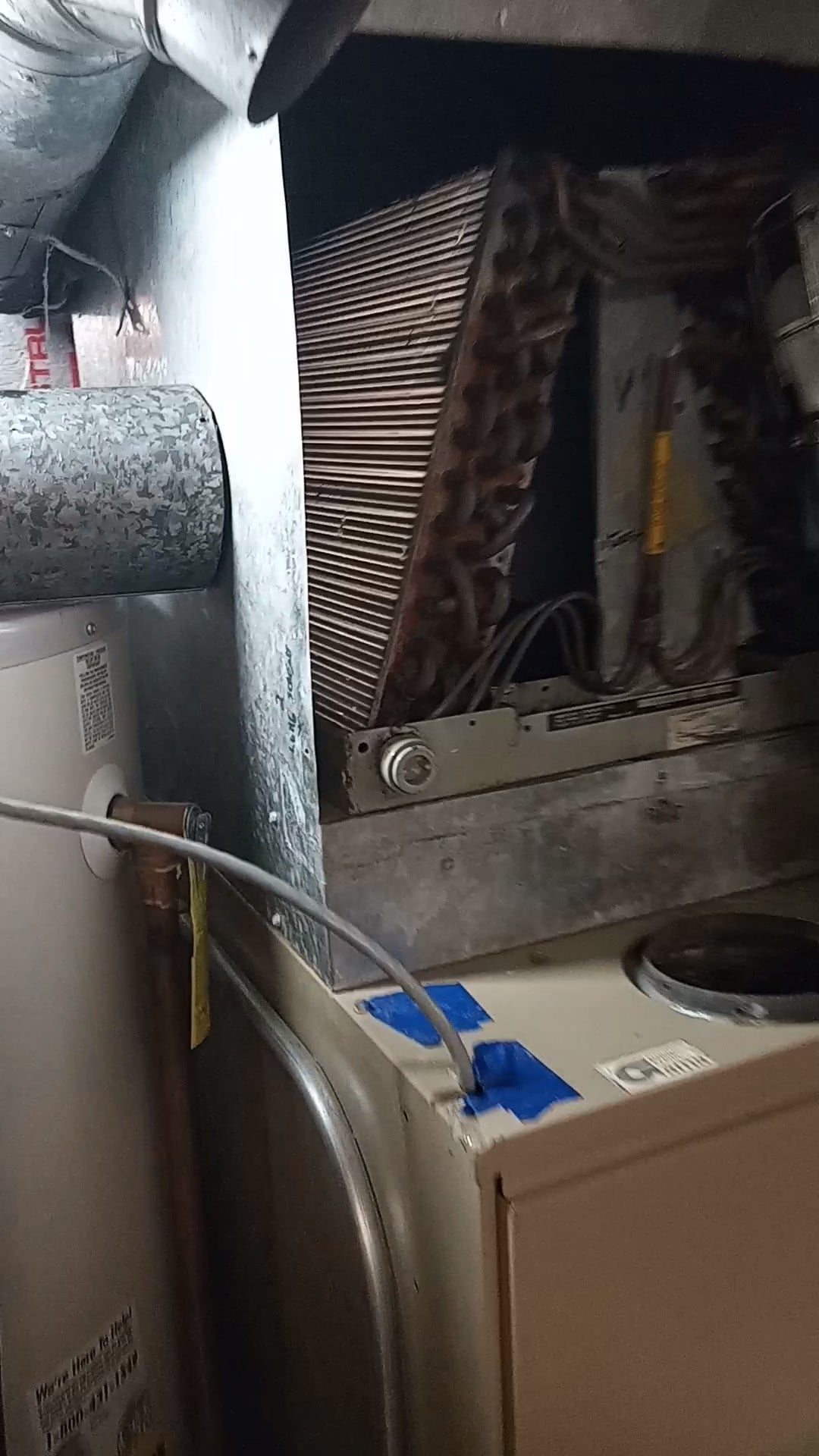

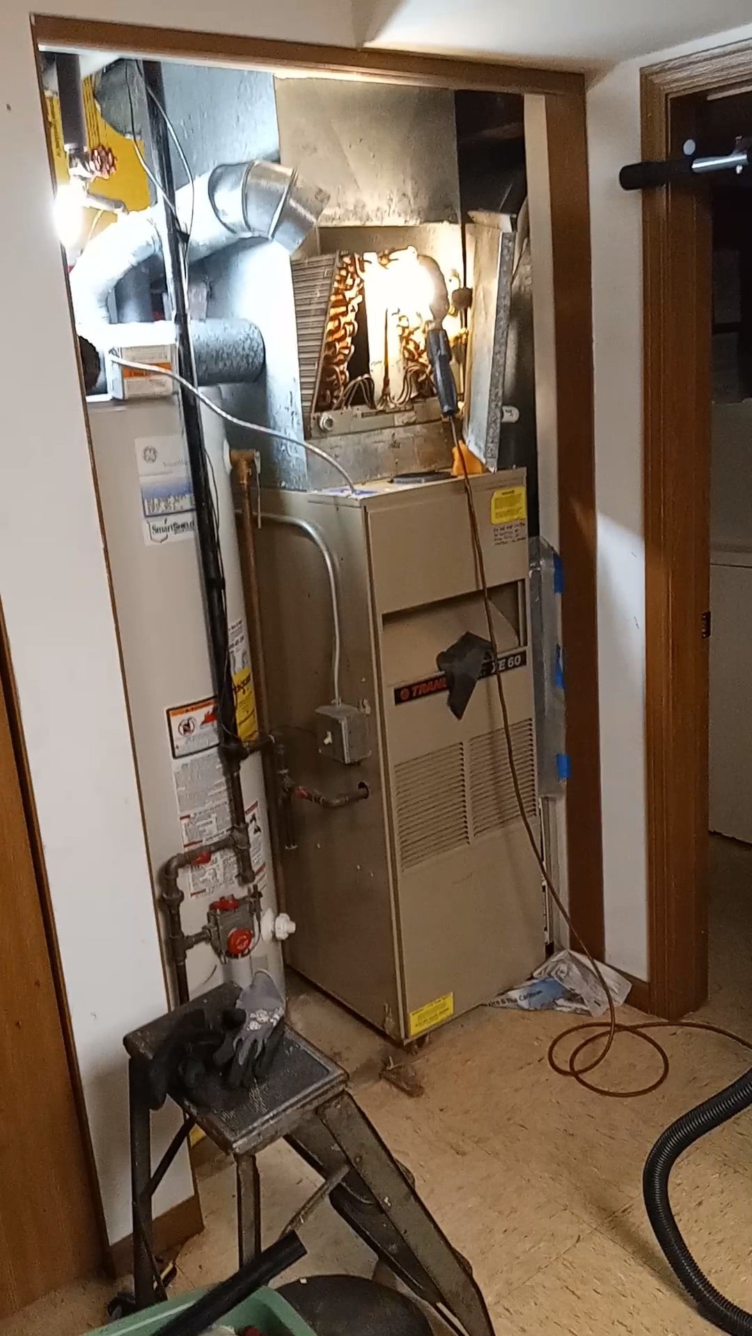

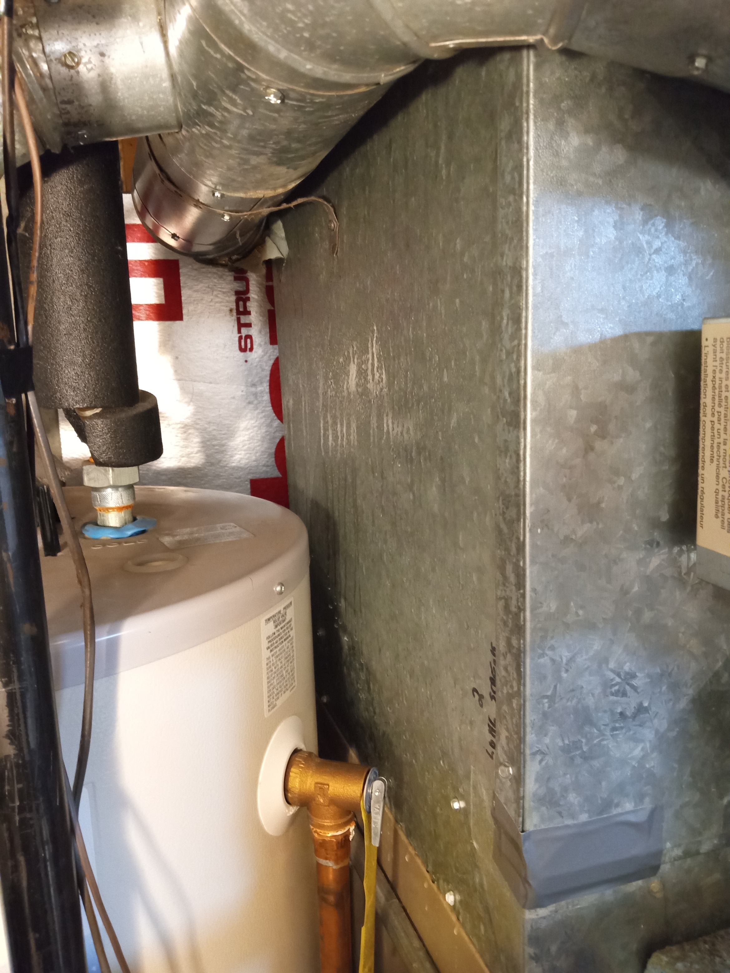

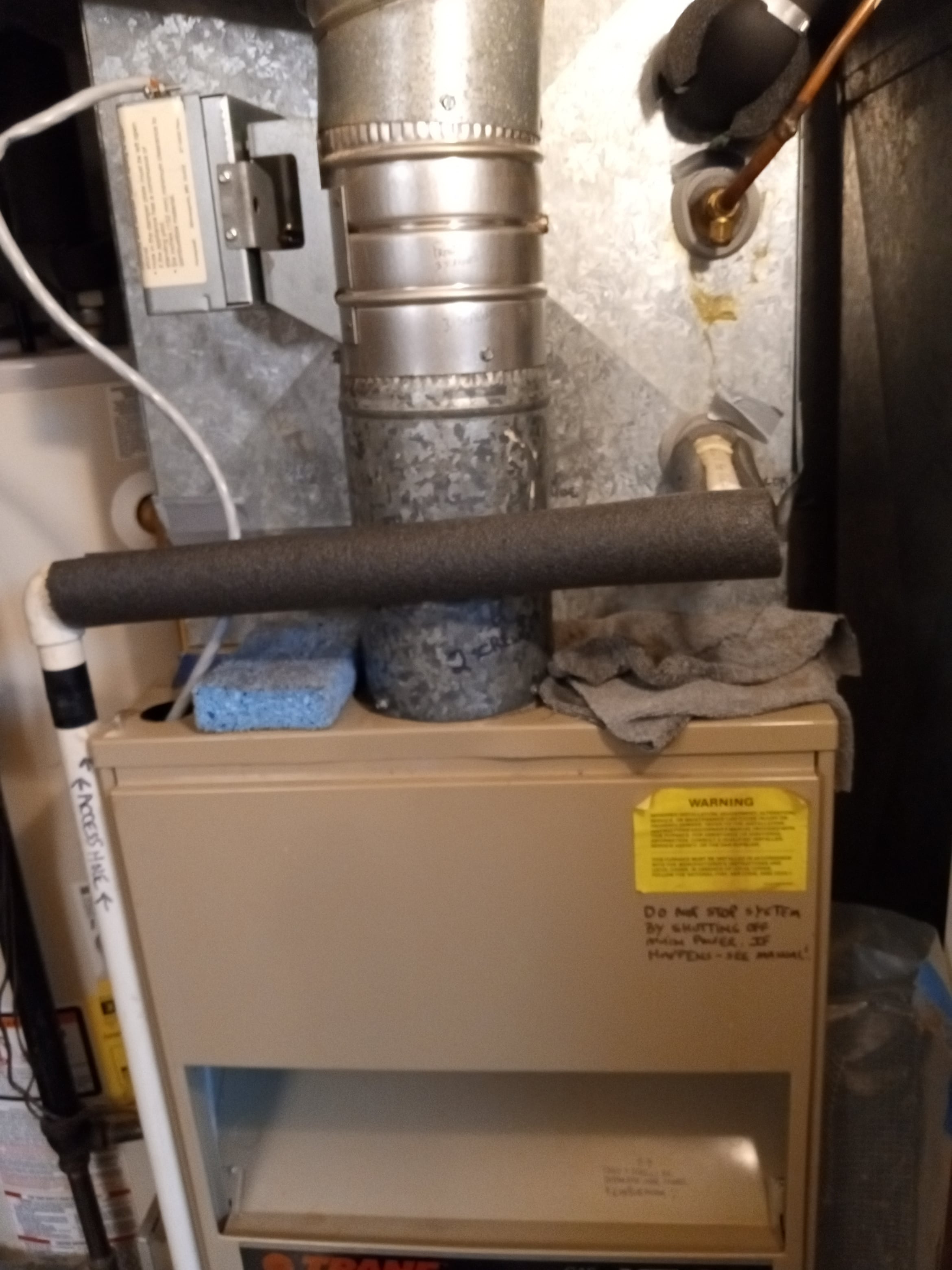

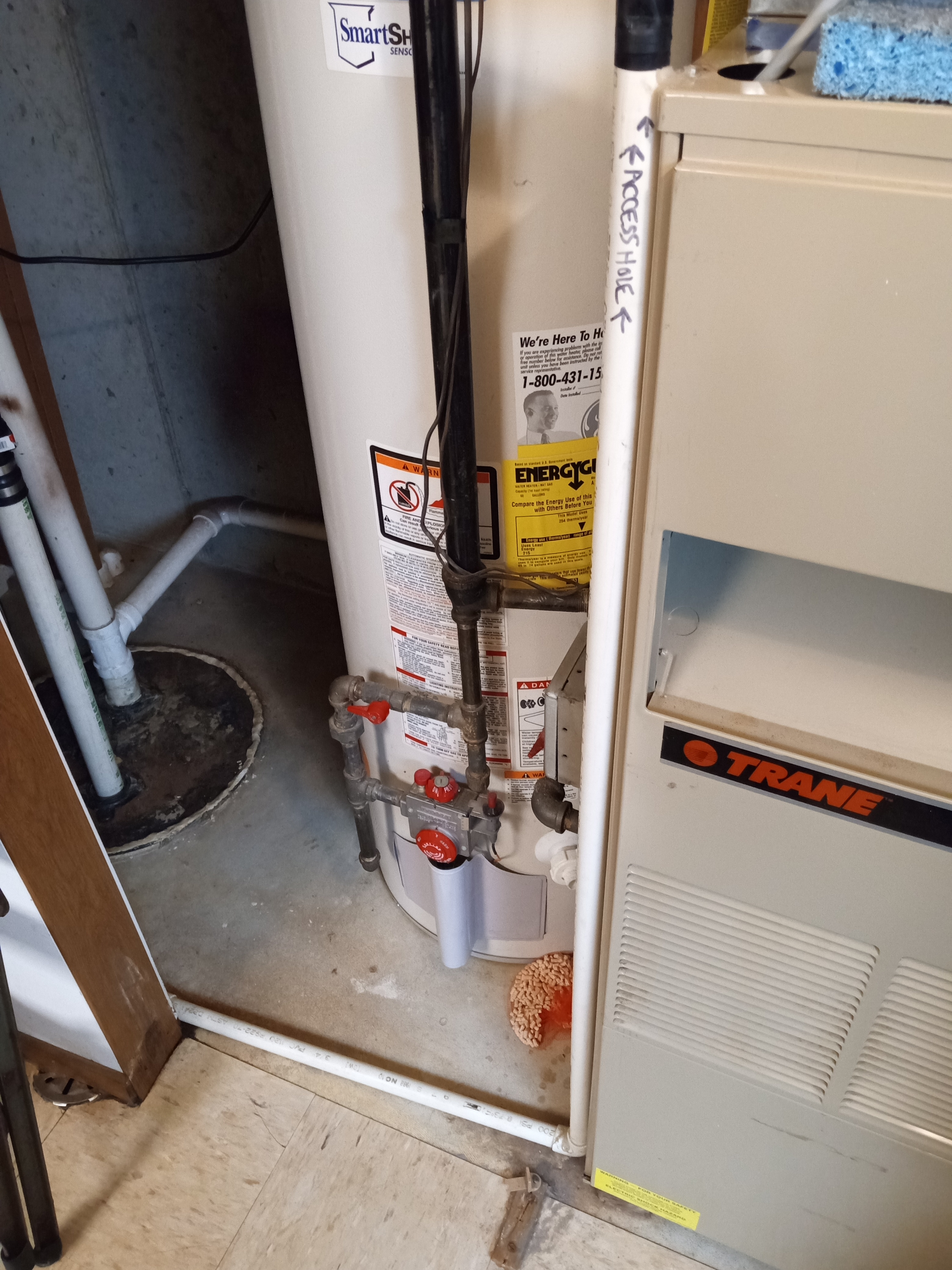

    Here are views requested with drain connected etc.
    IMG_20260714_162949218_BURST000_COVER.jpg IMG_20260714_163022757.jpg IMG_20260714_163122835.jpg
    UPDATE 7-14-26
    1 – Thanks again to all respondind.
    2 – pic of drain setup & side where condensation seen plus same on opposite side.. No trap on drainline. No insulation in blower compartment. No drain pump.
    3 - 7-12 Sunday: outside about 85-87 degrees inside 80-81 & humidity @ 42 % in living room where Mom is.
    I ran it for a few hours. At 430 PM the fat pipe was cold and moist.
    The smaller pipe was lukewarm/room temp.
    Airflow: possibly was reduced from start of AC. I felt a # of first floor
    vents with hand. Id say reduced.
    No puddles seen. But condensation on both side of duct where Evap unit is.
    4 – Monday: outside about 90 degrees
    Ran a number of hours. Humidity was reduced but temp was not. Temp measured in three spots 1st floor.
    Some ice on fat pipe but insulation was pulled back so I could see so possibly I didn’t get it back properly.
    Water found in blower compartment after I shut off for night and checkedit.
    Drips seen on sides of duct covering Evap.

    there’s no insulation on that supply duct it’s going to sweat

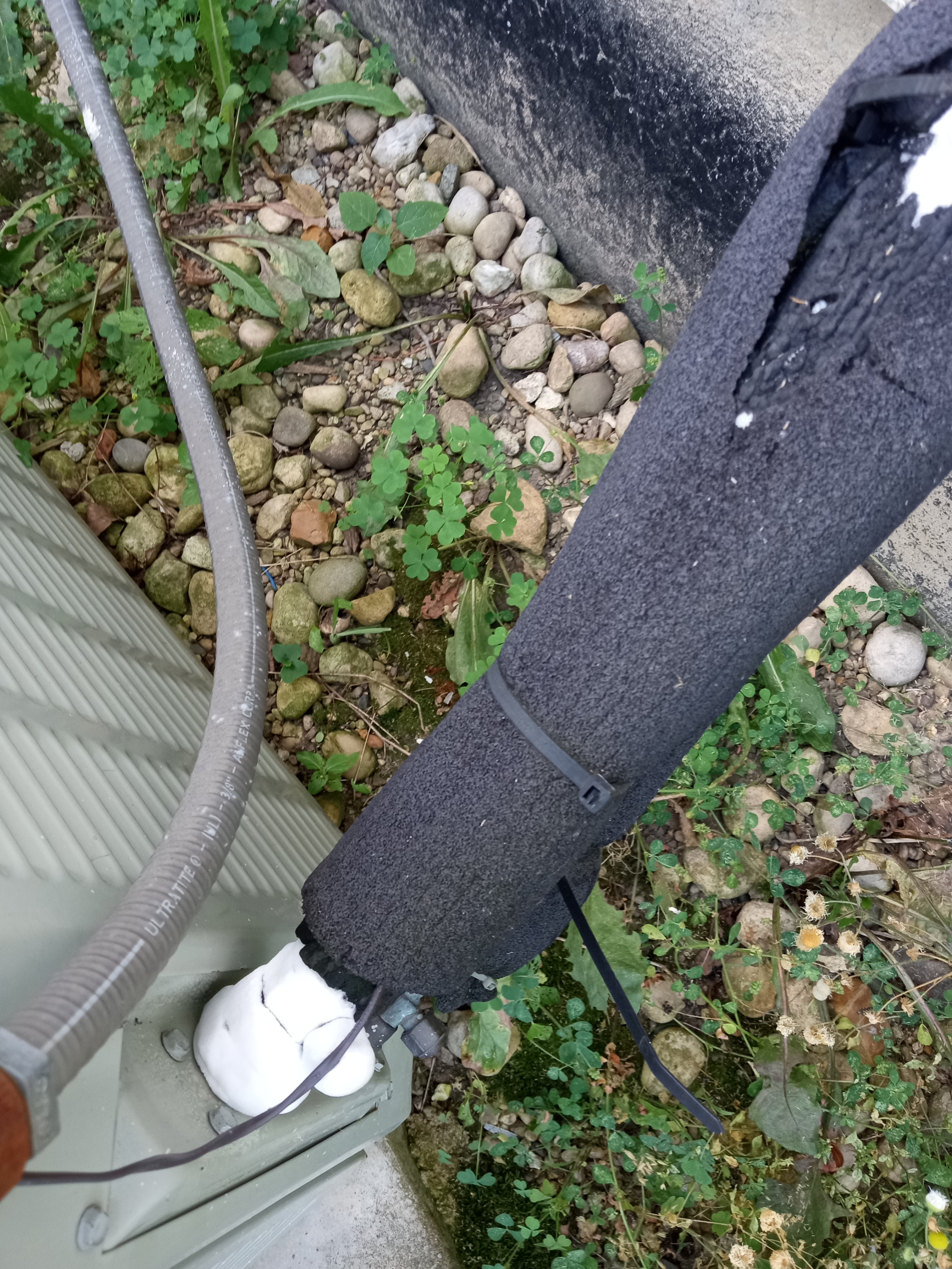

    UPDATE 7-17

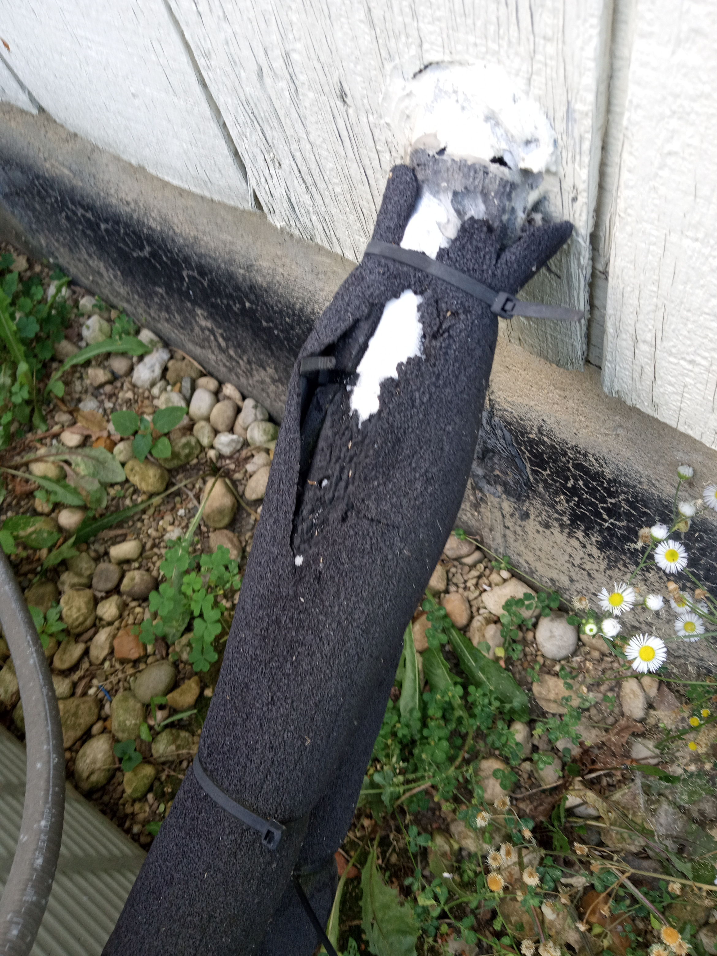

    I just saw this icing outside when I went to look at refrigerant type. Does the ice confirm the diagnosis of low refrigerant? Would rewrapping that pipe help?
    Tag on condenser said MFG 1988 and refrigerant 22.
    Allshore Guy - which duct should I wrap that you mentioned?
    Hvacnut - Im concerned about "little Becky" What type of bucks are you talking about if needs R22?
    edited July 17
    if it is icing all the way back to the condenser i'd suspect indoor airflow. is the blower running on high and intact and clean?
    it should be vapor at that point if there is enough load on the evaporator
    pecmsg Posts: 7,634
    edited July 17
    that’s frozen up!
    Pull the disconnect out. Let the indoor fan run for a while.
    but if it were low charge icing it wouldn't ice back to the condenser, it would be mostly vapor coming back to the condenser
    pecmsg Posts: 7,634
    As the coil freezes refrigerant travels furthere down stream.
