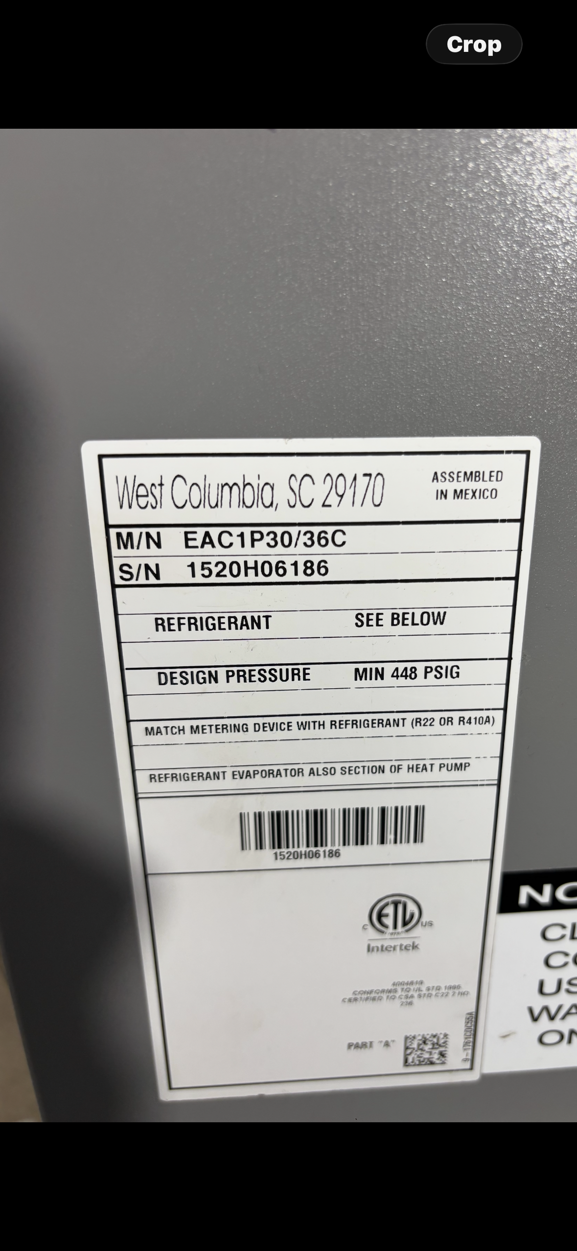

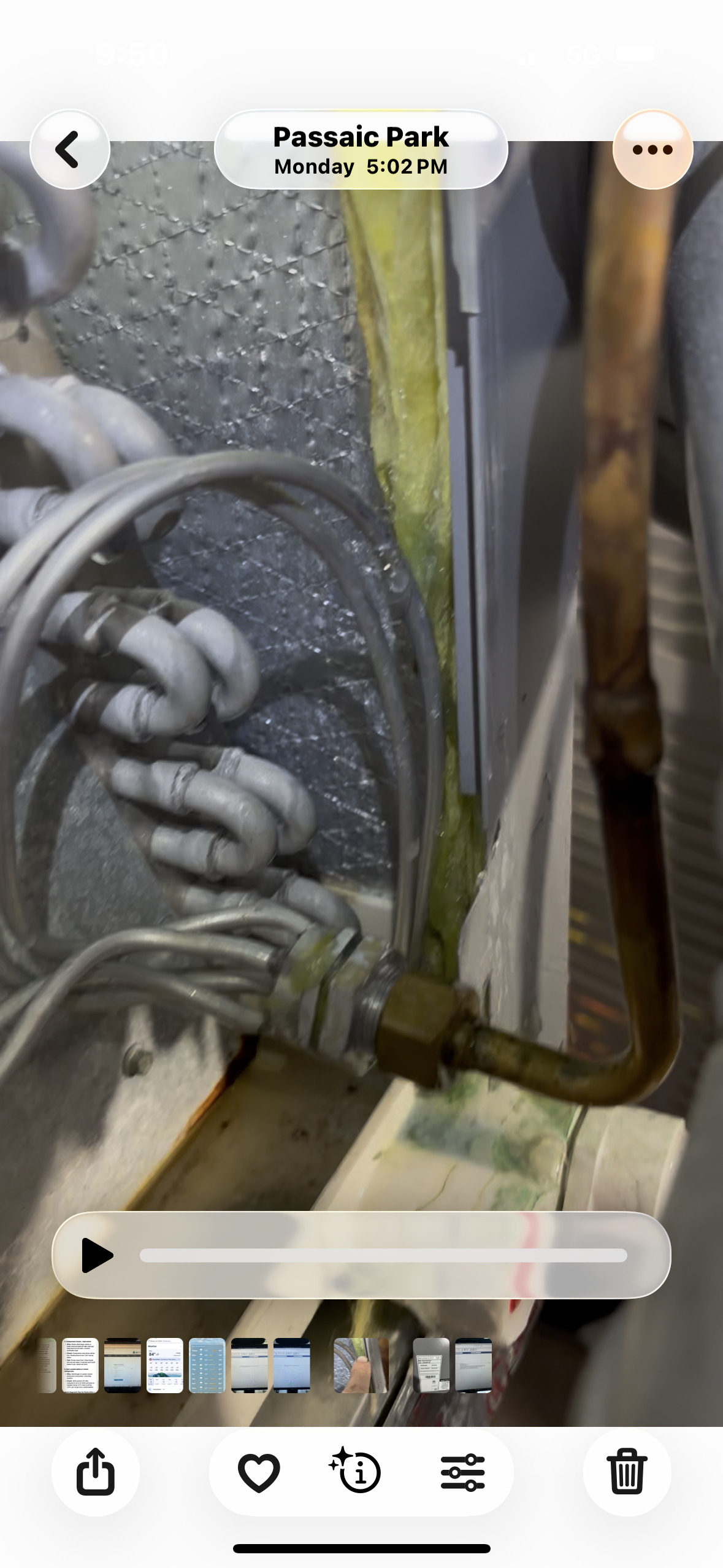

Hello to all,
I have a customer that has a leak on one of the distributor cap tubes on the a-coil. It is aluminum. In the past I have successfully used LA-CO which is a green crayon that you heat up and apply. In this case I am a concerned the cap tube will fall apart if I try that. Is there an epoxy on the market that I can apply to aluminum with out any heat?

    I don’t think I’ve ever seen an aluminum cap tube.
    is this after the expansion valve feeding the evaporator?

    There may be something like JB Weld, but as a contractor that has to stand behind my work, I wouldn’t try it. If it leaks again, the coil will have to be replaced. Go ahead and do it right now.
    Something I’ve learned: I’ve been doing this for 55 years and trying to save money by doing a repair in a way that the manufacturer doesn’t authorize, or that doesn’t meet industry standards, almost always eventually results in having to do it over the correct way and costing more in the long run.
    Replace the coil.

    Installer needs to register these when putting them in. I sell that brand and just registering the install (matched equipment ODU and coil at least) will give you a free 5 year extension, so 10 years total. the coil was manufactured 6 years ago, so it would 100% be covered if it had been registered, or if it were installed within 5 years
    it costs zero dollars and takes about 3 minutes to do after an install
    also, I have replacements for this coil. its a multi positional version but I warrantied this exact model 3 weeks ago and used a multi position to replace and they approved it

    btw those are distributor tubes, not capillary tubes. if they disintegrate when you try to braze up the hole you have bigger problems.

    You regularly replace coils with generic ones ? I tried that years ago and the new coil did not fit into the cabinet properly. I figured if you don’t get the oem you can’t replace a leaking coil ?

    It needs to be refilled every 5 days so I don’t loose to just try. I agree that a replacement coil is always the best option. The distributor tube rubbed against the insulation and leaked so I know that the coil is otherwise ok. If I can’t find fix it I’ll know right away and can just go and get the coil. I stand corrected, I can get the coil, thanks to GGross letting me know, the first distributor I went to said I could not get it anymore.
