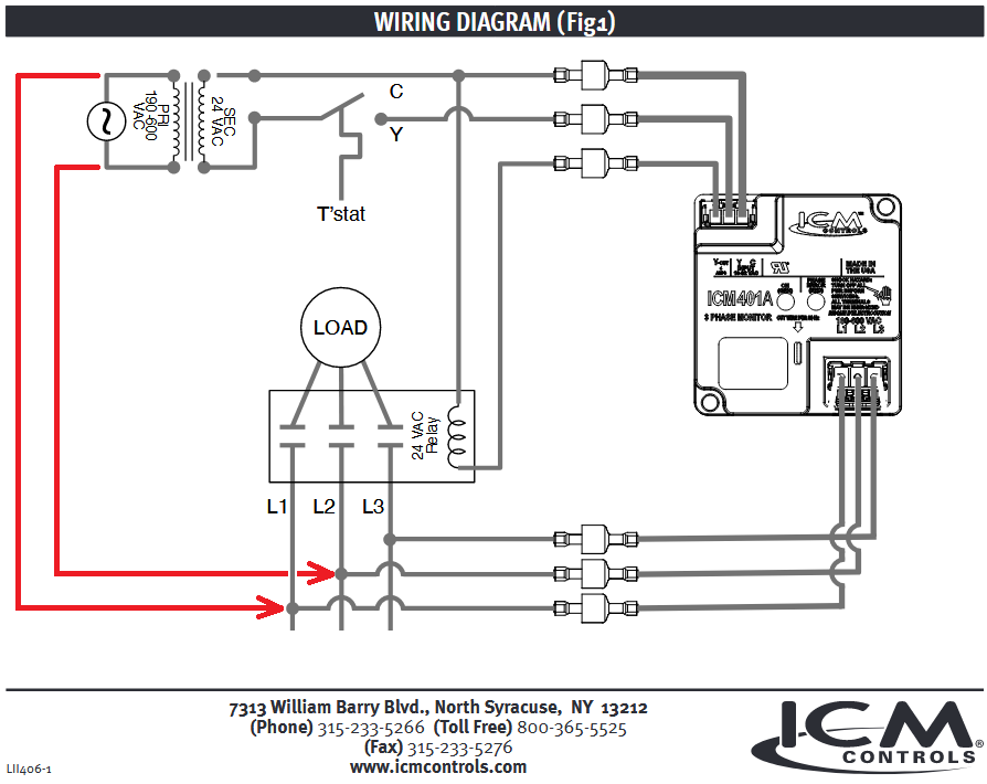

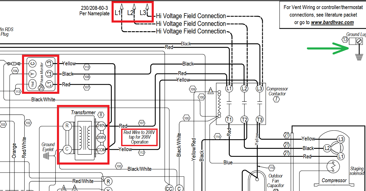

    Looking into Bard Wall Mount units a bit more, I suspect it has a Phase Monitor similar to this (some have a Bard part number on them). In the wiring diagram below, note the Control Transformer's primary Voltage, it is not 120 VAC. Again, I suspect the primary of the control transformer is 208 VAC.
    The Red wires are an example of the control transformer's primary connection.
    I suspect when they changed the original failed transformer they either messed up the Phase Monitor sensing wires or reversed two of the Phases, which you may have corrected. And I hope you verified proper compressor operation. If the other unit is the same model, presumably wired the same, you may want to use it to verify the wiring is correct.

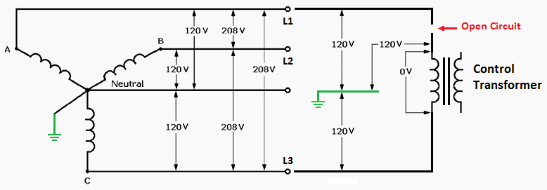

    With the information given by @Chapstick, I believe it is a 208 VAC Wye 3-phase system. The Phase Monitor appears to work and measuring 120 VAC is common with a 208 VAC Wye 3-phase system when one of the meter leads is connected to the Neutral or Ground. There is probably no Neutral in this situation.
    I believe the assumption that the control transformer is being back-fed somewhere is erroneous. Since even with one side of the transformer disconnected you would still measure 120 VAC to ground on the disconnected transformer wire. The meter simply 'sees' the voltage from the other phase through the partially disconnected transformer.
    Here is a partial wiring diagram that is probably similar to what @Chapstick was working on.
    109A_5 Posts: 4,809
    edited July 7
    With one wire going to the control transformer's primary open or disconnected (either wire, but just one) there will be 120 VAC on that wire from the transformer (measured from Neutral or Ground). Actually there will be 120 VAC on either side of the disconnection (measured from Neutral or Ground). There will be 208 VAC across the open circuit. When the open circuit is connected (closed) there will be 208 VAC across the transformer's primary.
