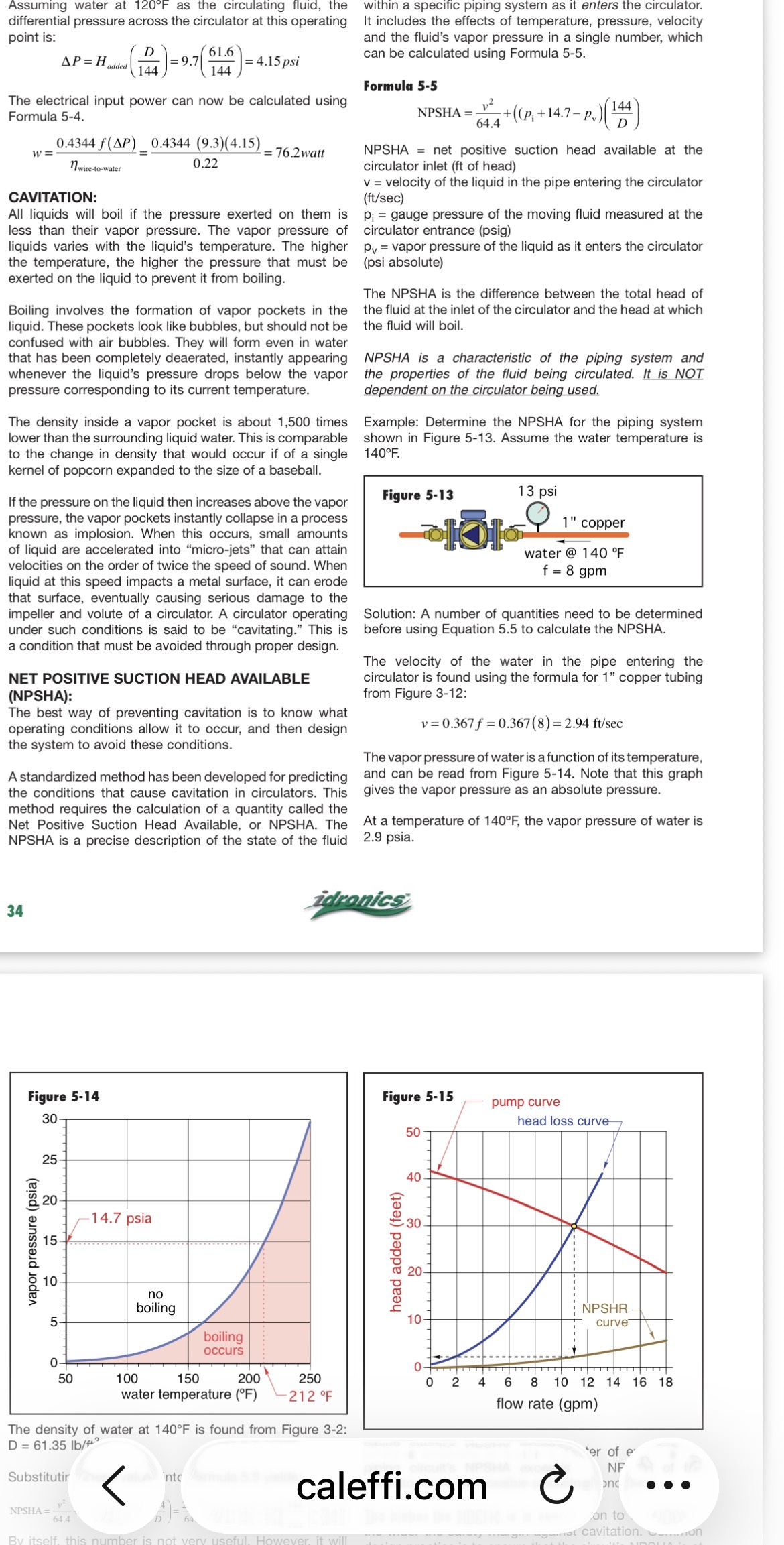

    hot_rod Posts: 28,699
    just be aware of cavitation issues when you start looking at no or negative pressure at the suction port of the pump
    Water will boil, even 100 degree water, if you drop below the vapor pressure
    From Caleffi Idronics 16
