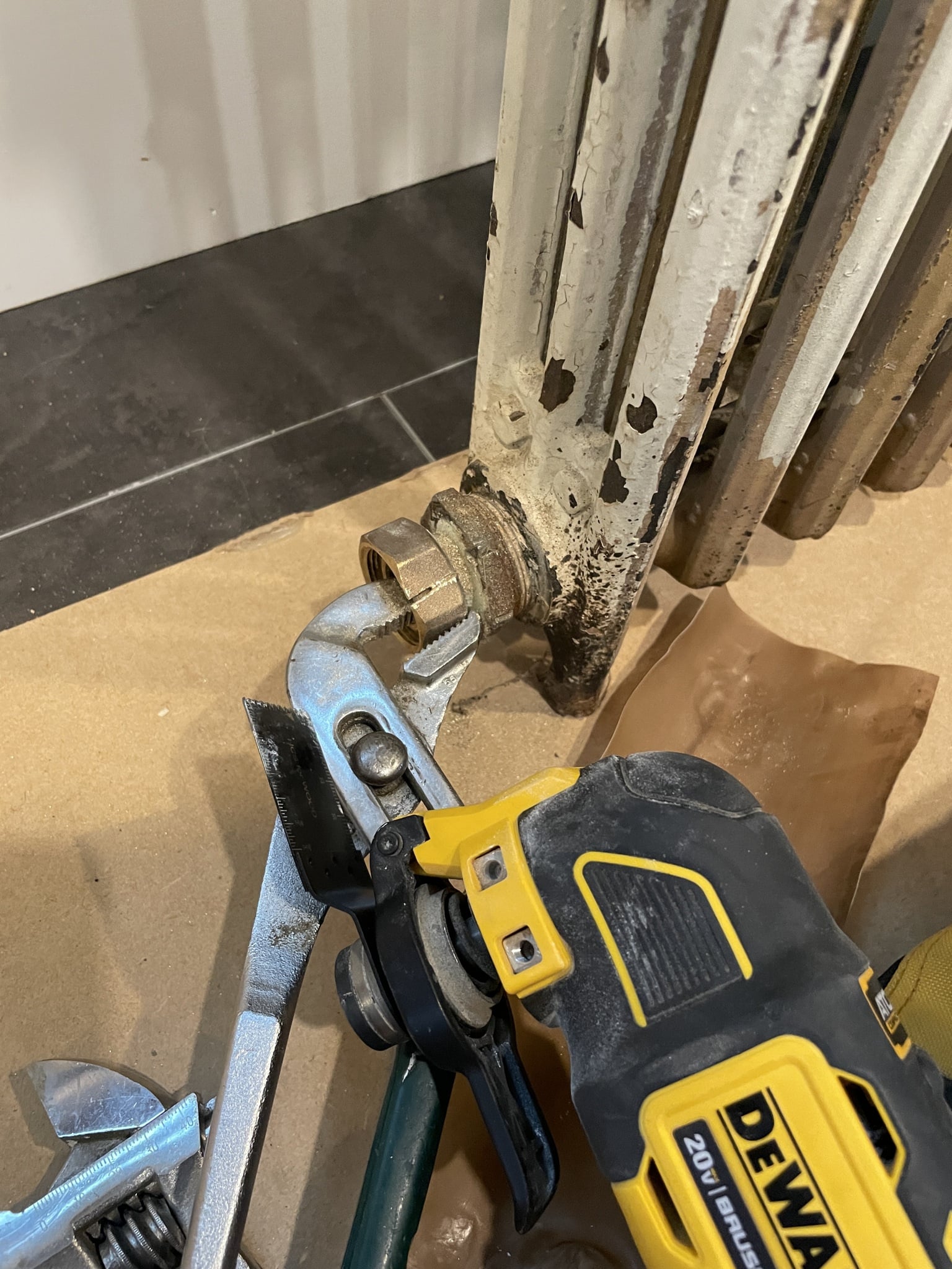

    Refilling to 15 PSI was a partial success. 3 of the 9 packing nuts were leaking a bit and tightening seemed to fix the problem, so that's good news and I can check that off my list. Unfortunately, the one valve that was leaking the worst, the one where I replaced the vertical nipple just below the valve is still dripping as before. When I took the valve off, I noticed the threads on the valve seemed a bit damaged. But I thought I'd just use a lot of pipe dope and some extra teflon tape to make sure it seals, but that didn't work, and I think I'll need to drain again and replace that valve.
    Replacing the valve is not a problem, what is difficult for me is getting the spud out. I haven't had any luck doing that on these 120 year old radiators. I bought one of those long universal spud wrenches, but I can't understand how to keep it tight on the spud to get a wrench on it. It just falls out. I've seen on youtube someone had a spud wrench that was just specific for the one size but I can't find it online. Also, I saw one video where he hacksaws the spud and chisels it out. That seems like it would work if the spud is soft brass, but then I'm worried I can damage the threads on the radiator — that would be a disaster. Advice? The dripping is very little, but I can't see leaving it, it will bother me and the nipple will rust again.
  • PC7060
    PC7060 Posts: 1,980
    Slide the spud tool and put a wrench on it they tend to stay in place.
    If spud lugs strips out, I cut the nut off with oscillating saw and remove spud using pipe wrench. Every spud I’ve every seen is brass and unthread easily once you get pipe wrench on em without damaging radiator.
    The brass is also why the lugs can strip.

    guitbox Posts: 58
    That's great, if I can't get it out with the spud wrench, I can still just cut off the nut and have enough room to grip it with a pipe wrench. That's the solution I needed, thanks! I was worried about messing up the threads on the radiator by cutting inside the spud.

    guitbox Posts: 58
    The nubs or spuds or whatever they are called were too worn to use the spud wrench. I ended up cutting off the nut. I put the spud wrench inside so the walls of the brass spud would collapse against something rigid. I didn't think that would work at first and I'd have to saw the inside of the spud (not my first choice) but eventually it moved with a big pipe wrench and an extension piece of PVC. It needed to wear off the lip on the spud before the pipe wrench gripped well enough to move it.

    PC7060 Posts: 1,980
    Good job getting it out. I start with a 18” pipe wrench and add a 36” cheater one for stubborn ones. 😊

    guitbox Posts: 58
    Thanks. My radiators pipes range from 1"-1 1/2" and this was one of the big ones and stubborn. I really had to mangle the pipe until an 18" wrench with a long extension would get it to move. But in the end it came out and now I know how to do it. Filled the system to 20PSI to pressure test it and after a tightening a few packing nuts, it's not leaking anywhere I can find anymore. I imagine that once I turn on the boiler the heat may cause some slight leaks and I'll have to go around and tighten nuts and bleed again, but I feel confident it's ready for winter now. Thanks everyone for the help.
