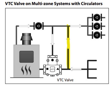

    Also, in my case, do I also need the highlighted secondary bypass loop?
    hot_rod Posts: 28,708
    Actually I would order the 115 sensor also. 115+18= 133° F29633 part number. The ODR may start ramping down the boiler before the 130+18 148° cartridge. Depends on how aggressive you get with the ODR settings.
    No need for the additional bypass pipe with the 280.

    That bypass pipe is needed. With boiler pump and zone pumps, you need to run primary secondary piping, the bypass pipe is what decouples the two primary flow rate from the secondary.
    If you run a single boiler pump with zone valves instead of zone pumps, you don't need the bypass pipe.
  • yeilon
    yeilon Posts: 15
    I do have zone pumps (one for each zone, on the return side), but not a boiler pump. Would that change your recommendation?

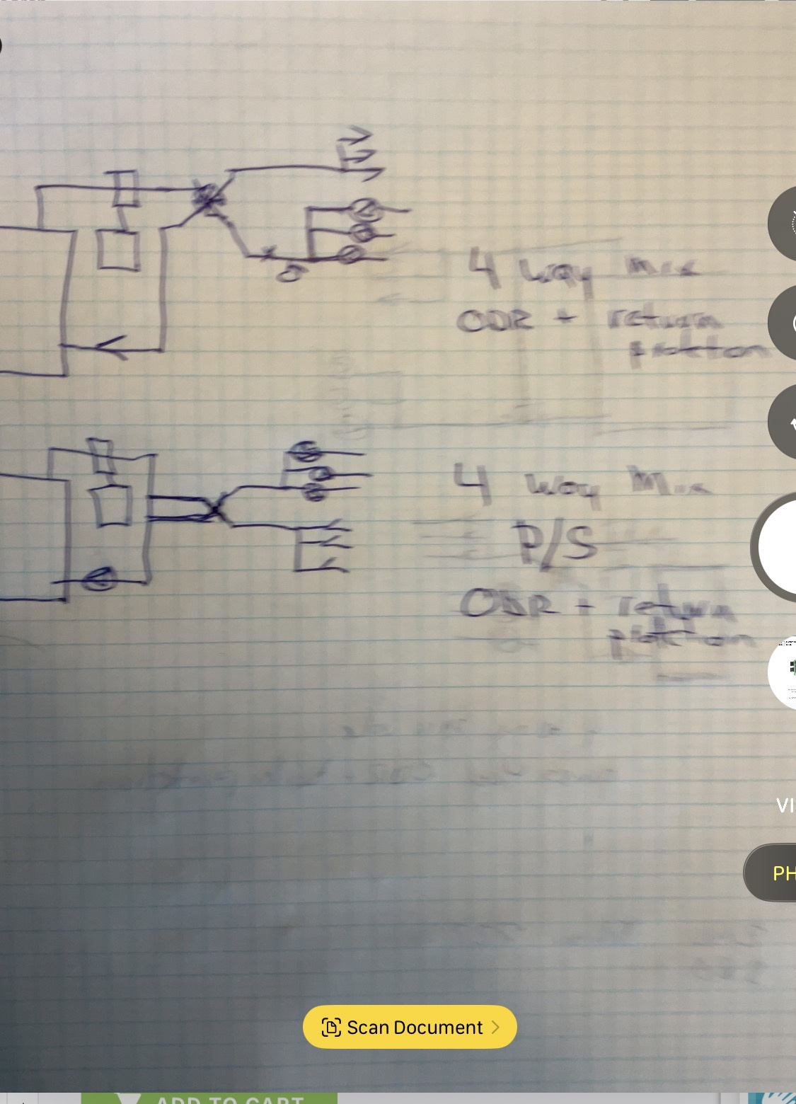

    Then decide if you want to zone with valves or the pumps. The pic below shows a single pump, multiple zone valves. A different piping needed if you use the zone pump. You will need a dedicated boiler loop, a 4th pump as Kaos mentioned.
    My thought is if the load is under 100,000 btu a single pump is a good option. If the system was larger and needed 4, 5 or more gpm per zone, maybe pumps make more sense.

    Thermostatic mix valve only works with zone pumps if you add in the extra boiler circ. You can't run just the zone pumps + mix valve.
    Your options are:
    -add boiler circ with 280/VTC+bypass and keep zone circs
    -add boiler circ with 280/VTC, remove zone pumps and change to zone valves (what @hot_rod suggested)
    -use 4 way mix with actuator+outdoor reset control on boiler with existing zone circs

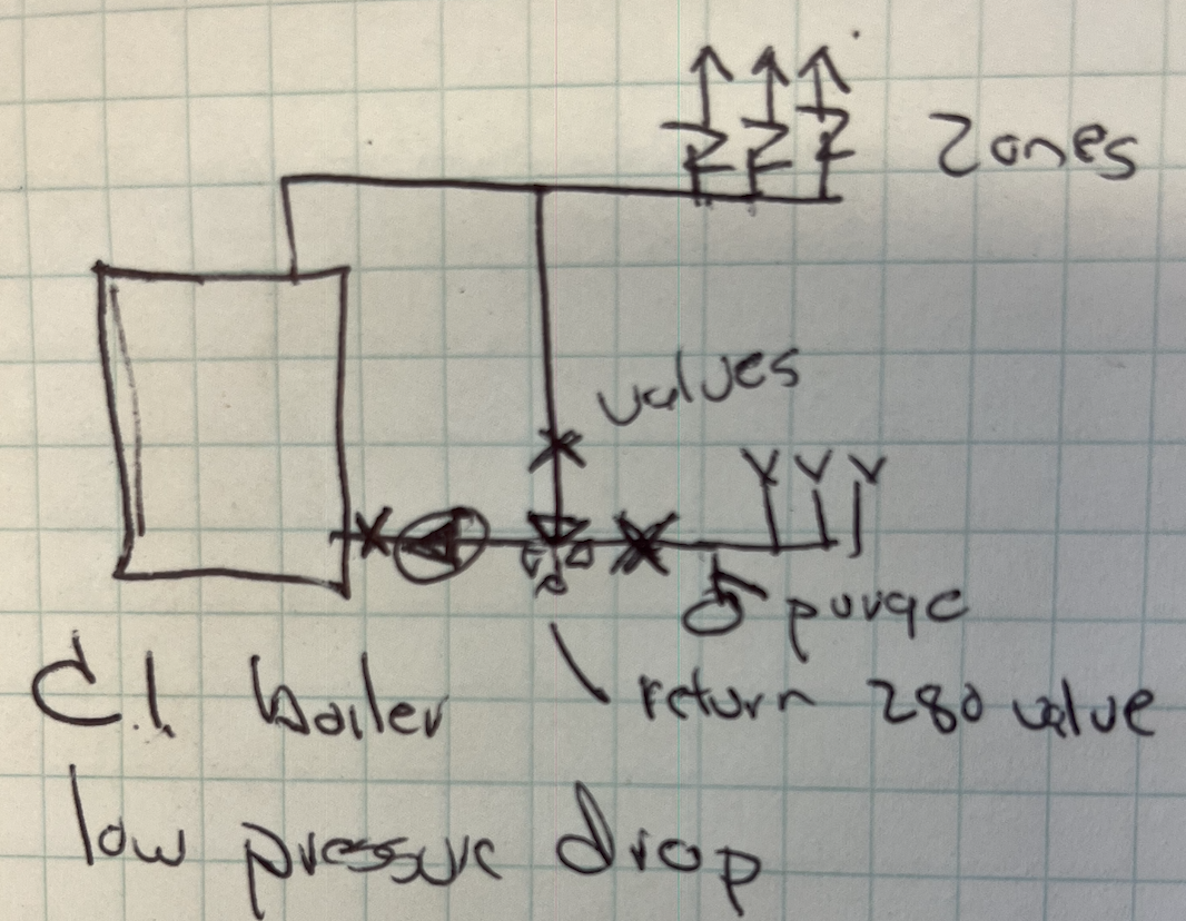

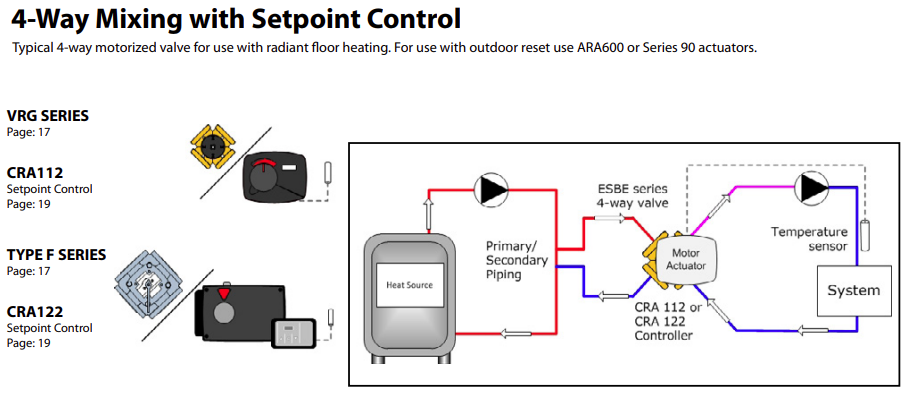

    you might consider a 4 way valve which gives you mix, ODR and boiler protection in one device.
    I have always piped them like the top drawing with low pressure drop cast boilers.
    Taco shows a primary loop, so an extra circ is needed.
    I think pumps could be on either supply or return.
    Price wise this may be the better option as everything is in one package. Shop for prices, they vary widely on this product.

    Thank you. Taco has discontinued the I-series 4-way mixing valves. I spoke with them this morning.
    Below is a similar diagram to your suggested approach. This one is from Danfoss, but similar valves and controls are available from other manufacturers.
    I plan to follow Kaos's option 1: "add boiler circ with 280/VTC+bypass and keep zone circs"

    Sketch a drawing of your final decision. Some component placement is critical to a proper working system.
    Pumping away from the expansion connection is important. Pumps on the returns make that tough to do, however.
    I'm most familiar with the tekmar 4 way package it takes 3 components and can get $$. If you shop ebay you can still find the pieces to do a ODR motorized 4 way affordably.
    The valve itself and actuator can mix and match with other brands of controls.
    tekmar, HBX, ESBE, and LK are common names.

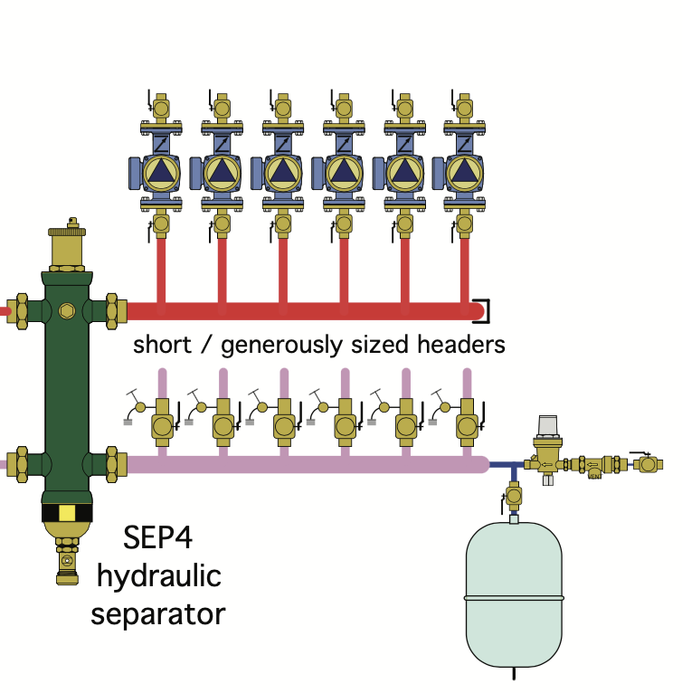

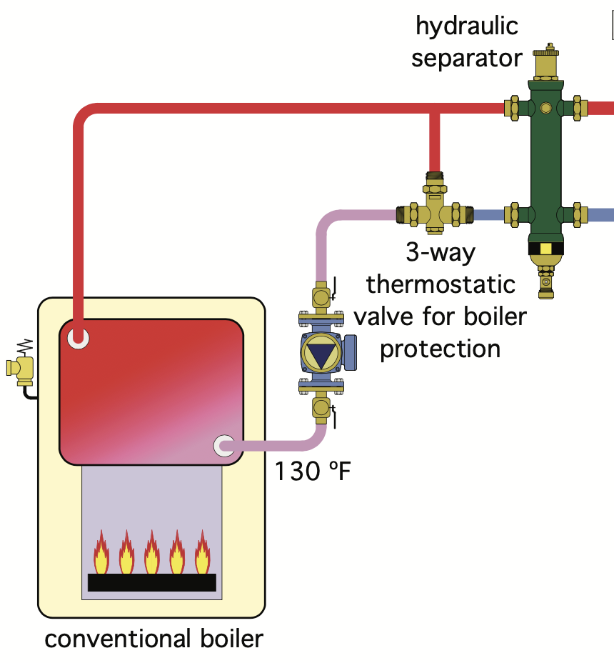

    If you are sold on simple, the 280 with a hydrosep is another good option, giving you 4 important functions in one package. Air, dirt, magnetic, and hydraulic separation. Expansion tank on either of the "blue" pipes at the sep.
    It looks like this with the zone pumps on the header pipes right of the sep.
    Screenshot 2026-07-01 at 6.00.46 PM.png Screenshot 2026-07-01 at 6.06.02 PM.png
