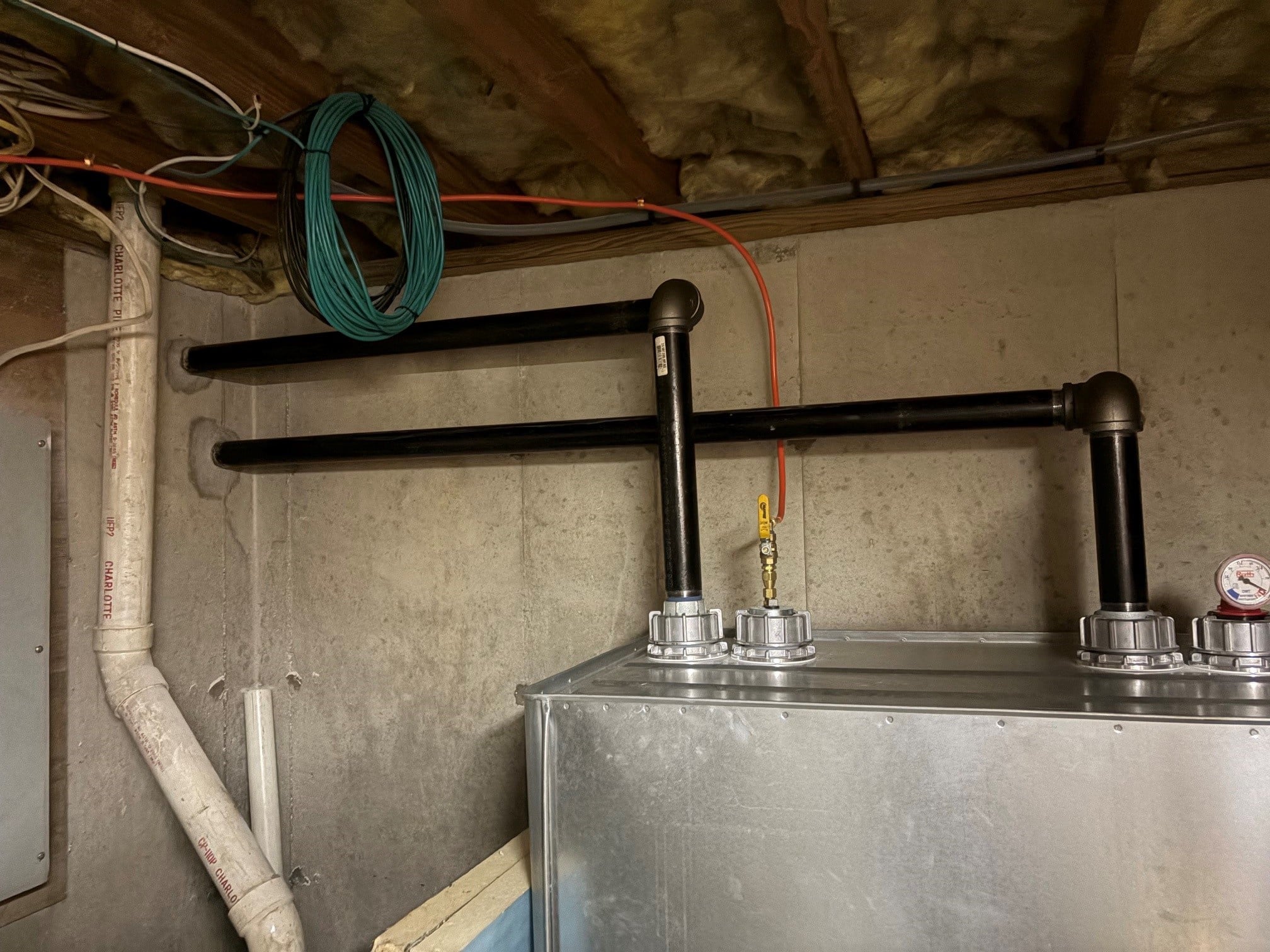

I just had a Roth 275 tank installed in my basement, the original copper pipes that ran through the siding were replaced by 2" steel through foundation
The pipes are horizontal, there is no pitch in either towards the tank. I'm aware of the reasoning behind having a pitch in both pipes: seeping through joints, the possibility of oil blowing out through vent after overfill, etc.
I've been told that having a pitch is not required, and that sometimes the run through the foundation prevents adding some pitch to the pipe.
Is this acceptable or do I need to insist that the installer return?
Please see the attached photo, thanks.
Roth.jpg 767.3K
    EBEBRATT-Ed Posts: 21,328
    I doubt you will have any issues. The installer looks to have done a nice job from what I can see.
    As far as the pitch issue goes, yes the pipes should be lower on the tank end. They look level.
    The only reason for pitch is so any oil leftover in the pipes will drain to the tank.
    As long as the pipes are not back pitched and are level you should be fine.

    Thanks Ed, I do believe that they did nice work and I couldn't imagine overfilling the tank to the point where oil got up into the horizontal part of the vent pipe, but I wanted to confirm with you experts.
    The vent pipe is ~6 feet long: would you have given that some support from the joist above or not necessary?
    HVACNUT Posts: 7,784
    Hopefully the fill is on the left. So its only about 2 ft horizontal.
    The only concern would be if the piping is below grade outside. If so I would've used galvanized over the black steel.

    I don't want to be a PITA (but I will if I need to be), it looks like they'd have to chip out whatever they patched with and then shorten the vertical, adjusting the 'swing' section accordingly.
    I posted in order to determine if it was something to be concerned with, it appears that it really shouldn't be.
    What is the desired degree of pitch, 1/4" per foot or similar? And should they have supported the longer pipe via the joist above?
    Edit: I took a closer look, both pipes are very slightly pitched towards the tank along the lines of 1/32" per foot.
    It's fine. If the pipe is level then they can't hold any oil. You would only have an issue if they were back pitched.
    No additional support needed.

    @charlie123 That looks like a very nice installation. The swing joints on the fill and vent at the top of the tank appear, from here anyway, to be pitched up toward the fill and vent as they leave the building.

    @Intplm. Thanks, while my phone might be distorting things a bit, the verticals aren't exactly vertical (fill is tilting slightly to the left (vent less so)) so the swing joint is accommodating that I believe. I guess that this helps a little with my original concern about the pipes holding oil.
    Re: the valve on my tank: I assume that what I have there is a basic valve, hoping to determine if I need an anti-siphon or Firomatic there or I'm ok as is, thanks.

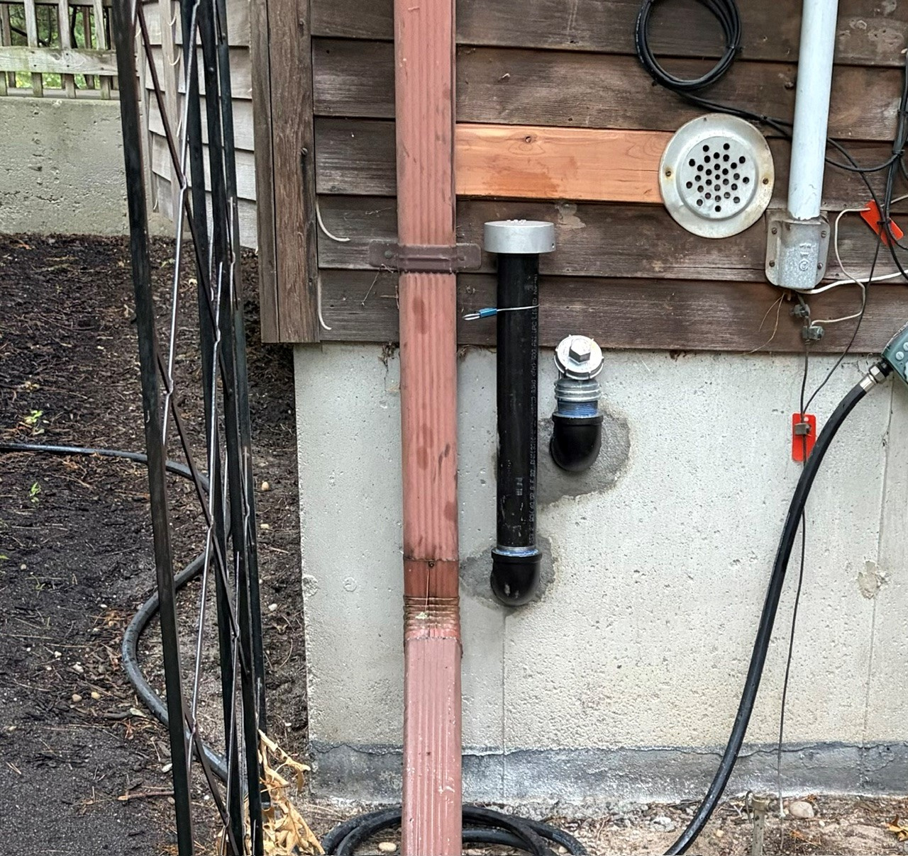

    I like the installation from what I can see. What does it look like on the outside?
    As far as pitch is concerned, so the oil flows back to the tank, I tend to think about what this will look like 20 years from now, or even 40 years from now. The swing joints should accommodate some settling of the building over that time.
    My concern is that the building may be more likely to settle at the walls and foundation, while the floor under the tank may not settle as much. If that happens, it could eventually create a wrong-way pitch. Of course, I could be wrong. The weight of all that oil in a full tank over 20 summers may cause the floor under the tank to settle more, which would actually increase the proper pitch.
    Regardless, you might just let it go for now. In 20 years, after the home has settled, you could have those vertical nipples cut off an inch to an inch and a half if needed.
    @charlie123 at the tank now it appears you just have a normal ball valve for a shut off.
    If your area requires a firomatic valve or an anti-syphon osv valve you do not have those. Most areas would require them yours may not.

    Hopefully the outside is acceptable…

    The outside looks fine for a right-handed delivery driver. I’m left-handed, and to me it looks like that vent pipe is a knuckle-buster.
    It is all good-quality work: neat work, professional work. But the actual future use does not seem to have been fully considered. That is probably because the tank installer does not drive a fuel delivery truck.
    Nice work, neat work, professional work. But like many engineers who draw things on a piece of paper, but do not actually have to perform the work, it may be structurally sound according to the book, while being ergonomically barely adequate.

    I'm left handed so I appreciate what you're saying but it's not so bad at the cap itself as it protrudes outward a bit.
    Unfortunately, based on the hole that they started for the 1st pipe, and trying to stay 3" out of the corner for the 2nd pipe, things wound up as they did.
