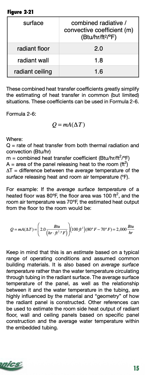

    Any radiant panel output is based on the floor surface temperature and the ambient air temperature of the space.
    In a residence you want to keep the floor surface below 82° or it becomes uncomfortably warm to bare feet.
    So here is some math for various radiant panels, floor, wall and ceiling. From Caleffi Idronics 25
    So for a room at 70° ambient with average floor surface of 82, 82-70 X 2 = 24 btu/ sq ft output.
    Often when you see higher floor output it is because the room temperature is lower. At 65 ambient
    82-65= 17X 2= 34 btu/sq ft. That may be fine for a shop, but a little cold for me at 65°

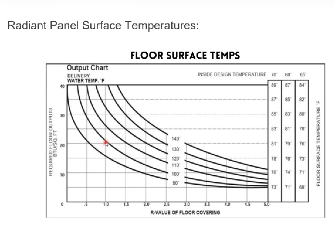

    Under a wood floor the subfloor and any final coverings subtract out.
    From Uponor
    Screenshot 2026-06-18 at 8.01.37 PM.png Screenshot 2026-06-18 at 8.03.31 PM.png

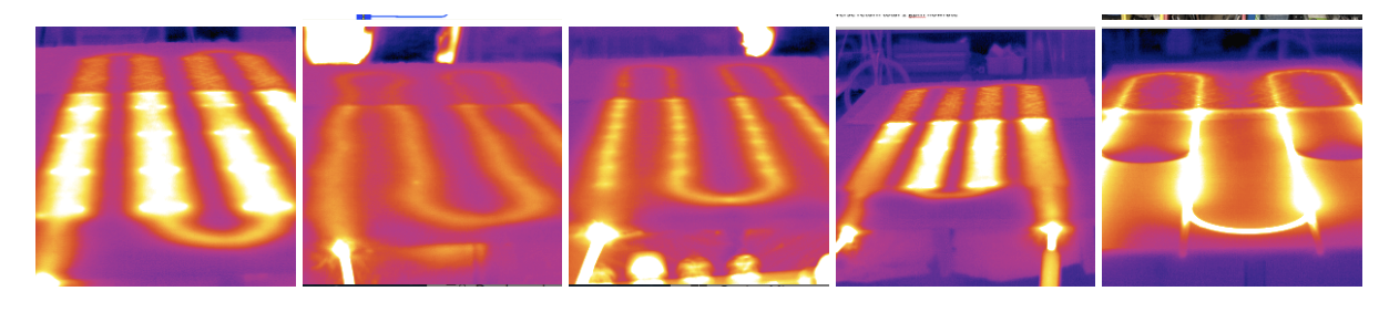

    Thjerse infrared show the challenge getting the entire surface a consistent temperature. From left copper tube in 4" extruded aluminum plates
    Suspended tube
    Staple up EPDM
    Pex in 4" extruded plates
    Warmboard.
    The back 1/2 of each sheet has berber carpet, no pad

    what are the 2 cooler circles in the warmboard?

    @hot_rod: Thanks for posting those photos, very interesting. Is the temperature scale the same for all of them? Because I'd expect the Warmboard to be noticeably warmer and evener than the plates, and it doesn't look that way. I'd also expect the copper pipe with plates to out-perform PEX, but that doesn't seem to be the case either.
    Interesting, it looks like the carpet does more to reduce output on the Warmboard than on the plates.
    hot_rod Posts: 28,699
    What you see with the Warmboard may be the 12” spacing. All the others are 8” on center in a 14” joist bay, so the heat stripping is more pronounced.
    Same SWT, same flow, same room ambient temperature.
    Notice that the carpeted back half reduces the surface temperature, but it does also spread the heat across the surface a bit also.
    The most consistent temperature spread I witnessed was the early SolaRoll mat systems. Both the width of the mat and the counterflow flow path with a hot supply next to a cooler return across the mat did the job well.
