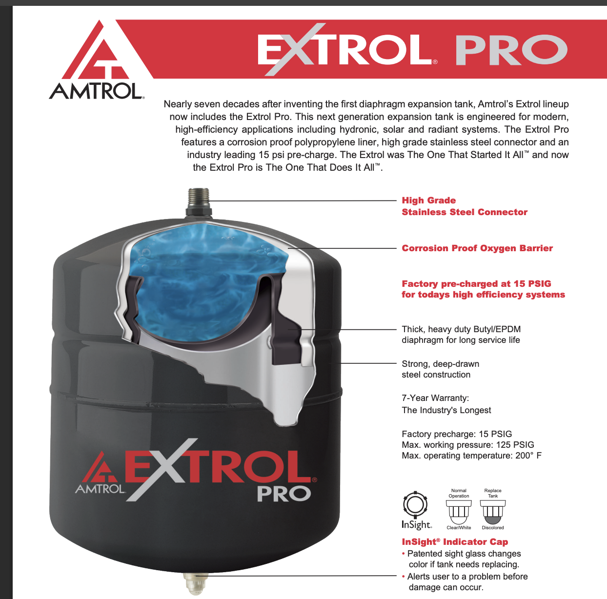

    The Amtrol Radiant Pro is basically their Thermtrol with a 1/2" connection. However it doesn't have the NSF listing as a potable water tank. But same poly lined tank used in the ThermTrol.
    ThermTrols are rated 180F, whereas the hydronic tanks are 200°. So use a ThermTrol only on low temperature hydronics.

    Screenshot 2026-06-16 at 4.02.39 PM.png Screenshot 2026-06-16 at 3.58.09 PM.png Screenshot 2026-06-16 at 4.14.07 PM.png
    wouldn't the schrader have to be leaking for that indicator cap to work?
  • Who woulda thunk it? I just looked at the patent, and the screw-on cap depresses the pintle on the Schrader valve when you screw it on. The cap has an o-ring to provide its own seal against the body of the tank. Then the volume of the cap is "in communication" with the air in the bladder. If the air in the bladder gets moist from a leak, it changes the color in the cap.
    https://patentimages.storage.googleapis.com/55/5d/ef/b1bd0c17214cac/US9915433.pdf
    Trying to keep Bernie burning!
    mattmia2EdTheHeaterManbjohnhy
    so instead of relying on both the o-ring and the schrader, to have at least one of them hold, we need the o-ring to hold.
