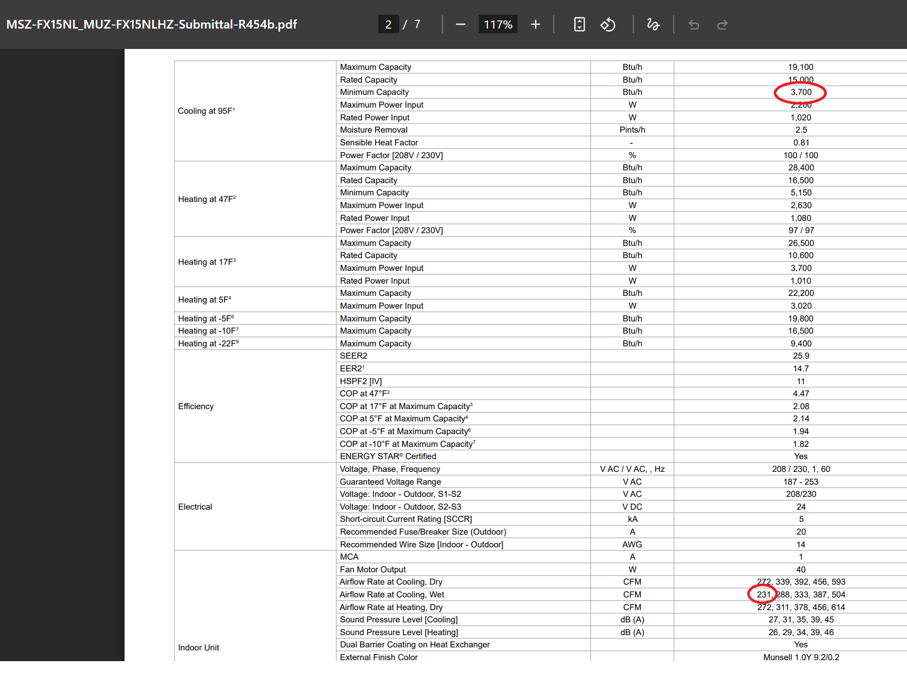

  • Kaos
    Kaos Posts: 1,003
    Here is the issue you have. The min airflow doesn't track with min capacity, so when you need to run the unit on min modulations, it flows way too much air.
    At max the unit is 330CFM/ton, at min it is 770CFM/ton.
    No way for the unit to do much de-humidificaiton at the low end with that much air.

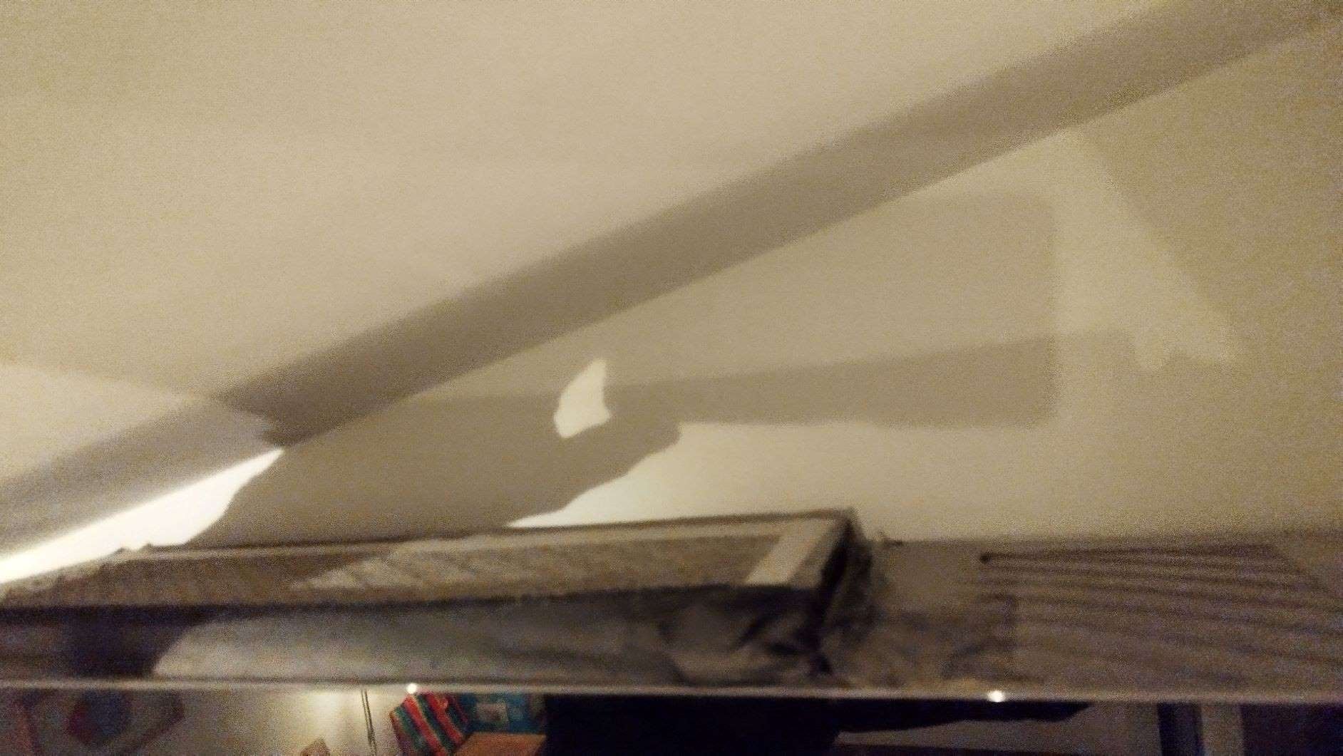

    The answer is you need to reduce the airflow rate. The way I have done this is by blocking the intake. Adding a pleated intake filter does a decent job of this. As a bonus it keeps the coil much cleaner. This will reduce max cooling capacity, but that should not be an issue with an oversized unit.

    Thanks for your advice and explanation. I did get a MERV 8 filter and attached it to the top as you advised. Humidity is staying in the mid 50's when it's as low as 76 out so not ideal, but much better. Humidity does creep up overnight when the outside air temp drops, so I may see if turning it off for say 6 or 8 hours helps to prevent that. I have a Emporia Vue energy monitor on it so I'll see how turning of off vice leaving it on all night effects energy usage.
