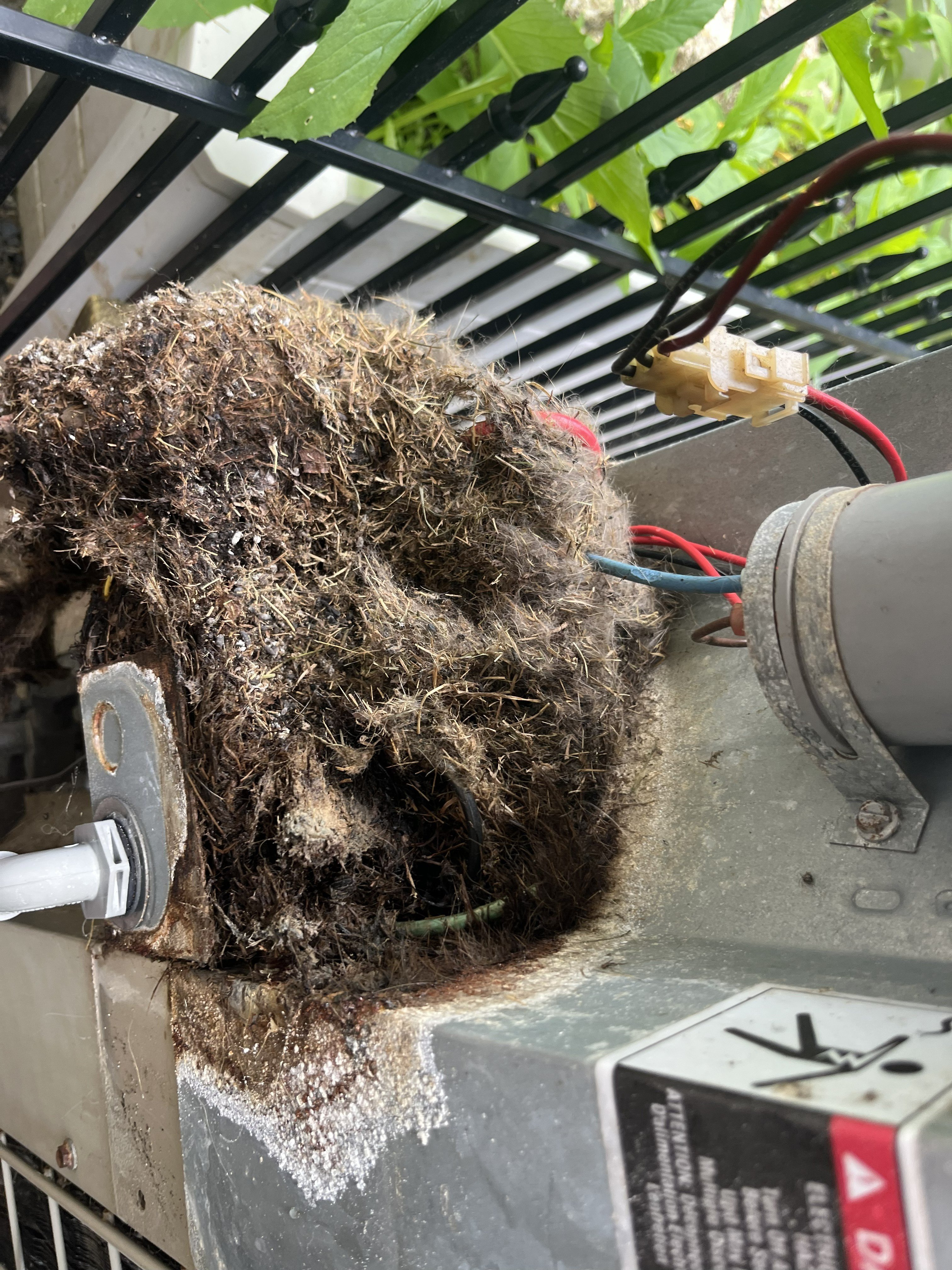

    I turned 73 a week ago. Today I did a "service call" at my niece's house. 3 ton split with a gas furnace no cooling. It's been really hot here lately. Comfort Air 31 years old and hasn't much time left.
    Condenser coil is starting to disintegrate (the fins). Compressor and cond fan wouldn't start. Found a giant mouse nest in the condenser controls. Repaired /replaced chewed wiring, checked capacitor, 43uF compressor and 4.95 fan writing on the cap gone. When I got home I found the compressor is supposed to be 50uF. Replaced contactor (got really lucky the local hardware store had one) and got it running. 60 suction 200 hd. I wanted to clean the cond coil but it's in pretty bad shape don't want to make it worse. After running it for 1/2 hour with a big load superheat was still high piston 30 deg. I added some R-22 and it worked fine and it went 75 suction and 225 head at 84 OA. I am slower than death and getting in awkward positions is tough sometimes.
    LOL
    Told her she has to start thinking replacement.
    Really don't know how it ran with that nest in there, but it had been running. Could have went up in flames!!!

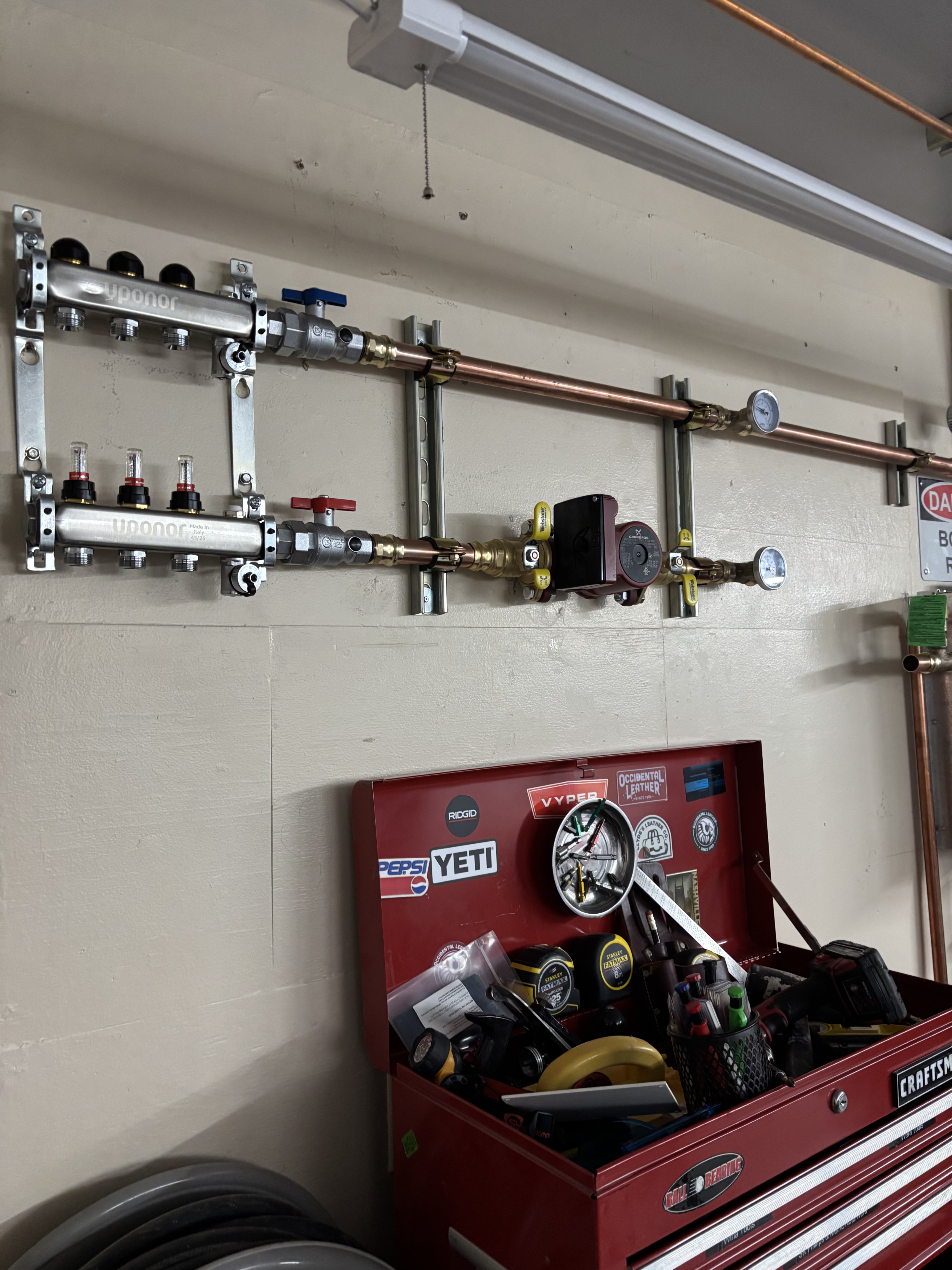

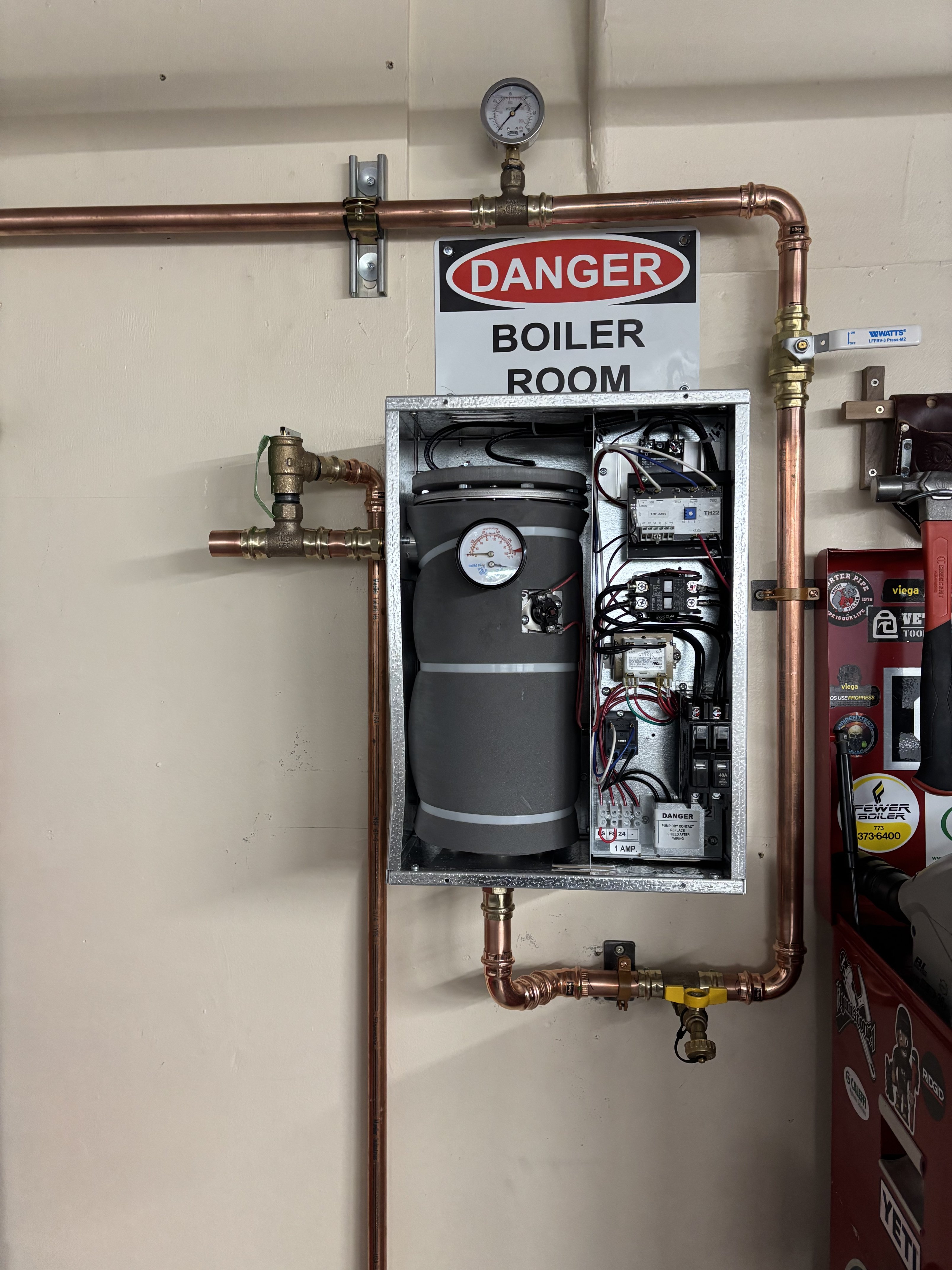

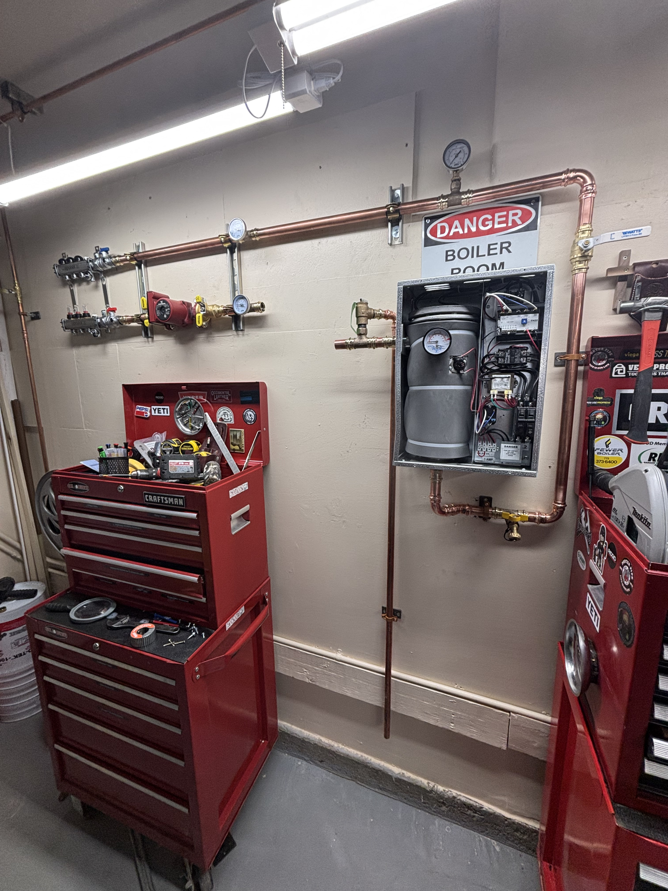

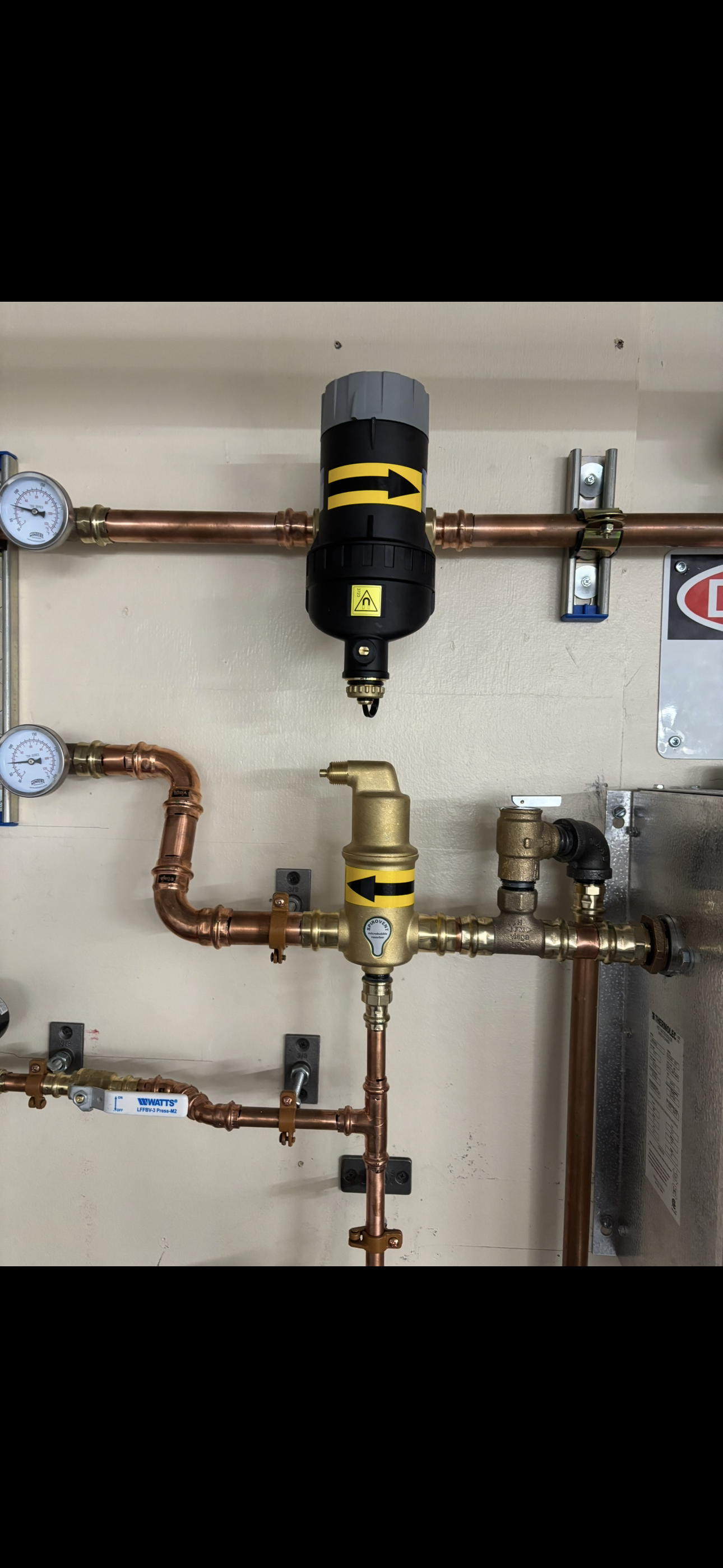

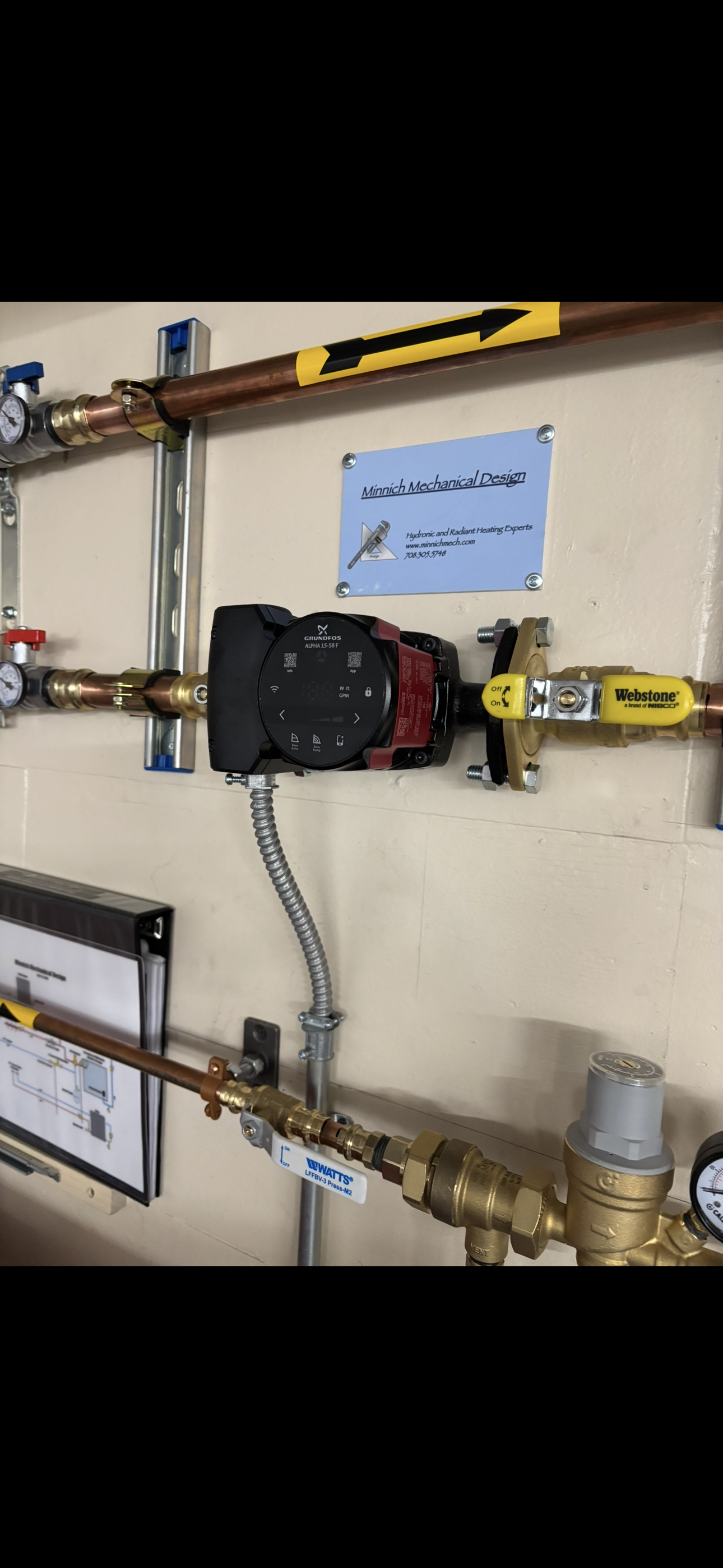

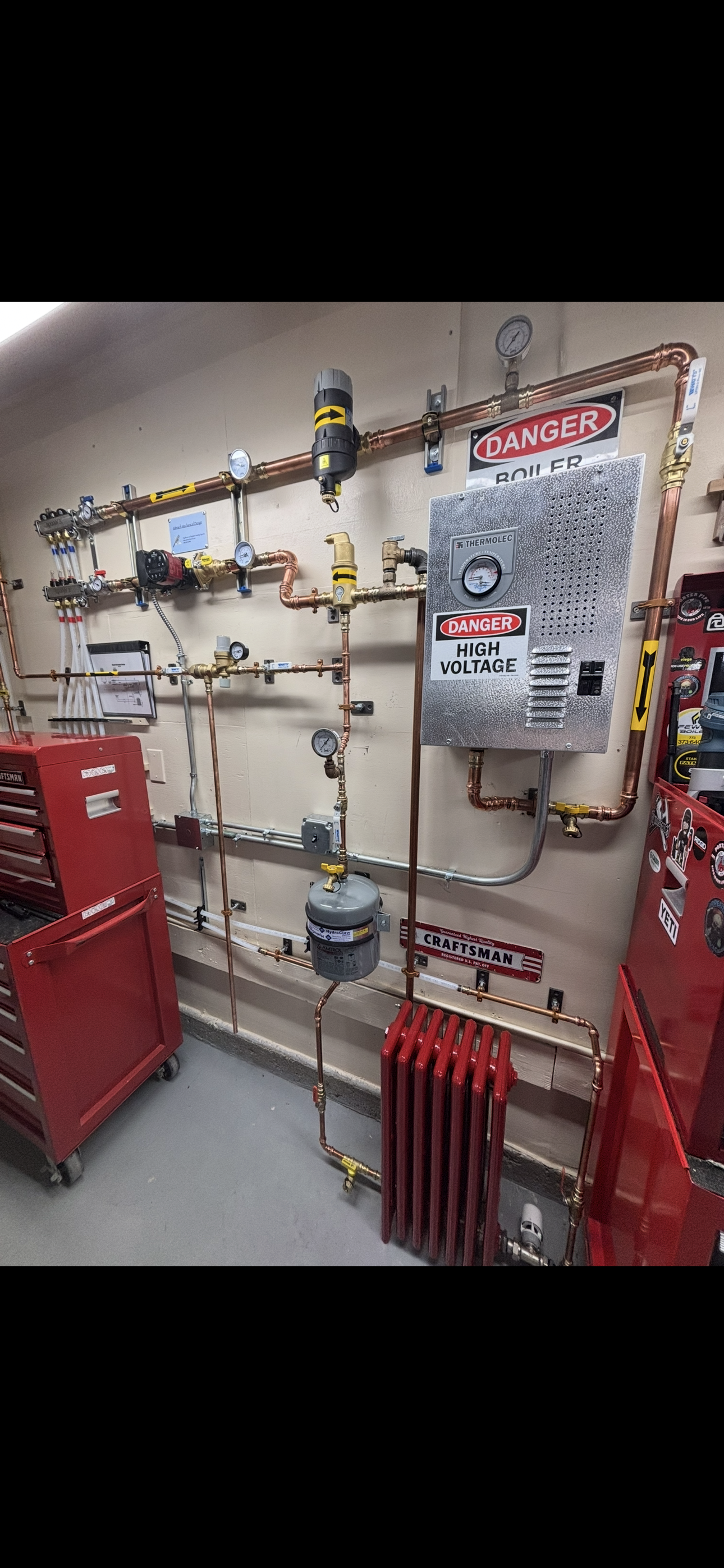

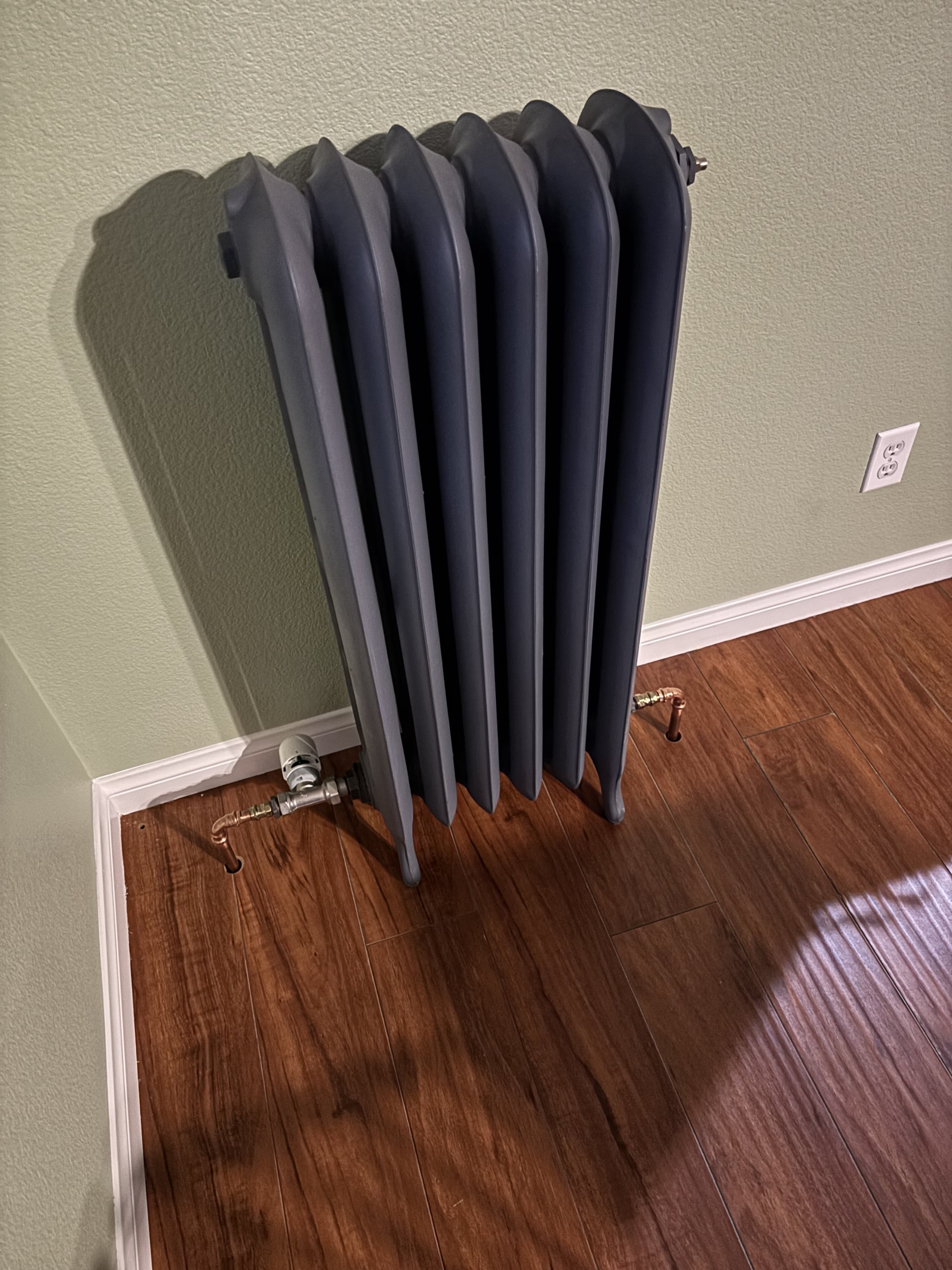

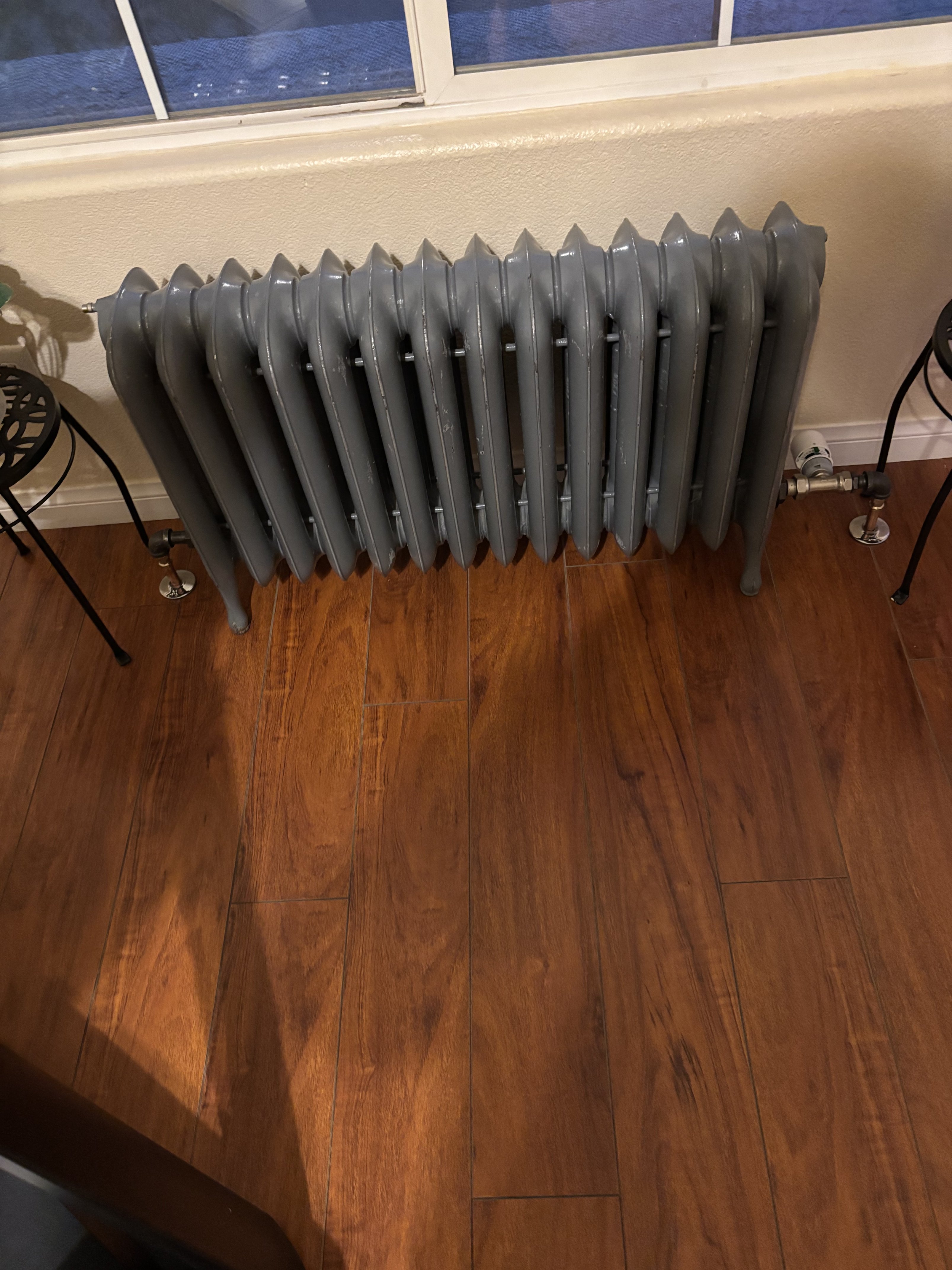

    I finished up about 9-10 days ago with the help of my son-in-laws. I needed them for the furthest radiator. The runs went across a storage closet ceiling, down into a crawlspace, and then into a second crawlspace and then up and across the garage/shop ceiling.
    Dismiss the escutcheons or lack thereof. I’m going to make wooden decorative ones that will match the floor. They’ll be cut in half, glued, and stained. The final color of the ones upstairs is not my call. I’m never up there.
    I’m happy with it. Clean and simple.
