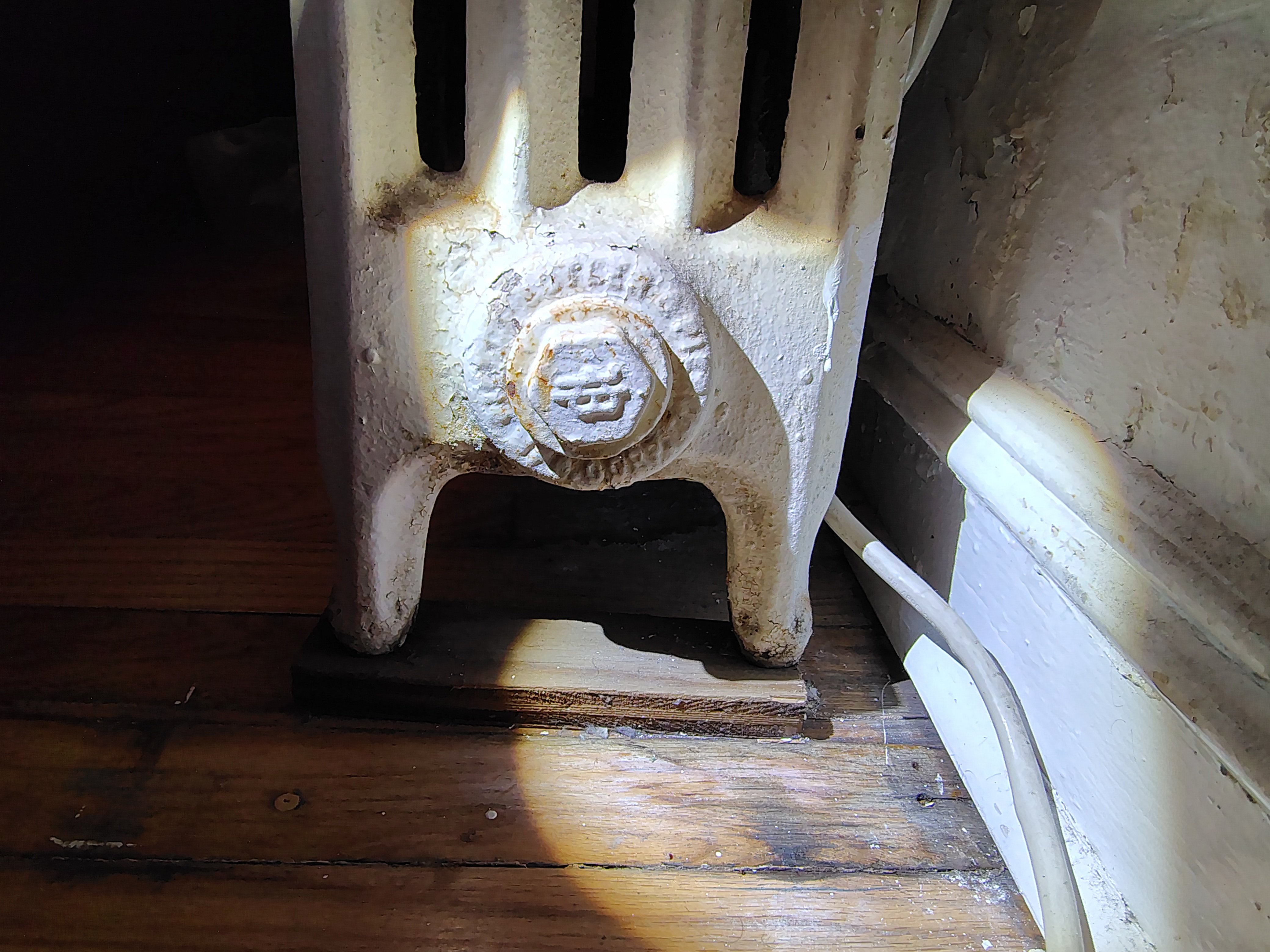

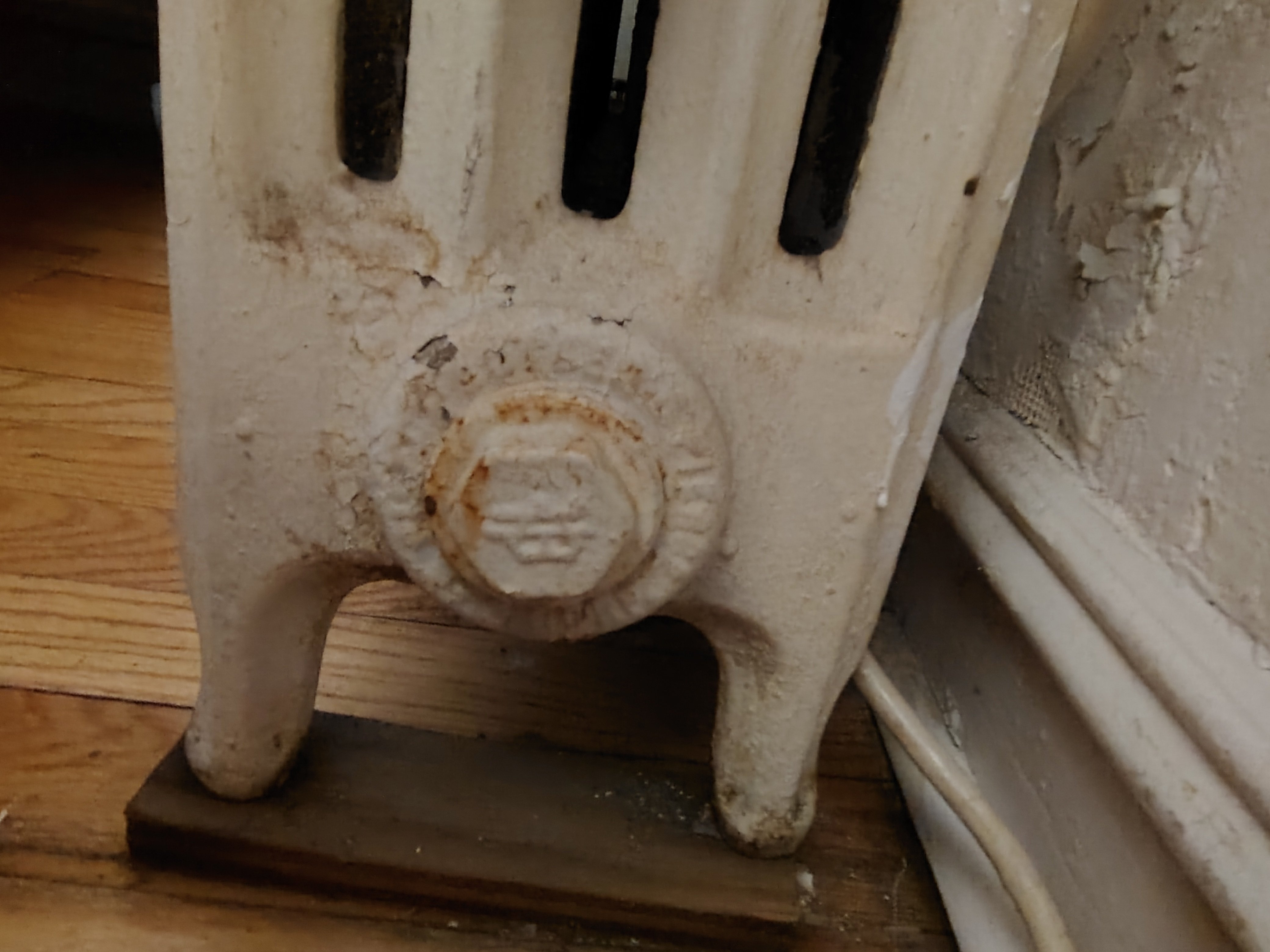

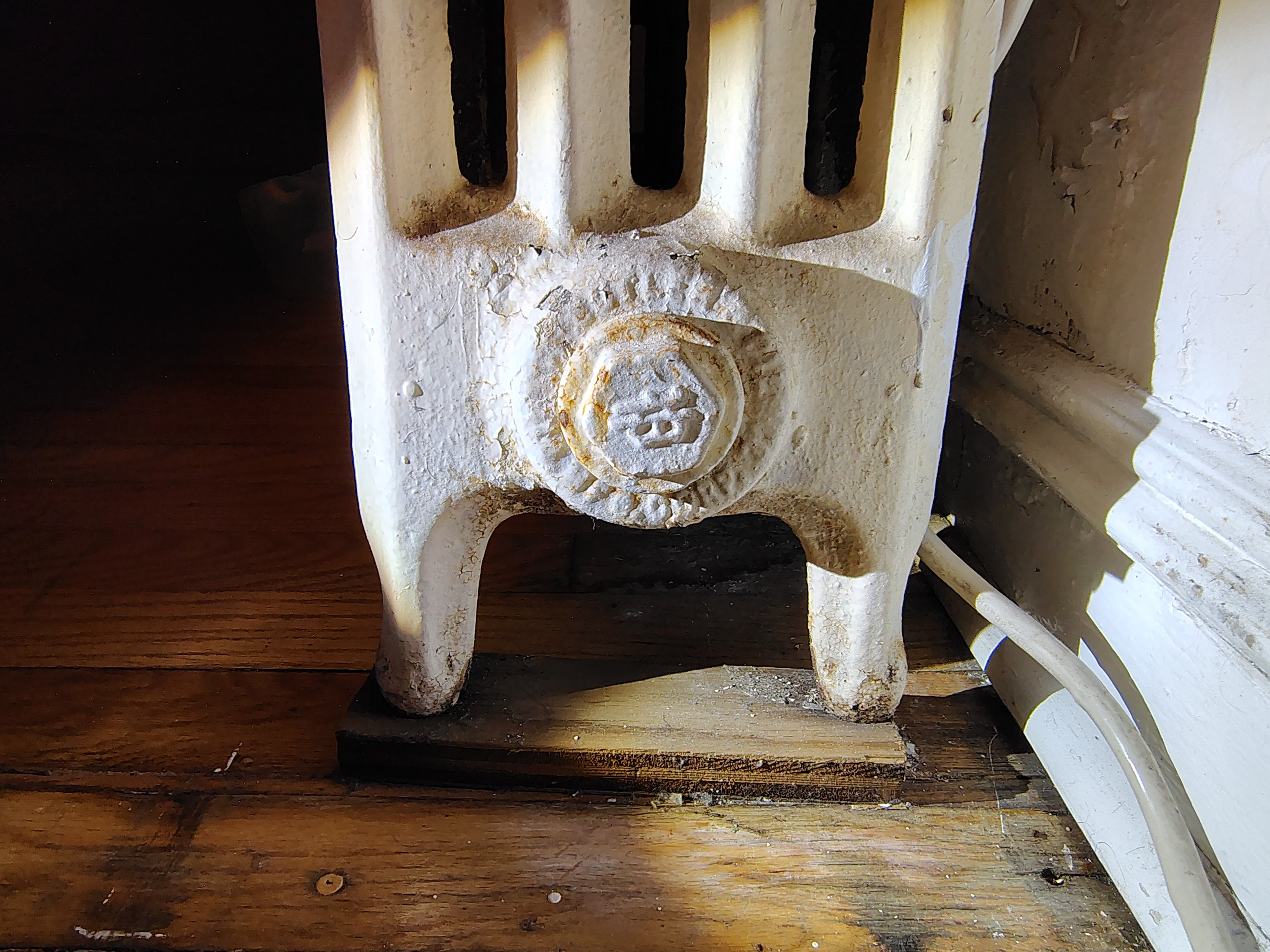

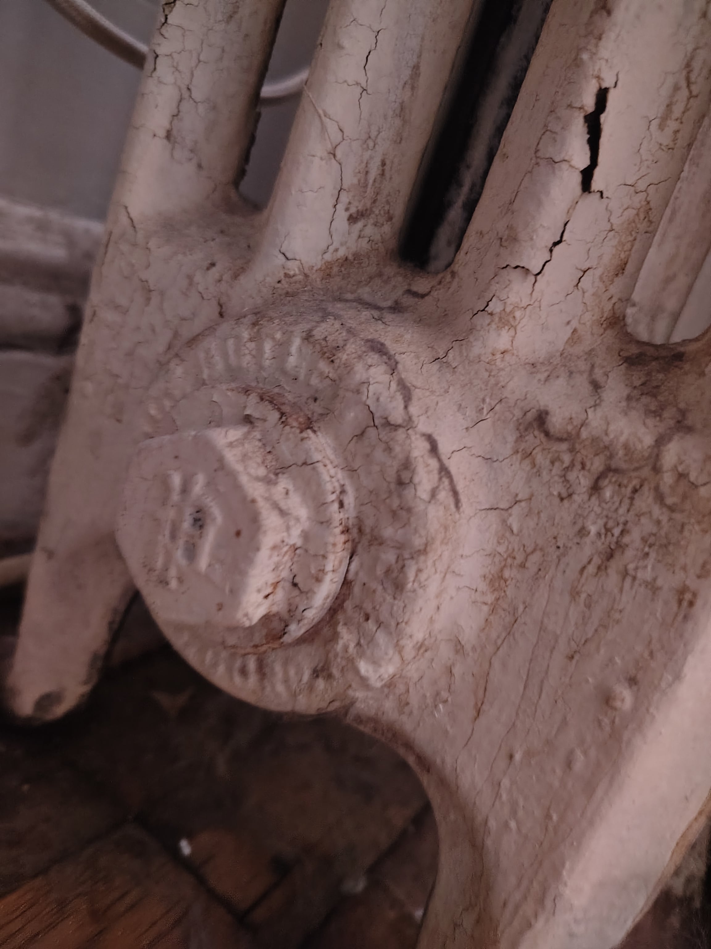

Hi all. New to the game. Purchased EDR but I am struggling to identify my radiator. There is some writing along the sides and the bolts have a mfg logo or insignia.
I've attached pictures.
Please let me know if this is something you're familiar with! Below pictures are radiator details.
IMG_20260526_124527444_HDR.jpg IMG_20260607_030018250_HDR.jpg IMG_20260607_030131966_HDR.jpg IMG_20260607_030145265_HDR.jpg
14 sections. 37" end-end bolt-to-bolt. 34" interior section 1 -14 (no bolts included)
feet 2 3/4" high.
7" deep.
4 tube.
5 3/4" air gaps.
23" total height including legs.
    others will know better than i do but i think this is after they were standardized so you just need a narrow tube with those dimensions and number of tubes, the different manufacturers were the same edr.
    sloomee
    Steamhead Posts: 19,007
    It's an Eastwood, made by Pierce, Butler & Pierce which was based in Syracuse, NY.
    This is true. Any chart for similar rads will work. On page 148 of E.D.R., we see a similar Aero rad made by National Radiator Corp. is rated 35 square feet.

    For better identification, you might want to remove some of those layers of paint down to the bare metal around the lettering. That will give you more information about what it actually says on that cast iron.
    I also agree with @mattmia2 . You can simply find a generic chart with the dimensions of that radiator and use it to determine the EDR of that section.

    I have those identical radiators. Somewhere on this site there is an edr sheet for them but I’ll attach mine. Steamhead is 100% correct

    Interesting- you can clearly see "Pierce, Butler & Pierce" on the rad in the pic, but by the time @TMS1980 's chart was printed, one of the Pierces was gone. Wonder what happened?

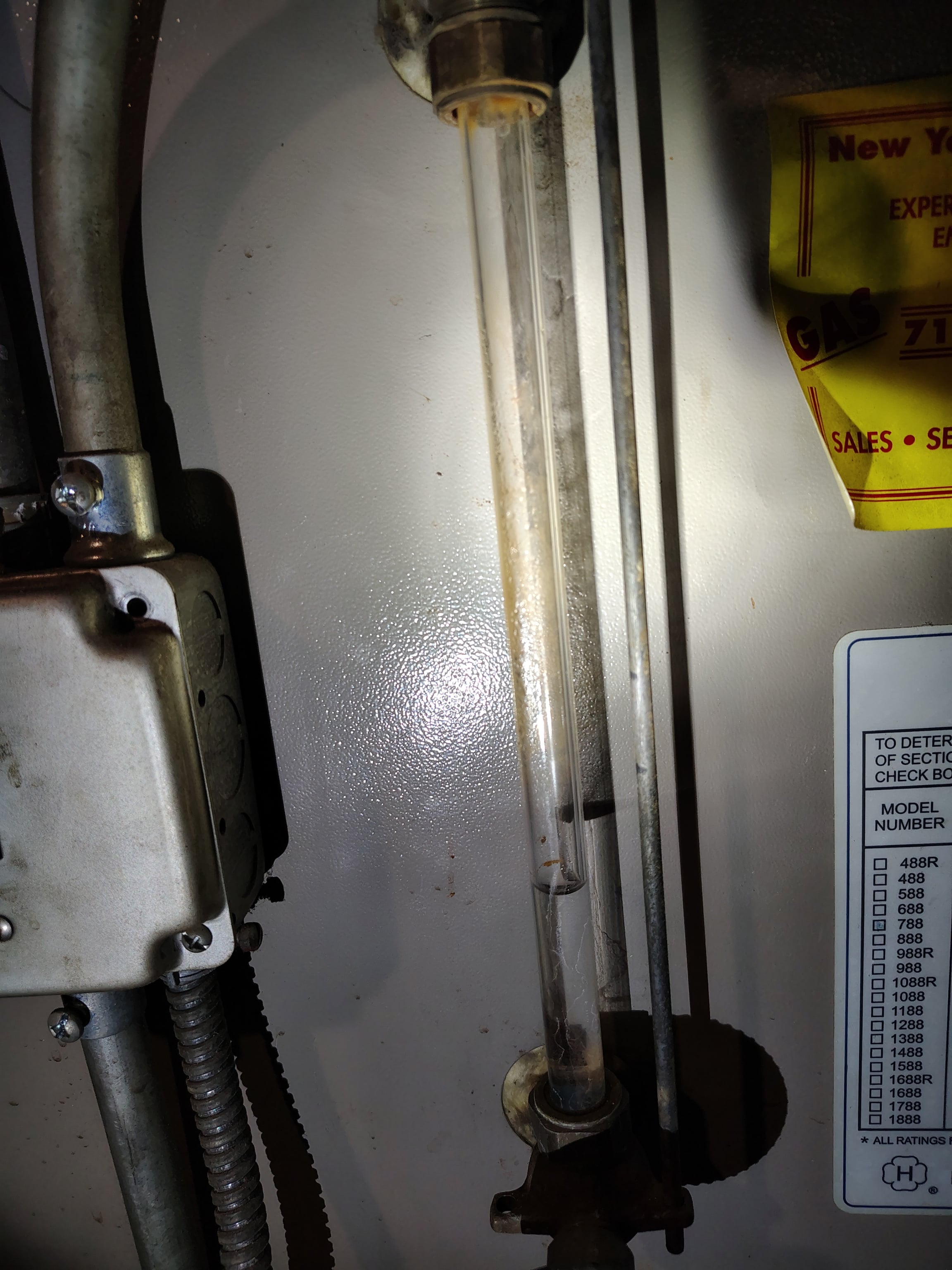

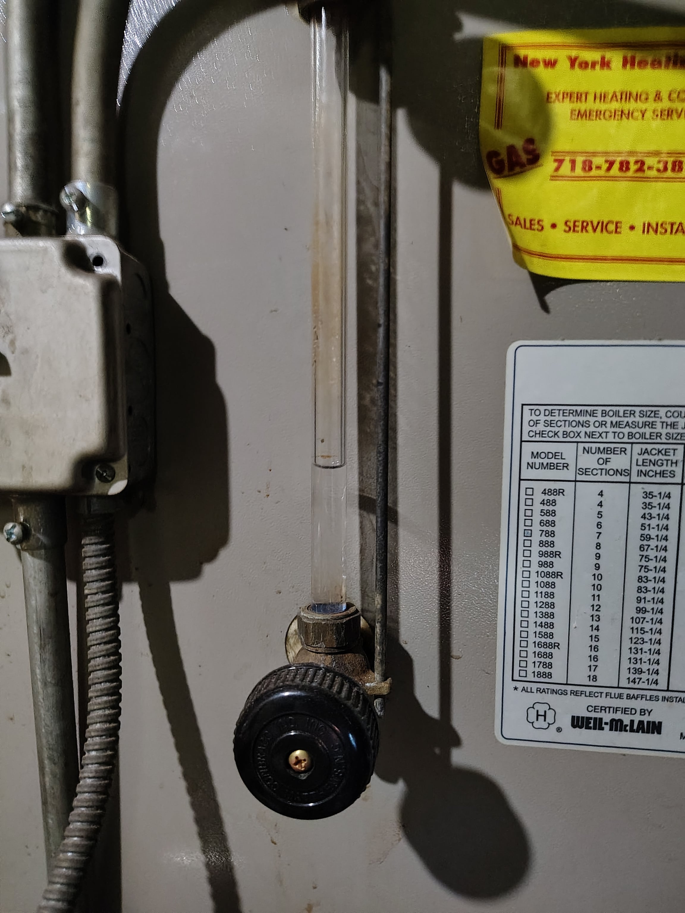

    I looked at the gauge glass, it does look like there's oil in there, but its mostly in the air gap. Attached photos. Is that dirty enough to cause banging? Never worked with steam but built metalworking fluids. This amount of oil might cause foam in a hot sump, maybe.

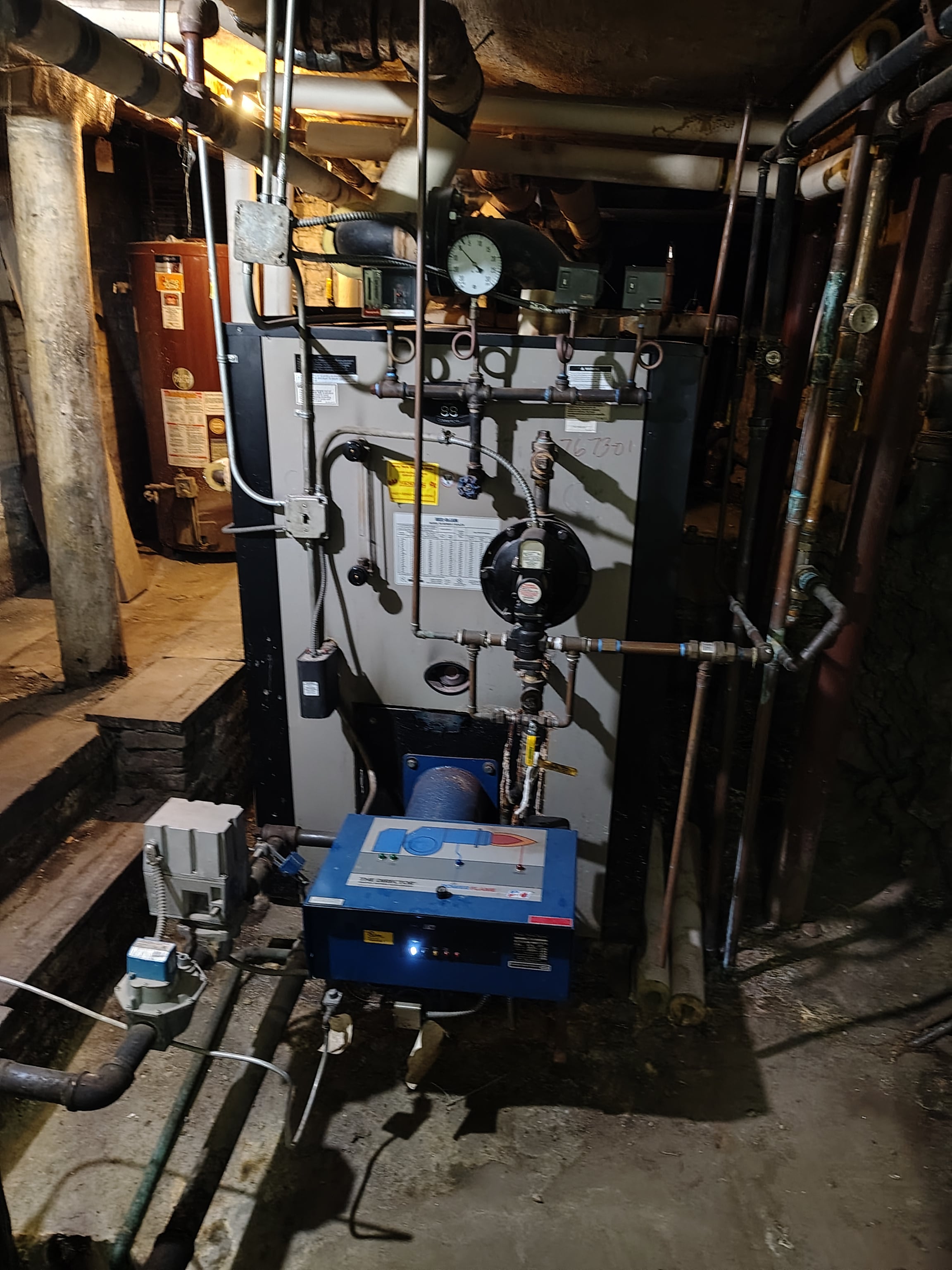

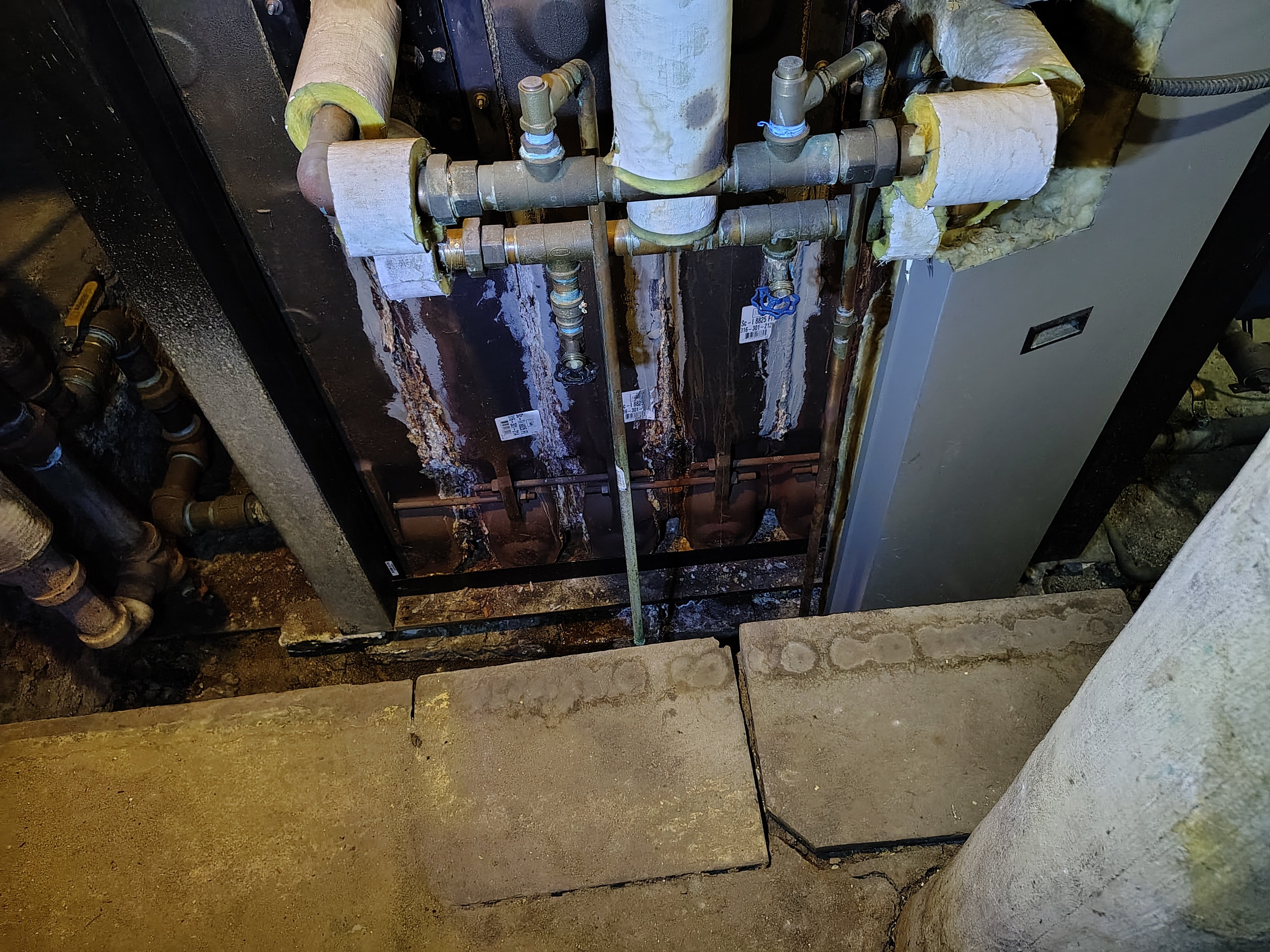

    As far as near boiler piping, it's, it's very extensive. I have some photos but it's a little hard to follow. I'll tee them up after this post.
    IMG_20260611_010755794_HDR.jpg IMG_20260612_043106961_HDR.jpg IMG_20260612_043111658_HDR.jpg IMG_20260611_012012198_HDR.jpg

    I'll get the photos later today. Took a bunch but it's really hard to follow and some didn't turn out.

    The water looks fine in that glass. Not much staining above the water line either. I have seen a lot worse.
    oil doesn't cause it to foam, it interferes with the steam leaving the surface of the water so it leaves violently in big bubbles that carry water with them instead of gently in small bubbles.(surging) if it is foaming that is because of detergent in the water or possibly high ph and some dissolved minerals(priming)
    it looks like that boiler is leaking

    @mattmia2 Is this too much oil in the water of the boiler? Judging by the gauge glass?
    edited June 13
    i don't really see any oil in there. that stain on the glass could be oil or it could just be rust. usually if there is oil you will see it floating on top of the column of water but not always. the test is to look at the gauge glass while it is steaming and see if the level moves or bounces more than an inch or so. if it is moving violently most of the length of the glass or leaves the glass altogether then there is probably a water quality problem.

    Okay guys I have a lot of pics but it's hard to follow, even for me, and I was down there. Some of them didn't turn out great, but mostly there's just a ton going on pipe-wise in this place.
    I can dump the pics, or I can take photos and video of exactly what you want. Is there a preferred way to embed video? An outside hosting site? What exactly would you like to see?

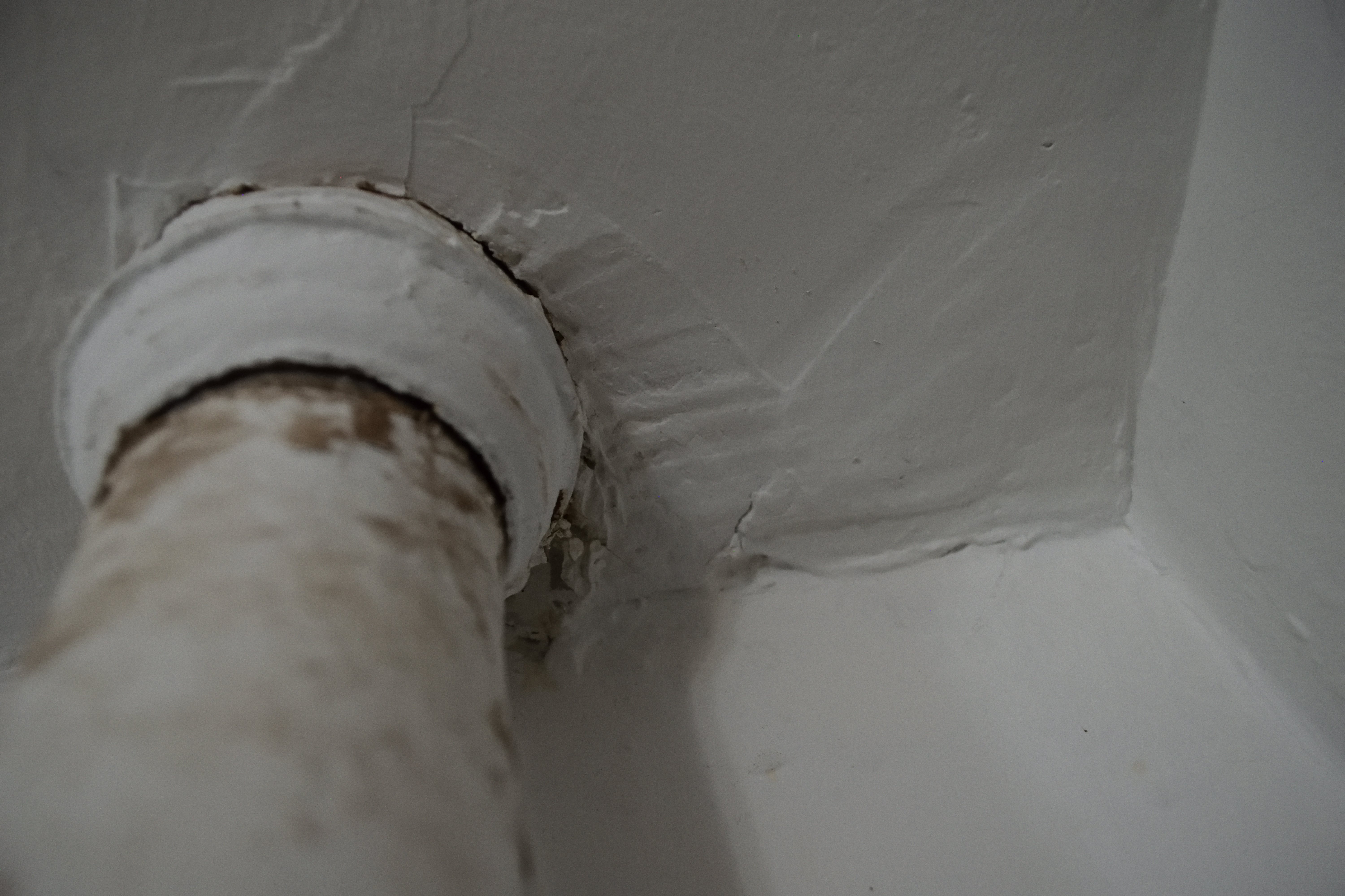

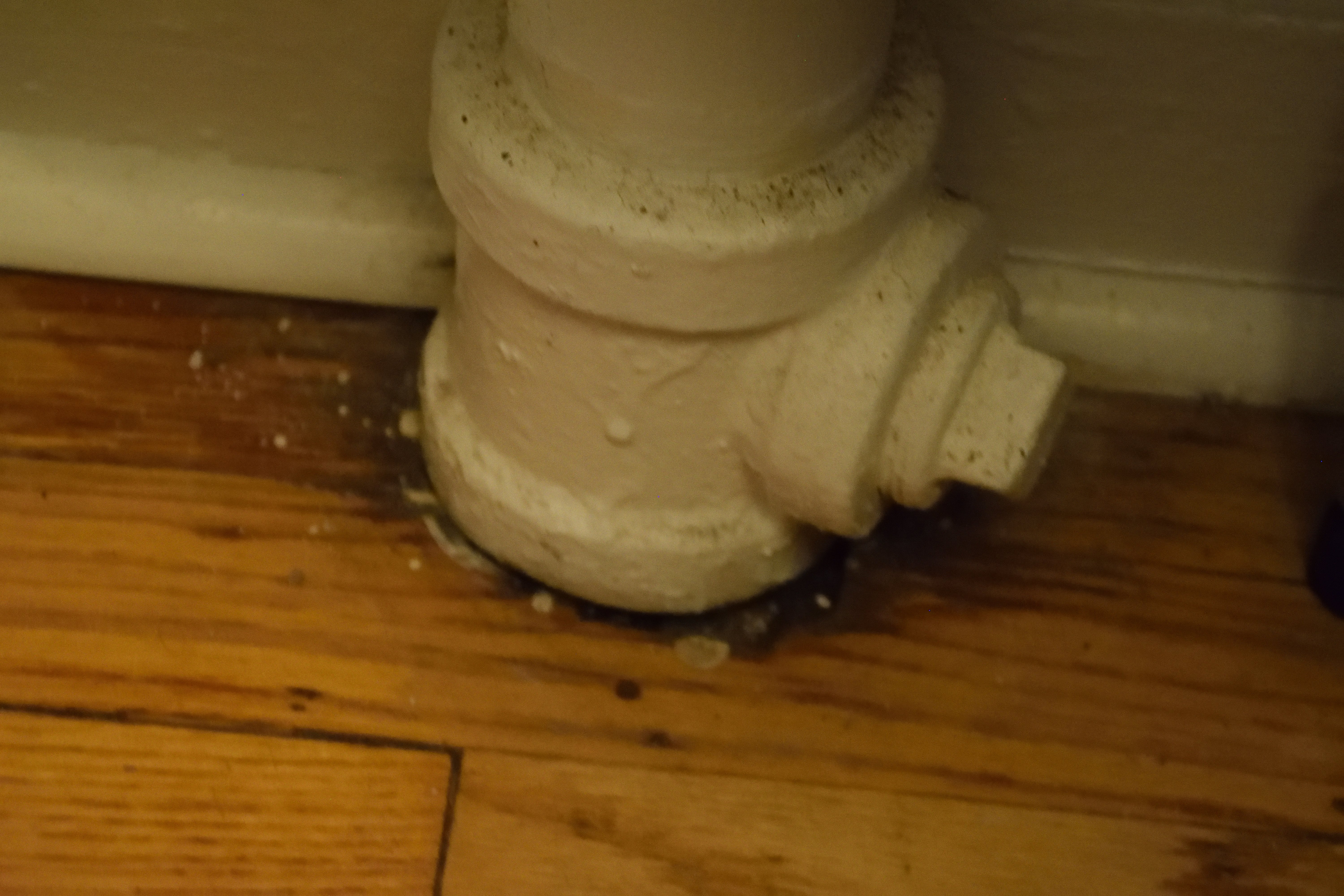

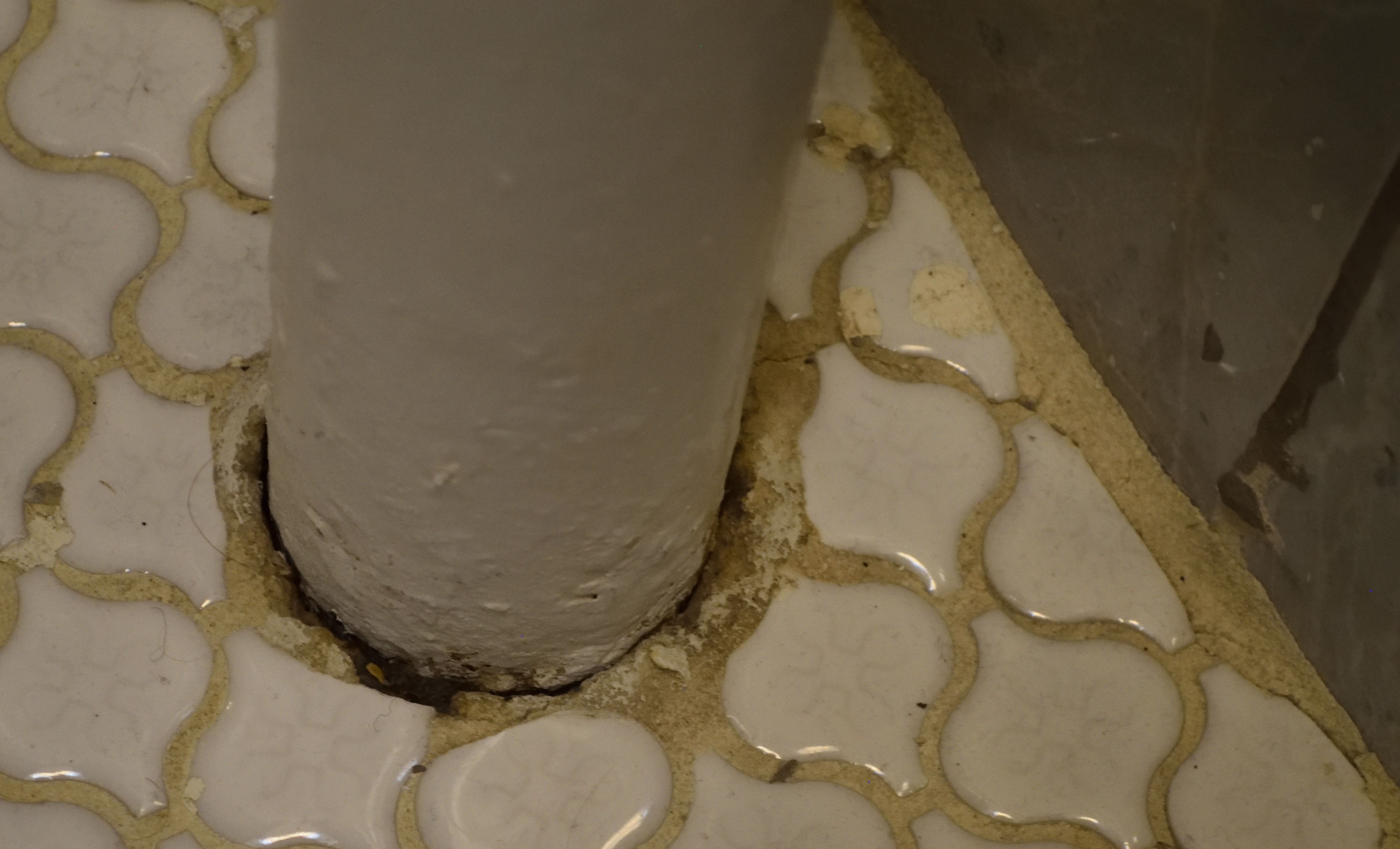

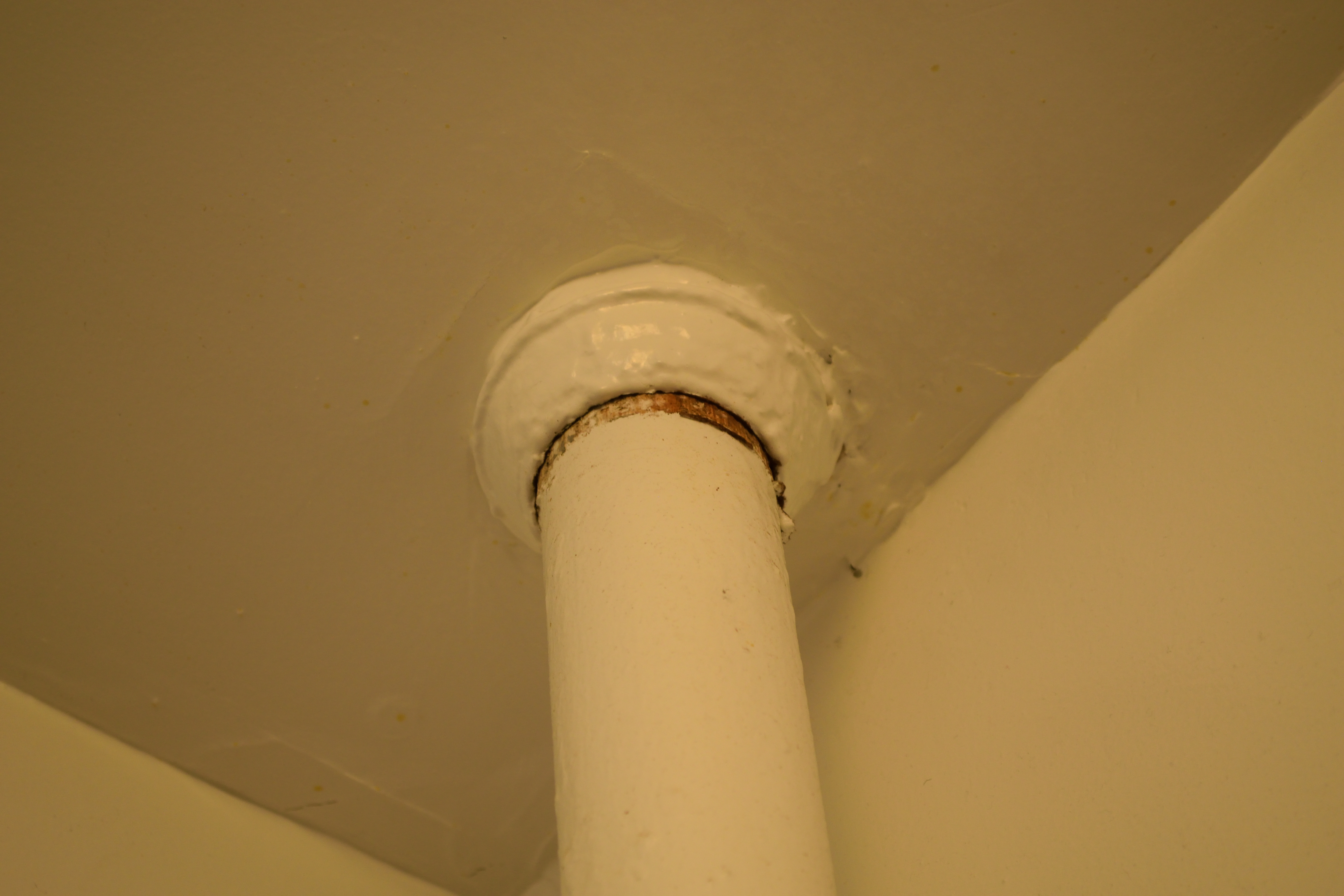

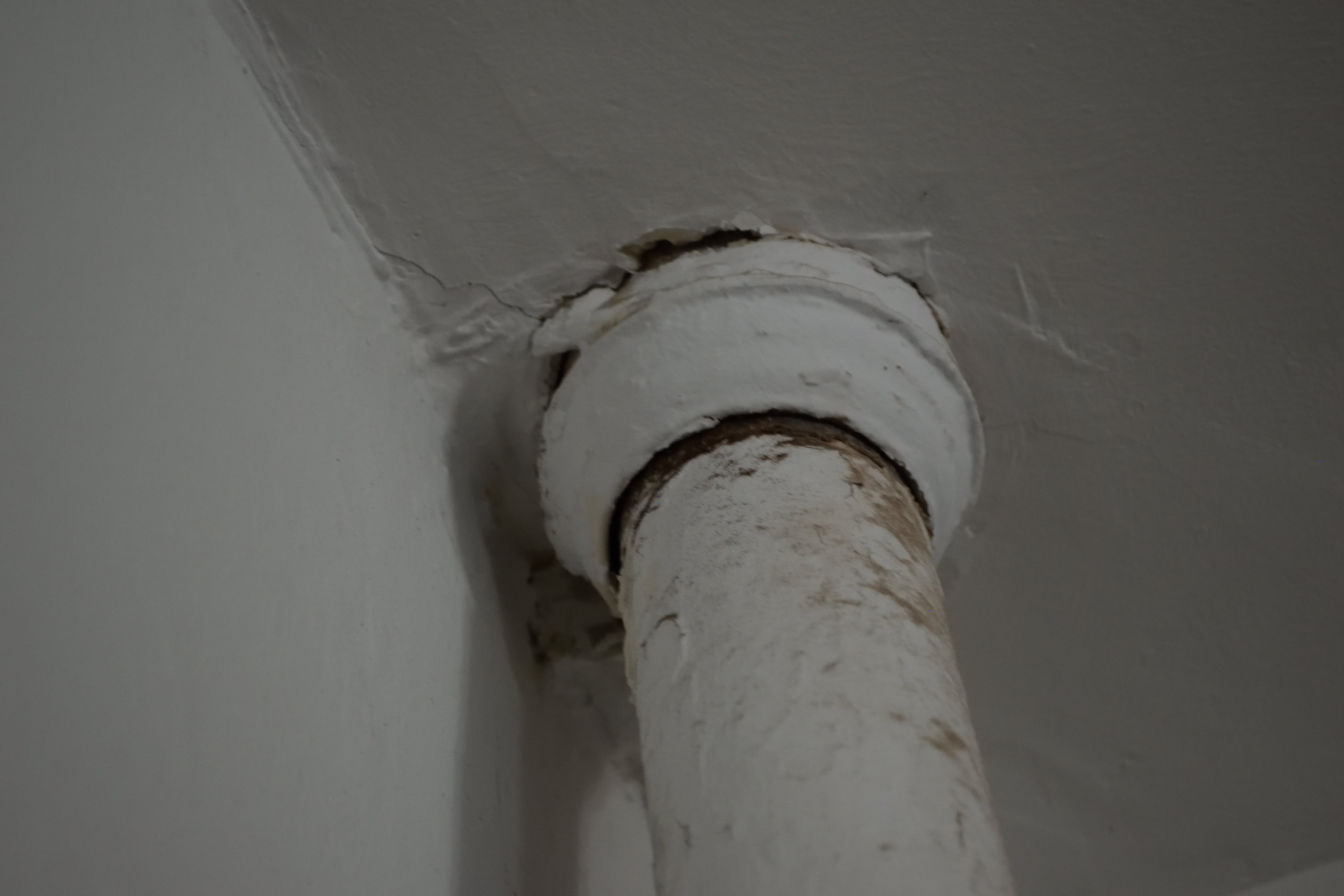

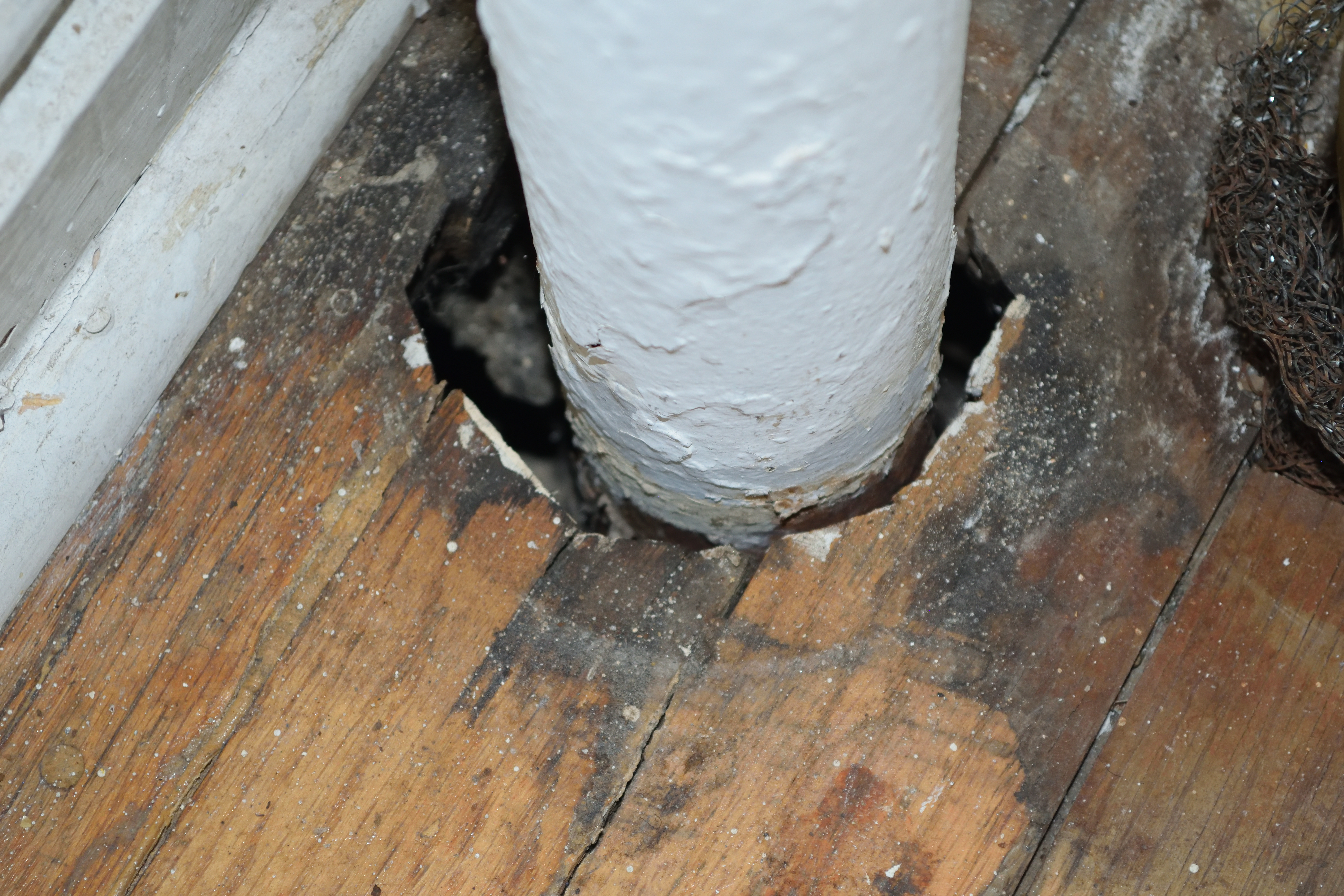

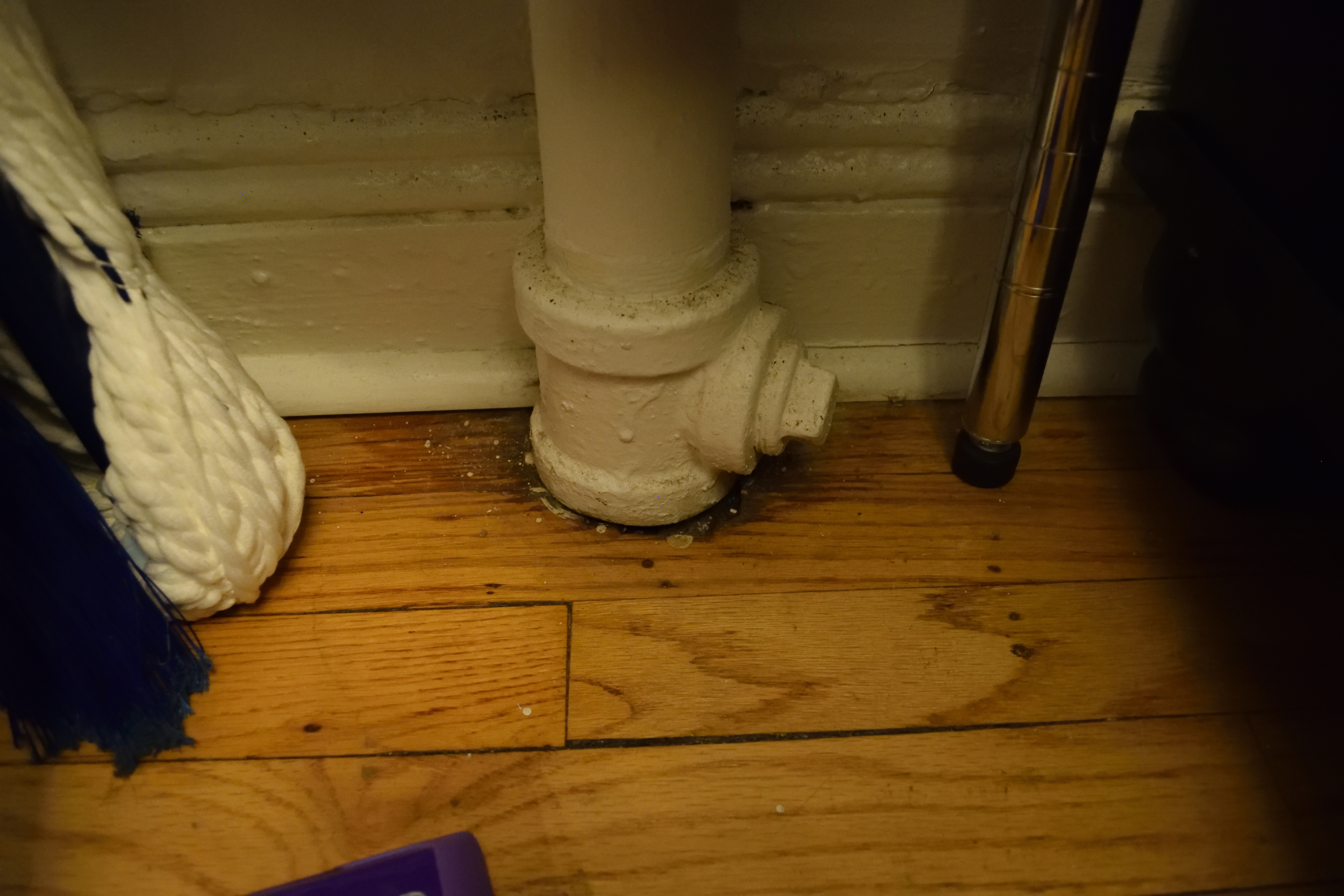

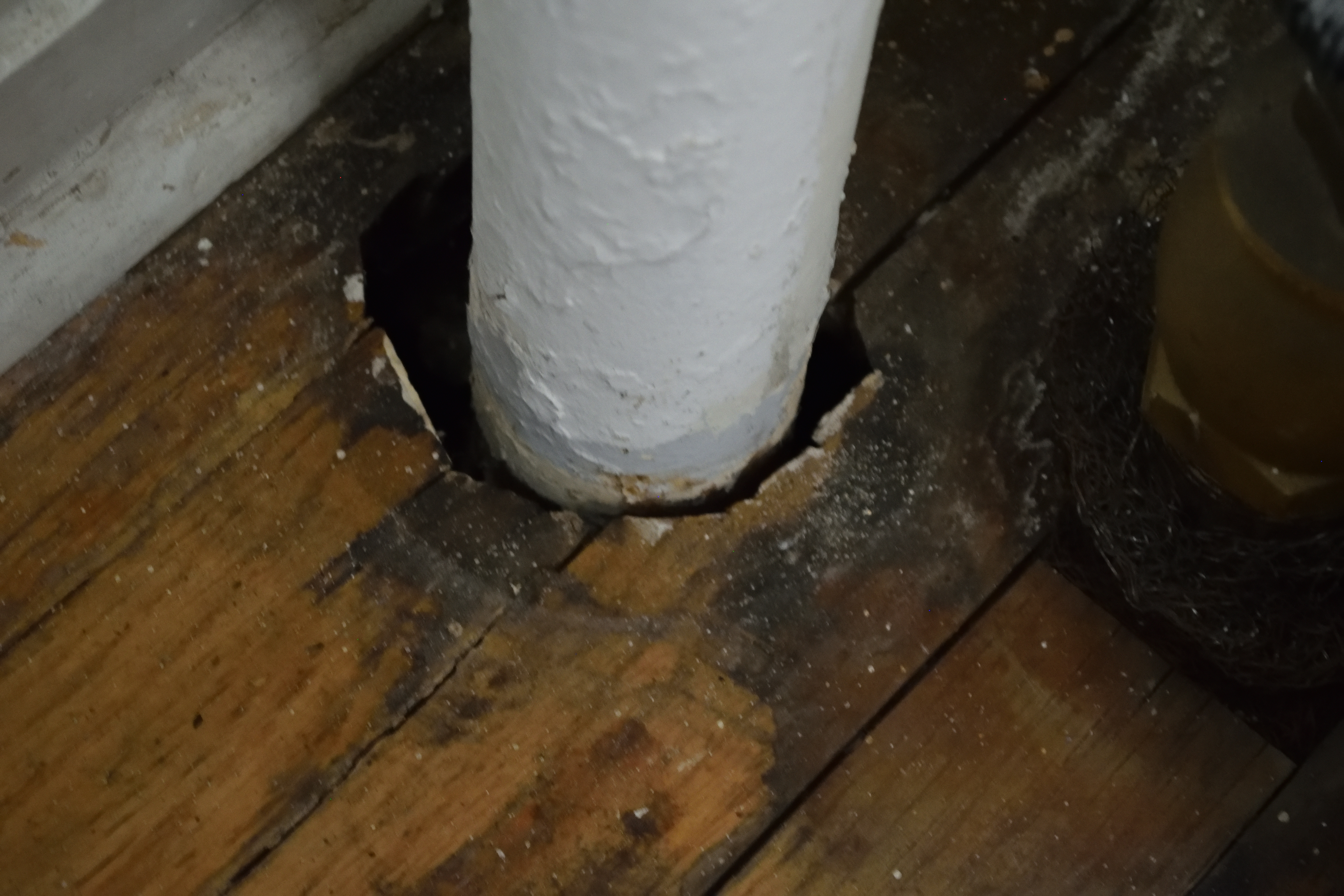

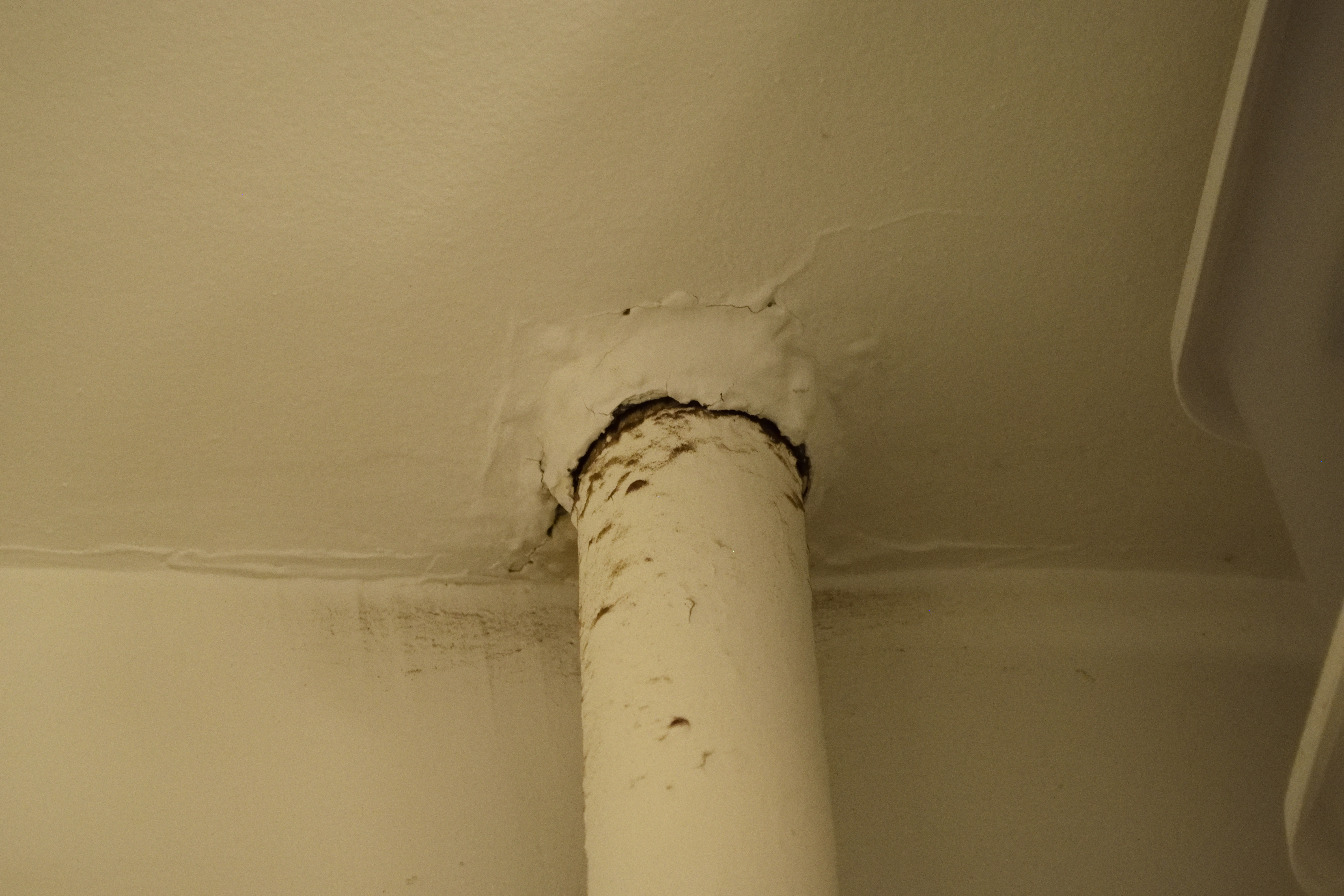

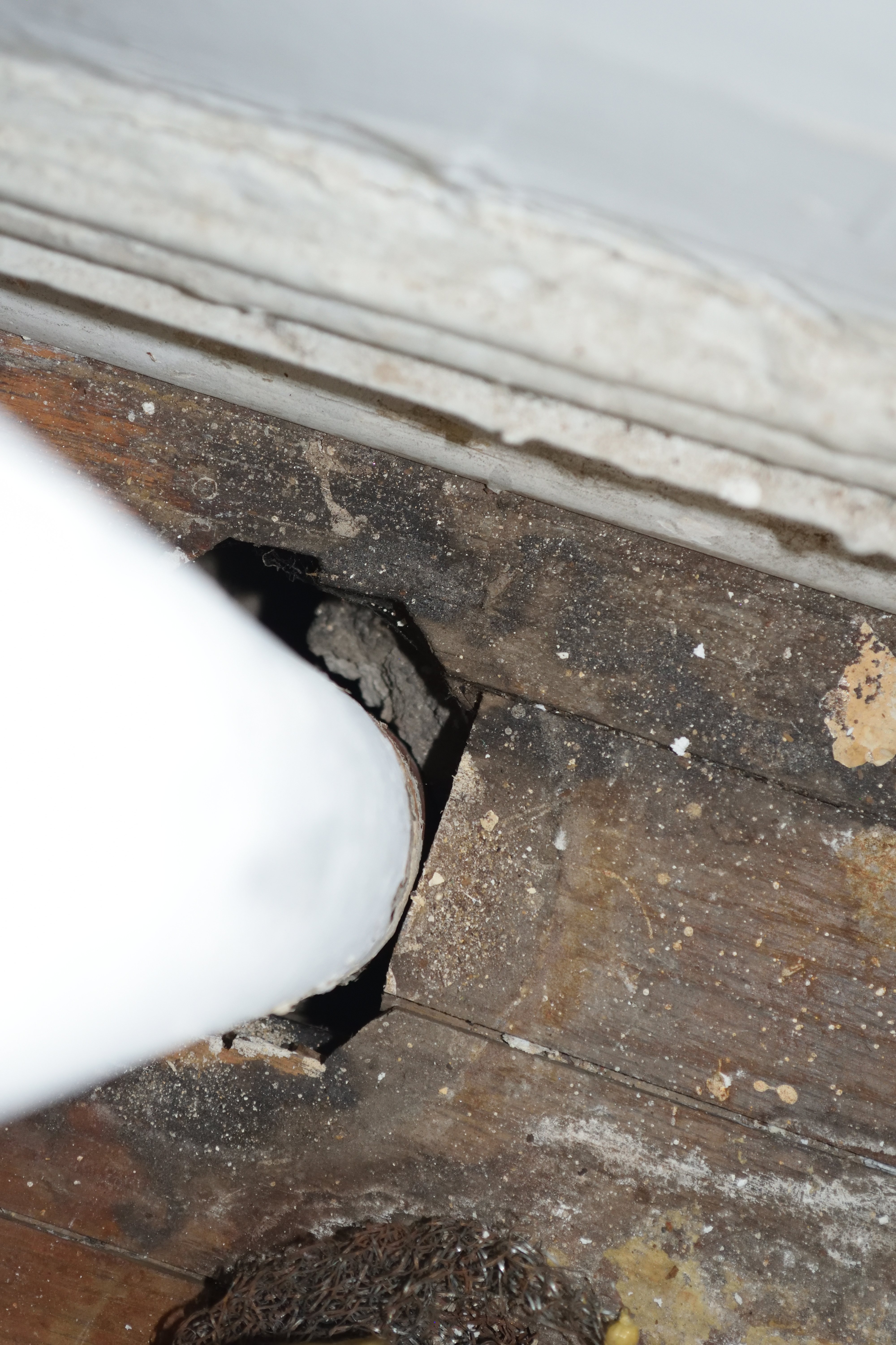

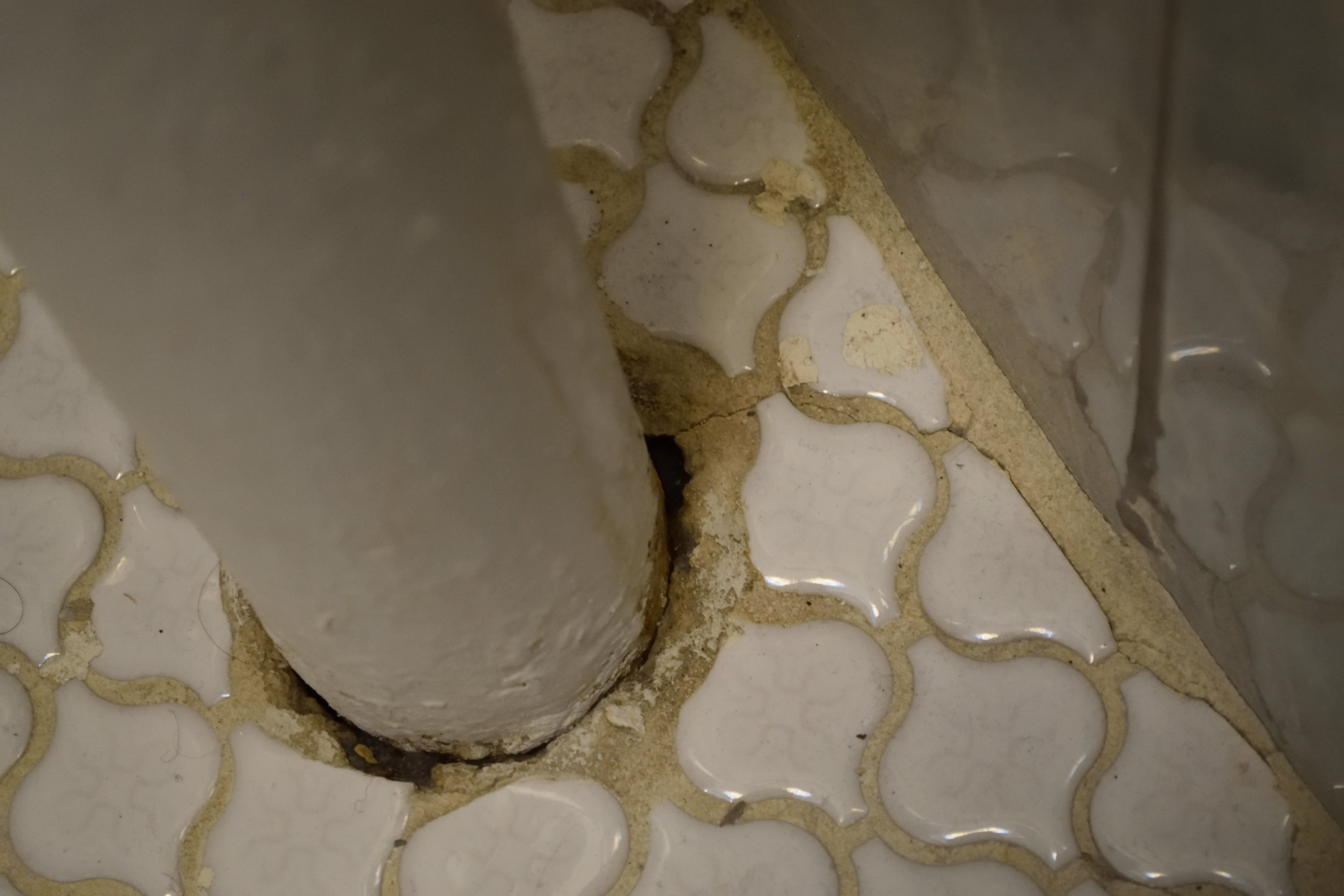

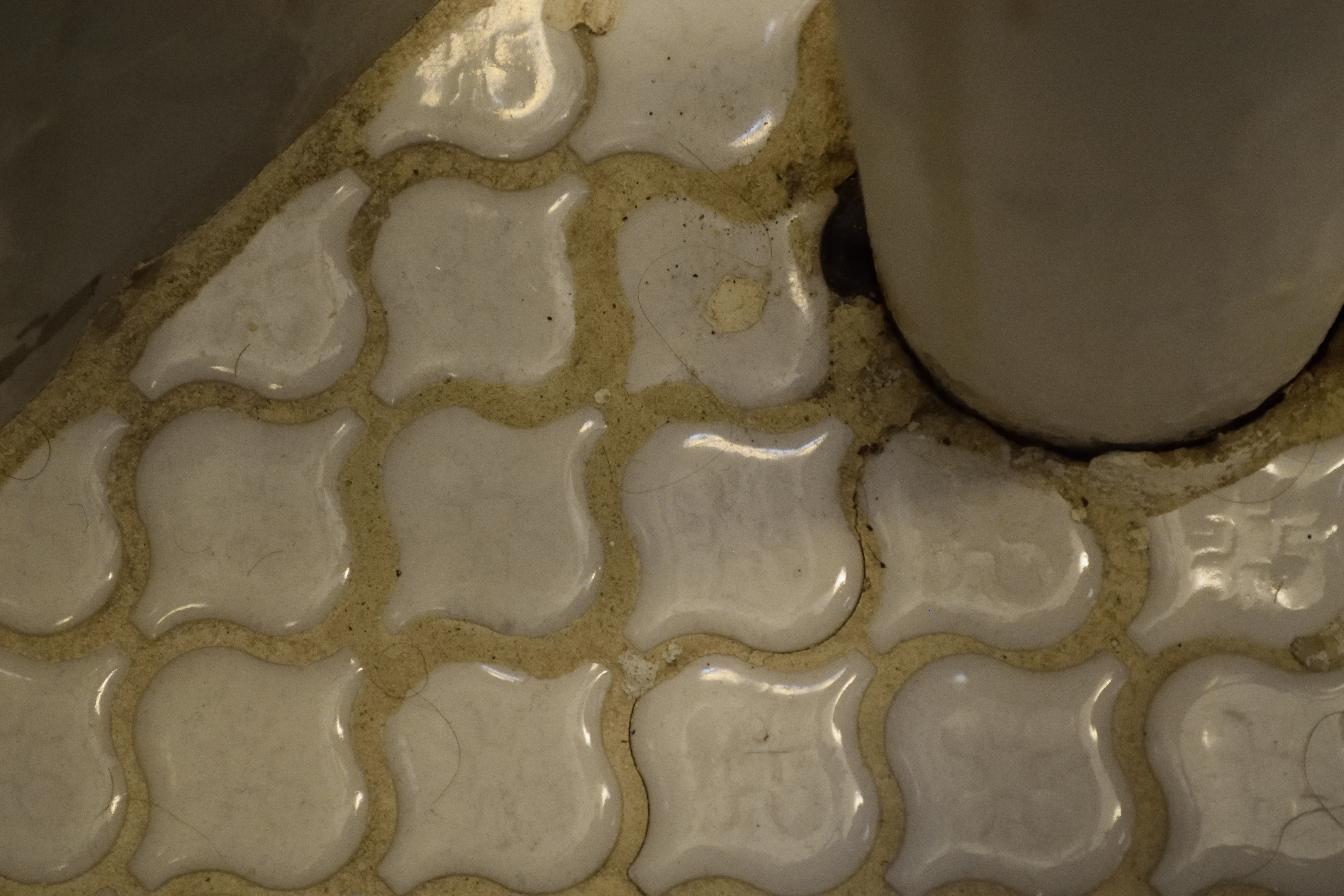

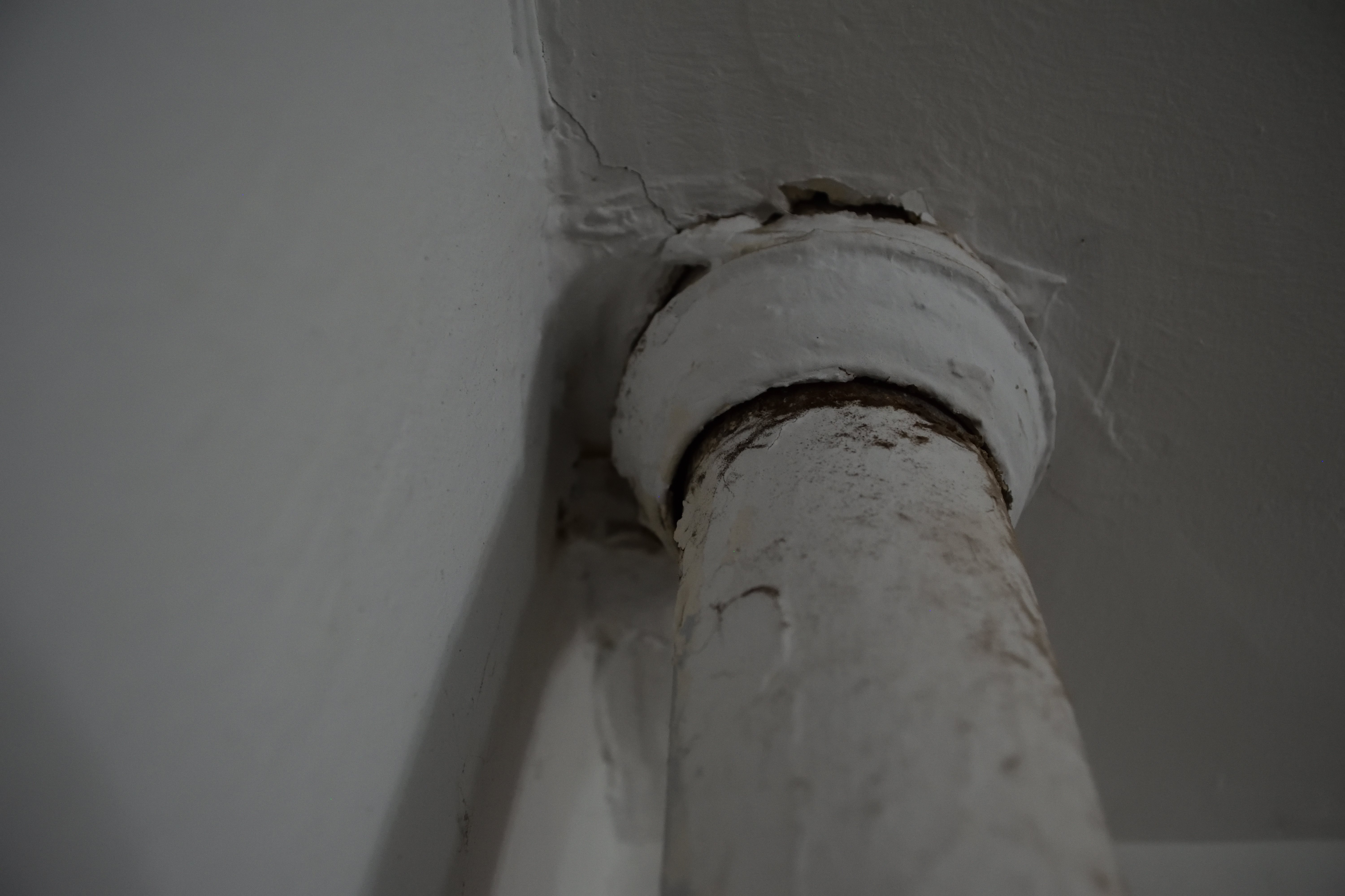

    I've added some photos of the escutcheons in my apartment. You are looking at 3 separate risers, kitchen, bathroom, living room, in that order - top then bottom. I removed the detachable escutcheon on the floor in the bathroom and living room. The thicker rings are on the ceiling in all shots, I'm uncertain if you would call those escutcheons. Apologies for the lower light, flash whited everything out terribly when I used it. Gap is 1-2mm on tile in bathroom. Gap on the first wood floor picture is about 15mm at widest, but some sort of loose wood piece is fitted beneath flooring to close space, probably for bugs, and floor feels flush around rest of riser. Big wood floor gap shot smallest point backside about 1.5mm, smallest gap front is ~4mm. Could banging during pipe heating be caused by what you're seeing here? I recall doing the calculations a year ago and thinking this probably wasn't the cause (at least around the floor) but please weigh in.
    There is a rotund hot water heater hooked up @mattmia2 as you mentioned, that might be what the partial heating was about.
    Ultimately though, I don't think my property manager is going to take my word for what might be going on. I'm located in the Murray Hill area of NYC @pecmsg. Is there someone you would recommend @mattmia2 @EdTheHeaterMan @pecmsg?

    Grallert Posts: 1,237
    It looks to me there has been some settling of those radiators. Judging by the escutcheons at the ceiling. The rust and caulking tells me those reds have settled down likely changing the pitch of the supply runs in the cellar. This would cause hammering if there is enough negative pitch.
    there are several steam experts in nyc. @JohnNY @Mad Dog_2 @EzzyT @clammy to name a few.
    there will be a lot of condensate from those risers and the piping in the basement needs to be designed and still properly pitched to deal with it or that condensate will pool somewhere and collide with stem an you'll get banging.
    what happens at the bottom of those risers in the basement and what happens at the ends of the mains will be important as well as pitch of the mains themselves. there could be takeoffs from those risers in the floors that feed the nearby radiators, the pitch of those will also be important.
