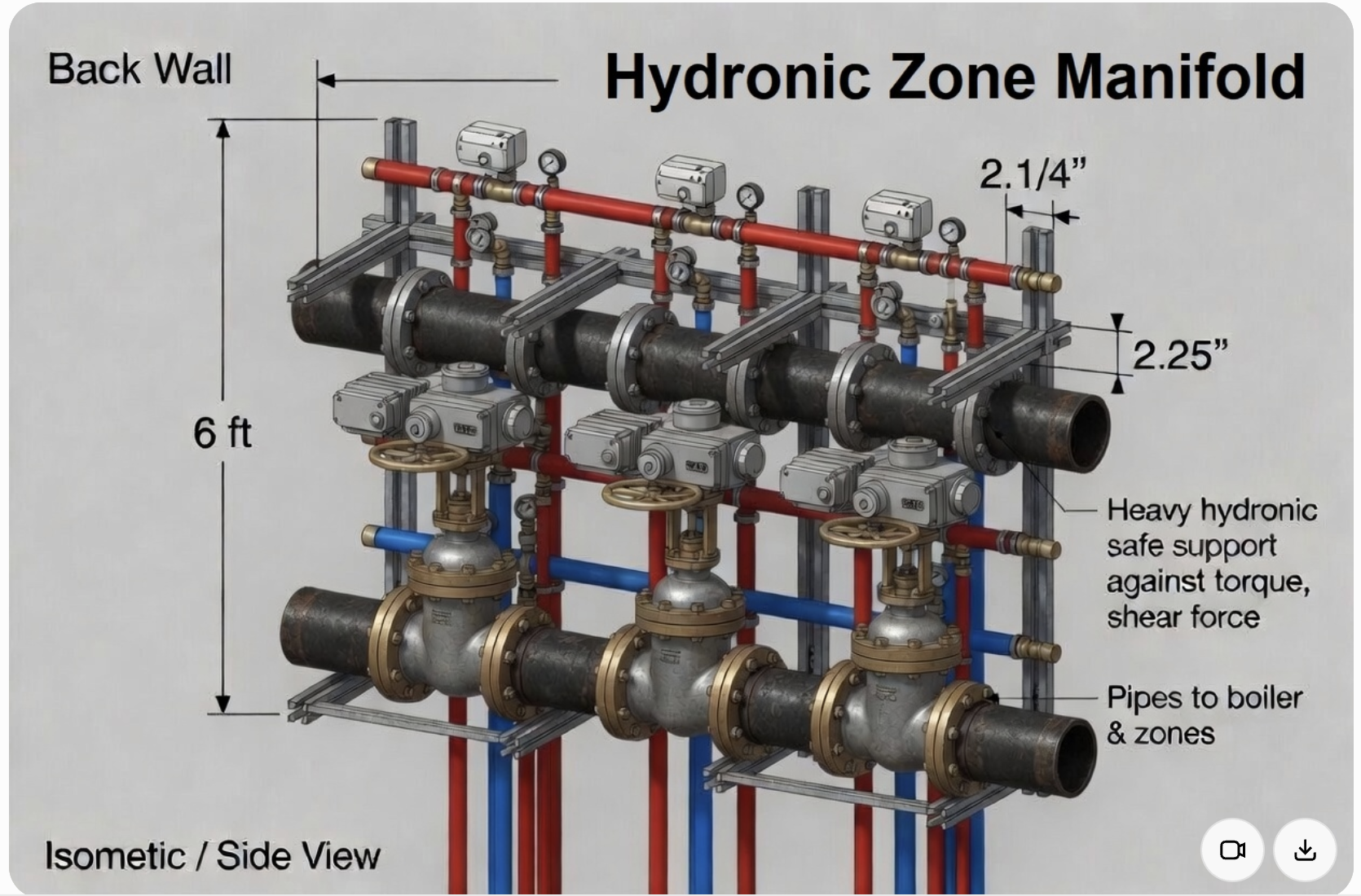

Professionally spacing heavy manifold on Unistrut 2-1/4" off the wall?
Building a heavy hydronic manifold using two 6-foot vertical Unistrut rails and six 40-inch staggered rungs (3 zones).I need to raise the entire Unistrut assembly 2-1/4 inches off the back panel to create a riser chase underneath for the pipe runs.Because of the heavy weight, I am worried about torque and shear force at the spacers.How do professionals achieve this 2-1/4" standoff safely? Any specific bracket part numbers or tricks?Thanks!

    Can you make a simple sketch? What kind of weight are we talking? We do this all the time. Mad Dog

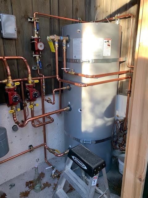

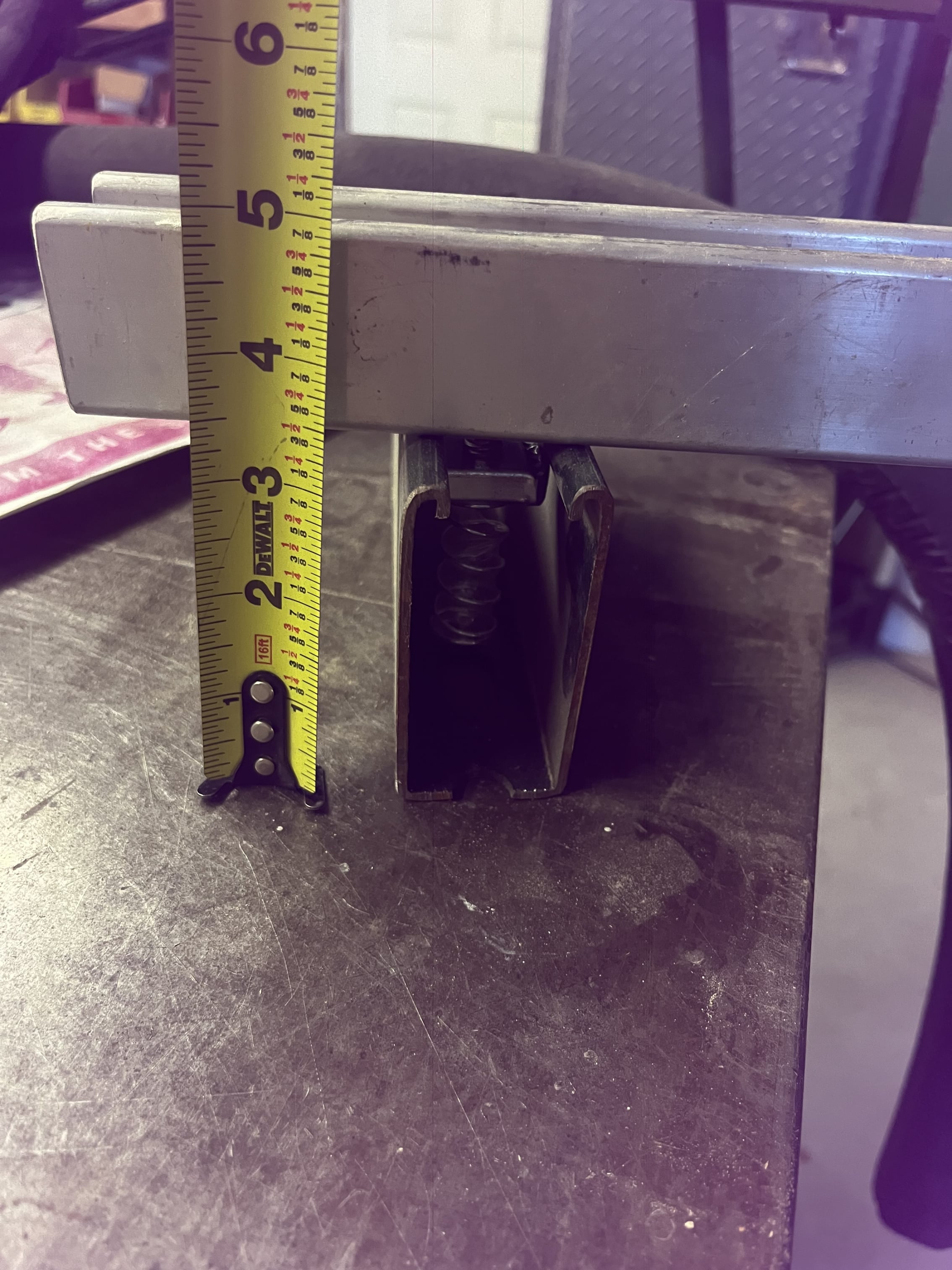

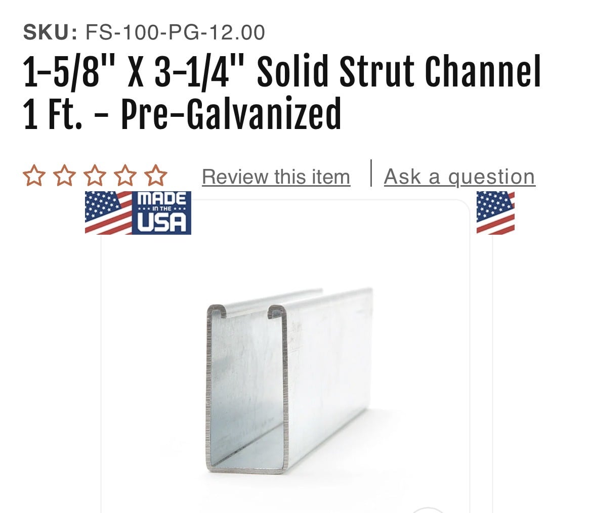

    use deep strut for the verticals and standard or shallow depth for the rungs

    how heavy is heavy? usually you use unistrut in a grid to do something like this. if it has an upper and lower support point the rotational forces on the fasteners don't become significant until you have very heavy loads.
    Strut can take a lot of weight.
    as mentioned above you can buy strut in various depths,
    3/4" (7/8") some mfg
    1 1/2" (1 5/8")
    You can get (2) 1 1/2" struts sold back to back (riveted) or you can bolt (2) 1 1/2" together
    2 1/2 & 3" deep is also old.
    You can look on line for strut catalogs and engineering data.
    The # of attachments and brackets available is endless

    How much weight? Evenly distributed? A shear strength or pull off the wall load?
    You could add some threaded rod and loop hangers from above if it is a front heavy load trying to pull off the wall.

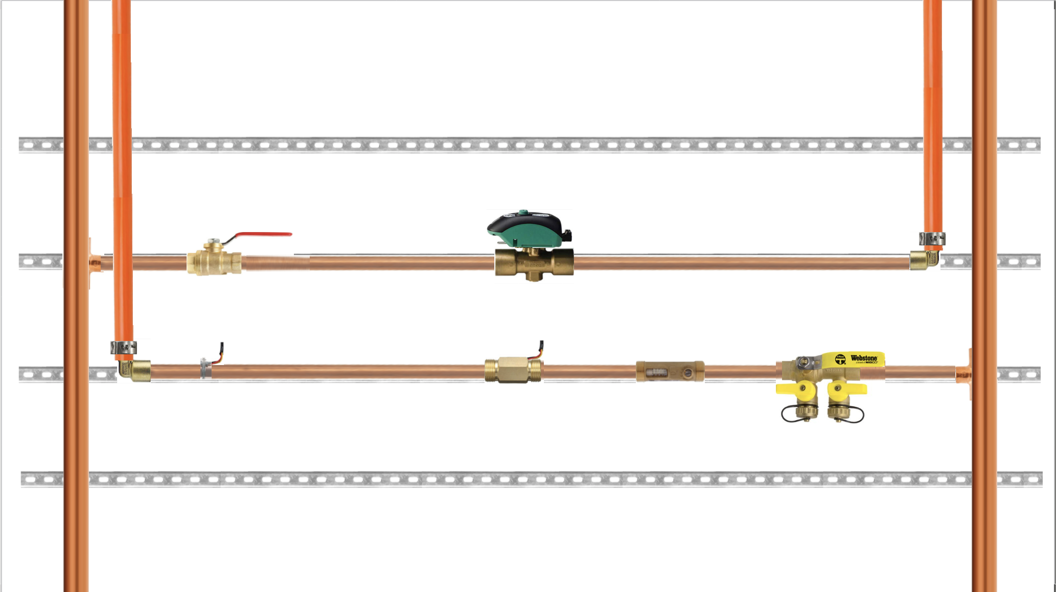

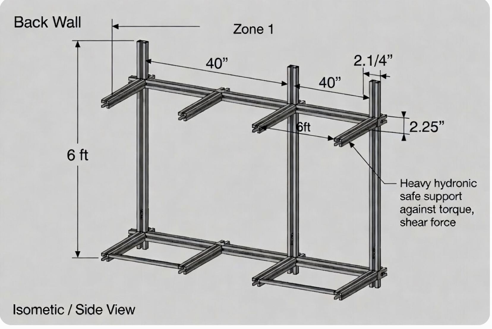

    Based on this description I was able to come up with this diagram of the support system.
    Then I asked the program to place the heavy manifold piping in that support system.
    Does this help?
    It's amazing what "AI" can do for you.
    But I have a feeling that your project looks nothing like this

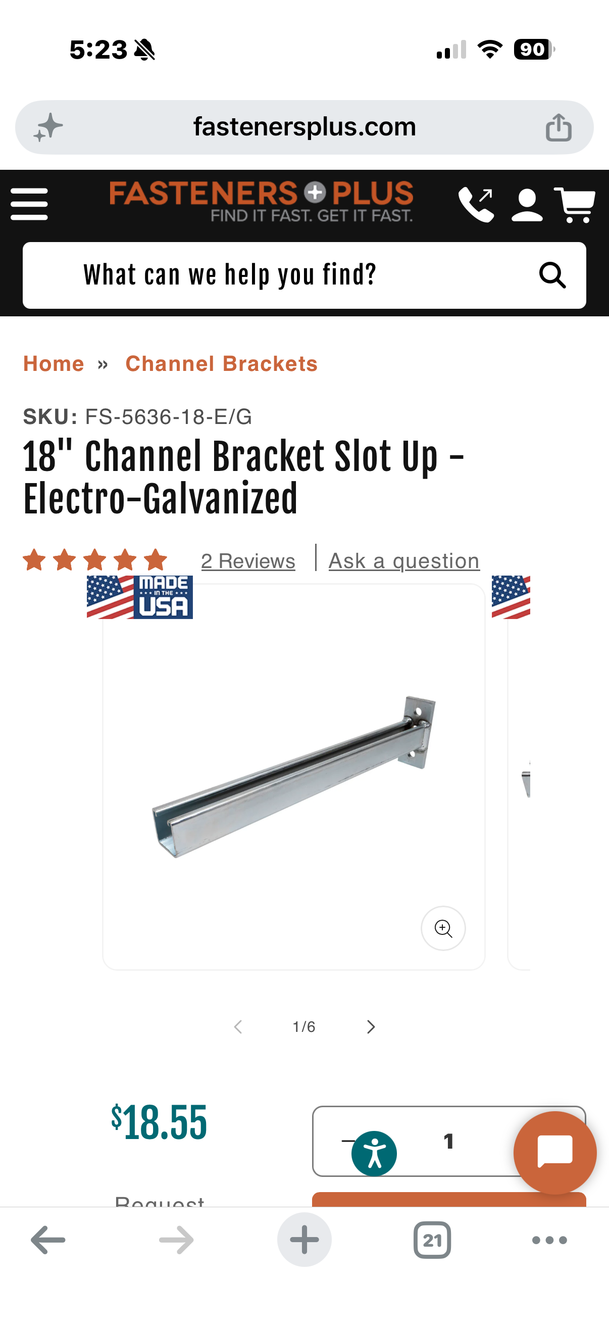

    ⅜" all-thread with wall plates and strut warshers (the big thick square ones) will let you space a piece of strut as far as you want. Split rings give it that finished look.
    There are literally thousands of strut brackets. Whatever shape you want to make, there's a custom fitting for it—but not all are stocked. I ended up ordering on the internetz for some oddball brackets I needed for the last job, much cheaper and faster than getting my local guy to bring them in for me.

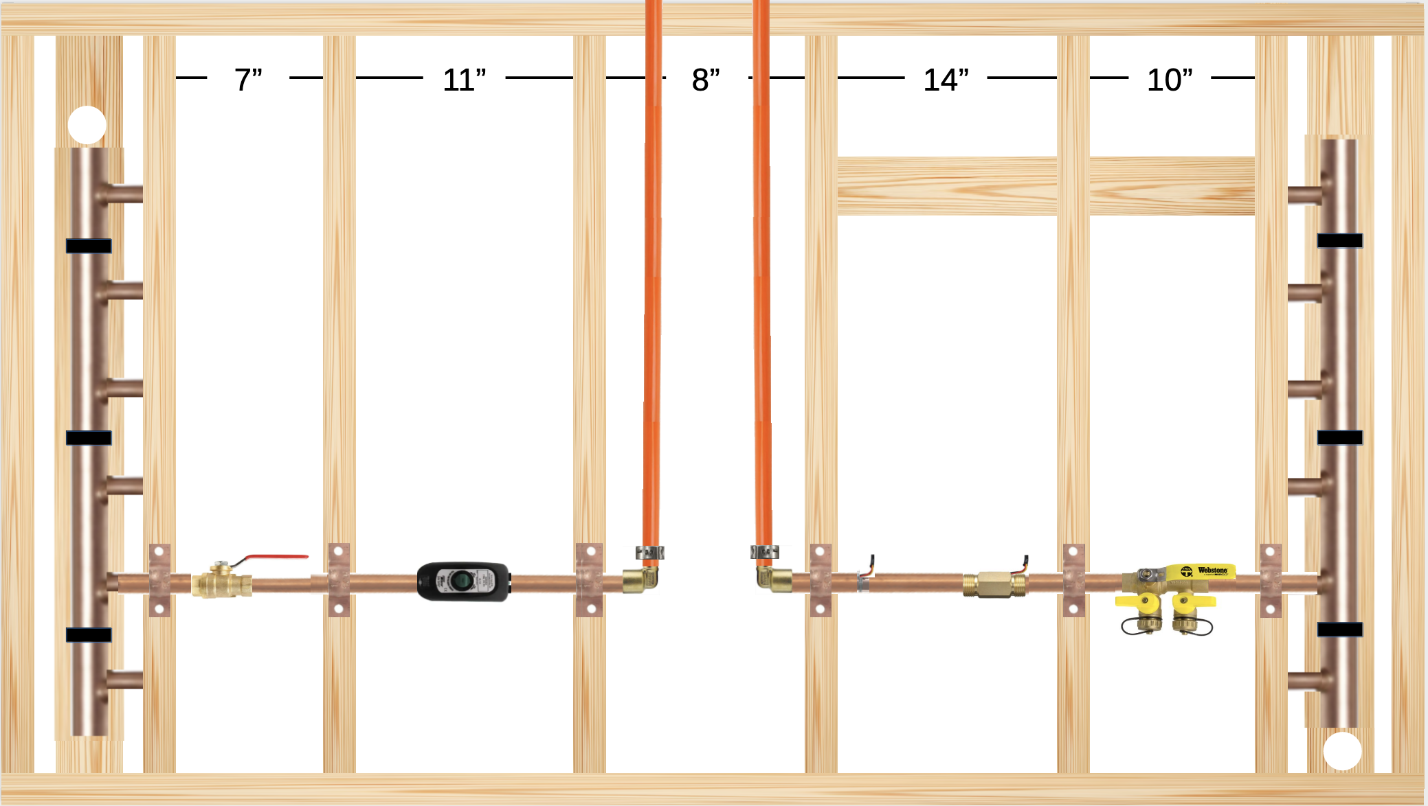

    After I posted this I (temporarily?) went back to my earlier plan of supporting the manifold on studs and doing away with the back board. I modified it to create a wider wall (from 4' to 6') so zone rungs don't need to be staggered. Now the rails are half as heavy and I don't need to cap every other one. As I might have compelling reasons to go back to using a back board, I'll show both designs.
    The above design shows the problem I posted about. Note that I'd like to have Unistrut on the backboard, but then I'd want the PEX risers to route under them. That's the rub (no pun intended). Some comments recommend a deeper Unistrut channel, but I know they exist. They don't however allow me to route PEX underneath.
    Forgive my unprofessional use of the word "heavy". It's obviously not that heavy, Just heavy enough to need to learn what the proper fittings are. Otherwise I won't like the amount of torque on the fasteners if I have to mount a distance away from the back board.
    So here is an image of a
    detailed plan to mount directly onto bare studs, showing the entire frame 6' wide and 4' in height. You can see both rails and the zone rung of one of the six zones. This provides an elegant chase for the PEX pipes. Perhaps mounting on studs is now considered "old-fashioned", but I like this design. It's still not resolved what I should use for straps. I would like 2-hole copper straps for robustness, even though they're not as good for serviceability.
    I still don't know what is the best way to mount the rails. My latest idea is a flat stud mounted behind each rail so I can attach clamps, but am not familiar enough with these kinds of clamps. I know of course I need to keep one tight on each rail and the two others should be loose enough to allow pipe expansion and contraction.

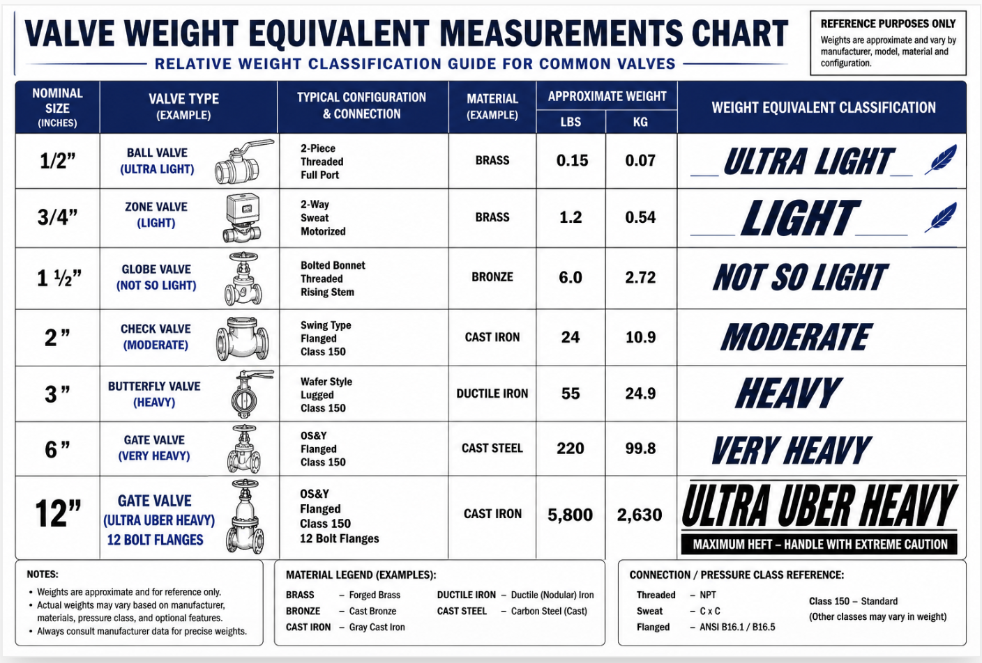

    To make this easier in the future I have included this professional chart for reference when describing weight to us professionals on heatinghelp.com

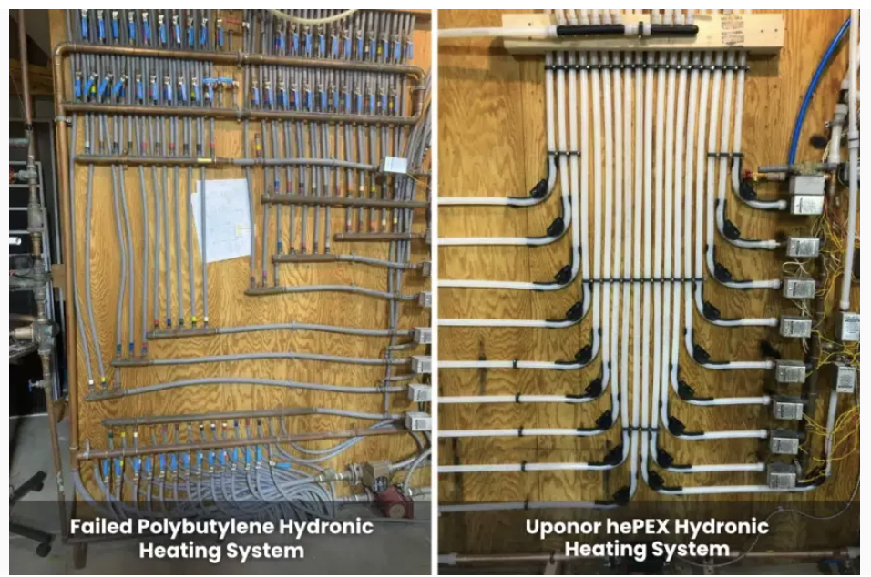

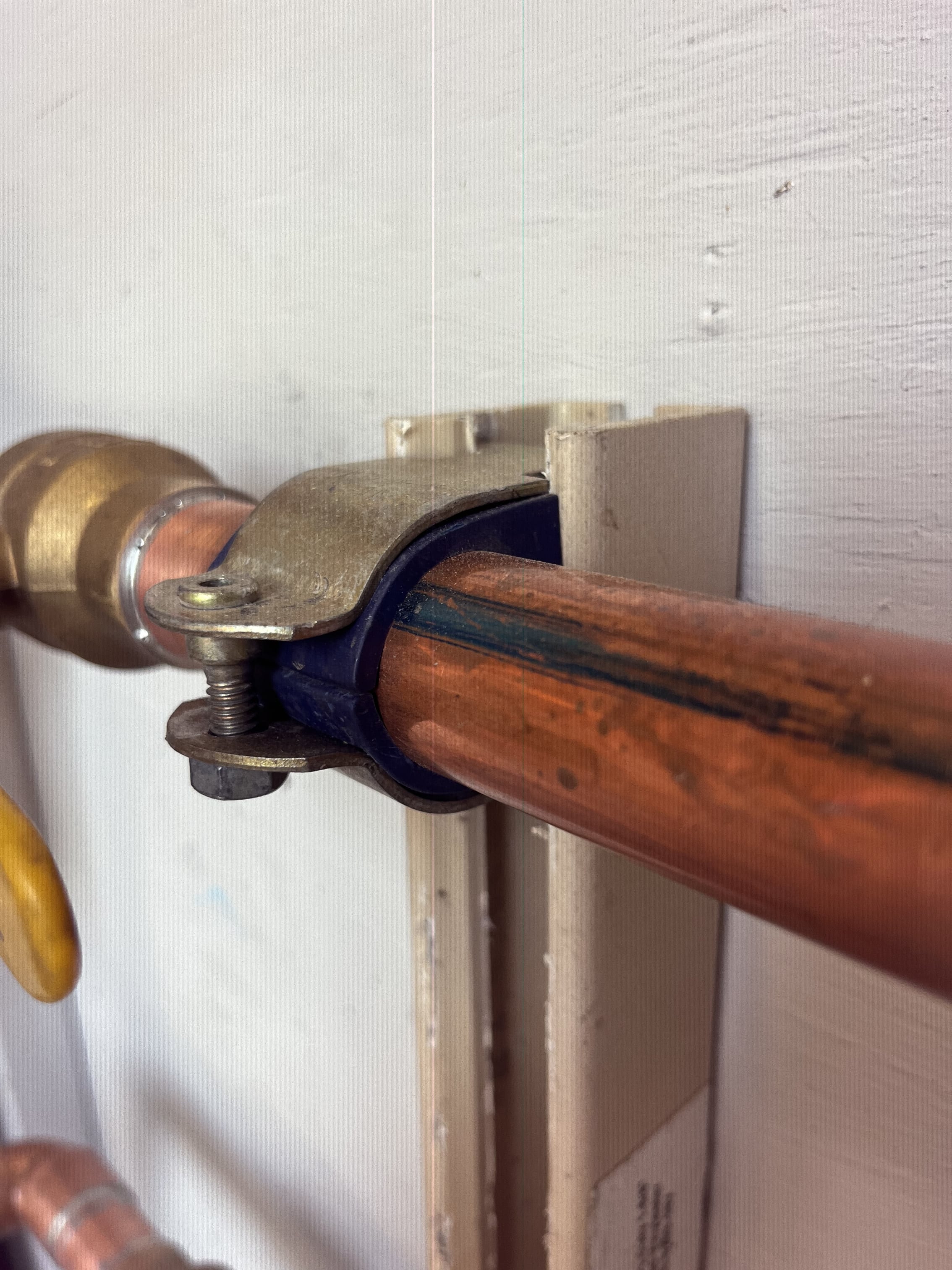

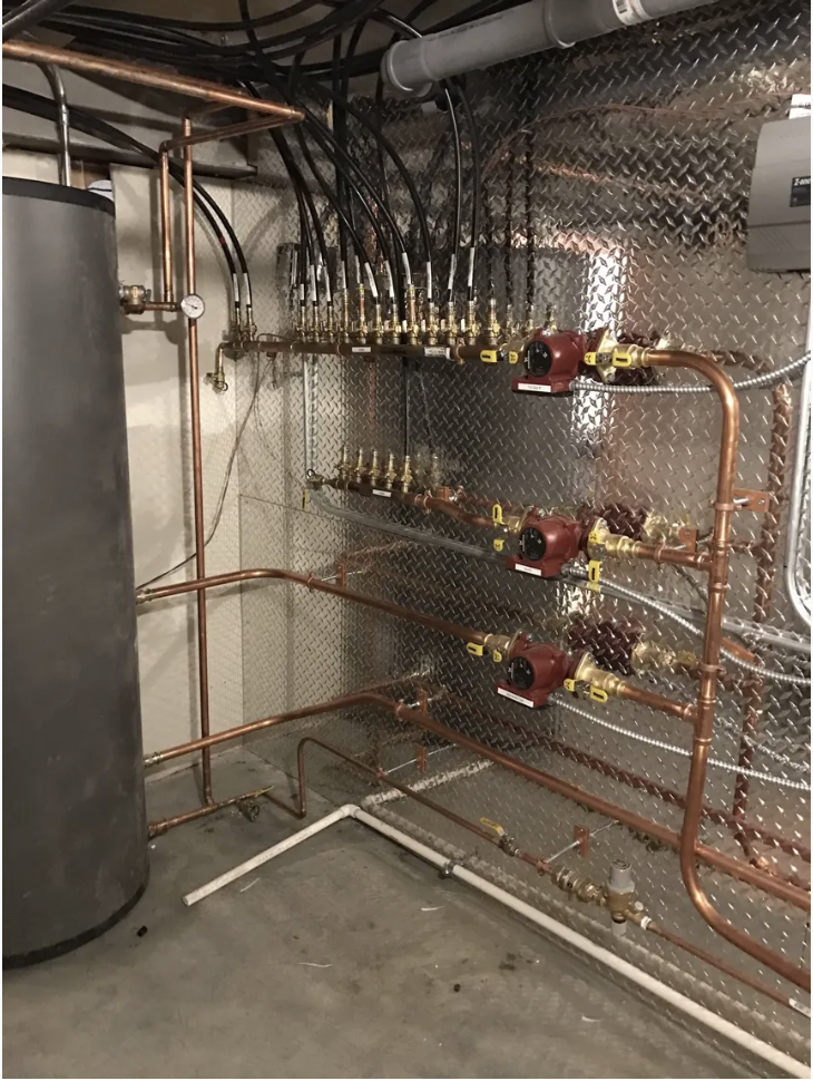

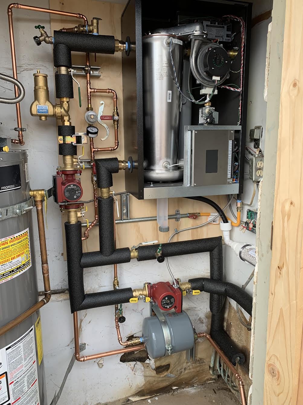

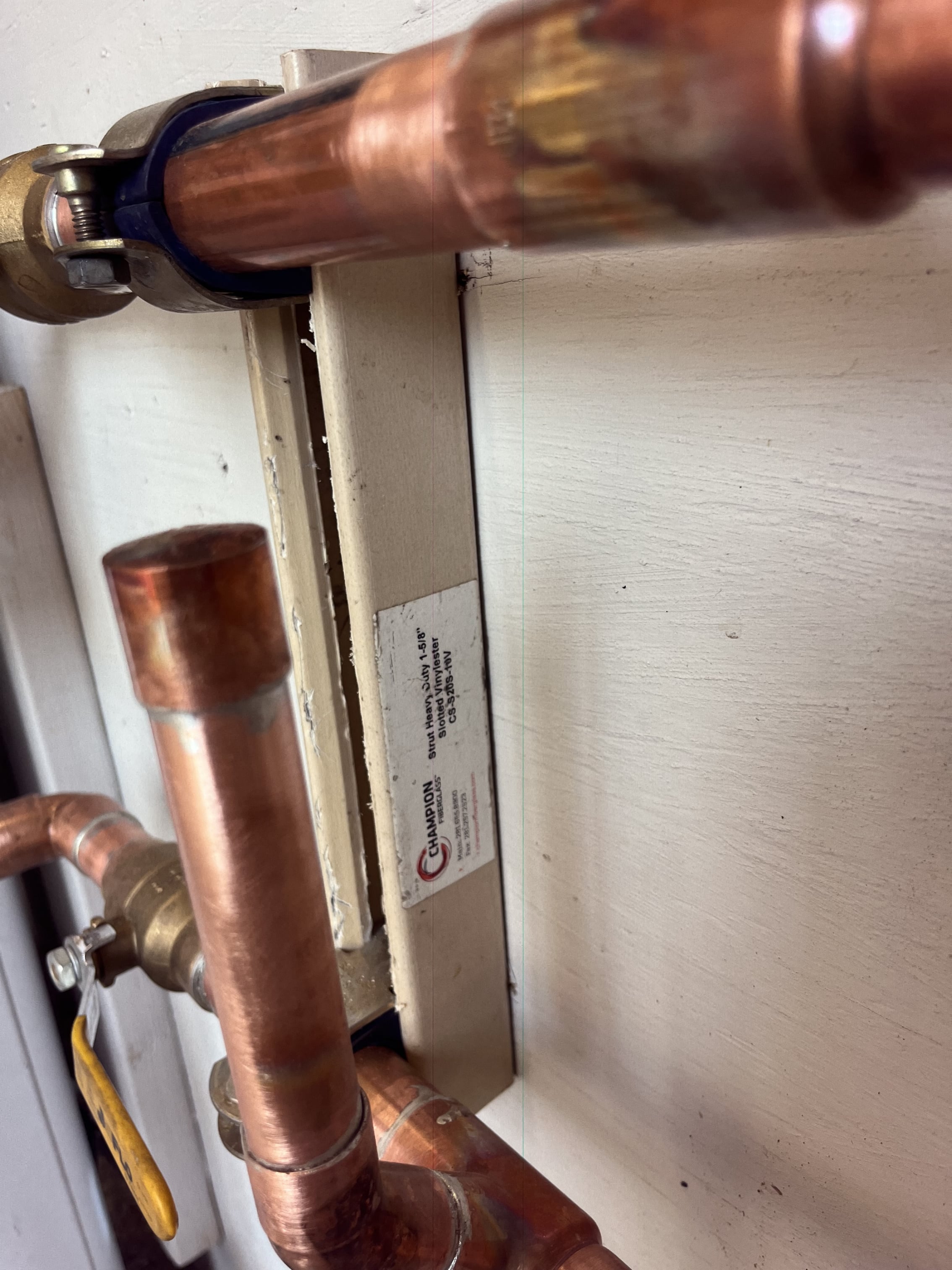

    Here are 2 classic photos of a lot more zones to maybe help with what you are trying to do with 3 zones
    This one is a failed system next to a better system design.

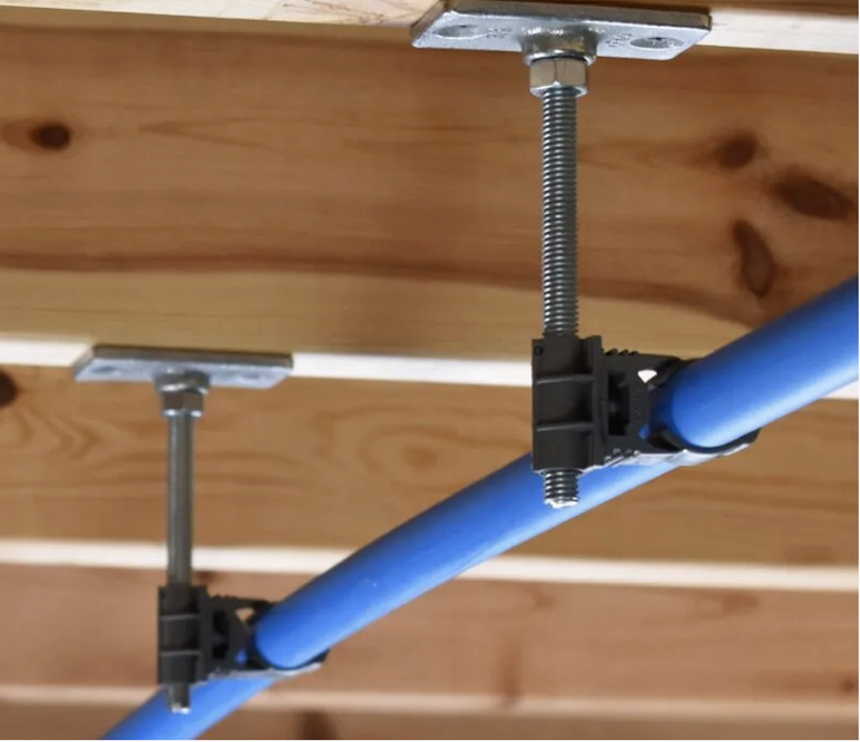

    This next one attached the All thread hangers directly to the wall panel that was decorated with faux diamond plate tiles to make the boiler room have a slick look.
    These threaded rods are cut to different length to get the piping far enough from the wall to allow for the circulator pumps and wiring can slip behind the piping.

    Thanks! That clamp in the photo looks ideal for mounting the rails regardless of my plan (sheathed frame or bare studs). And maybe that's the way to go for the rungs as well. Knew there had to be something standard like this. What's the exact name for it? Never seen one just like this. (This is the first heating system I've ever worked on.) I much prefer this than to the typical split-ring clamp and for my rails they're right next to a stud. What specific amounts of offsets are available perpendicular to the extender? There must be something that is adjustable.

    Looks like I'll stick with my "bare studs" plan. I wouldn't be providing thereby a "torsion box" for the boiler and boiler-side mounting on the reverse side, but I still prefer it this way for many reasons.
    At this point I'm still thinking of 2-hole copper straps for the rungs, but clamps like EdTheHeaterMan described above for the rails.
    Are 2-hole copper straps still used a lot on studs? Is it common to mount a zone manifold on bare studs?
    And what type of clamp can define a fixed position for my rails at that clamp, letting the pipe slide on the other two clamps holding it?

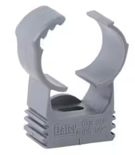

    @Larry Weingarten Very helpful, thanks, and I've already heard I should look into Oatey clamps. Now I need to learn more about the clamps that this adapter fits into.
  • DrHerrera
    DrHerrera Posts: 14
    Maybe an Oatey 3/4-in Plastic Self Closing Pipe Clamp would work for each rung. I've got to learn about how to snap pipes onto multiple clamps though. Or maybe Larry's suggestion is better.
    I'd definitely like to not need to raise the rungs. But then the rails can't be mounted this way because their diameter is greater (1-1/4" vs 3/4"). Got to mount them another way from below that level, such as from the flat studs I propose below them. But it would be more convenient to mount from one of the adjacent studs. Something to position the rail 1/4" inches into the frame.

    I don't need the rails to be mounted 1/4" into the frame if I don't use 2-hole clamps, just a self-closing clamp that raises the rails 1/4" less than those clamps that raise slightly the rungs.
    hot_rod Posts: 28,699
    For hydronics you want clamps that allow expansion movement, plastic, rubber inserts.
    2 hole copper straps can cause noise issues and they transfer pump noise throughout the rack and framing
    Ive been using fiberglass or composite strut for my projects, no rusting on the cut ends
    Aluminum strut is another option
