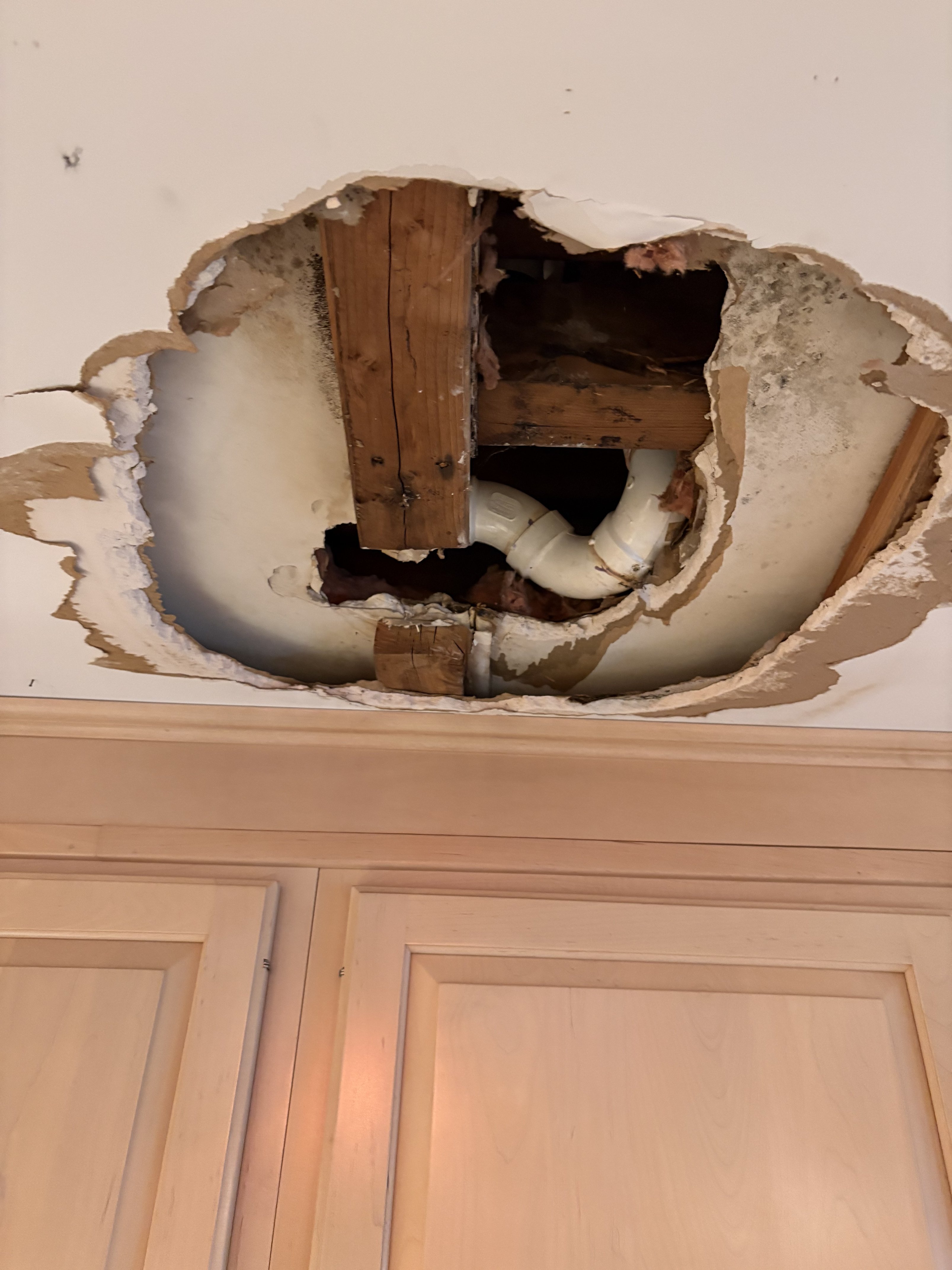

A second floor shower pan drain seal leaked. It did quite a bit of damage to the first floor ceiling. The “no caulking required” seal was only a few years old. Either the manufacturer changed the size or the first one shrunk.

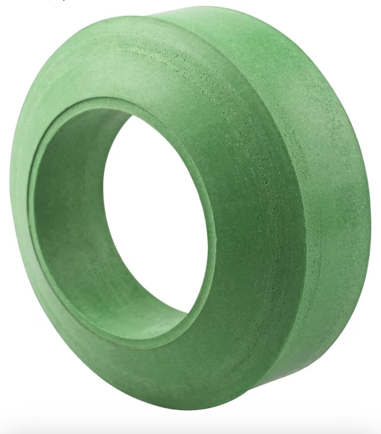

    The leak happened a few months ago. I thought it was interesting that a seal that came with the pan actually didn’t. I replaced it with a toilet tank to toilet gasket. It’s not leaking as observed from the hole in the ceiling underneath. I wanted to make sure before ceiling was repaired.

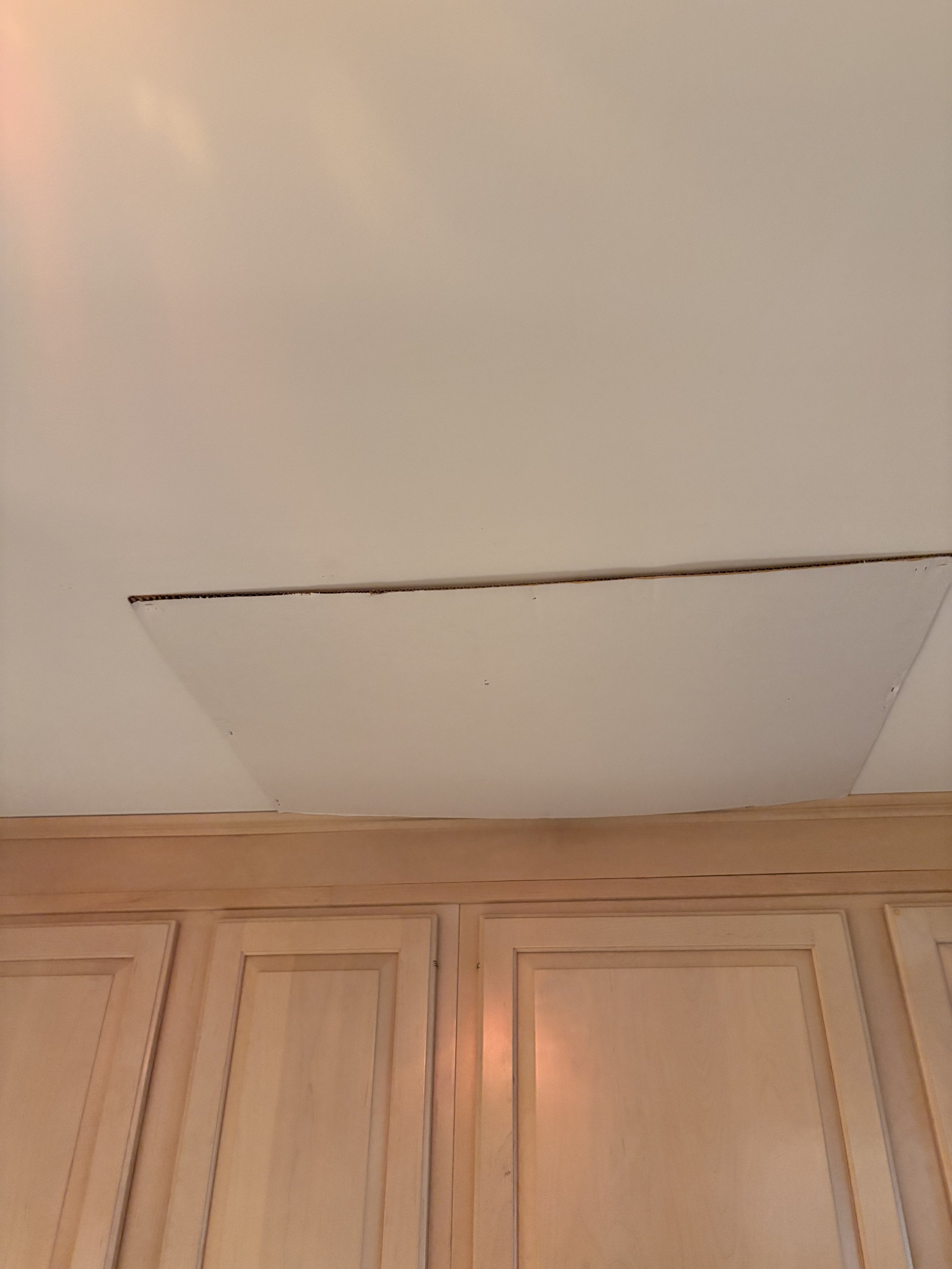

    I need to replace a 3’x4’ piece of if sheetrock in the first floor kitchen and repaint. The house is 70 years old and has be remodeled a few times. Card board and a staple gun works for now.

    Looks like a creative homemade P trap?
    looks like it does not meet code. makes one wonder what is happening at the shower pan.

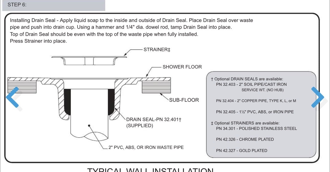

    It’s a moulded plastic shower base which replaced a 60 year old tile shower floor during a bathroom remodel. The seal obviously shrank and no longer sealed as can be seen by the first side by side photo. That seal came with the base same brand as the base.
    normally it would be compressed between the drain and pipe and clamped in place in some way to keep the synthetic rubber compressed between the 2 usually either with a plate and some screws or a compression ring that screws in to the drain

    The rubber seal is friction fit between drainpipe and pan as in the image
    that is terrible design. not only is there nothing to compress the gasket, the drain is on the outside of the pipe instead of the inside so even the slightest amount of leakage is dripping down to the floor below rather than in to the pipe.

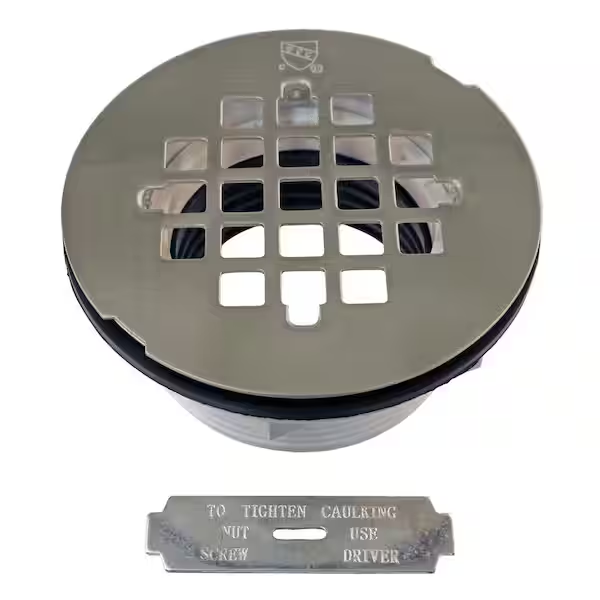

  • I've had pretty good luck with the gaskets that come with the shower drains. They typically come with a threaded compression ring that you tighten down with a key.

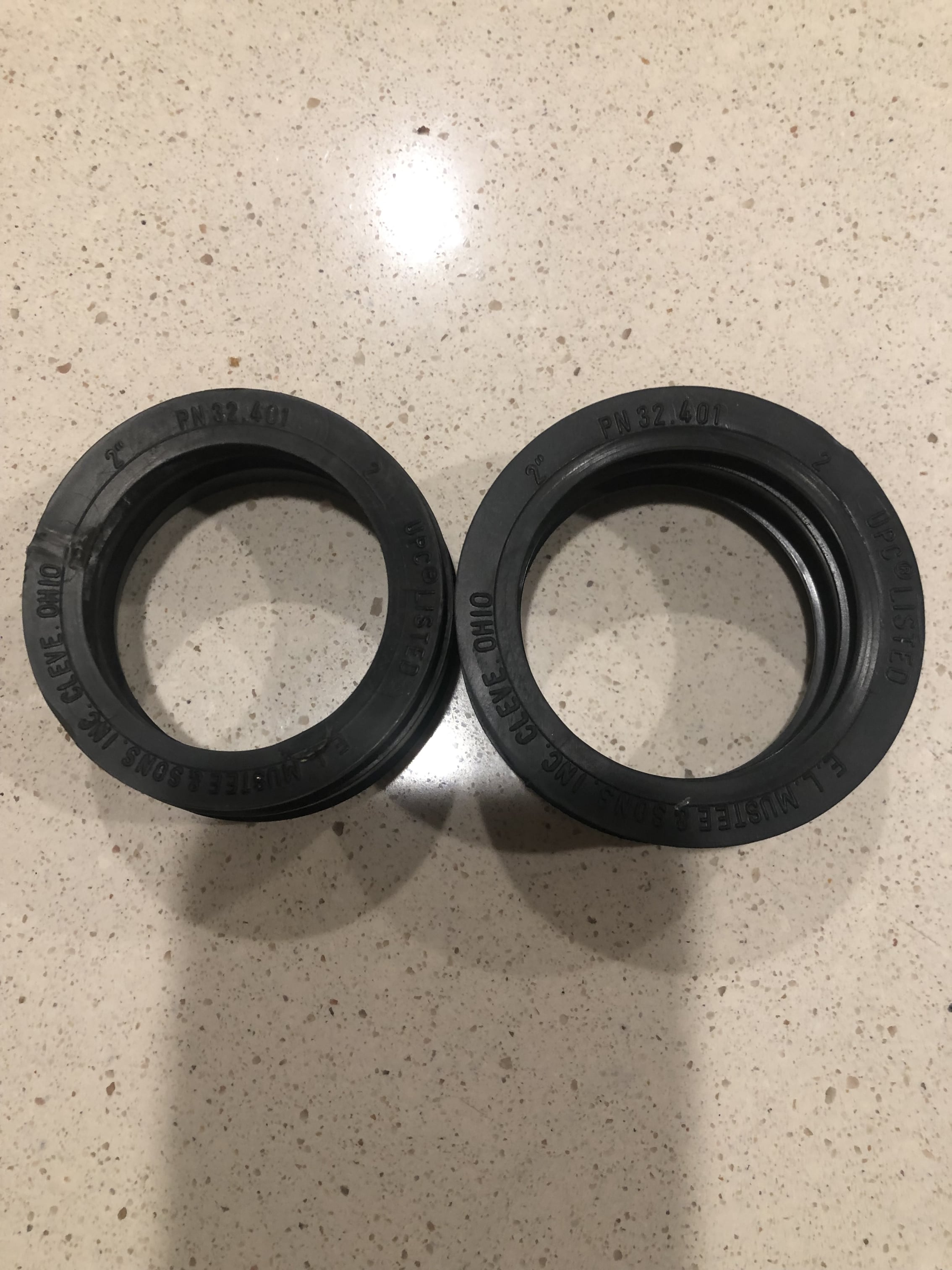

    Bad design aside. I sent a photo of the leaking seal to the manufacturer of the shower base and seal. The seal on the left is smaller than the replacement I bought. The part number is the same. It can be see by zooming in. I don’t know if the original on the left shrunk or they made it larger in size. I
    got no response. I have $700 damage from the leak. My insurance is $1,000 deductible.

    without a lockring to compress the gasket in place as the pipe and the shower pan expand and contract and move it is likely to slowly push the gasket out as they move around.
    i wonder if you could cut out the molded in drain and clamp on a drain of a better design, of course you also have clearance issues in the ceiling.

    The home made trap is because the drain was exactly over the 3” wide joist and the tile guy was coming in the morning. The 2” pvc is level and the toilet tank gasket is working great. It’s a tighter more secure fit than the one supplied with the base.

    I didn’t get an answer from E.L Mustee as to why or if they changed the size of the gasket. If the gasket was made larger then it may have worked better but I didn’t want to chance it
    EBEBRATT-Ed Posts: 21,328
    Seems to me it is like a doughnut you use in a CI hub when replacing CI with PVC or ABS. The drain pipe expands the gasket.
    @skyline137 did you measure the gaskets to see if there is any difference?
    The old one does look smaller.

    That gasket needs something on the outside to hold it in place as well as the pipe inside!
    Installation Error!
    i think it is a design error because el mustee/owens corning makes fixtures, not fittings.

    2 tight fitting sleeves that fit inside each other with an o-ring in a groove on one of them would be 1000x more secure than that doughnut jammed in between the pipe and the shower pan. everything on a car has worked like that for about the past 40 years.

    I would trust it more that a foam or rubber toilet tank gasket.

    there are 3 different gaskets, maybe it shopped with the wrong size for PVC?
    Any part number on it?
  • skyline137
    skyline137 Posts: 85
    The reason for the original post was about the part number on two supposed identical gaskets. The gasket on the left leaked. I don’t know if it shrank or came that way but it’s definitely not the same size as the one on the right.
    If you ZOOM in the part number is the same.
    does the new gasket just slip in or does it get smaller when you slide it in there? as most synthetic rubbers age they harden and will take the shape they were confined to
