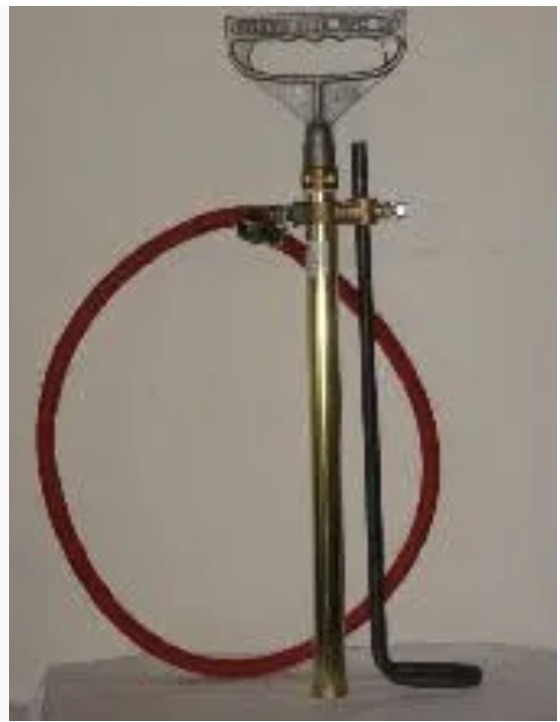

    Is this on a steam boiler or a hot water radiator boiler? Those first few non-answer replies (what not to do) are related to steam. Only @hot_rod gave you a good option.
    I used a pump to pump chemicals into a boiler system without draining the system. two different designs.

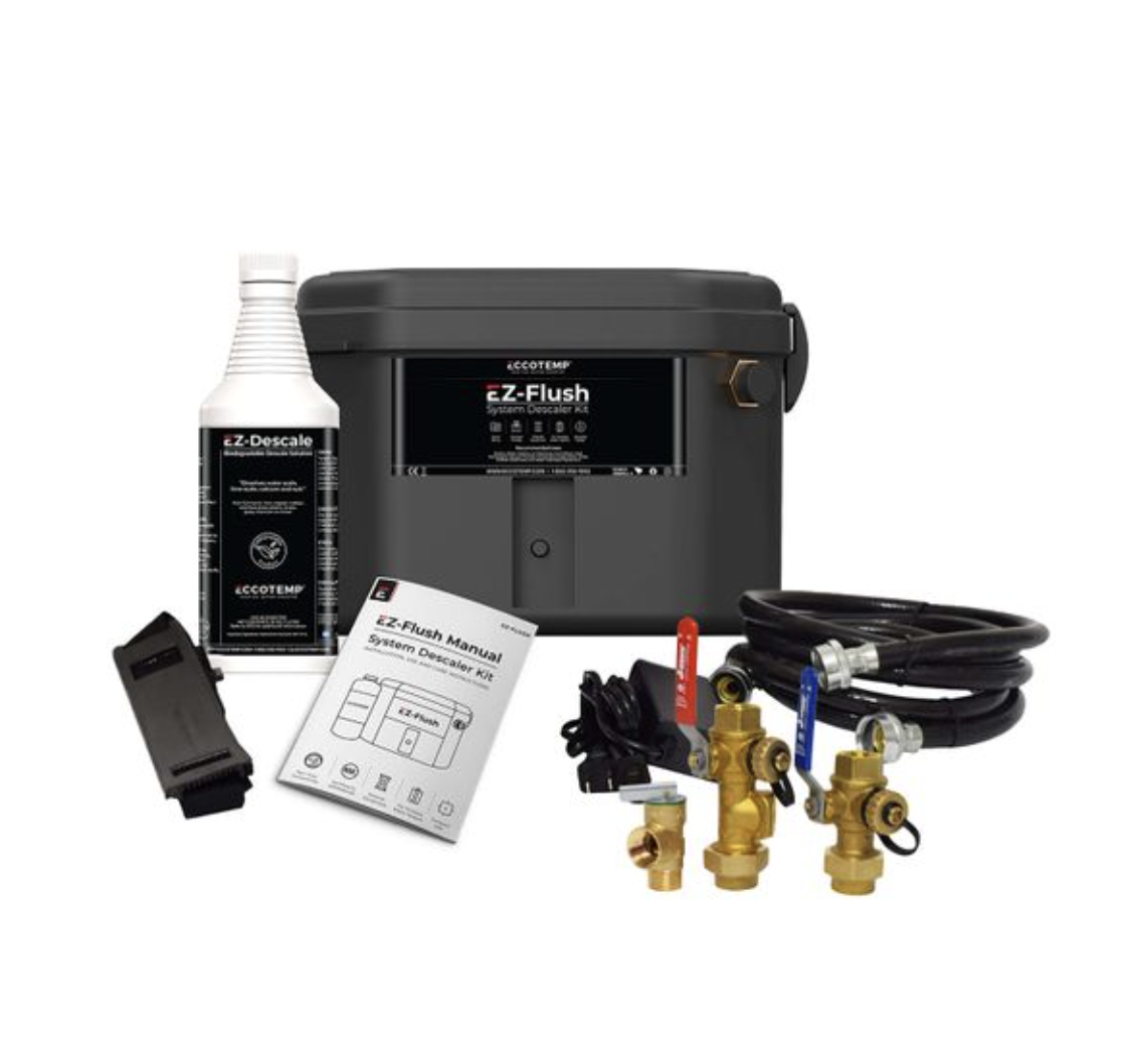

    EZ Flush electric pump kit is a new brand that is available in a compact kit that includes the pump and hoses. The chemical that it comes with is for tankless water heaters, but you can add your own chemical and run the chemistry thru the boiler for 30 minutes or so and see what happens. I have used a different kit and ended up throwing out the crappy water several times before I liked what I saw coming out of the boiler. Then I added the proper chemistry to get the proper pH for the boiler and let that run for about 15 minutes.
    I just needed to be careful to thoroughly clean my kit after a boiler, so I could use it on a potable water heat exchanger the next time I needed to.
