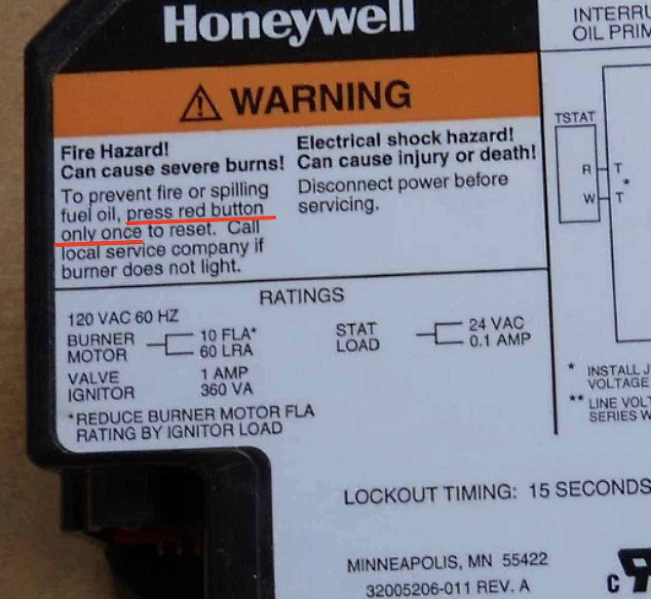

    @joea99 said: "…was always waking at morning and finding it cold. Always restarted with one push of red button.
    Until today."
    This is a problem for me…. an oil burner that is operating properly never needs to have the reset button pushed. When it is operating properly, the. reset feature never gets activated. That reset feature indicated a problem. That reset feature is a signal that there was a flame failure. That reset feature happened for the first time many days or weeks ago. The term "Always" indicates that the first time you needed to reset the primary controls was not this morning. that "Always" indicates that you knew there was a problem and you did not take time to address the problem. That "Always" tells me that you believe that resetting the burner primary control is normal.
    LET ME BE CLEAR. "PRESS RED BUTTON ONLY ONCE" is not a suggestion. "PRESS RED BUTTON ONLY ONCE" does not meat once per day. PRESS RED BUTTON ONLY ONCE means just that "ONLY ONCE".
    As soon as you needed to press the reset button a second time within a week, you shoild have followed the instruction on the control that reads "Call local service company"
    This is a clear indication that the average person does not read WARNING label, or if they do the fact that it says that it can cause death does not really matter.
    Live dangerously! You have been doing that since you pressed that red button the second time.
    DO YOU UNDERSTAND THAT THERE IS A FIRE INSIDE YOUR HOME THAT IS MADE SAFE BY THAT CONTROL? Yes a real fire that no one is looking at. It's not like a camp fire where everyone is sitting around roasting marshmallows. Not a controlled fire that some is making sure that it does not get out of control and cause a forest fire. This is a fire in you home that no one is watching except for that L7184 control …and you can't follow a simple instruction that reads "PRESS RED BUTTON ONLY ONCE"?
    Please don't do that any more. Call someone to fix your oil burner.
    PS: I will send you a sticker that reads "RESET ONLY ONCE" in bigger letters, if that will help

    @joea99 I agree that you may be able to reset it once, and if it runs for a month before needing another reset, then the next time you have no heat a month later, it would probably be acceptable to reset it once again. Your post did not indicate that, so I assumed the worst.
    Back when I started working on oil burners, the primary safety control was a “stack switch.” The most common one was the Honeywell RA-117 with a 90-second safety timing. Think about that for a minute—actually, a minute and a half (LOL). If your oil burner was running for 90 seconds with no flame because of weak ignition, and you had to reset it three or four times before the burner finally lit off, all that extra unburned oil would accumulate in the chamber. There could be a substantial BOOM when it finally ignited.
    That is why I still have a stack of “RESET ONLY ONCE” stickers on the shelf—although the glue may be dried up by now. Situations like that happened more than once with both customers and mechanics from the 1940s through the 1970s.
    Later controls improved safety by reducing the timing to 45 seconds. That was a big improvement. Your control only allows 15 seconds to prove ignition, which is considered the gold standard today. In fact, if someone still has a 45-second safety control on their oil burner, we strongly recommend replacing it with a safer 15-second control like yours.
    So if I sounded a little extreme, that is because my younger brother ended up in the burn unit after repairing an oil burner where professional boiler operators had ignored an ignition problem for an entire week. Three shifts of boiler operators had recorded the same note in the logbook every day:
    “Boiler #3 not operating / Reset once / Still not operating.”
    Day shift, night shift, and graveyard shift all did the same thing for a week. That is 21 resets with no flame (but only once a day by each boiler operator. At the end of the week, the supervisor reviewed the logbook and asked, “Why has this not been addressed? Call the oil company and get this repaired.”
    My brother found a bad ignition transformer and replaced it. While looking through the fire door to verify ignition, he started the burner. With all that extra oil built up in the chamber, the delayed ignition blew out his eyebrows and mustache and gave him a glowing sunburn in the middle of winter.
    Thankfully, he recovered completely. His eyebrows eventually grew back, although he is permanently bald now—but I believe that has more to do with age than the burns he suffered that day.
    And if you look at my previous post, the control itself does include a warning label.
    So I am an alarmist when it comes to reset buttons.
