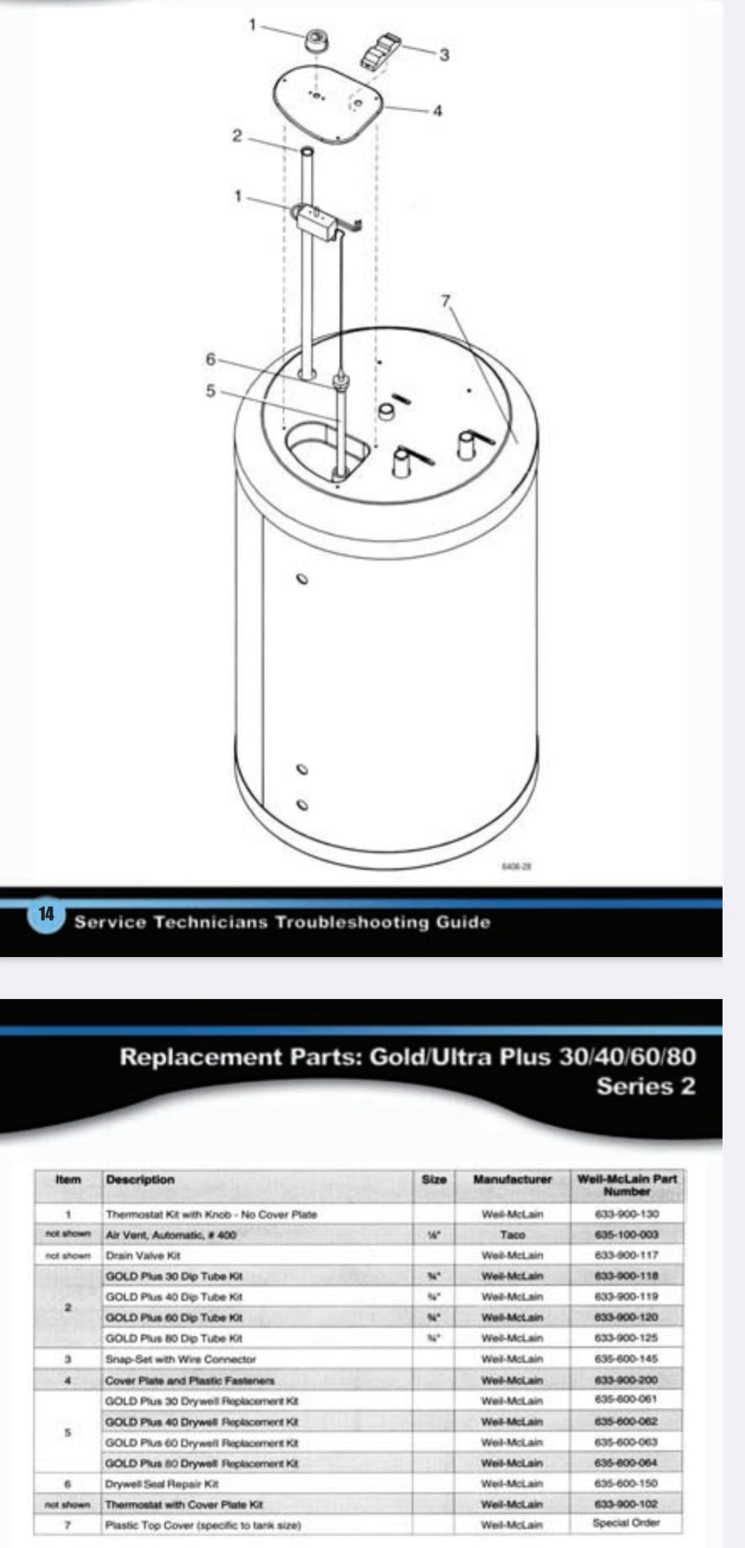

    One more reason I don't like those tanks. I know I've done it, but its probably been 25 years and I can't remember what I had for breakfast this morning. Weil McLain used re-badged TT tanks for years and their Series 2 shows a dry well repair kit (item 6). Maybe that could help?
