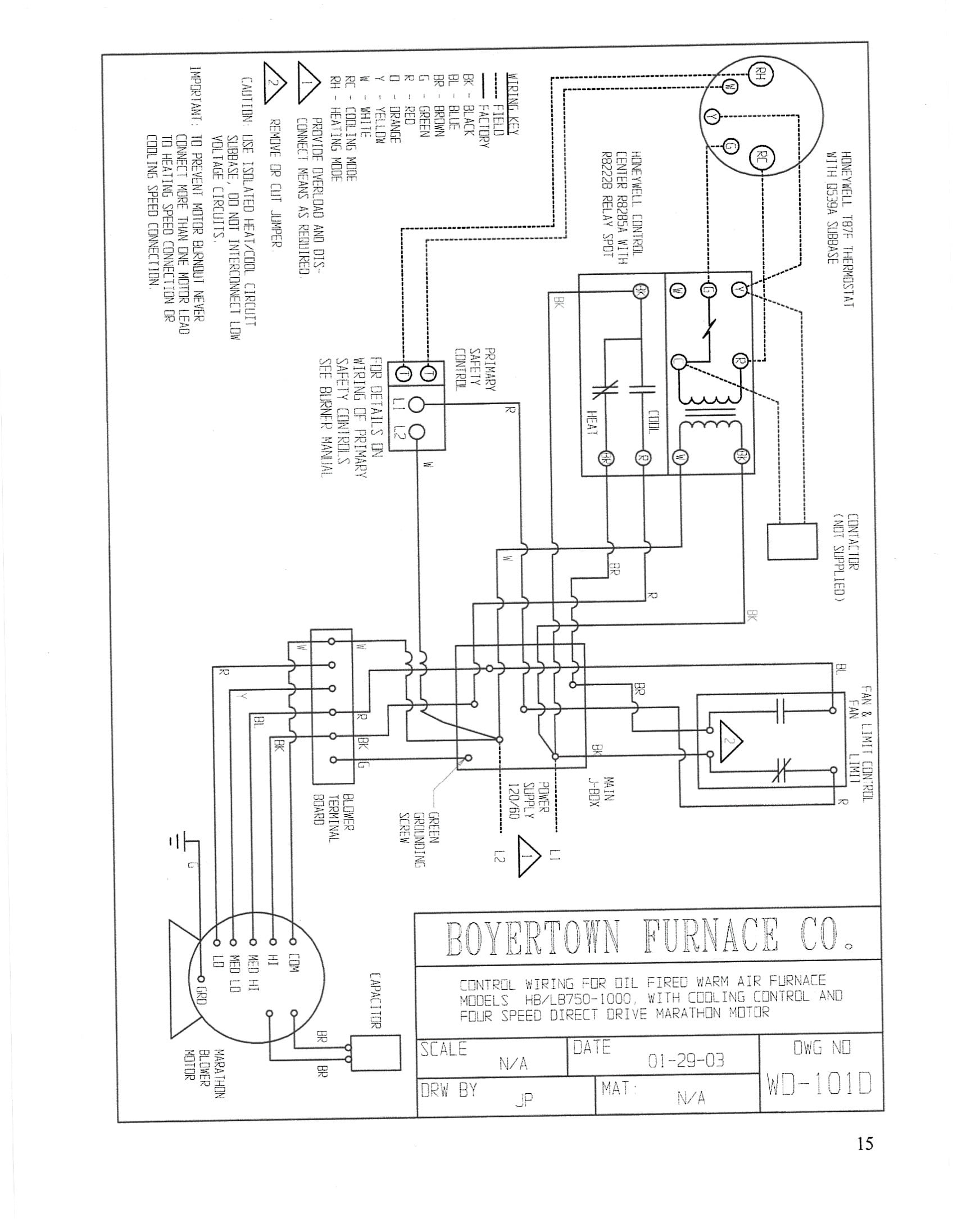

The Furnace/AC is a Boyerton LBD85 with a coil. this diagram shows a T87F thermostat which I believe is a mechanical, mercury, model.

    Get a T87F from eBay. They aren't common, but they are available.

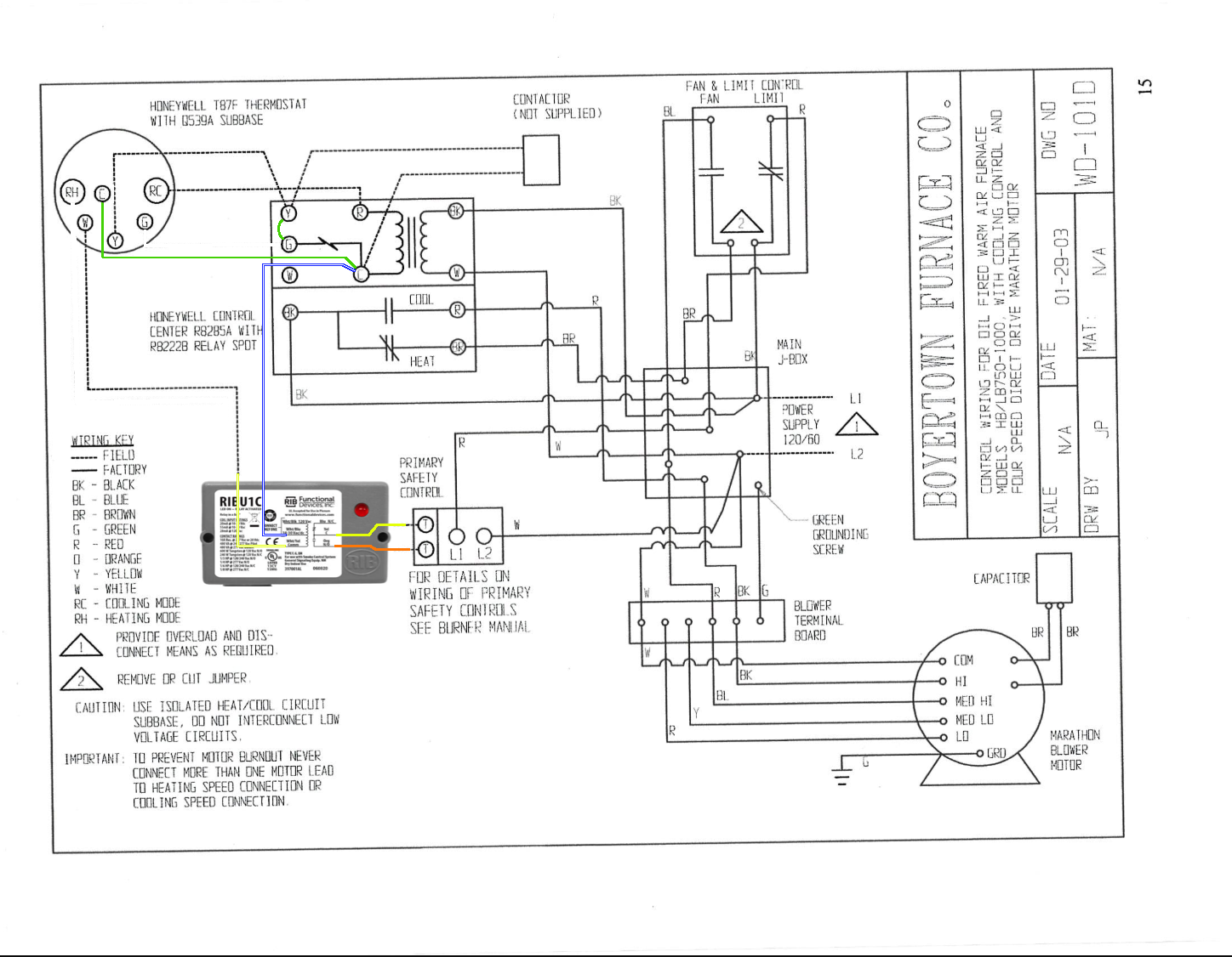

    The RC wire is for a separate transformer in the condenser, when that was an add-on to a furnace. It's been a while since that was a thing, most everything is all fed from the xfrmr in the furnace nowadays. If there's no separate transformer to energize the contactor in the condenser, no RC wire is needed. If there is, an interposing relay (I suggest a RIB U1C) can be used, energized from the Y call from the thermostat, to isolate the two transformers.

    EdTheHeaterMan Posts: 13,030
    Easy Peasy
    This is obviously an oil burner situation. The RIBU1C is a great fix for thermostat problems. And @HVACNUT has a great fix for getting an additional wire for the C terminal if needed.

    Hey Ed, thank you for responding as you always do in a well thought out help full manner. I think you are responding to the part of my question about using a power robbing T87K or N thermostat. I'm having a hard time wrapping me head around part of it. Normally R and W or RH and W are nothing but a contact that closes when the room temp falls below the setpoint (heating mode) . In this case connected to TT on the Burner Primary Control. When I'm working on a configuration like this I can jumper TT if I need the burner to run. I your example using the RIBU1C, its clear that power between W on the thermostat and W on the fan control close contacts that short TT on the primary firing the burner. but what happens with W on the thermostat, R(RH) is not in play so what is W connected to in the thermostat that completes the circuit?
    mattmia2 Posts: 18,449
    the jumper is in place in the thermostat that connects rh and rc together so w connects to rc and powers the relay off of the cooling xfmr which then is an isolated contact closure for the primary control.
    When the thermostat comes from the factory, I believe there is a jumper between R and Rc. That should stay in place (or you may need to reinstall it). Some power-stealing thermostats have a preference for which transformer they draw power from. I am not familiar enough with the T87N internal electronics to tell you which transformer it prefers when connected to the oil primary with R and W, and also Rc and Y for the AC unit, with the jumper removed.
    As a result, you may have issues if the primary control transformer is insufficient for power stealing. By making only one transformer available—the 40 VA air-conditioning transformer—you eliminate any guesswork about which transformer is being used for power stealing and whether that transformer is powerful enough to handle the job. 40 VA has plenty of power for power stealing. Using the RIBU1C makes that easy as you said
