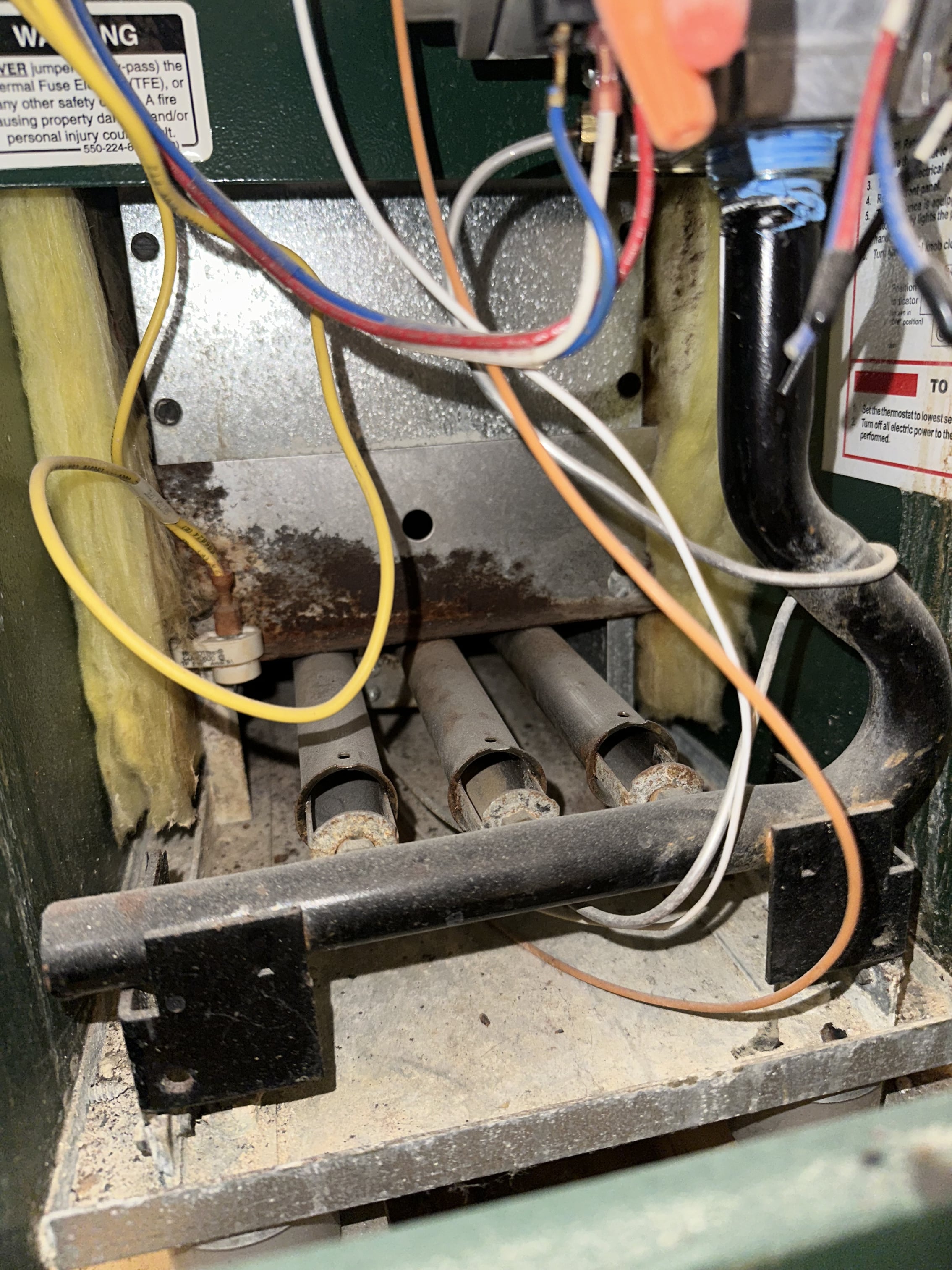

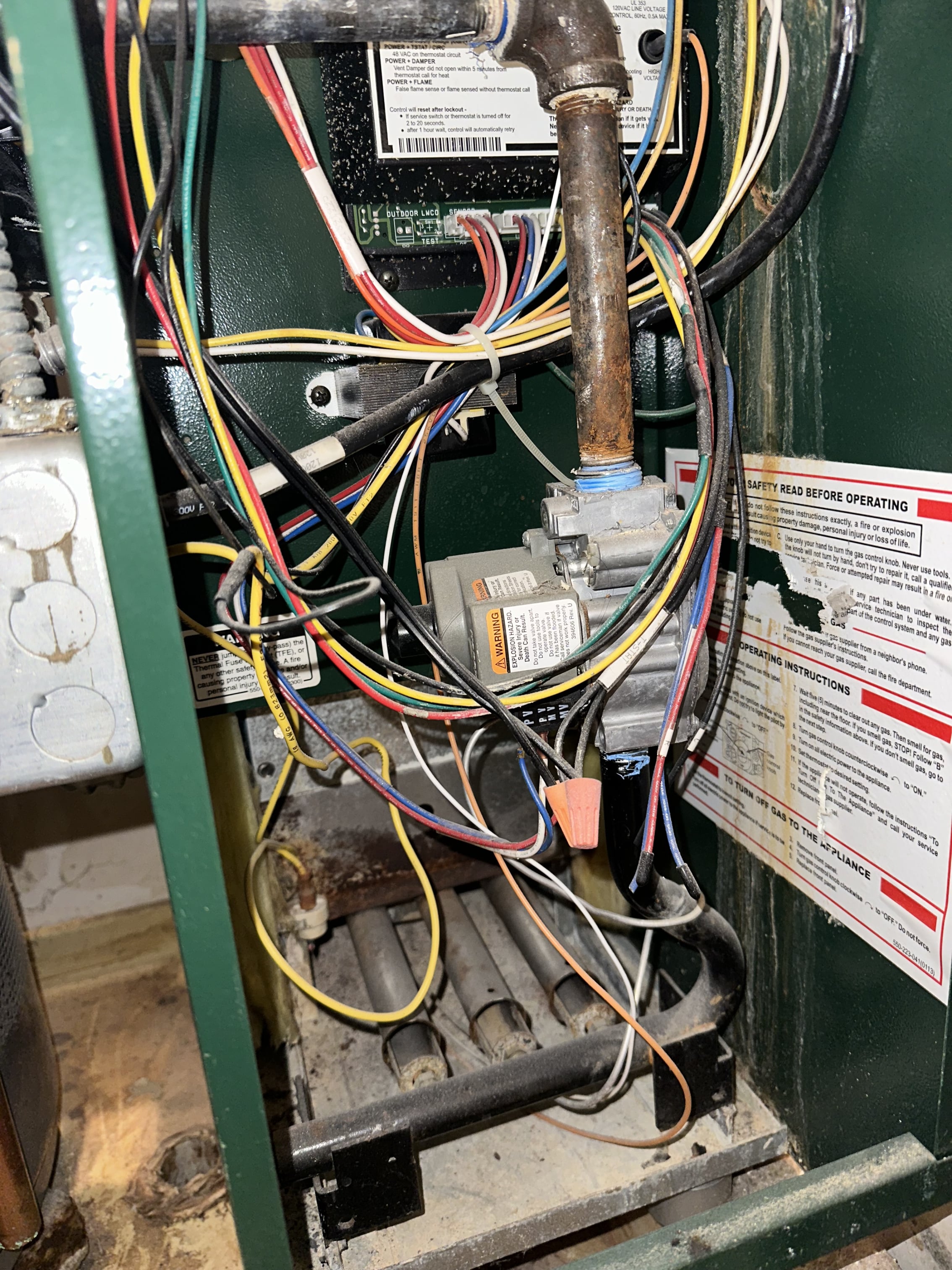

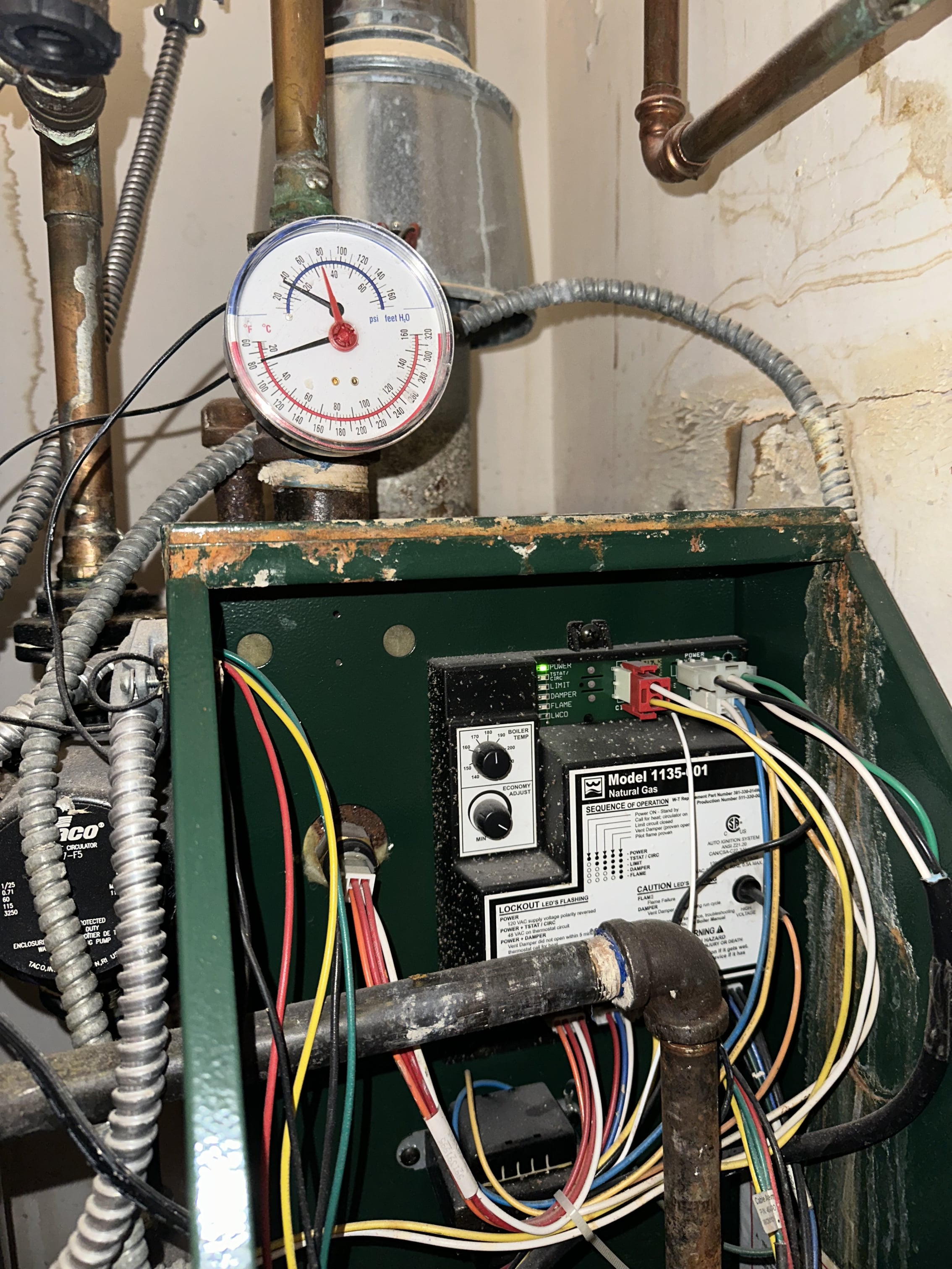

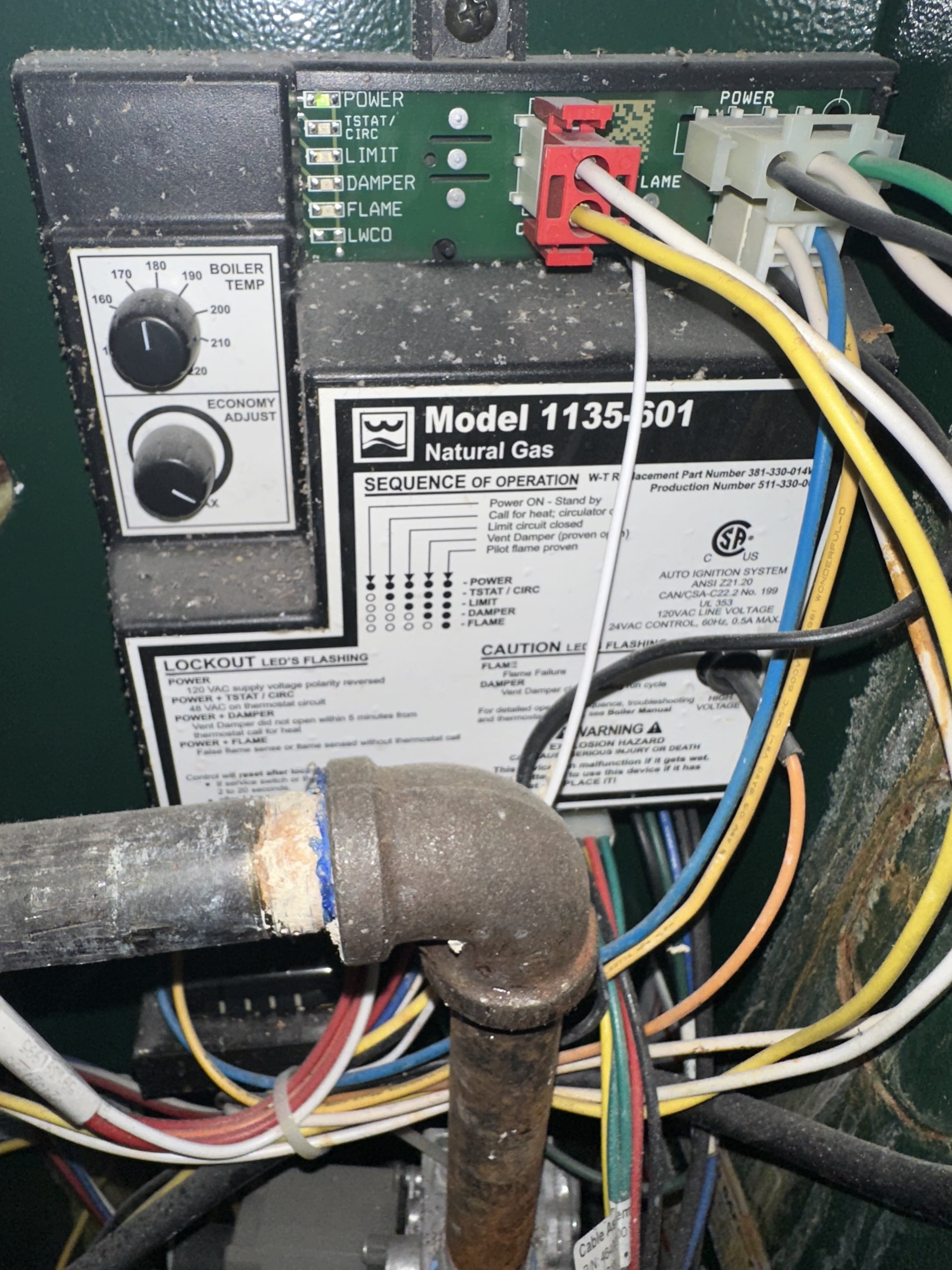

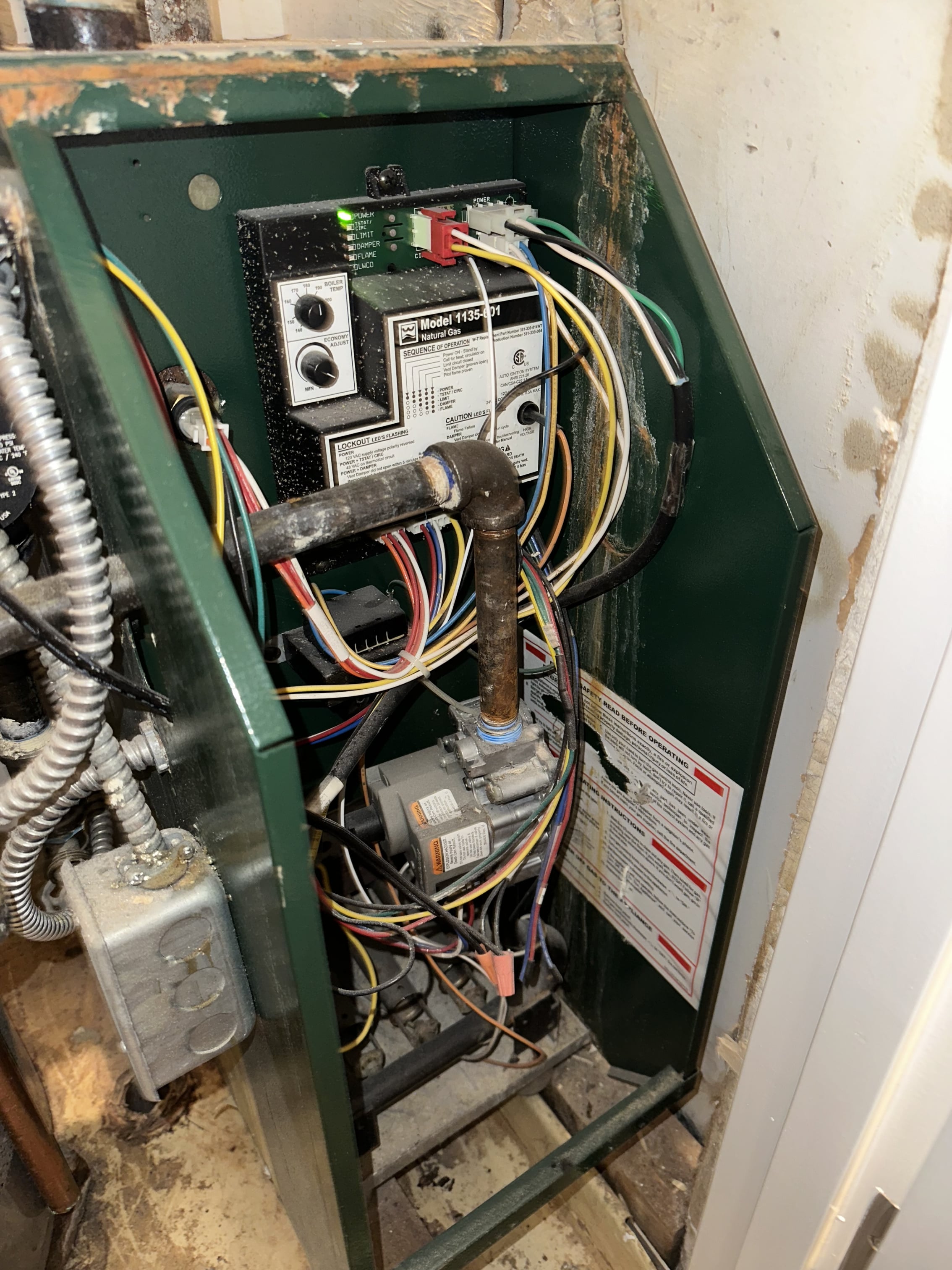

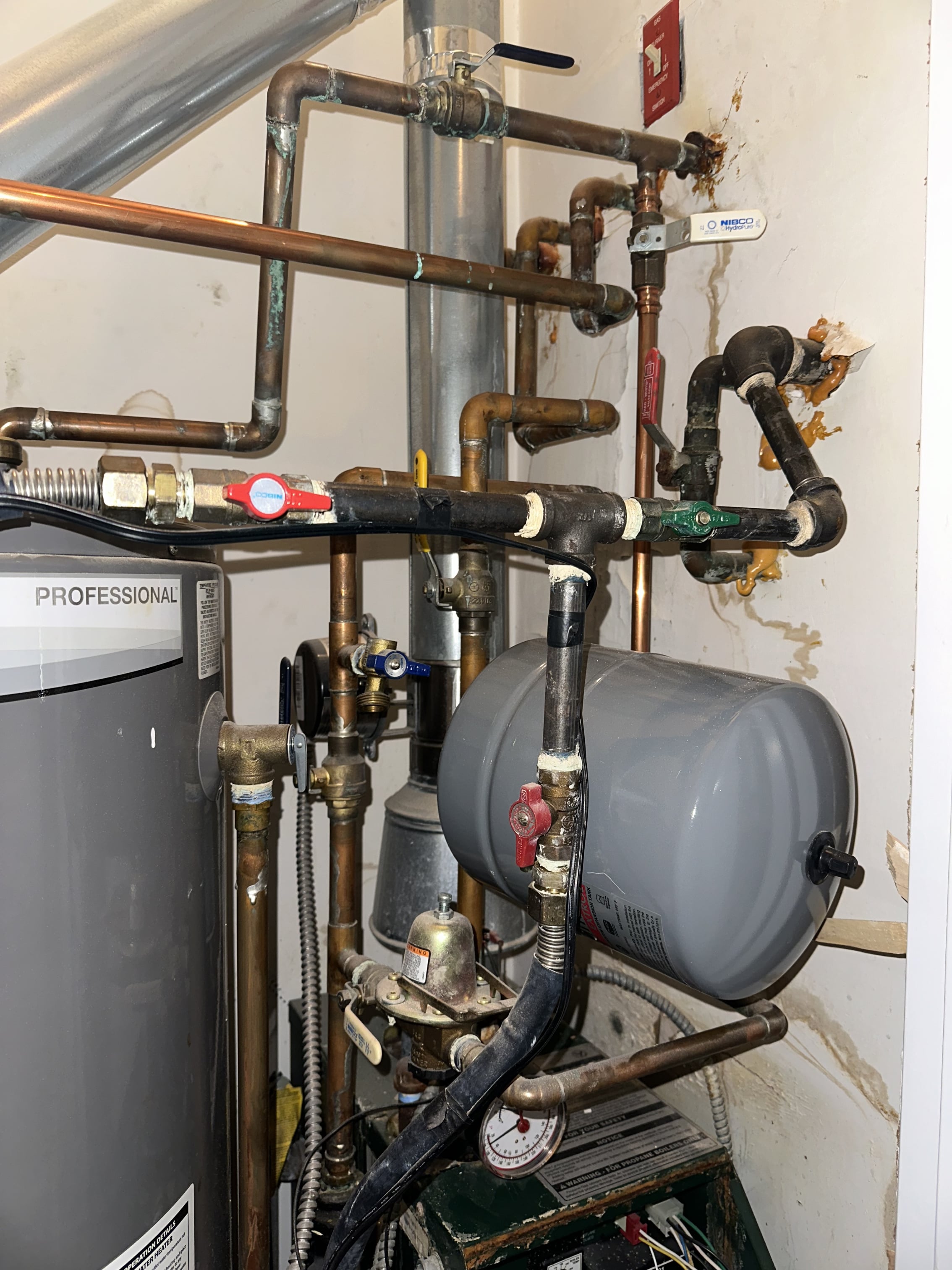

Can this Williamson boiler be saved or should it be replaced?
ems17270
ems17270 Member Posts: 5
edited May 5 in Radiant Heating
I believe it's from the early 2010s but not entirely sure.
I had a plumber contractor come out and tell me that it had to be replaced. I am considering upgrading to a tankless Navien Combi-Boiler because it would give me floor space, but obviously this is quite expensive, in the $$k range (NYC area).
IMG_1717.jpeg IMG_1718.jpeg IMG_1719.jpeg IMG_1720.jpeg IMG_1722.jpeg IMG_1724.jpeg
There is corrosion noted, but the area does not feel damp nor is there any visible leak. I also get a slight whiff of gas sometimes for 1 second when opening the utility closet door. The heating seems to be working fine but does make screeching noises when it first turns on.
Thanks in advance.

    If its not leaking all over the floor, Yes. The Question is...Will it cost more in labor and materials to do a total strip-down, cleaning et cetera. In most cases, No, its not worth it. Mad Dog

    Definitely looks neglected. Did the tech give an explanation to his diagnosis? That #60 extrol just hanging there is a little scary, but it doesn’t warrant replacement. Are you having issues? Was a combustion test done?
    You might gain a little floor space with a combi by eliminating the indirect, but the boiler always needs serviceable access all around. It shouldn't be a storage closet.

    The tech just said it looked very corroded and had to be replaced. He said they don't recommend repairing this sort of thing, and just replacing it. He didn't do any sort of testing.
    I am not having any issues aside from the noisiness. I do get a small odor of gas sometimes which goes away within a few seconds.

    what is leaking? is it from a pipe somewhere or is it condensation in the vent or leaking vent flashing? that corrosion isn't a boiler problem.
    Ironman
    mattmia2 Member Posts: 17,790
    oh, also, what is the combustion air source for that closet? if there isn't adequate combustion air that could cause vent problems that would cause that corrosion.

    I'm not sure if the plumber said it needed to be replaced because he said it's technically not up to code as the boiler is right up against the lateral wall.
    It's in a very small 700sq foot 100-year old apartment building so the closet size is very small.
    Air source I believe is thru a louver in the closet door. @mattmia2

    All the rust on the top of the cabinet says there's a water leak Above the boiler.
