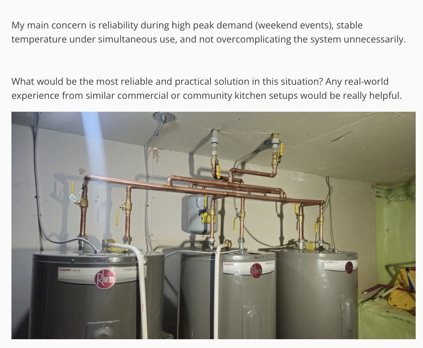

Hi everyone, I need advice on a commercial domestic hot water (DHW) system for a community center kitchen.
The building already has a ~380 Mbh propane boiler that is currently used for in-floor heating.
For hot water, there are only three 60-gallon electric tanks installed in parallel. This setup works okay during weekdays or low demand periods, but it is not able to keep up during peak usage.
On weekends or during events when the community center is full, the system struggles badly and we end up getting lukewarm water when multiple fixtures are running at the same time (kitchen sinks, prep areas, 4-5 washrooms , 6-7 handwashing stations etc.).

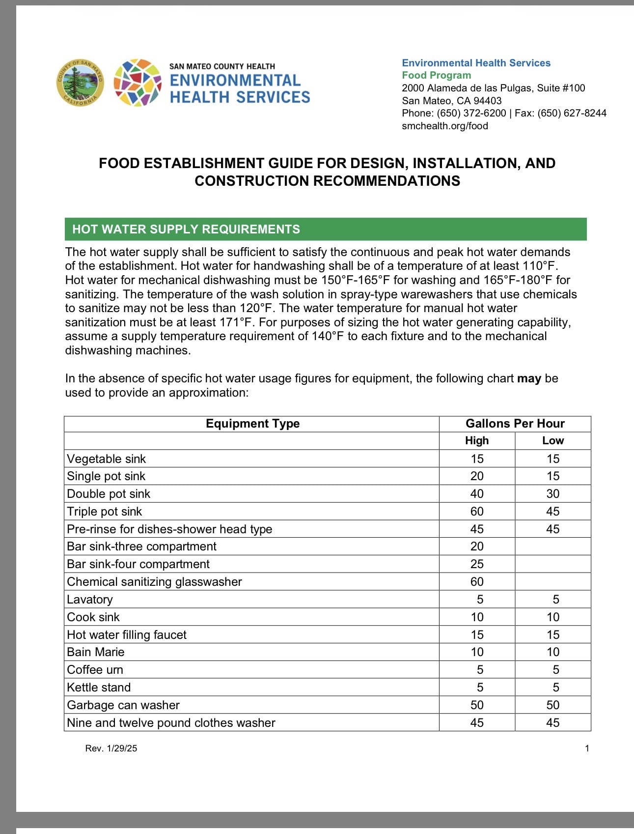

    the Department of Health having jurisdiction is going to have some very definite ideas about minimum flows and minimum temperatures

    those don’t look like commercial tanks. Any idea what temperature they run? Depending on the type of kitchen, they may need in excess of 170f to dishwashers?
    Typically you would also see a mix station for the rest or the DHW, hand sinks, etc.
    Your country probably has a guide like this.
    It is not uncommon to see health department stickers or numbers on commercial kitchen hw supply equipment

    your demand may not be that large if the parallel piping means you essentially have one 60 gallon electric tank. breaking them up to different loads may solve your proble but electric tanks have extremely slow recovery, the capacity you get is pretty much what is already hot in the tank.

    3 tanks with a 4500W element running in each, is 13,500W X 3.41= 46,035 btu.
    A high output 50 gallon gas, 60,000 btu input is about the same btu.
    A single commercial (180°) tankless at 199,999 btu X 86% or more efficiency would be around 172,000 btu/hr. More that 3-1/2 times the btu power you have now.

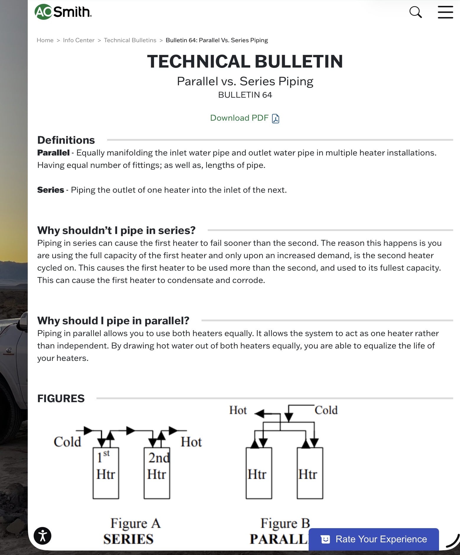

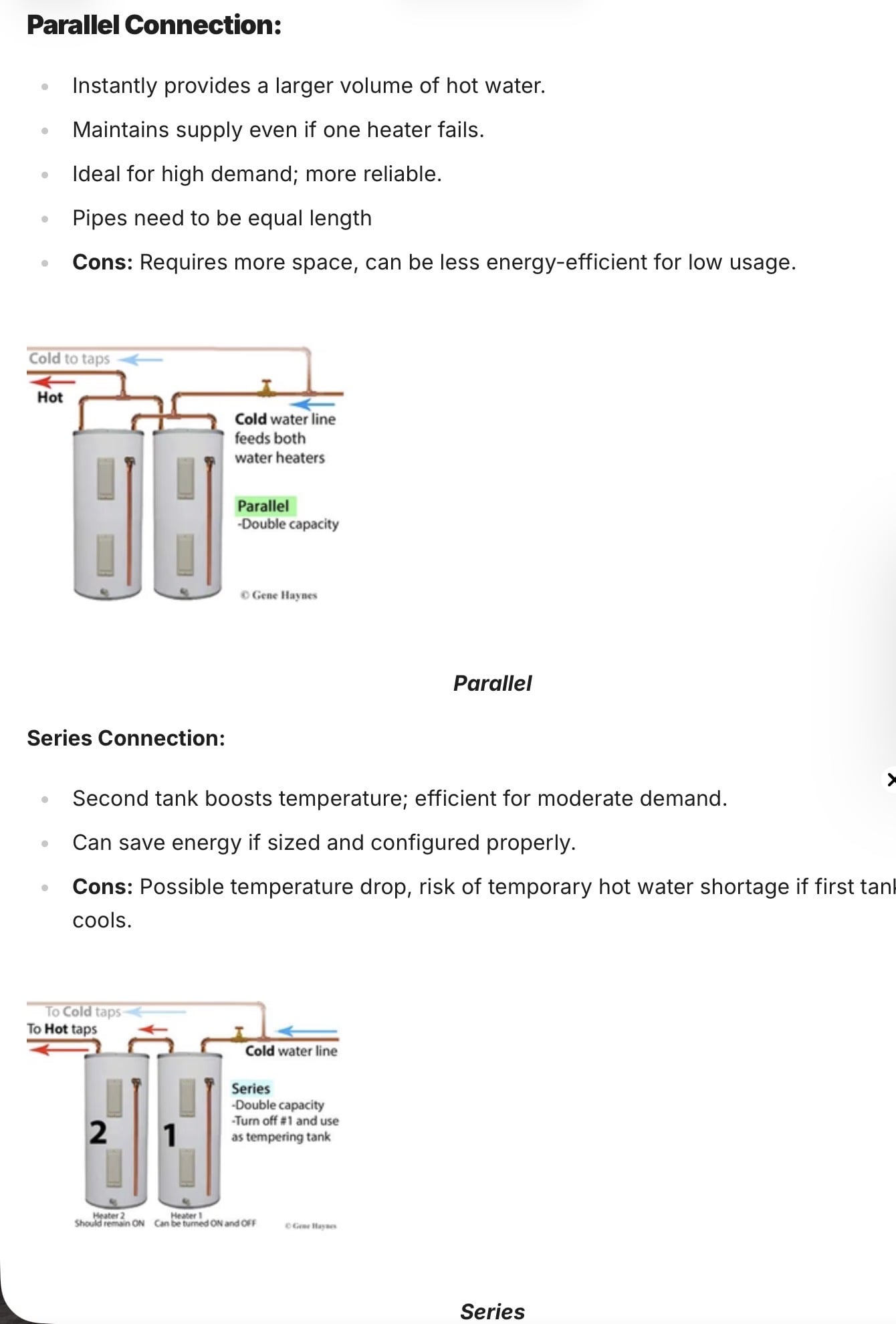

    but electric water heaters are more or less about the amount of hot water they store, they have essentially no recovery so the element wattage tells you little about the current demand, just that it is more than ~40 gallons per event.
    you could connect the tanks in series, then you'd get around 150 gallons instead of around 40 gallons of hot water.

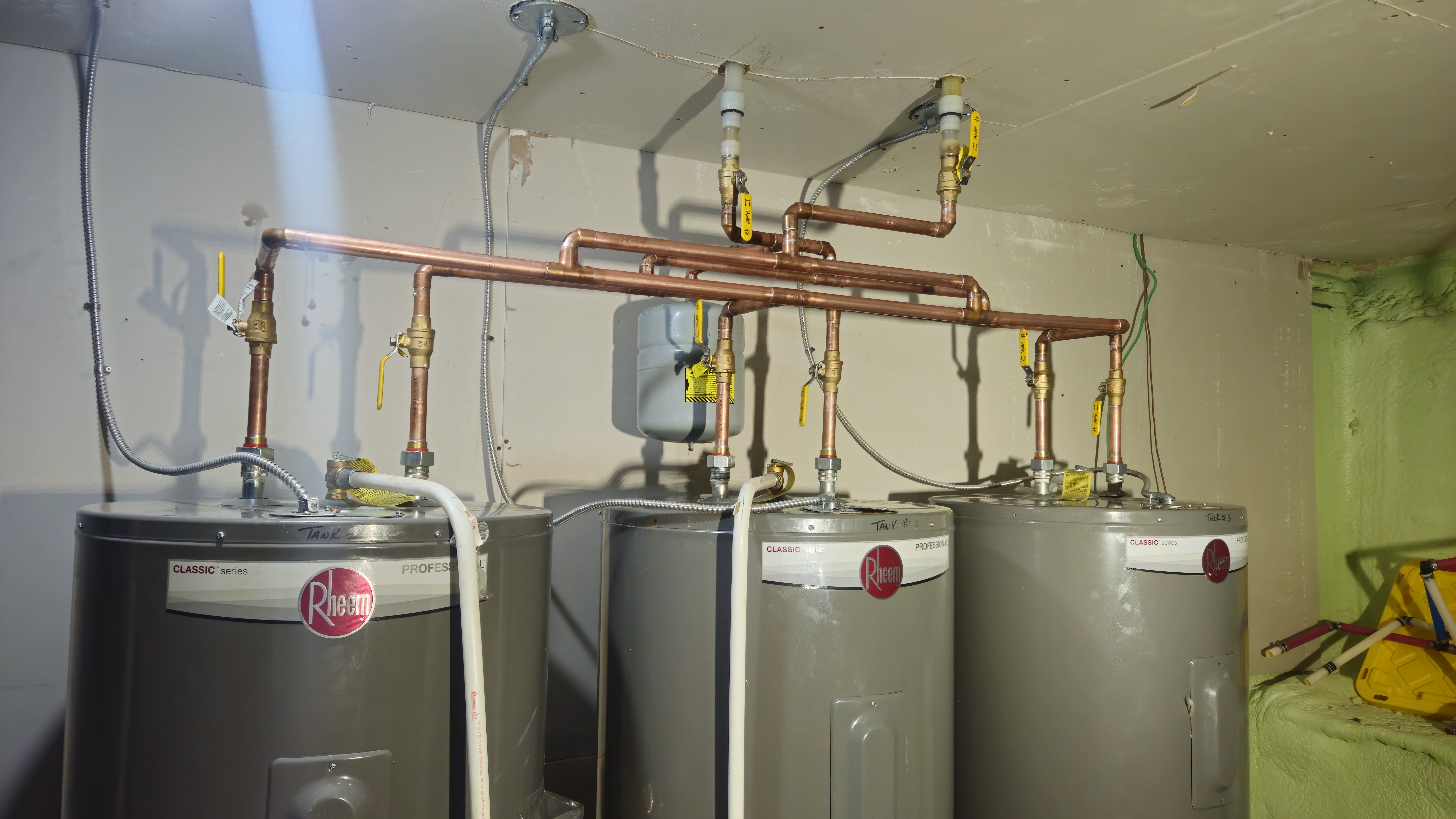

    they look to me to be properly parallel piped. Which is the better option for this application. Their main concern is high demand, so “on demand” properly sized are a good option.

    Well… I wiil agree that a parallel design can work. Sometimes. The one in your photo is actually not all that bad, but I'll bet that analysis of the heating duty cycle will show that the centre tank is taking more of the load — and that the delivered temperature droop comes when the centre tank runs out of hot water.
    To make parallel flow work well, it really needs to have a very low loss header on both the cold water feed and the hot water supply, and the connections from those headers to the various tanks must be EXACTLY equal. Same length, exactly the same fittings for each one.

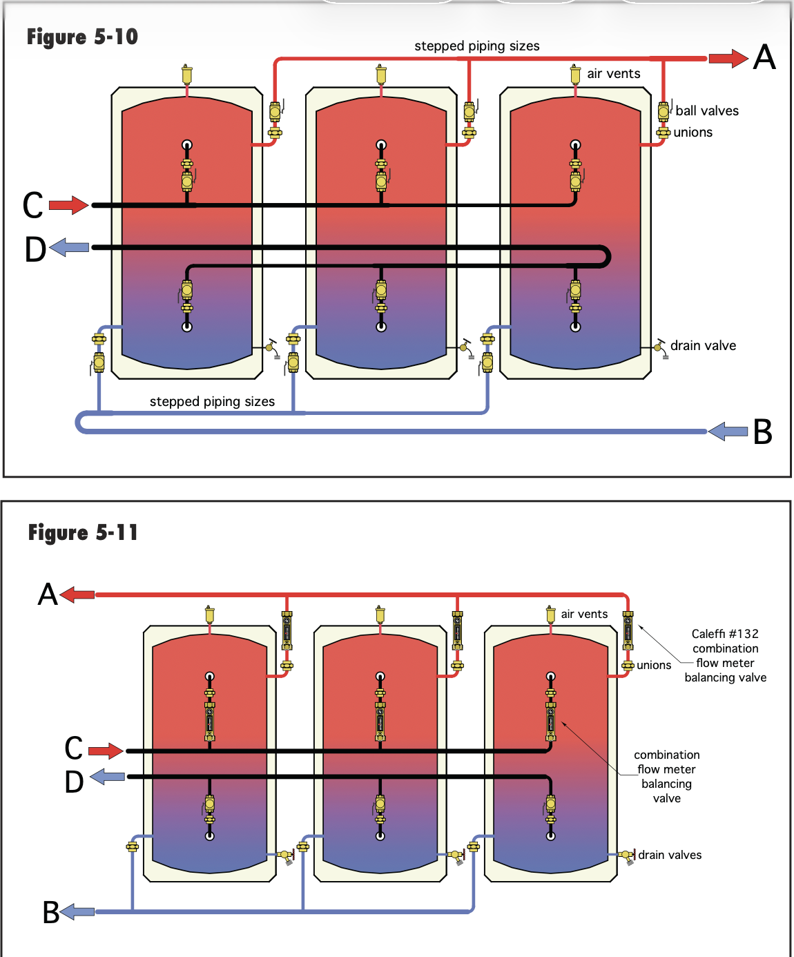

    hot_rod Posts: 28,699
    Reverse return or simpler yet, put a balance valve like a 132 Caleffi on each tank.
    These indirects are flow balanced on the coils and the tanks themself.
    is the dividing of flow linear? like their issue is that the recovery is measured in hours and they have someone using a faucet or 2 somewhere almost continuously rather than someone is using 15 gpm of hot water. the flow is probably more like 0-2 or 3 gpm over 3 or 4 hours. will that still divide evenly if you set it up with balancing valves?(i have a similar question for a valve to control flow of the mix in a shower head or faucet). i think the resistance is linear so it should stay in the same proportion with varying flow. sizing the pipe diameter from each tank to the manifold to the actual flow would also probably help. does the fluid dynamics, the interaction of the fluid with itself and with the surface of the pipe change the resistance between say 1gpm and 8 pm?
    in a series system i don't see how the tank piped to the distribution system tank can run out of hot water before the whole system runs out, the hot water from the second and 3rd tanks are supplying that tank with hot water and the cold water enters at the 3rd tank.

    the balance valve with the flowmeters attached, or a typical balance valve with PT ports would allow you to “see” how the flow is split among the tanks.
    I know that Christmas tree piping that water heater manufacturers show in installation manuals has been shown and utilized for years. You would need to gauge up all that tanks to get an exact answer to your question.
