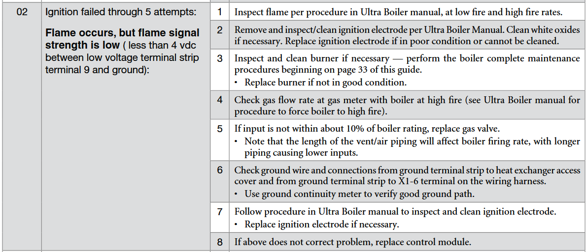

    I did check the low voltage terminal 9 to ground and it was only 2.2v during ignition. checked ground to X1-6 which was good. Unfortunately, this path leads me to a new control module.

    There may be multiple issues. Low flame signal and the weak spark. Although I believe flame signal is only valid when there is a flame present " only 2.2v during ignition "

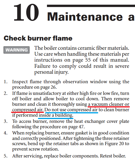

    you skip a very important step in your maintenance procedure and that is blowing out the mesh burner. the mess will get plugged during operation and needs to be blown out with compressed air at at least 90 PSI. The mess will look fine until you start blowing it out and then you start seeing all the debris come flying out. you can also wash with simple green but i like to use air so i don't have to wait to dry. Did you even do a visual inspection of the burner to see if the mesh was sagging?
    what series weil-mclain do you have?
  • ktm250rider
    ktm250rider Posts: 4
    I have a series 1 Ultra 155. I thought the service manual said to NOT blow out the burner. I vacuumed it out with a shop vac and bristle brush.
    1. Remove three M4 hex head screws (7mm box end
      wrench) and burner clips securing burner to cover
      plate. Remove cover plate.
    2. Use a vacuum cleaner to remove any accumulation
      on the heating surfaces. Do not use any solvent.
