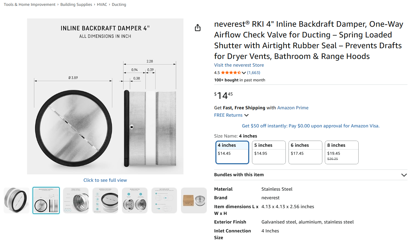

Hi! One of my goals this Spring/Summer is to better air seal our house. My boiler room has a fan-in-a-can which lets in a tremendous amount of cold air when the boiler isn't running. I re-wrapped with foil wrap all the connections in the rigid metal vent to prevent air from leaking out from those connections (many of them weren't fully sealed). I am going to seal the penetration with spray foam where the rigid metal vent exits the rim joist (which currently lets in a huge amount of cold air). I was also thinking about sticking one of these spring-loaded inline backdraft dampers into the duct right behind the hood where it the duct exits to the outside.
Is there any reason not to do this? When the fan-in-a-can is triggered to operate by the boiler turning on, should the pull from the fan be enough to open the backdraft damper?

    I would be rather cautious. Yes, it will probably work — but I wonder how much or if it will restrict the airflow, or even possibly change air pressure in the boiler room.
    Also, I would want to know just how much the boiler depends on air from that source — or to put it another way, if something should prevent that damper from opening, would the boiler still have enough air to fire properly? If not, you'll need a safety switch on it…
