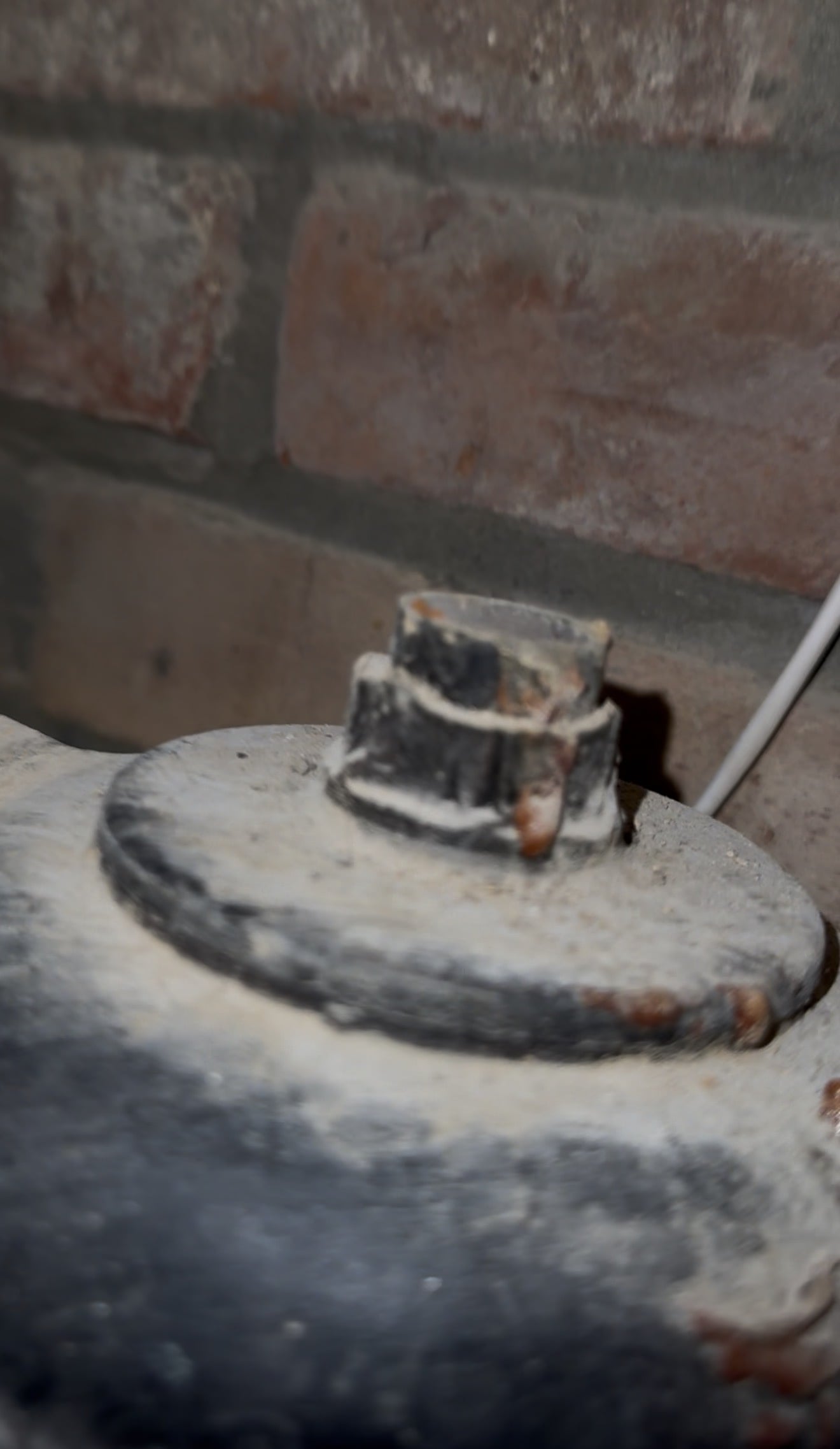

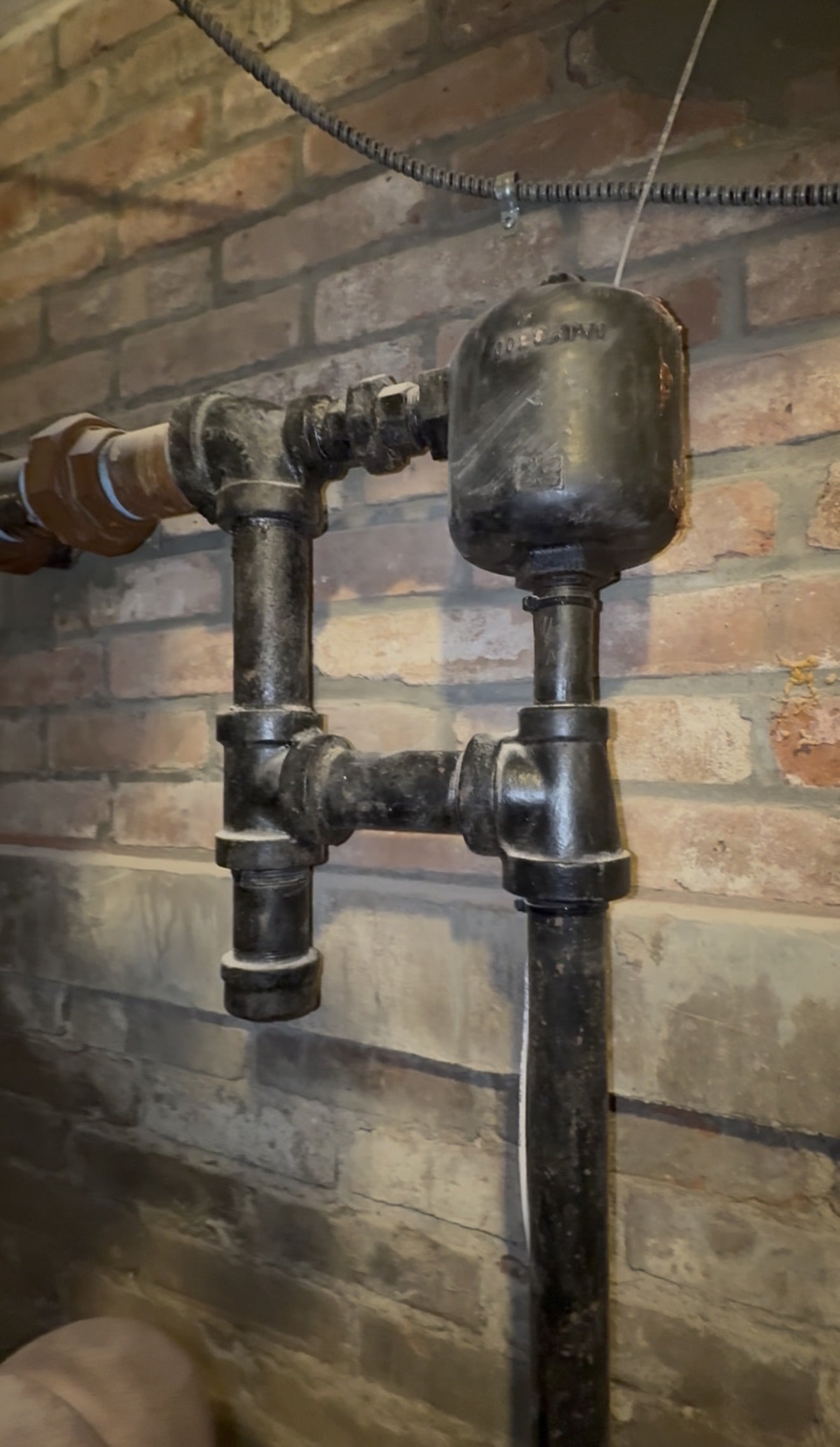

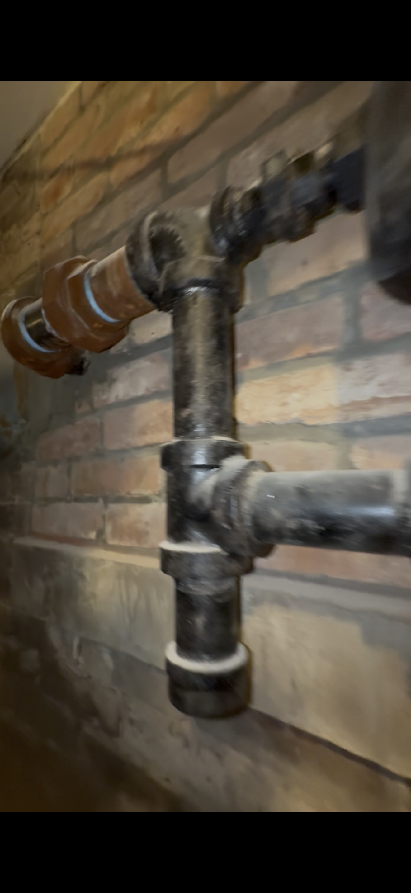

I have a Webster vent/trap (marked “0023 ATV” on the front) that recently started blowing steam out of the top. This began shortly after a contractor modified the wet return.

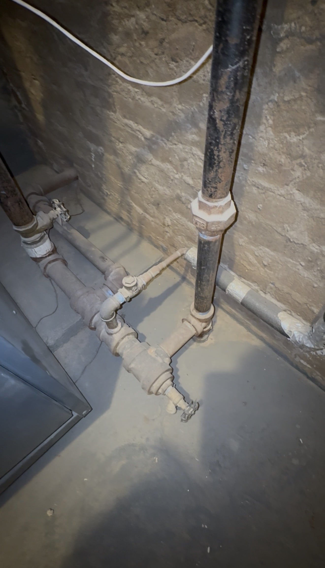

Originally, the wet return ran straight into the boiler. It was re-piped lower, creating a U-shape to get under a set of steps that were built. Not sure if that change could be causing this issue, but the timing lines up.
My questions:
– Could the wet return modification be causing this vent to pass steam?
– What is the proper replacement for this Webster unit?
– Can I replace it with (2) Gorton #2 vents on an antler, or is that not appropriate for this setup?
Appreciate any advice.
    shouldn't be steam in the returns.
    need to know more about how this pipe was changed, was anything tied together higher than it was originally? if it was truly a wet return and was just a pipe with nothing connected to the section that was changed, going down then back up shouldn't change anything.
    did you skim the oils from the new pipe off of the boiler?
    Steamhead Posts: 19,007
    As long as all the piping in the second pic is below the boiler's waterline, you should be OK. I'd look for a bad trap that is letting steam into the dry return.
    Semi-retired
    Mad Dog_2
    edited April 29
    The guys above. That vent blowing steam is a symptom, not the problem. As was said, steam should never, ever reach that vent or be in those pipes. So… two possible problems. The easy one is that the system cutout pressure is too high. The boiler should cut out at no more than 8 OUNCES per square inch (half a pound). Less would be better — Websters (and most similar systems) run just fine on a maximum pressure of about 6 ounces.
    So step one. Get down to the boiler and reset the pressure cutout device to a cutout of 6 ounces and a differential of 3 ounces. If it won't go that low, get a vapourstat and use it instead.
    Then the second possibility is a failed trap somewhere on the system. Could be almost anywhere, so you may have some detective work to do. May be more than one trap…
    Actually there is a third: in the work moving that pipe you reference, some piping intended to be a water seal may have gotten changed. Look for that, too.
    Edit: and one more thing. Don't change that vent until you find the real problem…

    That should be a Webster 02H trap.

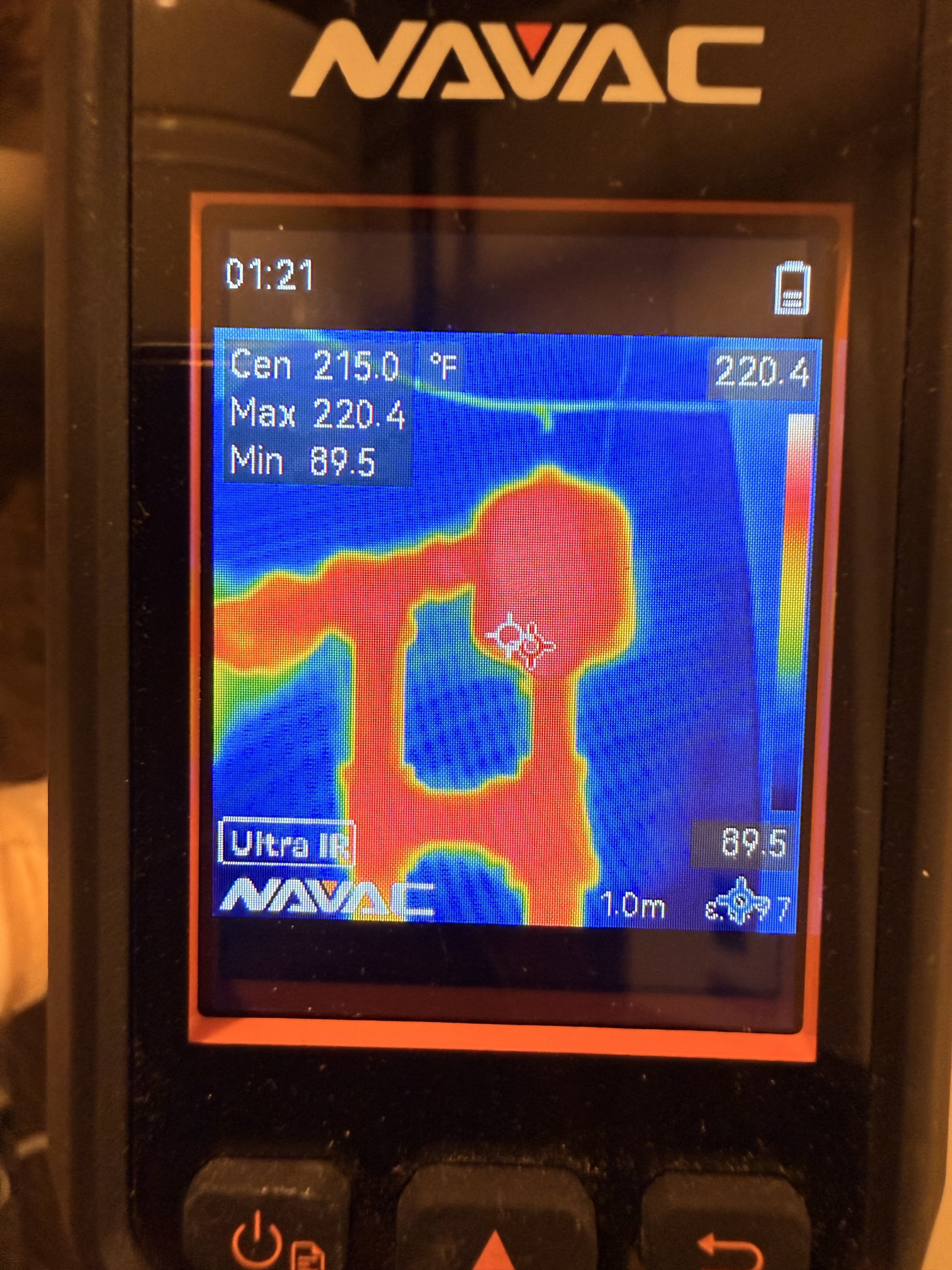

  • Ran the system for about 45 minutes to an hour until everything was fully heated. Once it got hot, the vent trap started hissing loudly and blowing out hot air (not visible steam). Also noticed a small water drip at the union near the vent trap.
    Let's try this again. That vent CAN'T get hot if there isn't steam in the dry return. There CAN'T be steam in the dry return unless a trap or water seal is blown. There should NEVER be steam in the dry return.
    Don't shoot the messenger — you have a problem or more likely problems elsewhere in the system. Find them and fix them.

    Use the "Ah-ha-ha Test for the Presence of Latent BTUs".
    That's where you put your hand on the dry return and when it gets hot enough that you yell "Ah-ha-ha" and your hand involuntarily pulls away from the pipe, you know there is steam in that pipe (thanks to @DanHolohan for that one).
    Follow the steam until it leads you back to the bad trap. There may be more than one.
    You can also use your thermal camera, but that's not as dramatic.

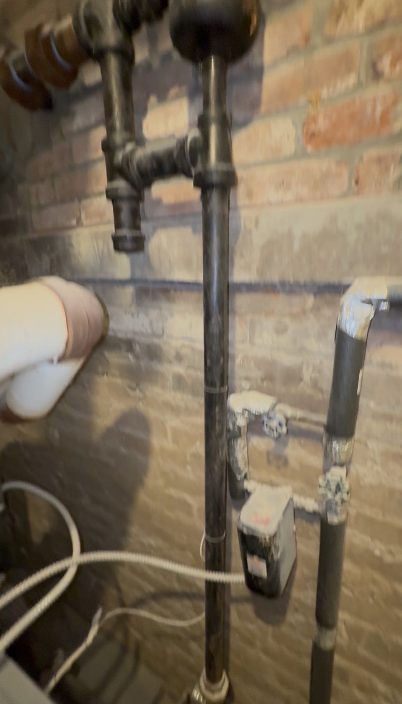

    the gray pressuretrol is the operating control and the pressuretrol with the clear plastic cover is the safety control, it is there to shut down the boiler if the operating control fails to cycle the boiler. it has a manual reset and will stay off until the red button is pressed if its setpoint is reached.

    Thank you for the input, I appreciate the help. We’re planning to replace all the radiator traps. In the meantime, we’d also like to address the vent trap at the boiler—would stacking Gorton #2 vents be acceptable there, or is there a better replacement option you’d recommend?
    two Gorton #2s on a little antler should be ample.

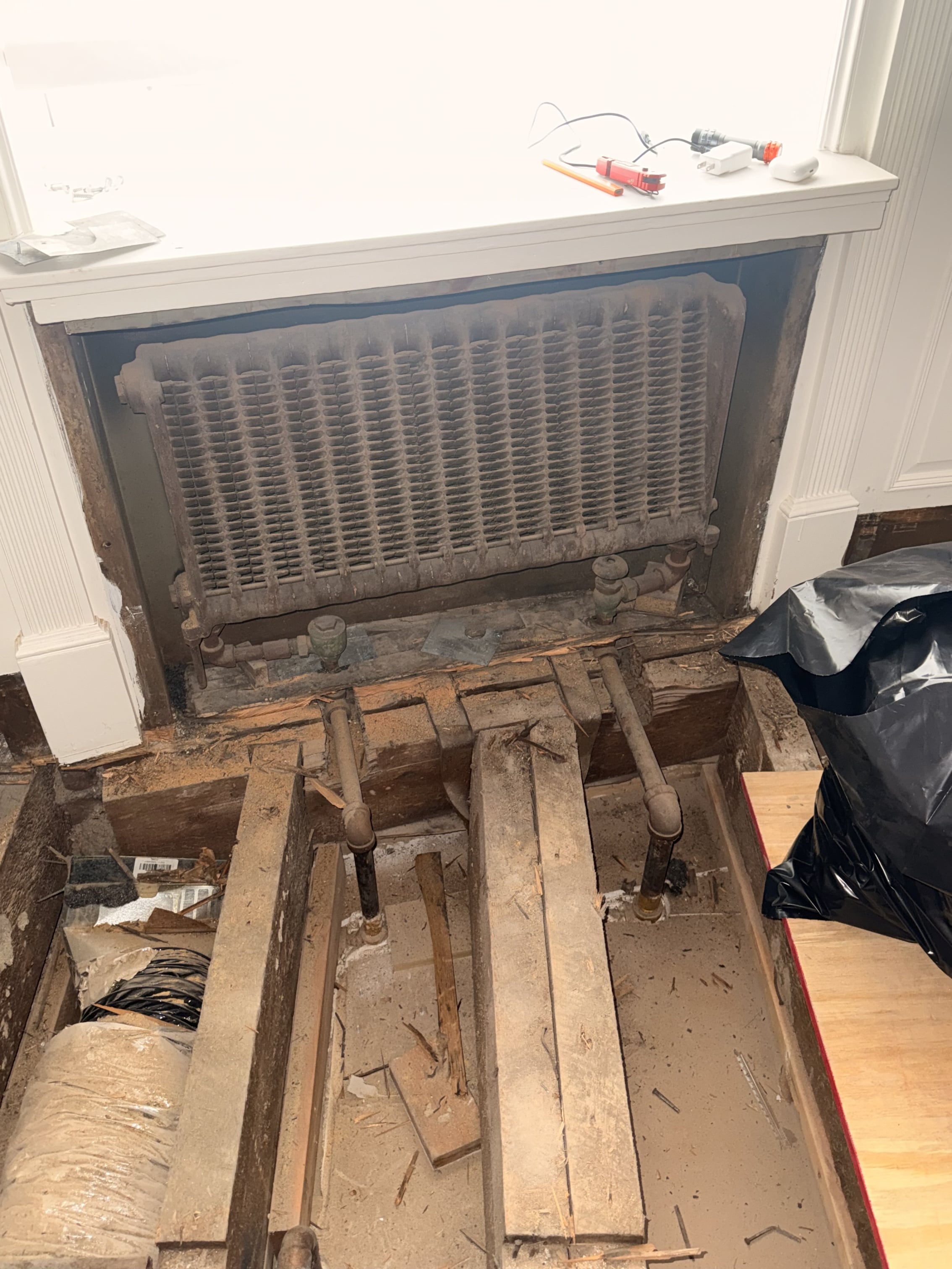

    I found that one radiator was removed and the piping was reconfigured like shown in the photo could that be causing the issue?
    Also, the system has about 30 radiators total and they’re planning to remove 4. Would that create any problems?
    BINGO! Remove that improperly-installed crossover pipe, cap the runouts and I'll bet the problem disappears.

    This work was done just a few weeks ago, but they’re saying the steam issue at the main vent trap was happening even before this crossover at the radiator. I’m thinking that points to some failed radiator traps, with this piping change possibly making it worse.
    Should both ends of that radiator piping just be capped off?
    Yes. Fix this and try it again, see what happens.
