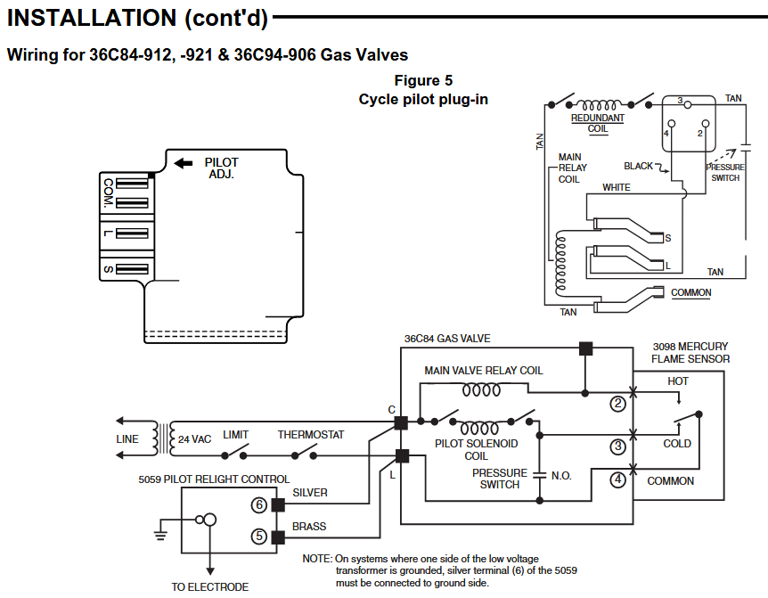

Replacing that valve - per SupplyHouse.com they said 36c84-912 was a direct plug and play match. the 209 fires right up but only .5"wc - so weak. 912 lights pilot, but main doesn't open. Has same terminals, same 3-prong (one larger) w/ matching numbers - all looks good except mgv not opening. Bad valve? Sure wouldn't think any re-wiring should be done, but dunno.
Help is surely appreciated. And, don't have model/s# - tags are unreadable, but since 209 'works' I only need a direct plug and play match. TIA

    Just curious why you would need to know that - I can check. But, my question is: is the 912 a direct plug and play replacement as far as no different wiring needed? BTU of the 912 is correct. The main valve in the 912 not opening.

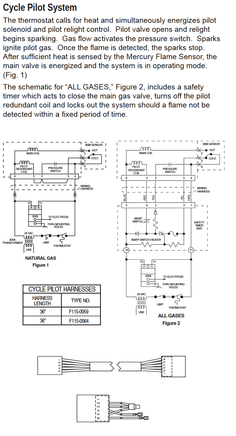

    Sounds like you need a mercury flame sensor
    EdTheHeaterMan Member Posts: 12,674
    edited April 29
    I refer you to the question I would ask the technicians that worked for me. It happens to be my signature tag line just below this comment.
    I had two customers with that gas valve / mercury flame sensor set up. I seem to remember that the three prong Mercury Flame Sensor (MFS) was something that I replaced often on both customers. It seems that the original lasted 30+ years but the replacement MFS were problematic and didn't last very long. I actually remember that one of the MFS failes within one year and the place I purchased it honored the 1 year warranty. they were affiliated with Johnstone Supply at the time so the main office had a policy for that warranty. Today that store is a mom and pop supply house because they didn't have a large enough property to provide the minimum amount of floor / warehouse space and they only had street parking. Bye Bye Johnstone. Hello American Parts co.

    Having two valves with almost the same symptoms is curious. I don't see why the wiring would be different, they are the same Model number series.

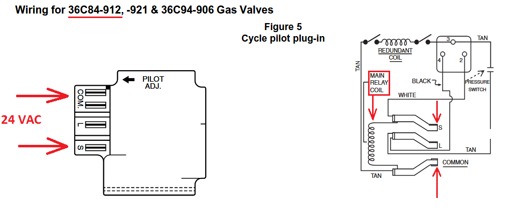

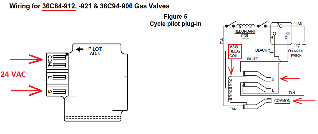

    If you truly believe there is a wiring difference, prove it, is there 24 VAC getting to the Main Valve solenoid coil when there should be. If not, why not.
    During a call for heat I would monitor the inlet gas pressure and verify there is 24 VAC across both solenoid coils with the focus on the main valve coil, since the pilot works.

    What I am ONLY hoping to get here is: are these 2 valves completely interchangeable - plug and play - same wiring.
    Maybe my first post should have been - is a 36c84-209 wired EXACTLY the same as a 36c84-912.

    Pretty sure you would have to get direct with the manufacturer to see if they are exactly the same. everything I can find, including on supply house lists the new one as a cross reference, I have not seen any mention that the replacement is exactly the same. If you know how the original needed to be wired, and you have the instructions for the replacement, it should be pretty easy to determine if there are any required wiring changes.

    I doubt the 40 year old valve is exactly the same as the new one. It would not surprise me if the solenoid is different. Engineers like to eat so they redesign things that otherwise appear to work fine. And they may have simply redesigned it to do exactly what you are seeing, old valve possibly partially opening, the new one does not partially open under the same conditions.
    This electrical circuit looks easy to troubleshoot. You say the gas pressure is good so only the electrical remains.
    Also it would not surprise me that a defect with the Mercury flame sensor switch contact behaved differently with valves that are 40 years different. The pull in current may be different.
    And for all I know from here, the old main valve may simply be leaking and not really opening, hence the low pressure to the manifold.
    To me there is two things to prove, gas pressure and if the is there 24 VAC getting to the Main Valve solenoid coil when there should be. If not, why not.
