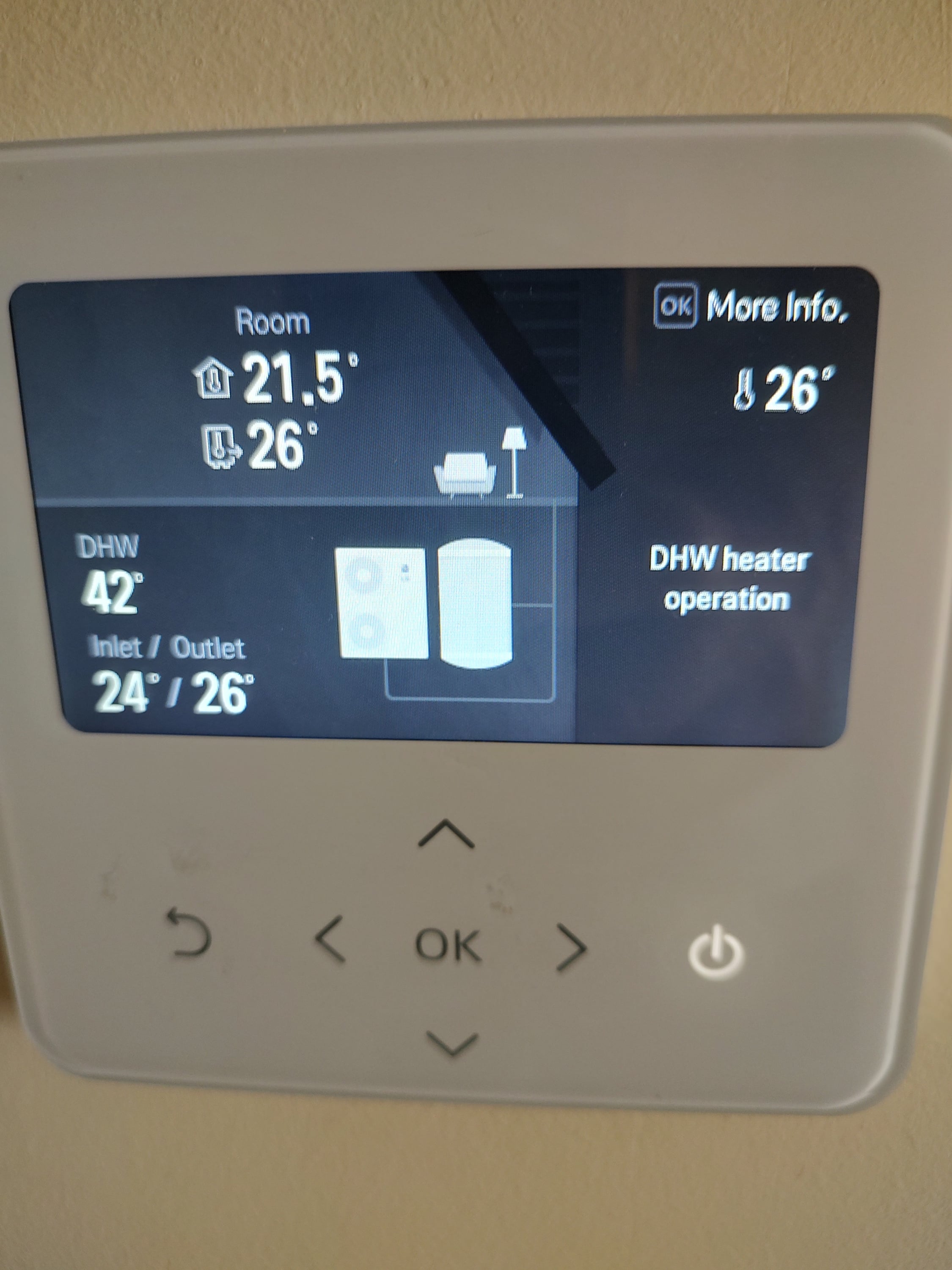

I have a 9kW LG Therma V monobloc heat pump installed two years ago. I’ve hit aan issue where the unit has stopped engaging the DHW cycle, eventually falling back to the immersion heater after the programmed 30-minute delay.
The Symptoms:
  • Space Cooling/Heating: Works perfectly.

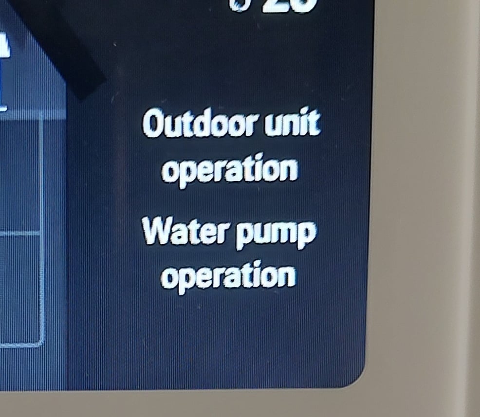

  • Cooling/Heating on - DHW call: When a DHW cycle is called, the outdoor unit remains in heating/cooling mode. The controller displays “Outdoor unit operation” and “Water pump operation.”

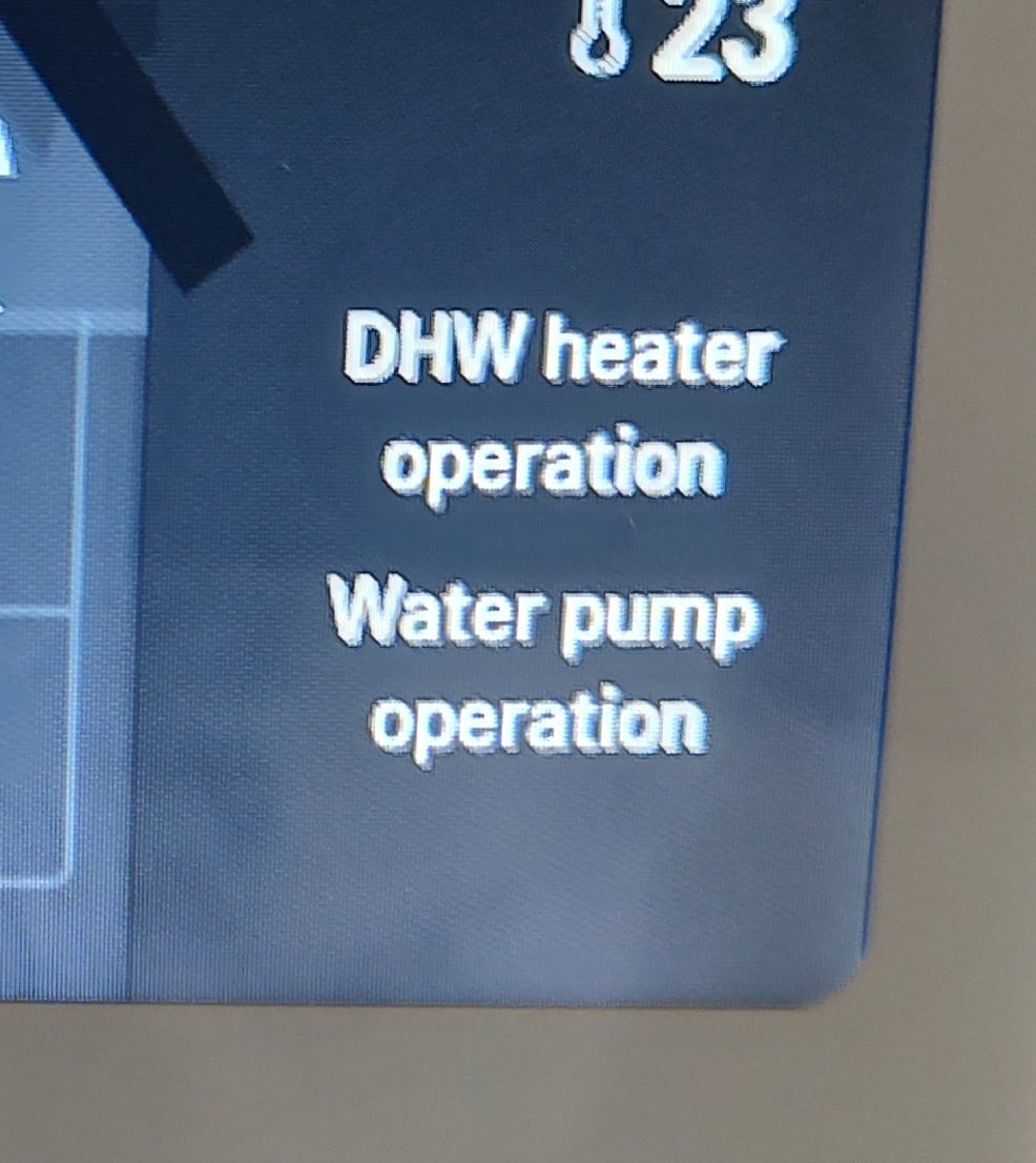

  • Fallback: After the 30-minute delay, the internal immersion heater kicks in. The display then changes to “DHW heater operation” and “Water pump operation.”

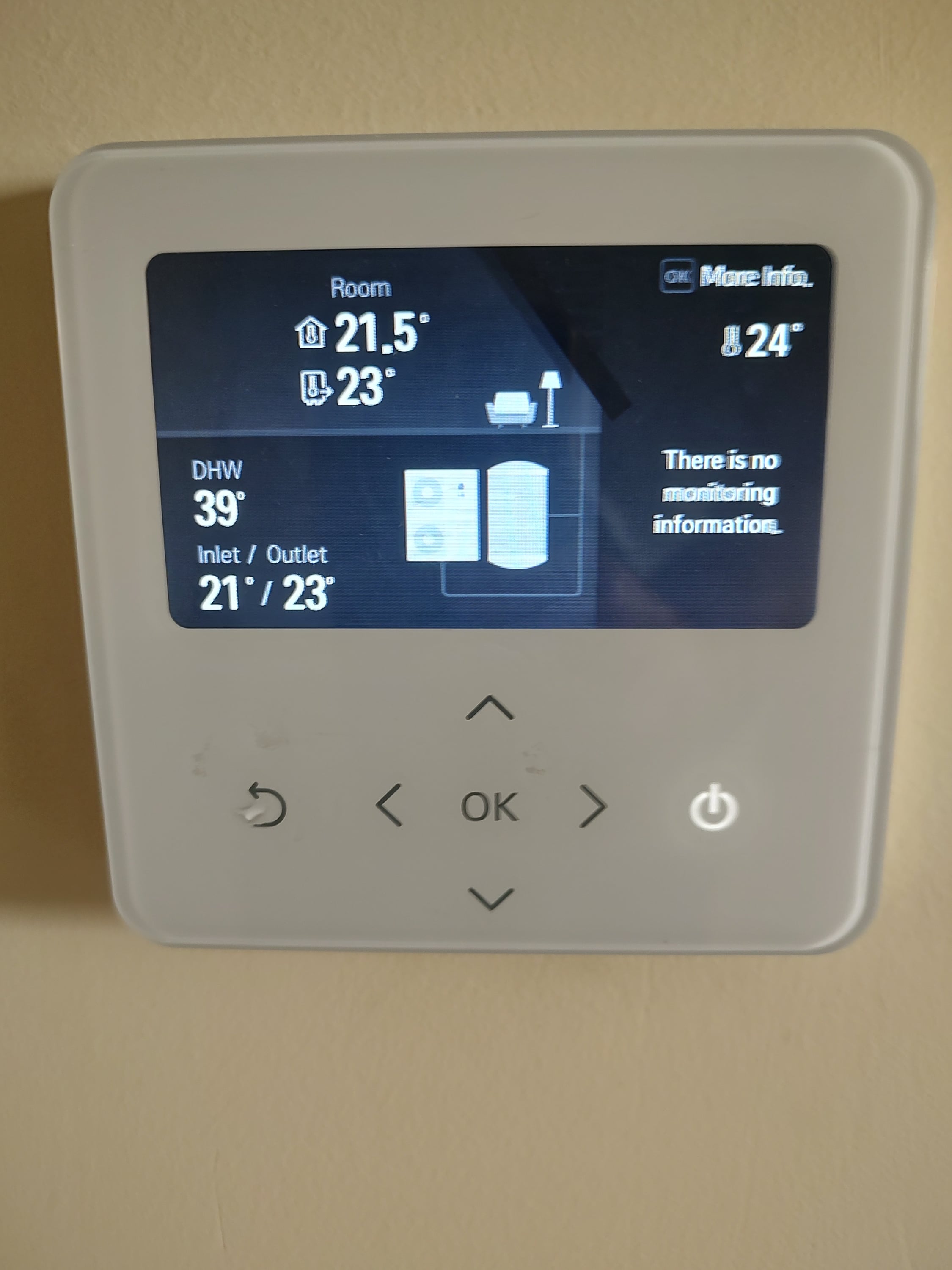

  • Cooling/Heating off - DHW call: When a DHW cycle is called, the outdoor unit remains idle. The controller displays “There is no monitoring information” for the first 30 minutes.
  • Fallback: After the 30-minute delay, the internal immersion heater kicks in. The display then changes to “DHW heater operation”.

In the pics I just switched off from cooling mode, so the feed and return temps are residual from that. After a while the feed and return temps become equal.
