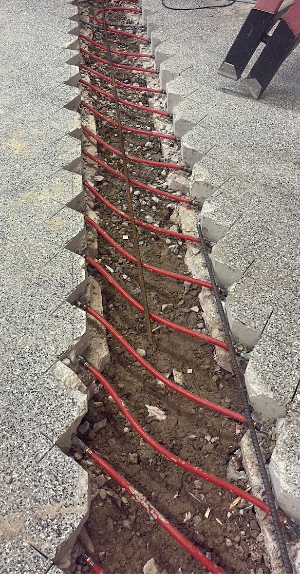

I'm adding a bath to the read of my shop space to create an ADU.
Unfortunately I needed to cut a utility trench through a slab that is only a few years old.
I do want to retain the radiant heat so I came up with a method to re-attach the cut loops.
The loops are 6" OC so it required a number of couplings, and some concrete sawing.

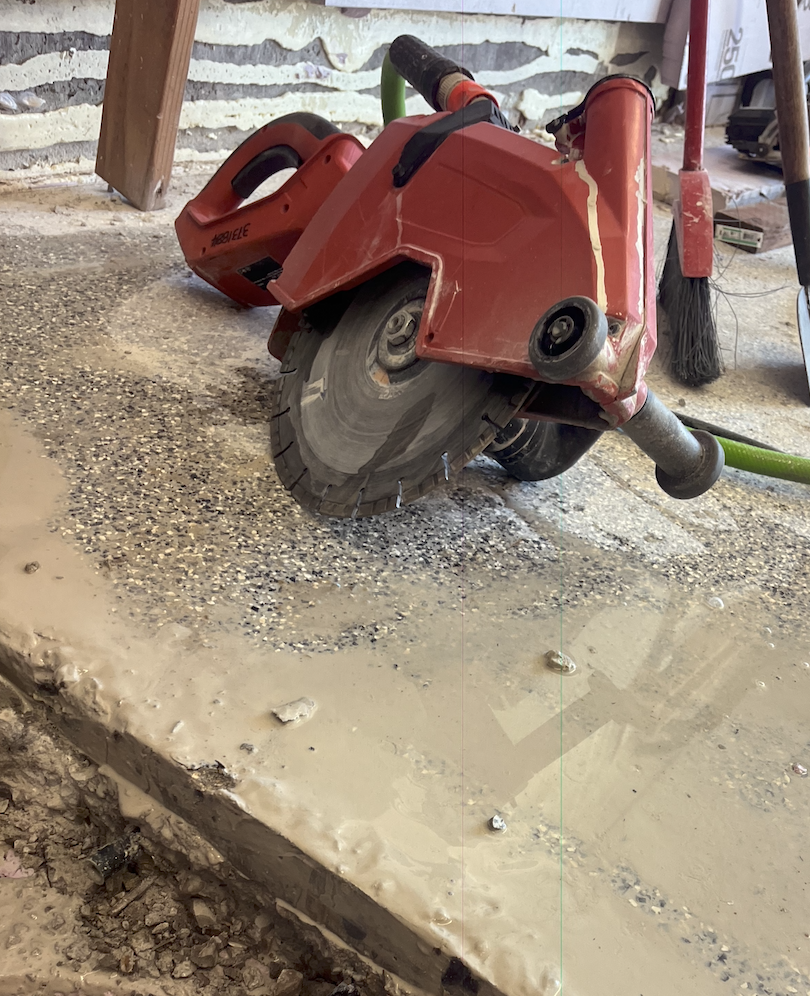

These 12" electric hand concrete saws work amazingly well. I used a gas powered walk behind sam for them long cuts. The hand saw was just as fast to cut, actually.

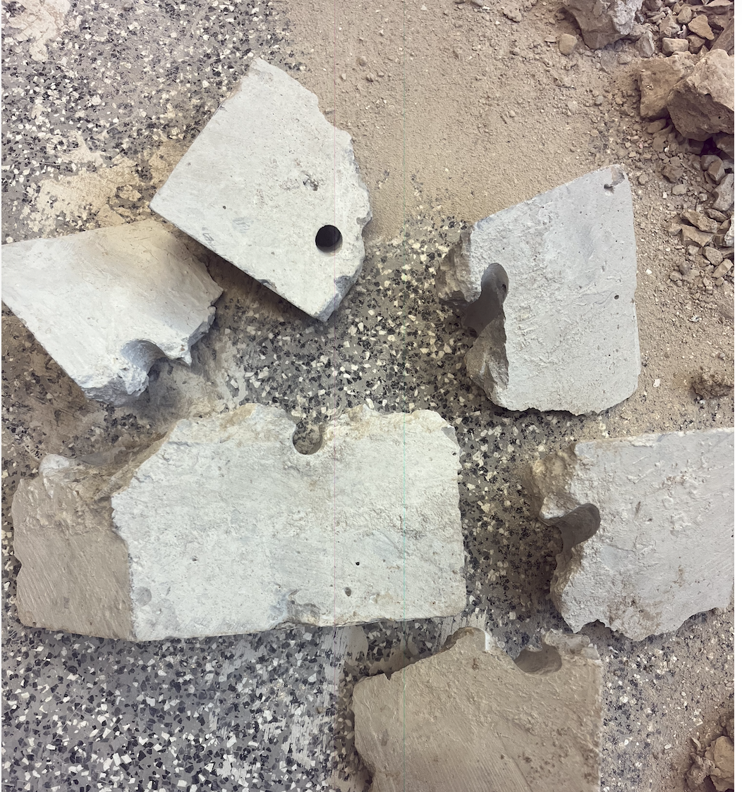

I used the wet saw to cut parallel to the loops first. Then a cut across the tube about 1-1-2" deep. The piece came out easily with a chisel. Luckily concrete doesn't stick to pex, so the tube was undamaged to reconnect. This provided just enough room to get a crimp tool around the tube.
I can slide some insulation below the tubes, some rebar to keep the pour stable.

    Maybe its the pic but those pex lines look pretty deep in the slab. Looks like they are on the bottom of the slab.
  • I would have trusted Uponor’s joining method more than crimp rings. Also, less pressure drop when you add up all those splices, no?
    hot_rod Posts: 28,705
    I thought I had done a better job of suspending the mesh on 2” foam blocks You learn a lot when you cut into a slab 🫢

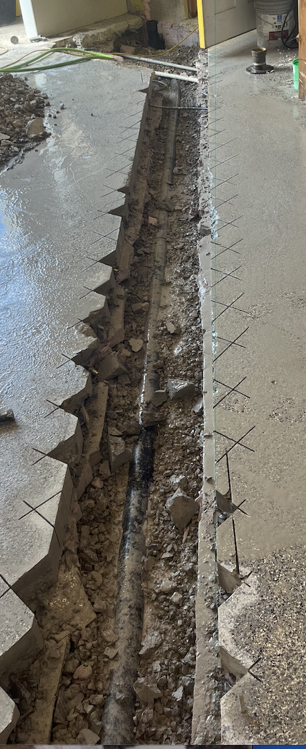

    I did get to un disturbed ground to put in the sewer line, I wet the back fill to help settle it
    Not a bad idea to pin it across with some rebar drilled into both sides

    The black pex is Viega B pex, I didn’t want to expand that
    I looked for a crimp x expansion coupling as the red pex is Mr Pex, A pex

    I looked st sll the options fir routing and the line does run to an ejector pump located in the shop that is connected to this space . I looked at an over the top product also, but height is tight.
    The cutting was easier than I thought, took about an hour and 1/2
    Splicing and crimping took a lot longer
    It was as much about the challenge as the destination.
    Loop flow is under 1/2 gpm, so the 80 couplings are not too much of a restriction to flow
