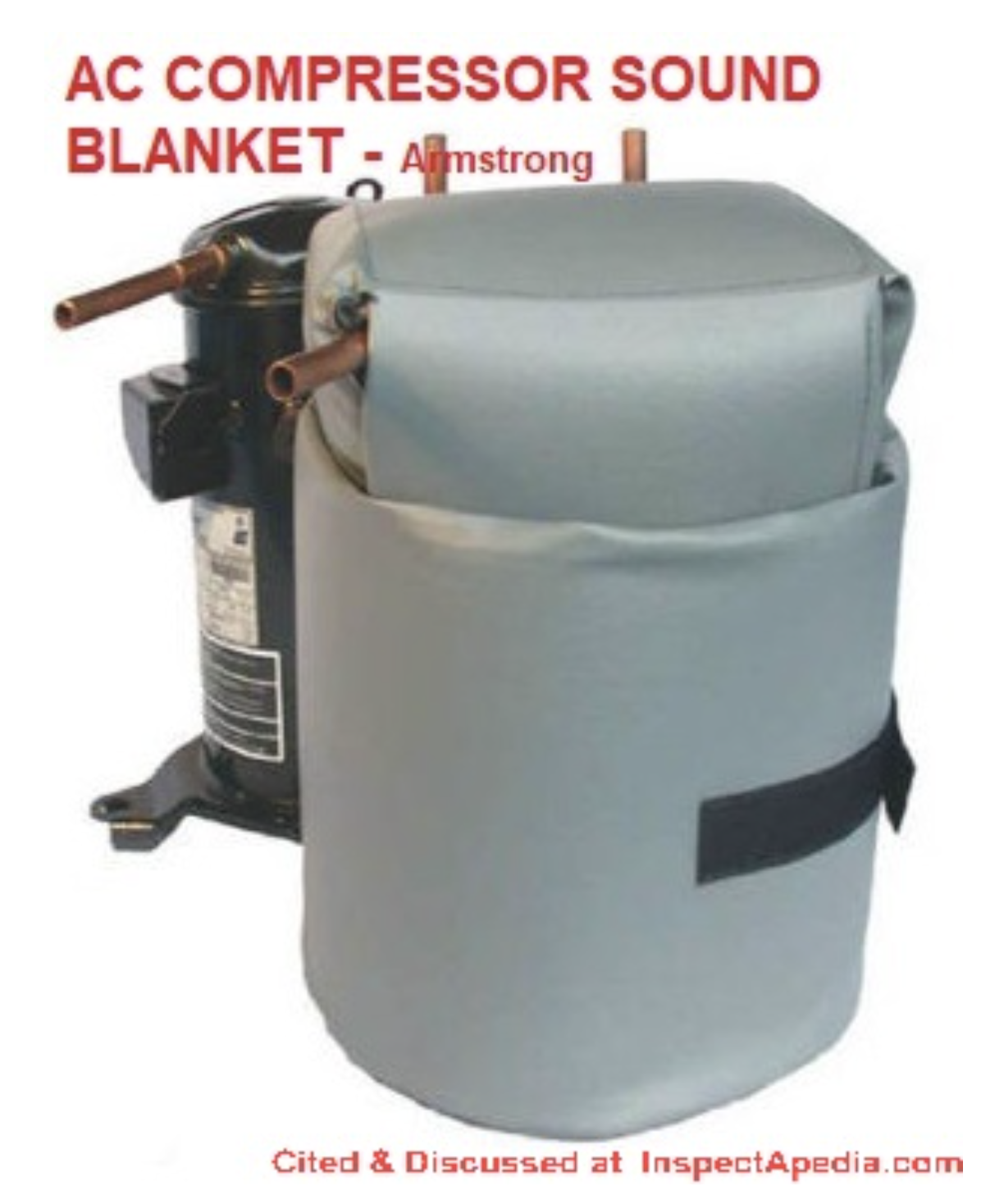

    The high end condensing units that boast about low noise have an insulated compressor blanket that can substantially reduce the compressor noise.  Look inside the condensing unit and see if there is a vinyl cover on the compressor.  If not, then look for something like this for your problem.

    Thanks. The noise is initially the loud clack of the contactors, then the drone of the compressor, complete with a buzzing line (I presume) and the fan isn't terrible, but not quiet like the Mitsubishi ductless conditioning the ADU. I'll look for a blanket on the compressor, but believed we were getting a premium system anyway. I'm planning on getting the contractor back, but want to have information before they arrive.
