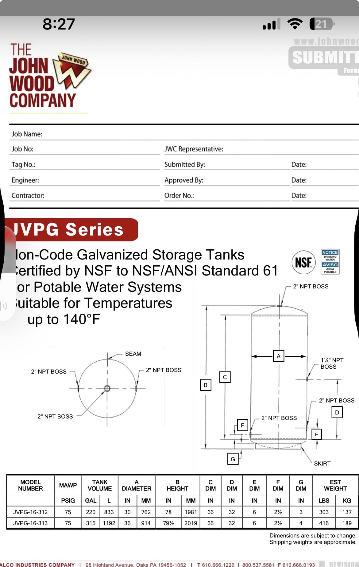

So I have been buying John Wood tanks, and I really like them. https://johnwood.com/wp-content/uploads/2014/03/JSTR.pdf
But I need 2- 400 gallon tanks, and Im limited on height. 3-300 wouldn't be good but Im limited on space. Anyone know of any other big steel tank manufacturers that would ship to VT, and have perhaps a 400 that is a little bigger in diameter, making it a little shorter?

    I dont need to be insulated. I dont NEED ASME, but this is for wood boiler storage so it's nice because it's so big and typically entombed to not worry about having leaks later on. Not that it never happens but ASME typically are less prone. My ceiling is 94" and im very tight on space, so I need a tank that is 90" or so.

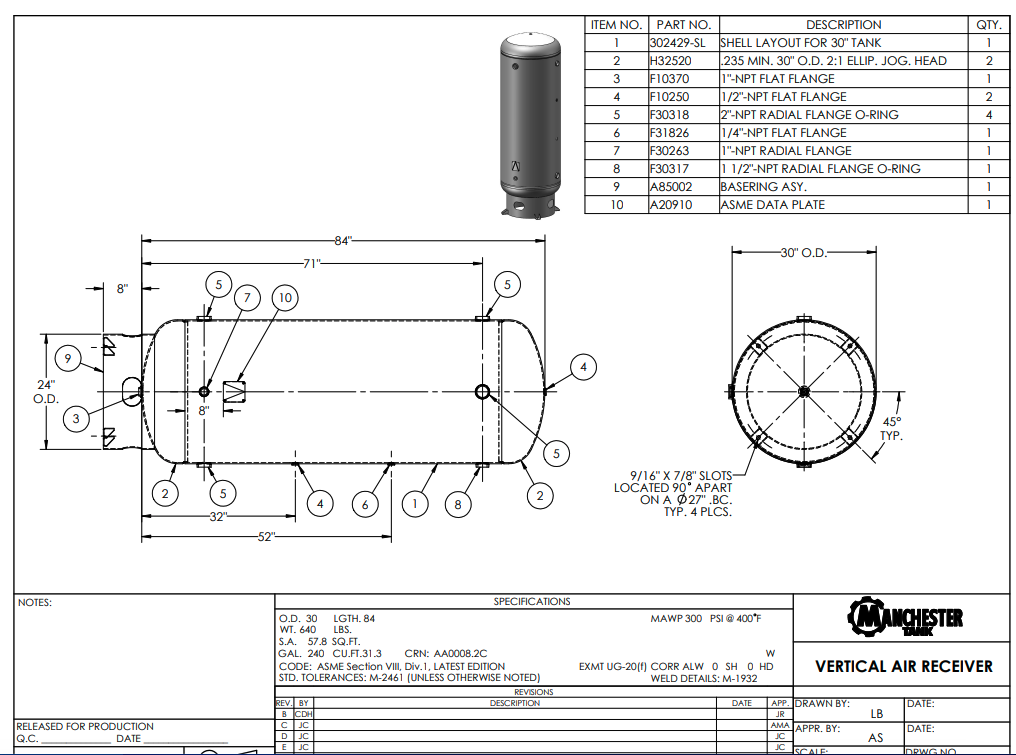

    Manchester Tank builds tanks for LP and compressed air. They have vertical tanks under 90"., here is a 240 G. probably an expensive tank.
    Can you mount a horizontal tank? Plenty of 300 and 500 LP tanks around>https://mantank.com/products/

    Dollar for dollar very difficult to beat the John Wood Company. They make great tanks, and at the right price. I guess we will have to try to figure out a different location at his house!

    these 75 psi galvanized tanks should work dimension is in the ballpark

    I saw those but I want the tanks to run at 180, and if I read it right, they only go up to 140
