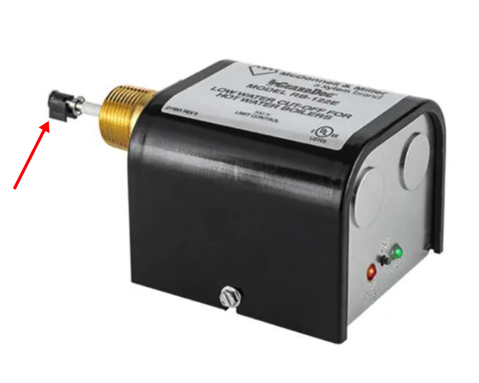

It has a plastic spinner on the end. It keeps the probe clean with the spinning action
it moves with the water flow thru the pipes, not so good on a steamer.
