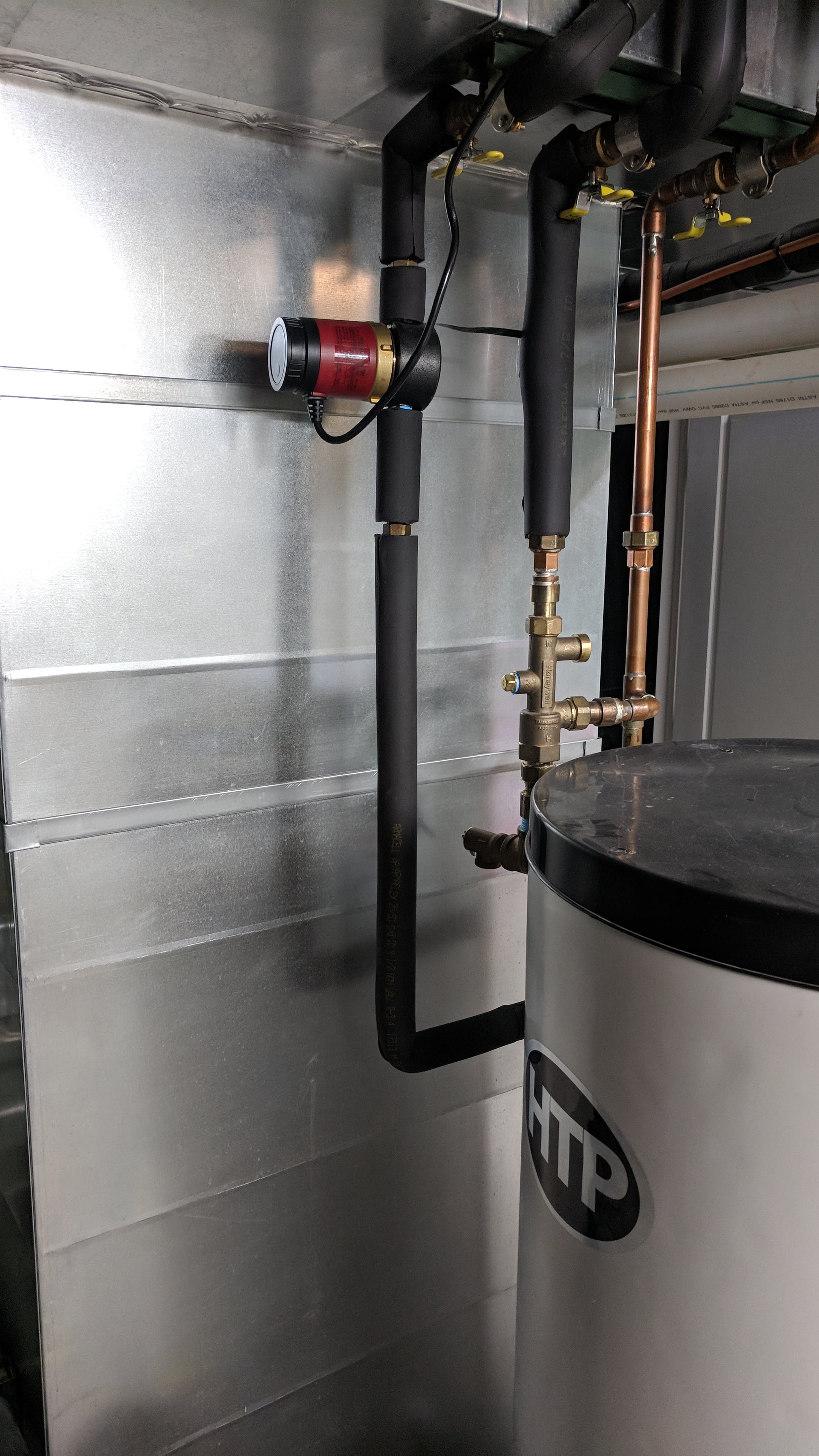

Couple questions regarding my DHW situation:
  1. Has anyone here had success getting HTP to replace an indirect water heater that has a lifetime leak warranty where it is NOT for the original homeowner?
  2. I'm seeing a very small amount of water accumulate underneath the tank and the connection points are dry— I assume this means a leaky/busted tank and needs replacement.
  3. Should I be replacing like-for-like (with another SuperStor Ultra 60)? Or is there a different brand I should be considering (note: this is used in conjunction with an HTP UTF boiler and provides both potable water and radiant heated floors)?
  4. Does anyone have a good resource on how I can flush an indirect tank myself (what valves to shut off, do I turn off the boiler / recirculator, etc.)? The setup at my place seems quite complex (previous owner was a commercial HVAC engineer) complete with expansion tank and thermal mixing valve. IMG_20180721_121652.jpg
Thanks everyone in advance!

    Why am I looking at a recirculation line and mixing valve but not the leak? Stiff neck?
    P.S. and off topic. Whats the dimensions of the duct near the indirect. It looks a little large to just be using S slip and drives.
    P.P.S. Show the leak.

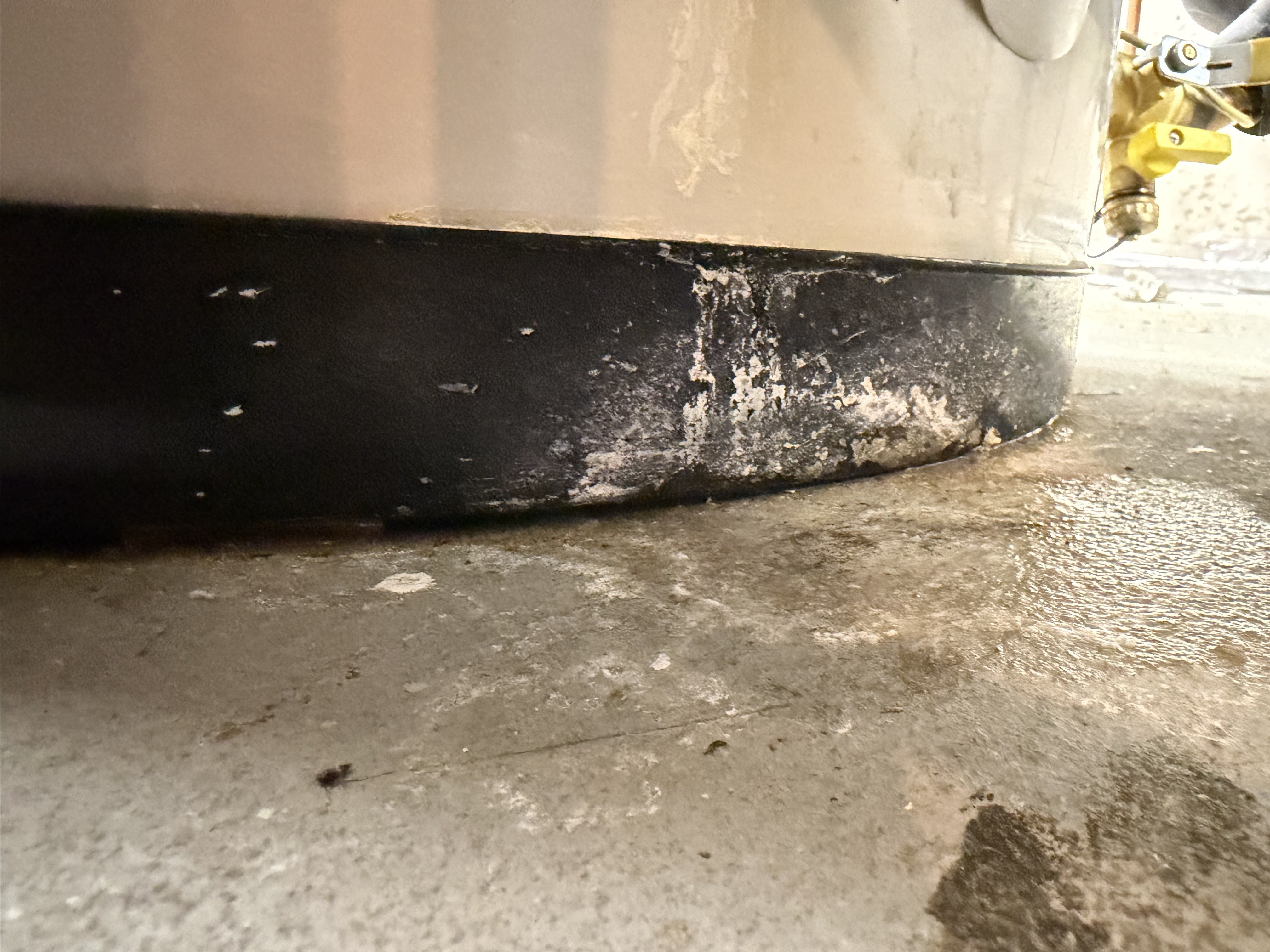

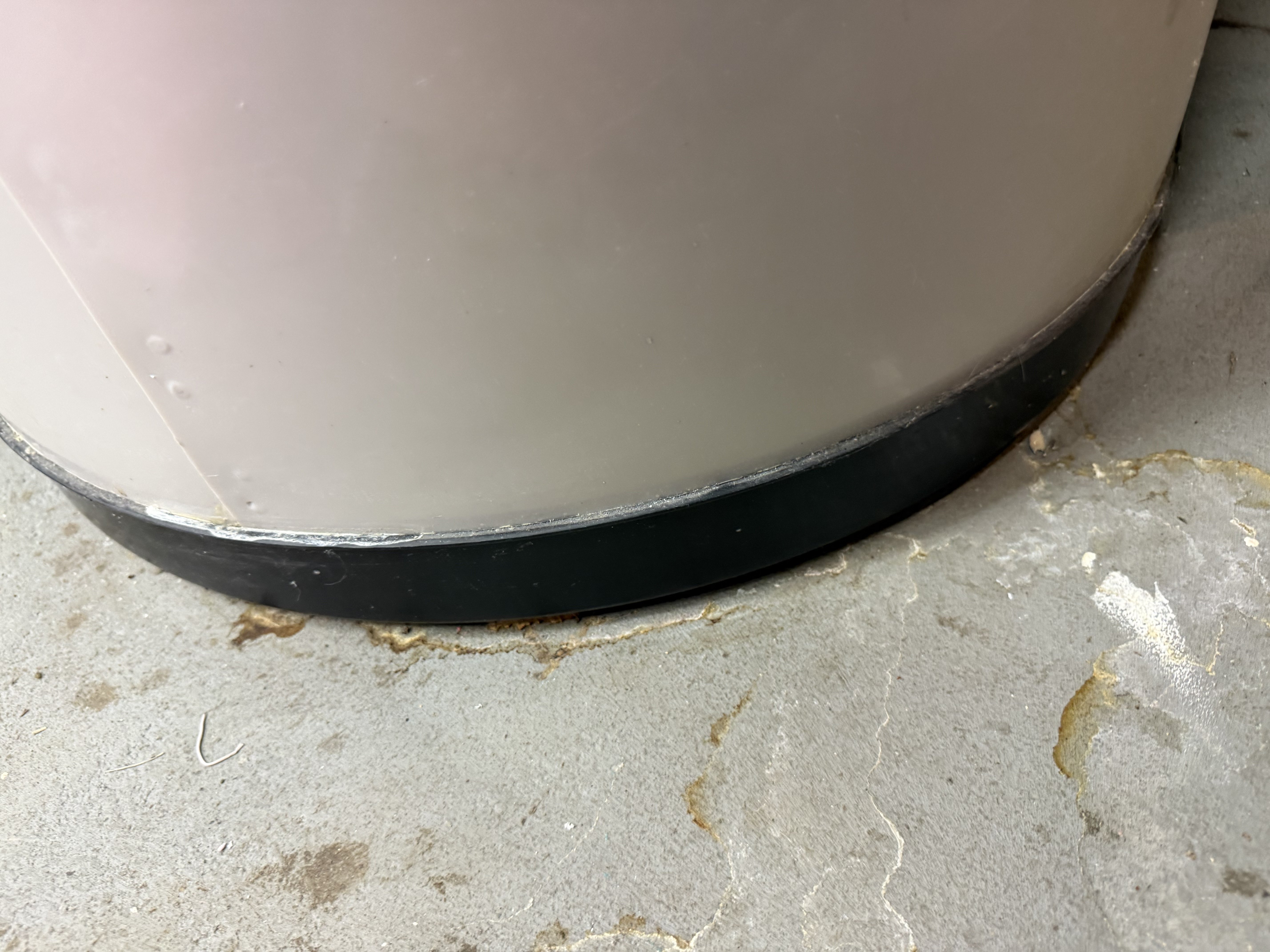

    Thanks all for your responses! Here's a pic of the "leak" but can't really see where it's coming from.
    We are hooked up to our municipal water supply— https://www.chicago.gov/content/dam/city/depts/water/WaterQltyResultsNRpts/ccReports/CompChem_2025_Q1-Q3.pdf
    Our water is from the stats in the far-right column. Pulled out some key values below—
    Our chloride is ~16.5 mg/L, hardness (CaCO3) is ~145 mg/L, TDS ~180 mg/L.
    Tank was installed in 2015 (so ~11 years old).
    i see it is crusty on the side of the jacket, what does that lead to?

    In one of the pics the crusty stuff is above. Look carefully, it might be leaking from above and you missed it.
    mattmia2PC7060
    HVACNUT Posts: 7,784
    Look at where the pipes go into the tank. You can pull out the escutcheon plates for a better look.
    bbender0787mattmia2
  • I’ll take a look. There’s a slow leaking pinhole leak in a pipe to the side of and above the tank I’m having repaired. If you look at the OP pic, it’s the only horizontal section of pipe from the mixing valve. I didn’t think it’d be putting out that much water, but maybe I’ll dry everything up really good and see if I get any moisture for 3-5 days after the repair?
  • I’ll check this out this afternoon. When I checked all the connections, including the aquastat they seemed bone dry but I’ll pull off the covers and do a more thorough check.

    i'd put something under that drip and see if the tank dries up. depending on the humidity a drip is more than enough to make that puddle.
    is the relief valve dry? if there are check valves in the tempering valve and the expansion tank has lost its charge or is bad the relief valve will drip.
  • I’m going to do exactly that. Wiped everything down and dried it, have a mini cup at the bottom. Having the leak fixed on Monday as well. Here’s to crossing my fingers the tank is actually fine!
  • Relief valve is dry around and to the touch on the inside. Also checked underneath all the escutcheon covers and all dry there as well.
