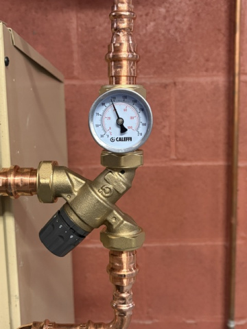

    it depends on what type of mix valve you have. If it is an ASSE 1070 listed valve it will not go above 120F. That is a point of use mix valve. Sometimes called an anti scald valve.
    If it is a ASSE 1017, those adjust from about 85 to 180F
    There are some valves that are dual listed and they have a stop built into the cap or the valve itself. That needs to be removed to allow over 120F
    Got a pic of the mix valve?
    If the tankless coil gets scaled that can cause temperature droop also. Has the coil been delimed?

    I don't have a pic of the old valve. It was just a dial that went to 160F and looked very basic in design. No gauge. I'm posting a pic of the one the plumber just installed. At present, we have it set to 5.5 on that dial. I've tried the shower a few times and it's "fine", meaning I can adjust the shower so that it is not scalding. It is hot, but the mixing from hot to cold is not a continuous or step-wise scale as the handle is turned. It goes to cold on movement to the handle rather quickly. Again, new Kohler mixing valve and balancing valve were installed. The scalding stop screw is not engaged on the handle. The lines were flushed.

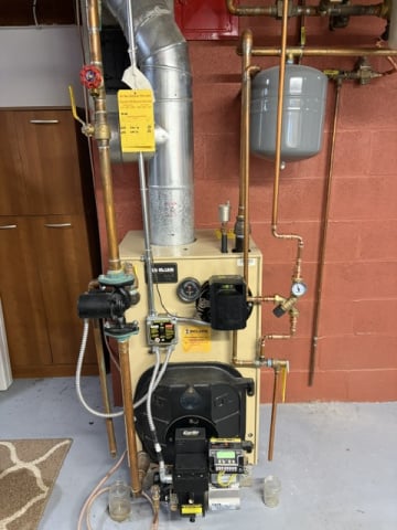

    Thanks Ed for your well considered summary and review of options and the pros and cons. It's incredibly helpful. I'm attaching a picture of the entire system. As I mentioned, when I asked about cleaning the coil, I was told it could not be done now at this age (13 years) and that is something that maybe should have been considered as part of early maintenance, but wasn't done. I wasn't given a reason (lack of maintenance valves or potential leak in the coil). It was intimated that it was unlikely to withstand the effort.

    I wonder what the boiler side of the coil looks like.

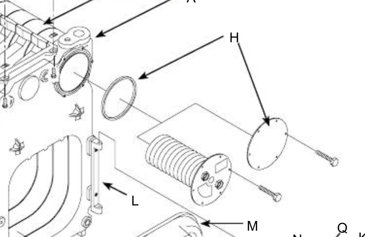

  • Larry Weingarten
    Larry Weingarten Posts: 4,210
    Hi, Here's a diagram of the coil. It looks like it should be replaceable. Seems you need to find the right person who has experience with this sort of job and see what $ they want to do it.
