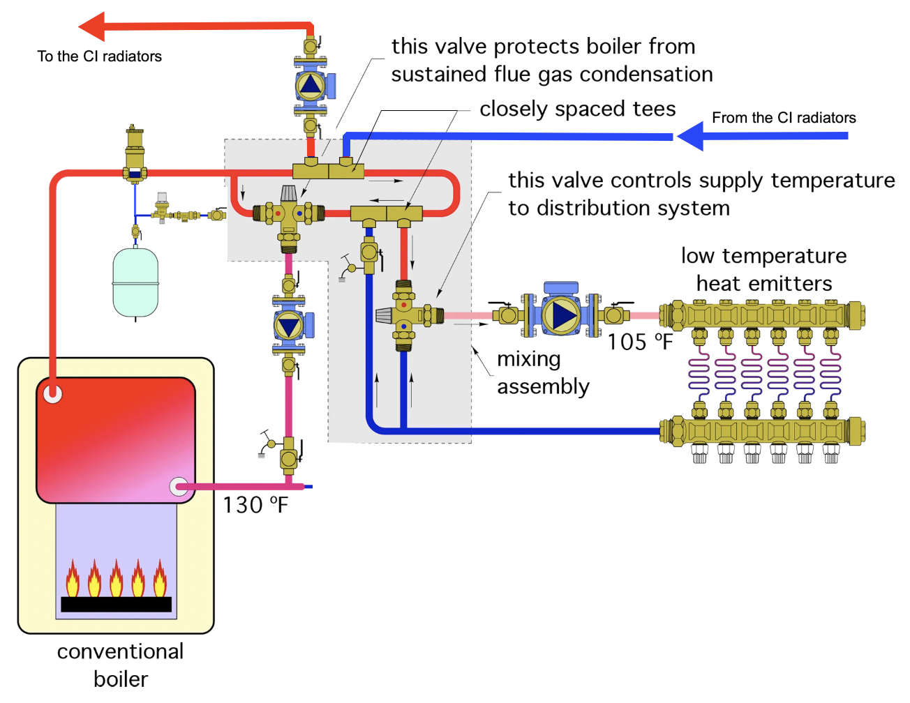

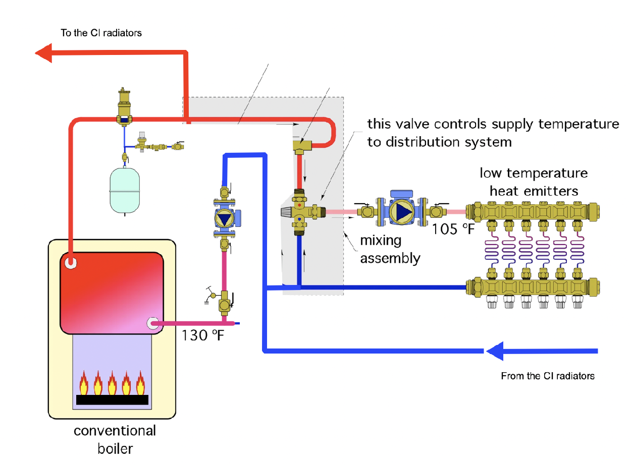

    This reinvention of the wheel sounds like someone has not read their radiant floor design guide.
    You can get any boiler to provide two temperatures with the use of a circulator pump and a mixing valve, without needing any other design features like a tempering radiator.
    This would be a simple design:
    The high-temperature water flows to the radiators as usual. The low-temperature water is cooled by the return water from the radiant floor loops and only receives a small amount of heat from the boiler as the mixing valve detects that the radiant floor temperature is below the mixing valve setting of, say, 100°F or 110°F. No additional device is required to deliver low-temperature water.
    If you are worried about condensation of flue gases causing a problem with your existing boiler, and there is no boiler temperature protection already in place, then this is the time to add boiler protection like the diagram shown below:

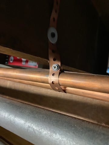

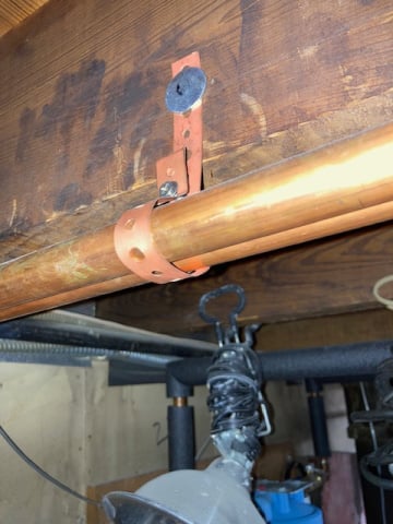

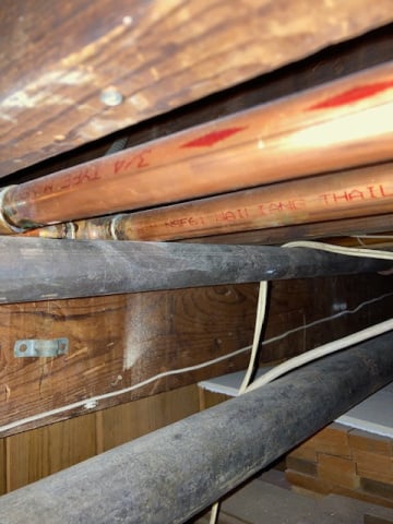

    Thanks for the response. I should have included photos in my original post. The first two show what I would describe the copper pipes being "deliberately strapped tightly to each other". The third shows the new copper pipe (in the background) resting on and supported by the existing cast iron pipe. Hopefully this paints a better picture.

    i'd be concerned about noise, but not about heat transfer or chaffing. they are using the same hanger but they aren't tightly clamped together like you would if you were trying to do something like heat any residual liquid refrigerant on its way to a compressor. it is sloppy but not an issue functionally.
    any heat that does transfer to the return gets circulated back to the boiler and back to the supply. maybe it makes the boiler run a degree hotter but that has only a very small effect on efficiency that would likely be difficult to measure. insulating the piping would have more of an effect on efficiency than separating the lines.
