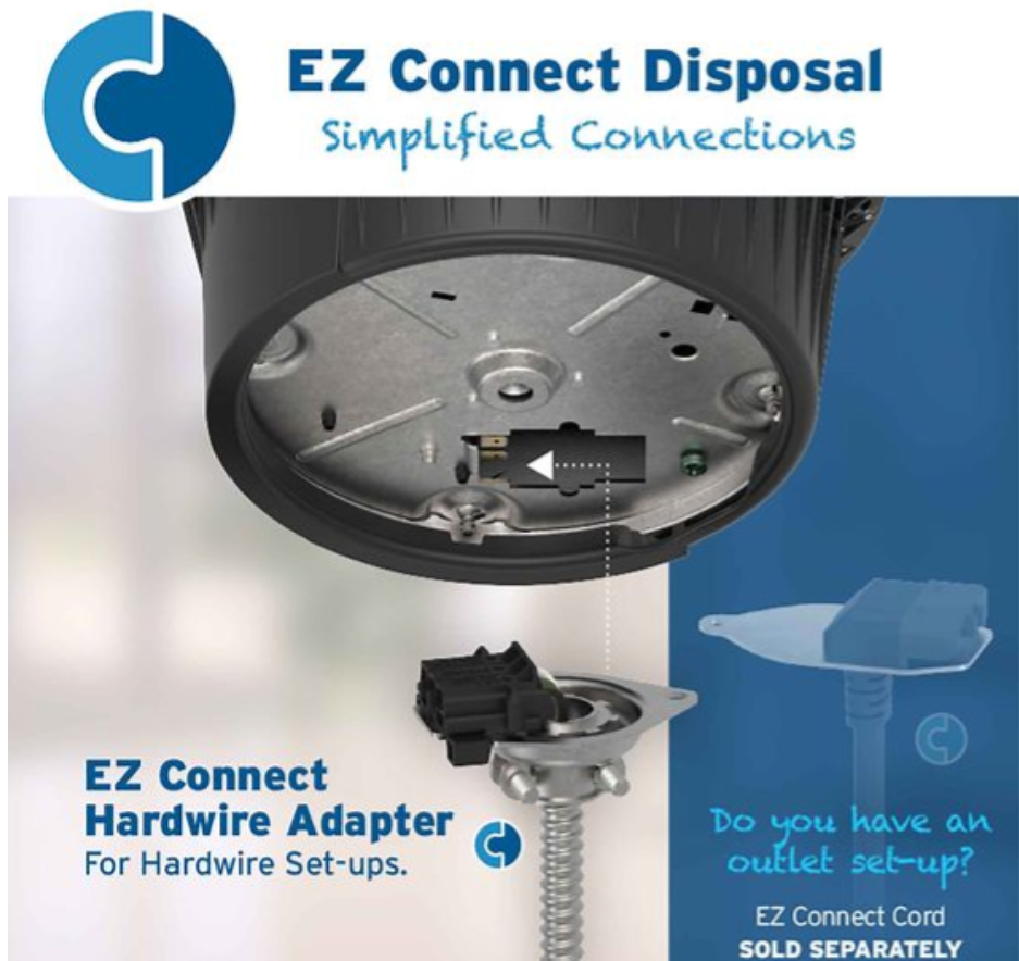

While I was laying on my back under the kitchen sink hooking up the DW drain I noticed the cord on the Insinkerator 750 PRO disposal (about 4 years old) was falling out of the disposal. Well, guess I might as well fix that too.
Guess I have been away too long as all the disposals I ever wired had a little junction box with 3 wires in (or 2 with a ground screw) it and a knockout and you either used a cord or hardwired it and connected it with wire nuts.
No more.
This thing has a rinky dink plastic connector that plugs on to the motor terminals and then the field wires plug into the other side of the connector…..like backstabbing a receptacle. How do you plug stranded wire into a backstabbed receptacle type connector ???…..you don't.
I knew something wasn't right.
When I got home I looked it up on line. The connector that come with the disposal is for hardwired only so you can plug solid NM or AC cable into it.
If you want to use a cord you have to go to HD etc and for $17 you buy the "Insinkerator Eazy Connect factory cord" which come with a plastic connector on the end to fit the motor connections.
The guy that originally installed it just tried to push the stranded wire into the connector with the backstab type spring clips. Didn't work.
Insinkerator say this was done to "help" diy homeowners wire their disposals. ……………..Not if they can't read the instructions. And Neither did the plumber who got paid to install it.
