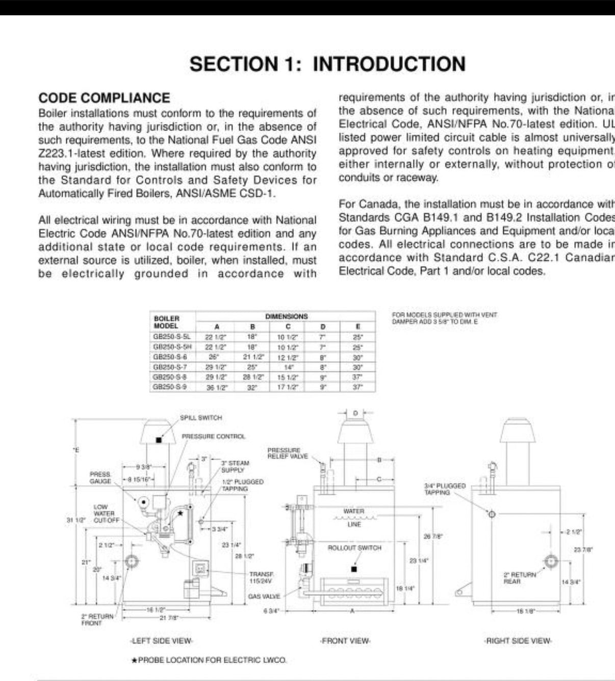

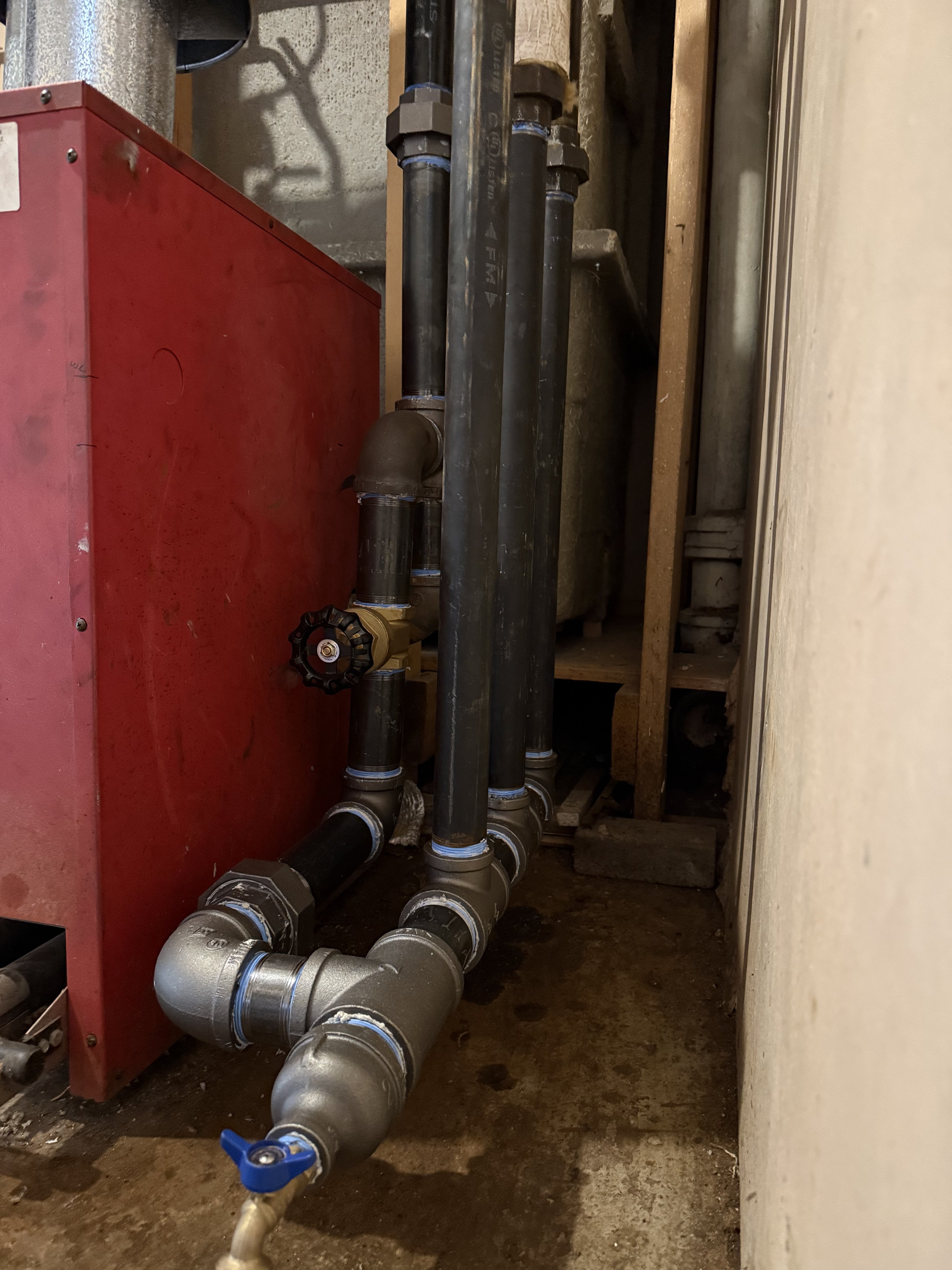

    I say skimming but I believe it’s more drain and fill. My boiler:
    I do not find a 1.5 or 2 inch port at the water line on my boiler which would be used for true skimming. Any thoughts? It’s a HB Smith GB250.
  • dabrakeman
    dabrakeman Posts: 1,038
    The 3/4" plugged tapping should have been fitted for skimming.

    you can't really get rid if the oil by draining it, the oil just clings to the inside of the boiler when you drain it and floats on top of the new water, you have to skim it, slowly run the top surface of the water off through the skim tapping.

    What are the needed part(s) for a proper skim port? Nipple and a valve?
    i mean y9ou can do it with just a nipple and a cap but a couple nipples, a valve, maybe an ell to turn it down toward the bucker and a cap or plug are better. since the skim port is just 3/4 I might use 2 nipples and a reducer and use a larger valve and fittings from there.

    Since the manufacture's "Steam Boiler Cleaning Instructions" method seems a bit involved, I think I try the 3/4" Right side tapping. Not the highest tapping, but maybe the most practical for this situation. Hopefully it is higher than any internal obstacles.
    you basically want the skim tapping to be above the bottom of where the sections connect together at the top so the top of the water coming out that port is above all of the sections and oil will float out from all of the sections.
