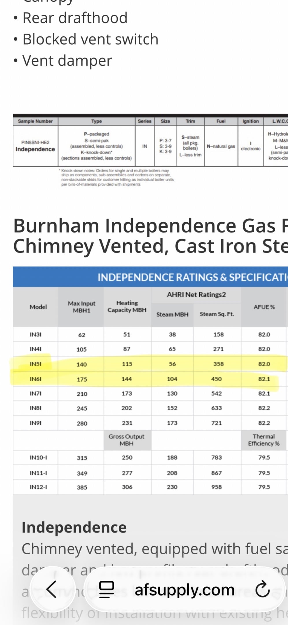

I need a new steam boiler. I calculated my current EDR as 370 without the piping pick up factor. When looking for a boiler do I just need to match the boiler steam sq. ft. output to the EDR because the boiler steam rating includes the 33% pick up factor that I did not account for? For clarity, based on the ratings for Burnham Independence boilers: the IN5I would be slightly below requirements and the IN6I would be somewhat oversized?
    Match the boiler Square Feet rating to the EDR — don't add anything else. If the match isn't perfect (it rarely is!) better to go slightly undersized than go oversized — so in this case the IN5I would be the prper choice.
