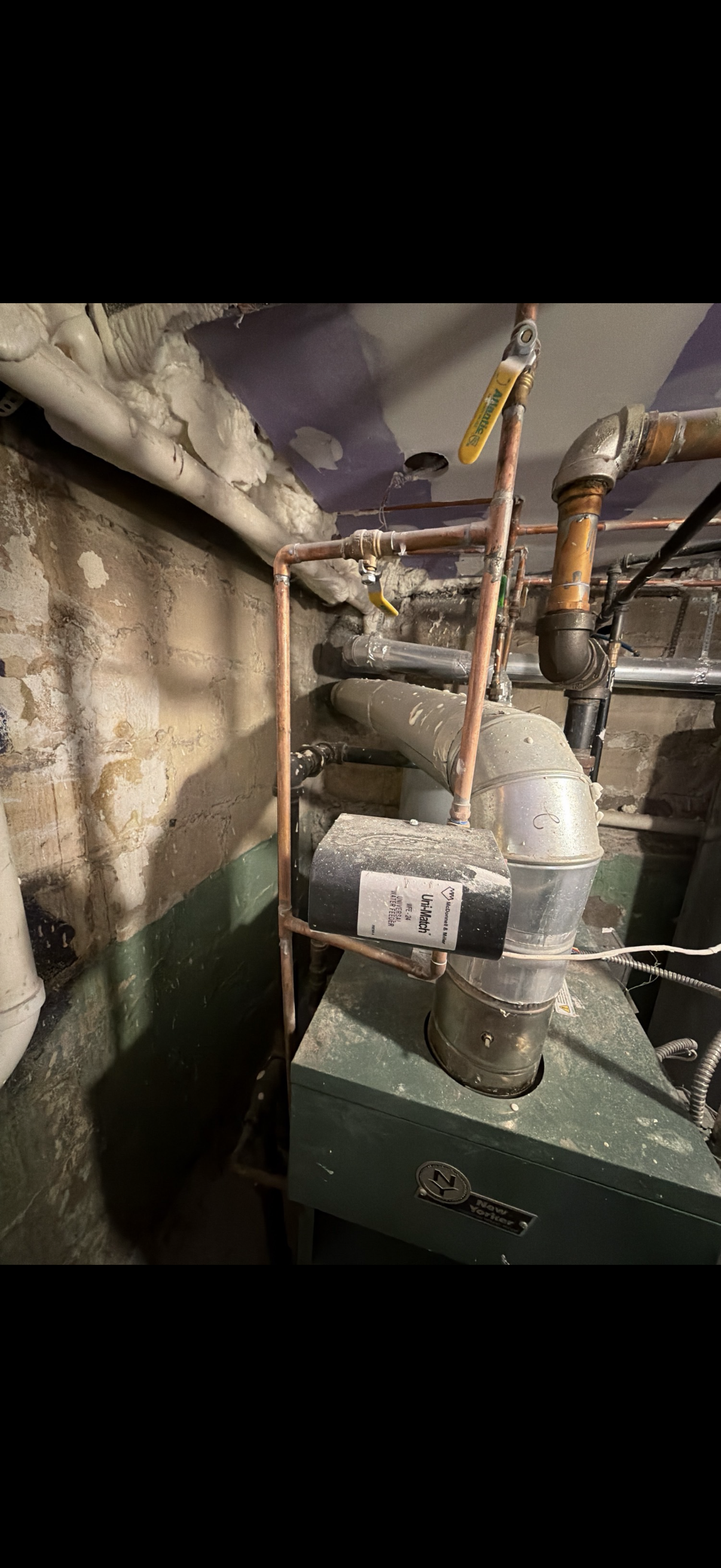

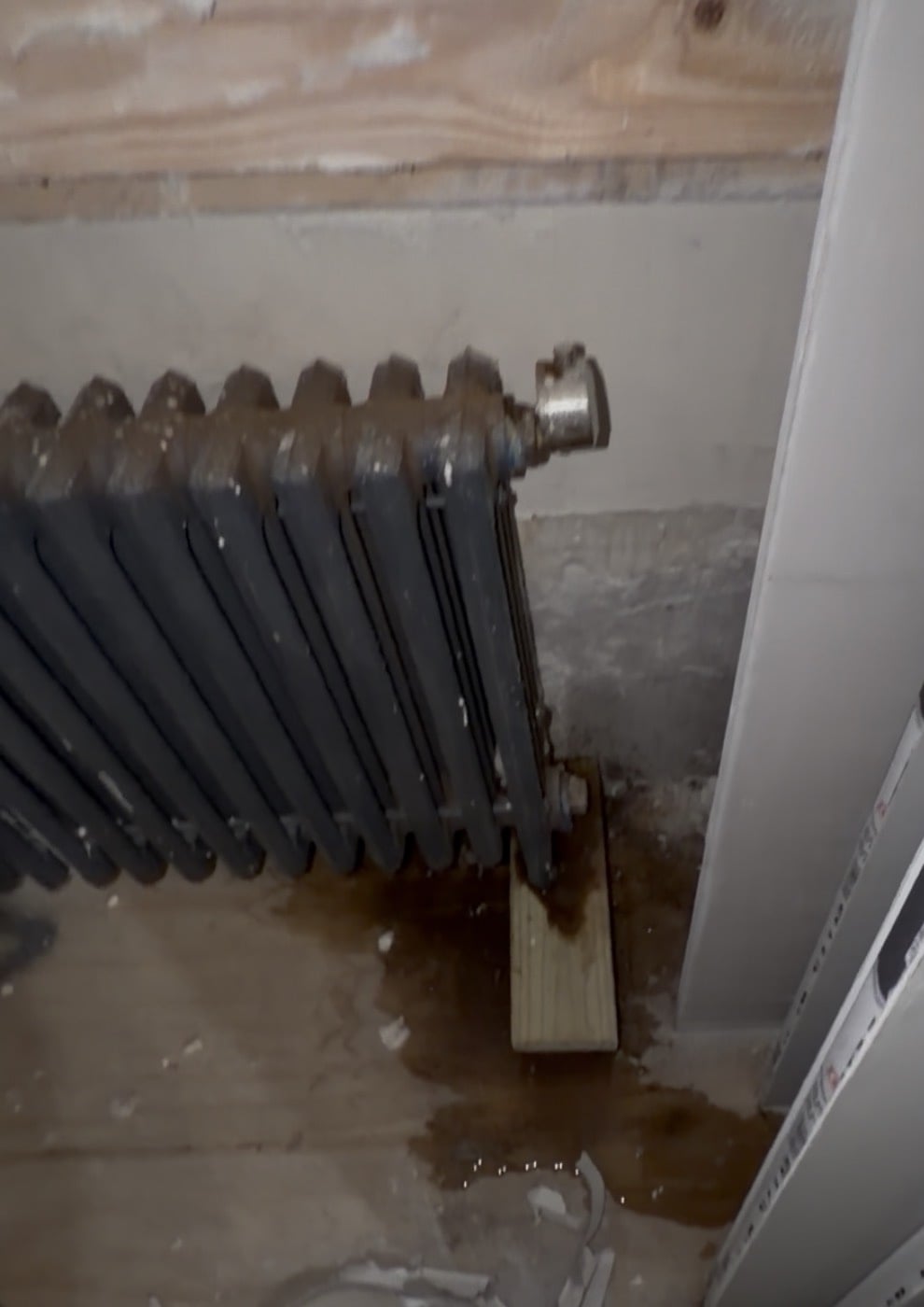

Would appreciate some suggestions please. My radiator glass keeps overfilling when heat works for a few hours and my radiators start banging and leaking water.
Replaced all radiators, brought in 3 different Plummers and all take money, claim they fixed the issue as water is not leaking when they are there, and leave.

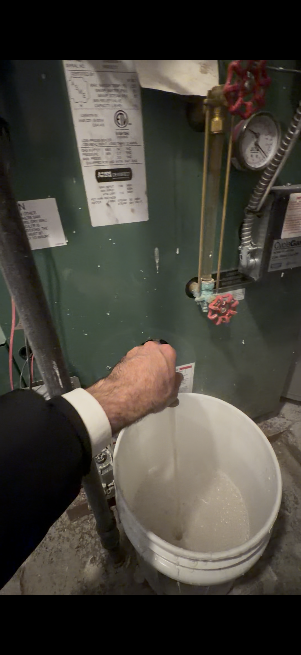

I keep having to drain the water half way as the glass tube gets to the rim.

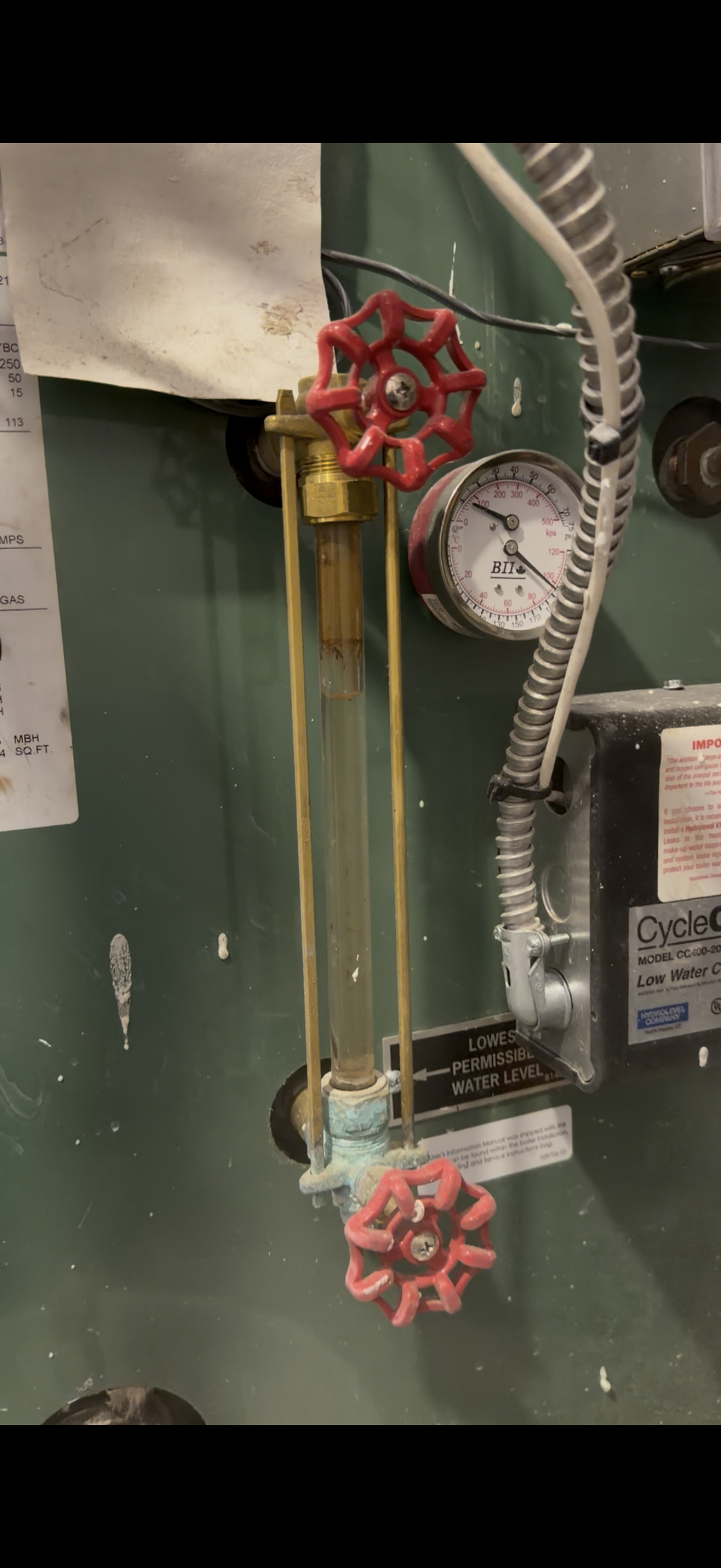

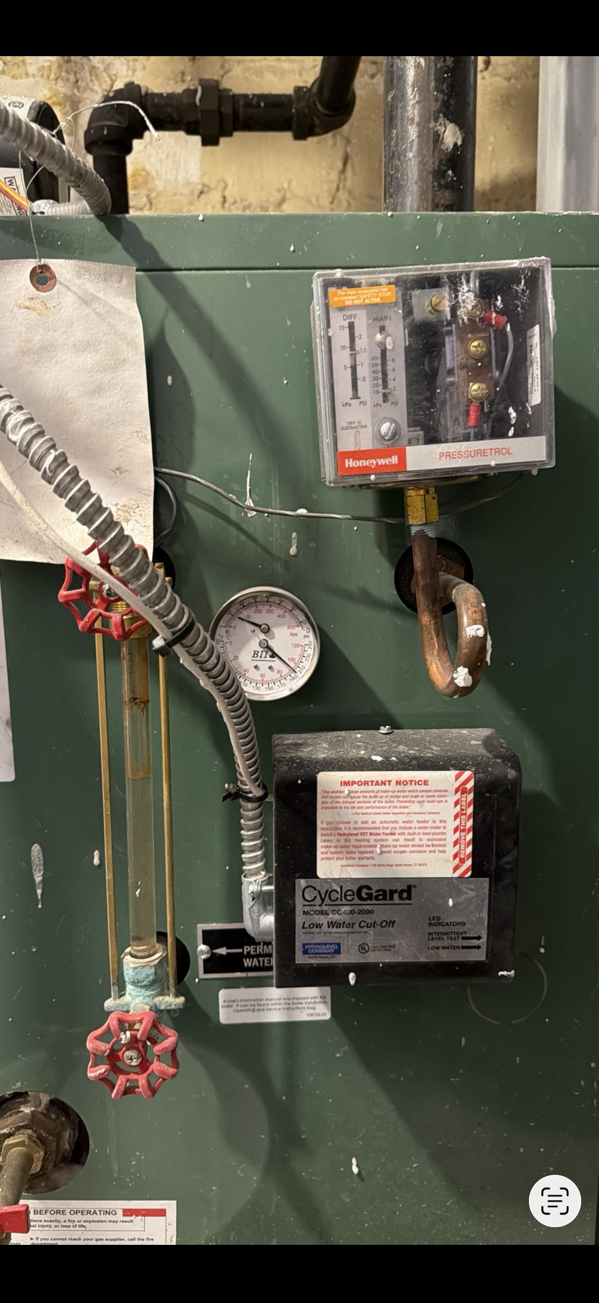

    The way it is supposed to work on your system is the low water cutoff ("CycleGard" in the first picture) is intended to send a signal to the feeder valve (black box labelled "UniMatch"in the second picture) which is supposed to feed water to the boiler if the water is low — and then stop feeding.
    At a first guess I'd look at three possibilities: slow returns tricking the low water cutoff, the low water cutoff lying to you — or that feeder sticking open.
    Diagnosis isn't hard. Turn the manual feed valve — on the pipe above the water feeder valve — off and keep track of the water level for a few cycles. If your problem is slow returns, the water level in the sight glass will drop while the boiler is firing, but after the boiler stops it will recover to where it was before the boiler fired. It should recover in a minute or two, but if it takes ten or fifteen minutes you have a slow return problem and one would need to look at the piping to figure out why.
    If it does recover OK eventually, you will need to see if the feeder valve has a time delay on it — but I don't think that that particular design of valve does. On the other hand, if it does recover you can run the boiler with the manual valve closed, provided you check the water level in the gauge glass from time to time and make sure that it is high enough to be safe.

    I definitely can’t say for sure what is happening here without being there, but I will say that gauge glass looks very oily…
    See if the LWCO is calling for water, or if maybe the auto feeder valve is leaking by.

    Holy moly macaroni. Someone charged you money, to replace a radiator, because it was overfilling with water??? That is 1000% criminal. Either there is a problem getting water back to the boiler, or a problem with automatic feeder, or a bypass valve, or the low water cut off. In my findings, it is almost always a feeder problem or a manual valve issue. Relatively easy repairs.

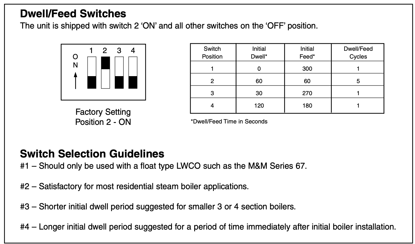

    The water feed valve WFE-24V, Uni-Match Universal Water Feeder (24V) comes from the factory with a 60 second delay open. You can look to see it the DIP switch #2 is on and all the other switches are off.
    If that is the case you can try to set #4 on and all the other switches off to see if that helps at all.
    ethicalpaul Posts: 9,097
    That's very good info, Ed. It's very helpful of you to provide it.
    I will say it must be combined with observation of the boiler to see what is happening…if the autofeeder isn't calling for water these settings are irrelevant.
    And if the autofeeder is calling for water due to carryover, then the water quality should be addressed as a primary focus.
