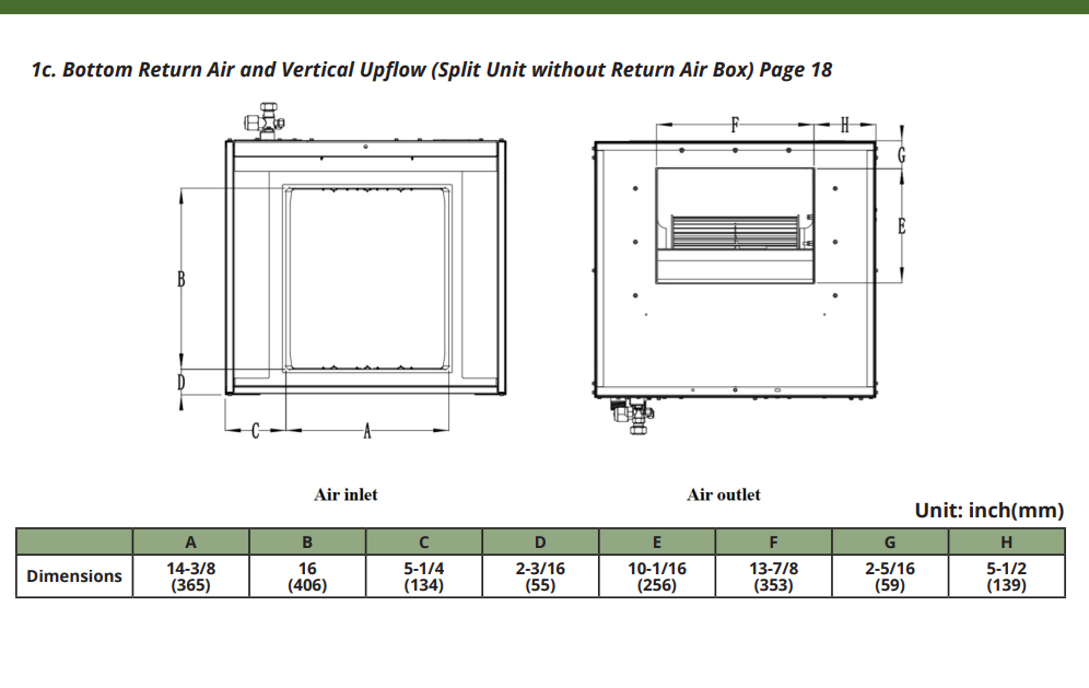

I have built the ductwork up to this last step, connecting the air handler to the 10x24 main duct that is ~17" above it.
The top of the blower is this:
do I get a 10x14 bent up and then hard attach it to the duct above, and use a hardcast canvas joint at the top of the blower?
Or should I transition from 10x14 to a larger size in that ~14" above the canvas joint?

What I have is a horizontal 10x24 trunk that is not directly over the air handler. so I can either build a slightly smaller stack duct than the top of the unit, or go through all sorts of angsty bends to reach over to the trunk,
I think the former solution will be cleaner, flow-wise. I can get a local HVAC shop to make that final play and I just might do that.
@Kaos this is the modular 4 ton GeoCool and the compressor unit is remoted about 2' away so no compressor vibrations to deal with.

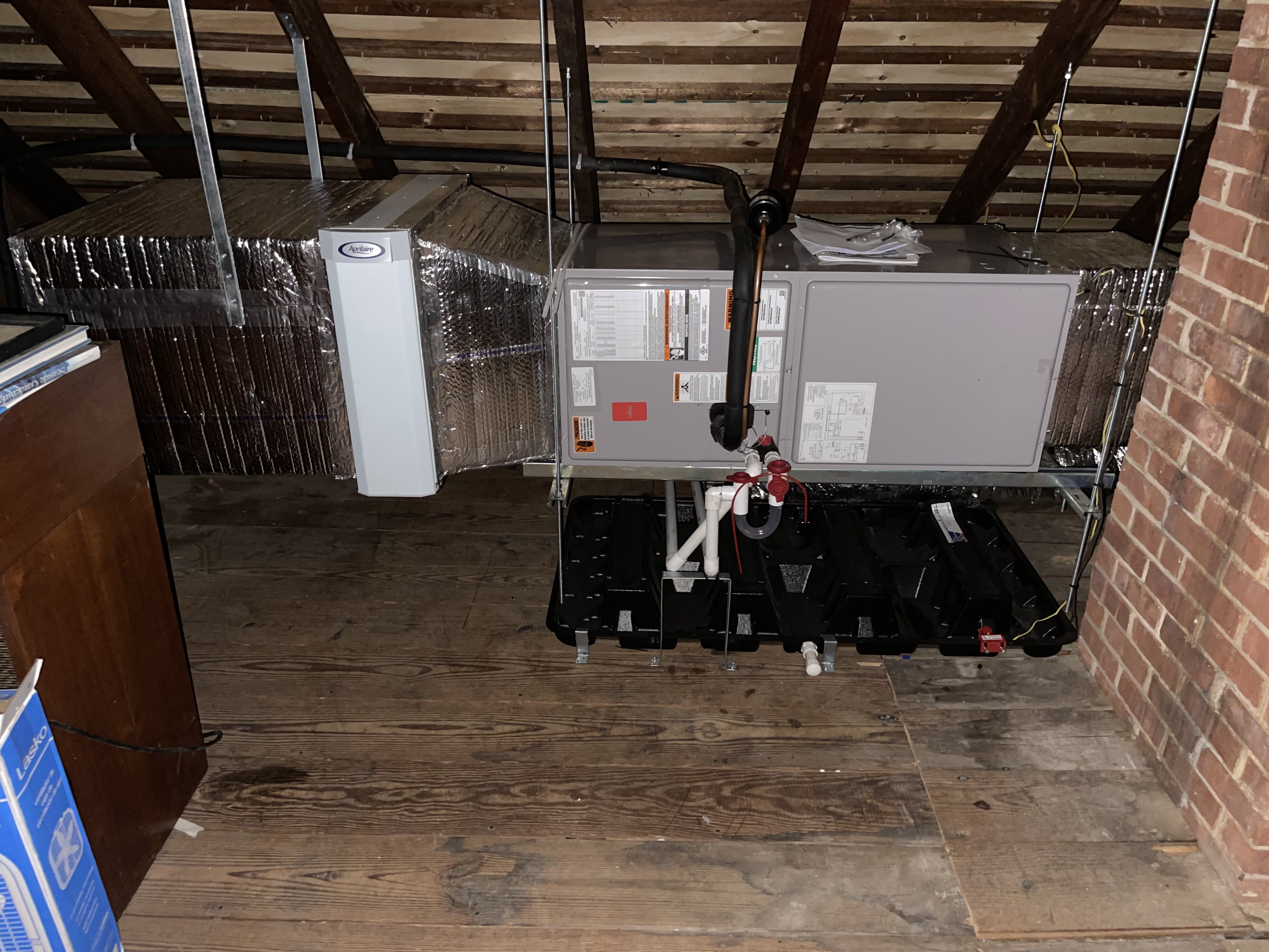

The stack of modular components was about the same height as the bottom of the trunk so it got de-stacked.

I spoke with the company that I got the temporary furnace from. He will build my transition next week after I get it all stacked up and moved into place.
I thought my equipment room was generous, LOL! What I would give for another foot of depth right now. I had to snap a line at 36" in front of the panels for the required access.
