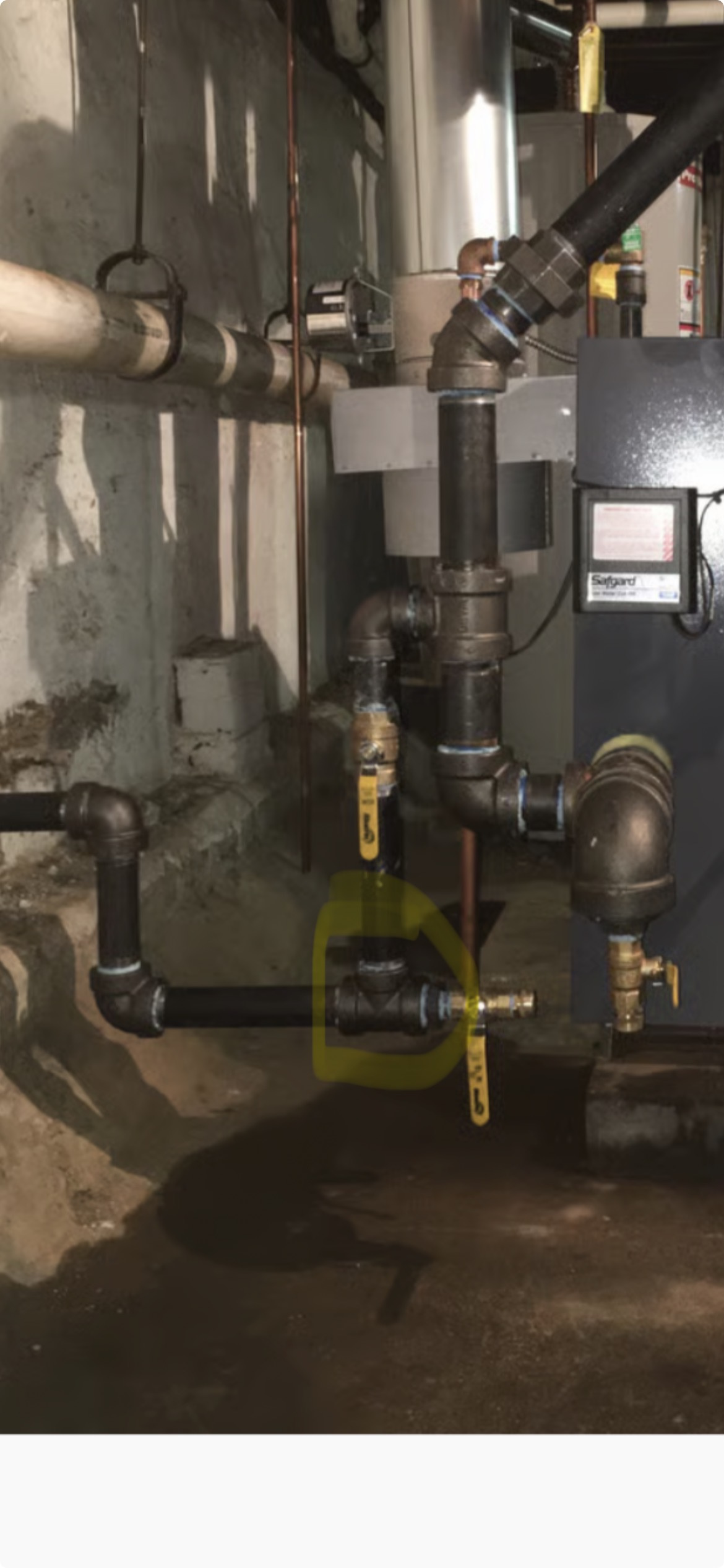

    From what I can tell 304 and 316SS are just as far away from copper as steel and cast iron are on the chart, just in the opposite direction.
    I'm not seeing a benefit of using stainless steel as a coupler between steel and copper?

    the close nipple being brass or stainless is probably helpful but not for galvanic protection but because the threaded part is thinner and it will tend to rust through at the close nipple first, by making it brass or stainless it won't rust.

    Or you could do as I did and make the entire thing copper, right to the header. There's nothing wrong with a copper equalizer as long as you can solder 1.5 - 2" properly.
    I have a good heavy steel tee at the boiler, but then a male copper adapter into that. It may rott out eventually, but, who knows.
    I do feel brass and bronze are a good compromise though, they don't seem to be as bad as copper when used with steel.

    Can you please elaborate more on the stainless fitting at the Hartford connection? Would it be the highlighted tee if the return was copper?
