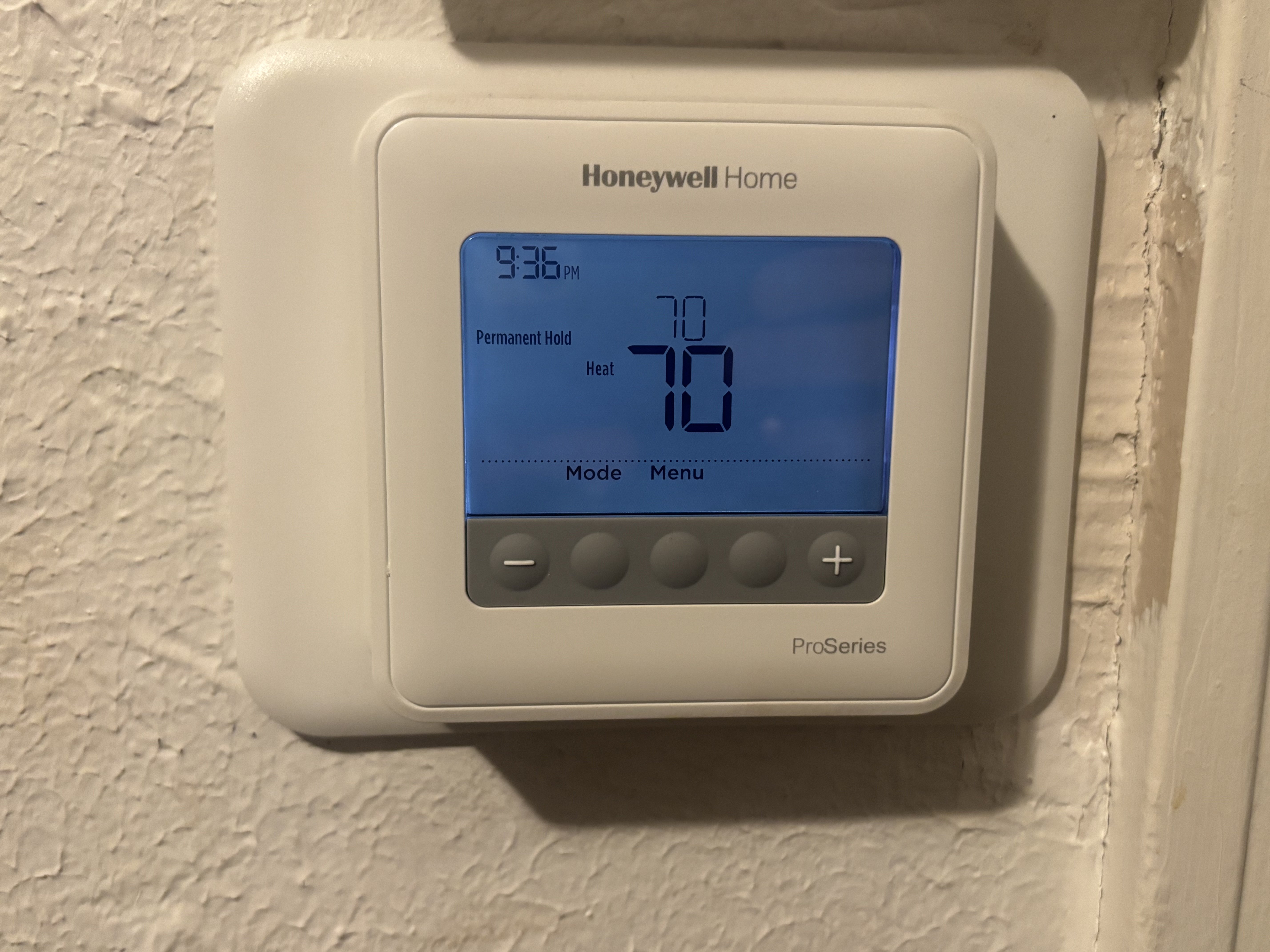

Hi all:
It's been a bit since I've been on here. I just had my boiler cleaned by a new company earlier in the year. Everything was fine, but my round Honeywell thermostat ended up having issues, which I attributed to an issue related to cleaning the boiler. Guy came back, said the tstat was bad, said he had another available. I asked if it would work correctly with a steam boiler, and he said yes. So, we've had it a couple of months. Our house has been quite evenly heated as a result, but I am starting to suspect that this one is short-cycling the boiler. Hard to tell with my bills at this time, as gas and electric has spiked so much.
Pic attached. If this isn't adequate, I'll figure out how to get it off the wall and see if there's a model number inside. Thanks for any help.
May well be running shorter cycles than are ideal for steam. Thoose usually ship set up for hot air…
Do you have the manual for the thermostat? If so, it will guide you through using the settings under the menu to set it for steam heat. Not hard to do.

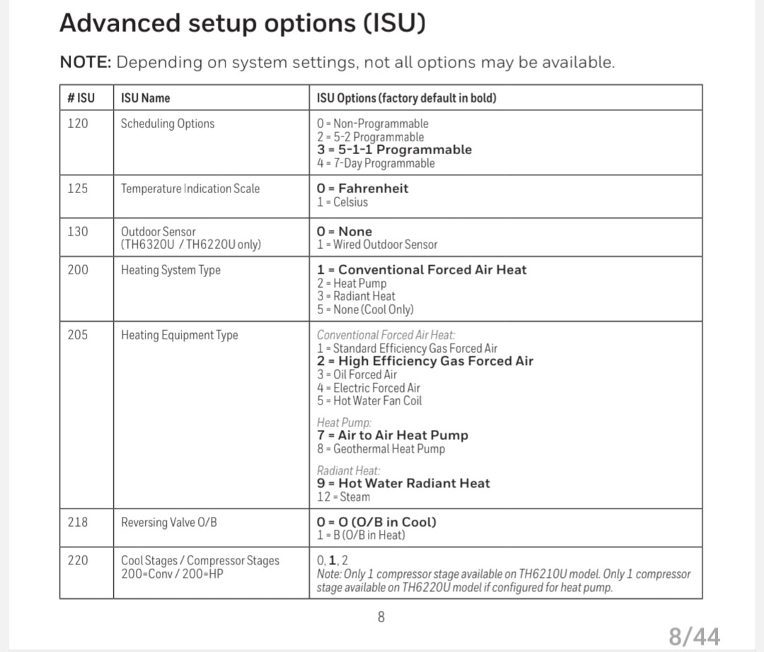

The tech should've set it up for steam in the Installer Setup. If you get the actual model, you can download the installation manual or come back here. It's easy. It'll look like this.
ISU 200 = 3
ISU 205 = 12
I see the thermostat is in permanent hold. You can also set it up to be non programmable as well if you want.
Keep going through that menu until you get to CPU as previously mentioned. Depending on your system it should probably be 3, 2, or 1. Start with 1 for longer fire time but if the house temp drops too much, go to 2. 3 only if you have poor insulation, bad windows, or perhaps under radiated, but thats means you are losing a lot of heat no matter what.
