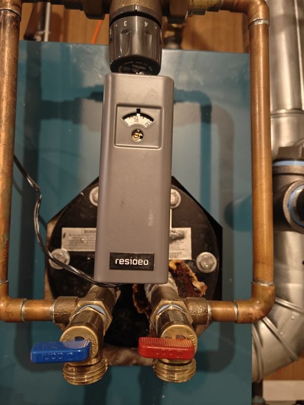

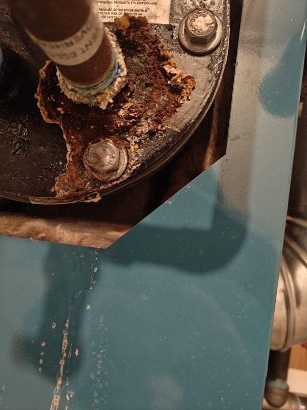

What's causing this crust on the boiler?
I had this new boiler installed January 2025 by New England Steamworks, and unfortunately I'm now past their 1 year warranty period. But today I checked my boiler and there's a ton of crust near the water heating coil.
What caused this? And is this something I can fix DIY?
  • HydronicMike
    HydronicMike Posts: 453
    edited March 17
    Electrolysis and/or small leak. I wouldn't touch it until you are ready to repair it properly. And you definitely want to fix it before it rusts the bolt on the coil, although it looks like it has the kind of coil with pass thru bolts.
    You can try shutting off the main water supply and hitting it with a wire brush. But again if it starts to leak, you might be in for a bigger job.

    Oof. Is this leak something to call the professionals in for?
    pecmsg Posts: 7,613
    a very small leak
    109A_5 Posts: 4,617
    That is caused by a leak, probably been leaking for a while, maybe since new. You probably should look at (inspect) your boiler more than once every 14 Months.
    DIY repair ? Maybe, it depends on your skills.

    I had it serviced last June, when the tech noticed it but said it was minor/not a big deal. I've swung by the boiler and had a water leak monitor nearby that never went off but honestly just never looked that closely at it until today when I went to adjust the aquastat.
    109A_5 Posts: 4,617
    " minor/not a big deal "
    Well… Now you need to pay for the repair that could have been repaired under warranty. I guess it depends on your opinion of a "big deal".
    Maybe the Tech that seemed to imply it should be ignored will repair it for free.

    So why are you adjusting the Aquastat?
    Anyway, that is just a small leak, likely because the pipe sealant was insufficient, the fitting was not tightened enough, or the fitting was soldered after it was installed on the coil. I would recommend getting a wire brush, cleaning it down to bare metal, and then spray painting it with some Rust-Oleum. Black would be my color choice. Then keep an eye on it.
    Another thing that no one looks at is the bolts that seal the coil to the gasket and the boiler. After about 500 hours of operation, they should be snugged up. You may find that even though they were tightened at the factory, after 14 months of use those bolts are now only hand-tight. Those gaskets shrink after they are heated for several months. that is why they are not as tight at they were when the boiler was new.
    In another 6 months check them again. That should be the last time you will need to tighten them. then the coil gasket will look new for years after that.

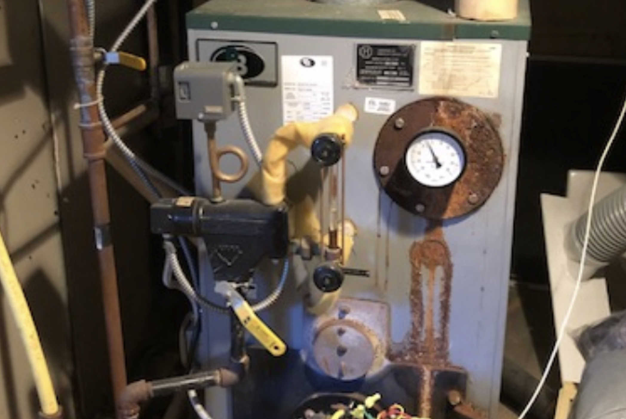

    See how this coil cover plate that has no coil, is rusting away from the coil plate gasket? Tighten those bolts!

    This should come under the boiler manufacturer's warranty. Call @New England SteamWorks , they should be able to handle it for you.
    Semi-retired
    pecmsg Posts: 7,613
    that’s not a manufactures defect.
    those fittings are field installed.
    mattmia2 Posts: 18,233
    if the coil bolts weren't installed with antiseize they probably should be taken out one at a time and have some antiseize added in addition to the retorquing to take up the gasket creeping.
    did you contact @New England SteamWorks ? they don't have to cover it under warranty buty they might if you aks nice.

    I filed a rather sad trombone ticket with them and it looks like NE Steamworks is willing to work with me on this despite it being out of warranty! I see now why they have their reputation. They'd have been within their rights to ignore me and my lack of observational skills haha!

    Reposted with a photo: I asked Daniel Friedman from InspectApedia.com for permission to use a copyrighted photo from his site and was waiting for a reply. Nice guy.
    So here is the full post again, with the photo that explains the gasket problem visually.
    Original comment: Anyway, that is just a small leak, likely because the pipe sealant was insufficient,he fitting was not tightened enough, or the fitting was soldered after it was installed on the coil. I would recommend getting a wire brush, cleaning it down to bare metal, and then spray painting it with some Rust-Oleum. Black would be my color choice. Then keep an eye on it.
    Another thing that no one looks at is the bolts that seal the coil to the gasket and the boiler. After about 500 hours of operation, they should be snugged up. You may find that even though they were tightened at the factory, after 14 months of use those bolts are now only hand-tight. Instructions like these are no longer included in the instruction manuals like they were 50+ years ago. Mostly because newer gasket material do not flex as much with the heating cycles as the older fiber gaskets do. However you can still find 8 to 12 year old boilers that look like they are over 30 years old as a result of those loose coil gaskets.
