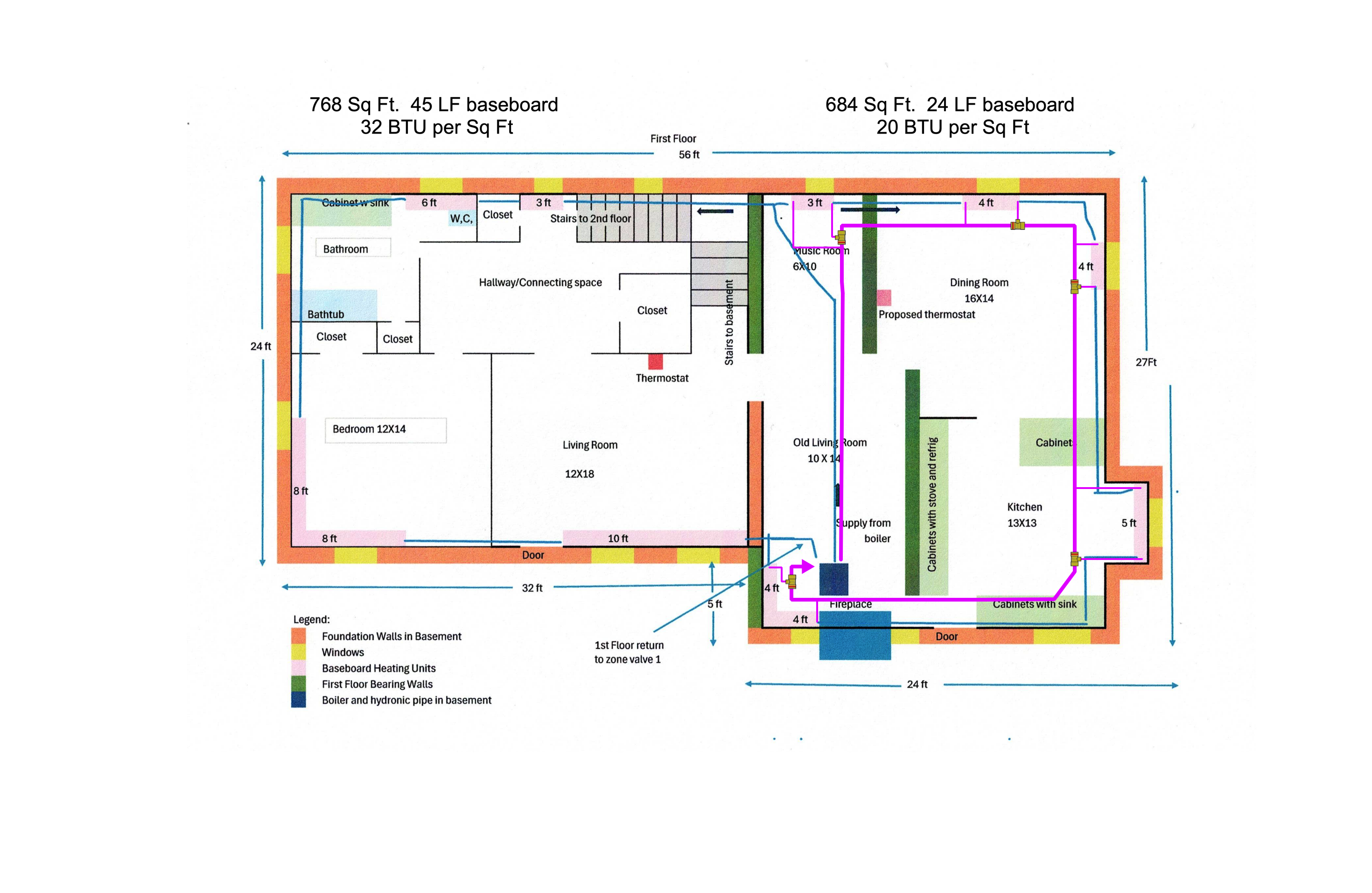

1250 sq ft. Assume 45 BTU/sq ft (seems to be a reasonable rule of thumb value)=56,250 BTU for the first floor. Divide by 600 BTU/Ft for the existing baseboard, we get 93.75 ft required.
The total 1st floor baseboard dimensions are about 60 linear ft.
Calculating the other way, with the existing baseboards, I have available about 30 BTU/sq ft. Observationally, I'm fine as long as the outside temp is never below 20F.
I say, no wonder it's cold and takes forever to warm up.

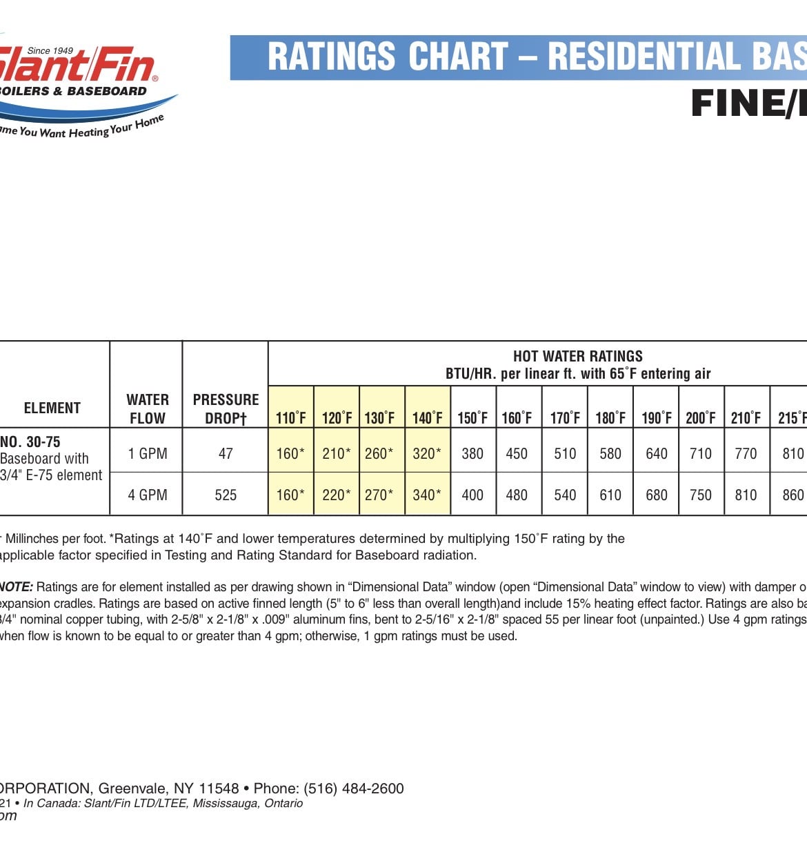

    hot_rod Member Posts: 27,403
    fin tube at AWT of 180 is probably closer to 550btu/ ft
    So 60’ x 550= 33,000 btu/hr delivered
    30,000/ 1250 is 26btu/ ft that seems low for that building, as you are experiencing
    A heat load calc for the first floor would confirm you are under radiated
    You can squeeze some additional output from fin tube by increasing the flow rate. 4 gpm is possible in 3/4 tube
    Fin tube charts clearly shows increasing flow from 1 -4 gpm, which reduces delta which in turn increases average fin tube temperature, will increase btu// ft output
    With SlantFin # 30 fin tube note the output increase from 580 to 610 with more flow. Sometimes this is possible by increasing soeed on a multi speed circulator.
    This applied to any type of heat emitter

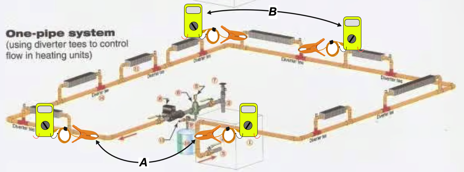

    The first step is to look at the problem zone—the first floor—with 60 feet of baseboard.
    Measure the inlet temperature of the baseboard loop (the supply pipe at the boiler) and the outlet temperature of the loop (the return pipe at the boiler) when only that zone is calling for heat. Allow the burner to run until it shuts off on the limit control. Then observe the temperature difference between the supply and return.
    You are looking for a temperature drop of no more than about 20°F. If the temperature drop is greater than 20°F, then splitting that 60-foot zone into two 30-foot loops with a common return (or supply) pipe may help improve heat distribution. If the temperature drop is 20°F or less, then the additional piping will probably not improve the situation.
    Another test is to observe the room temperatures when the problem is occurring. Are the rooms closer to the supply side of the loop warmer than the rooms closer to the return side? A difference of about one degree is not a problem, but a difference of several degrees suggests an imbalance that repiping could help correct.

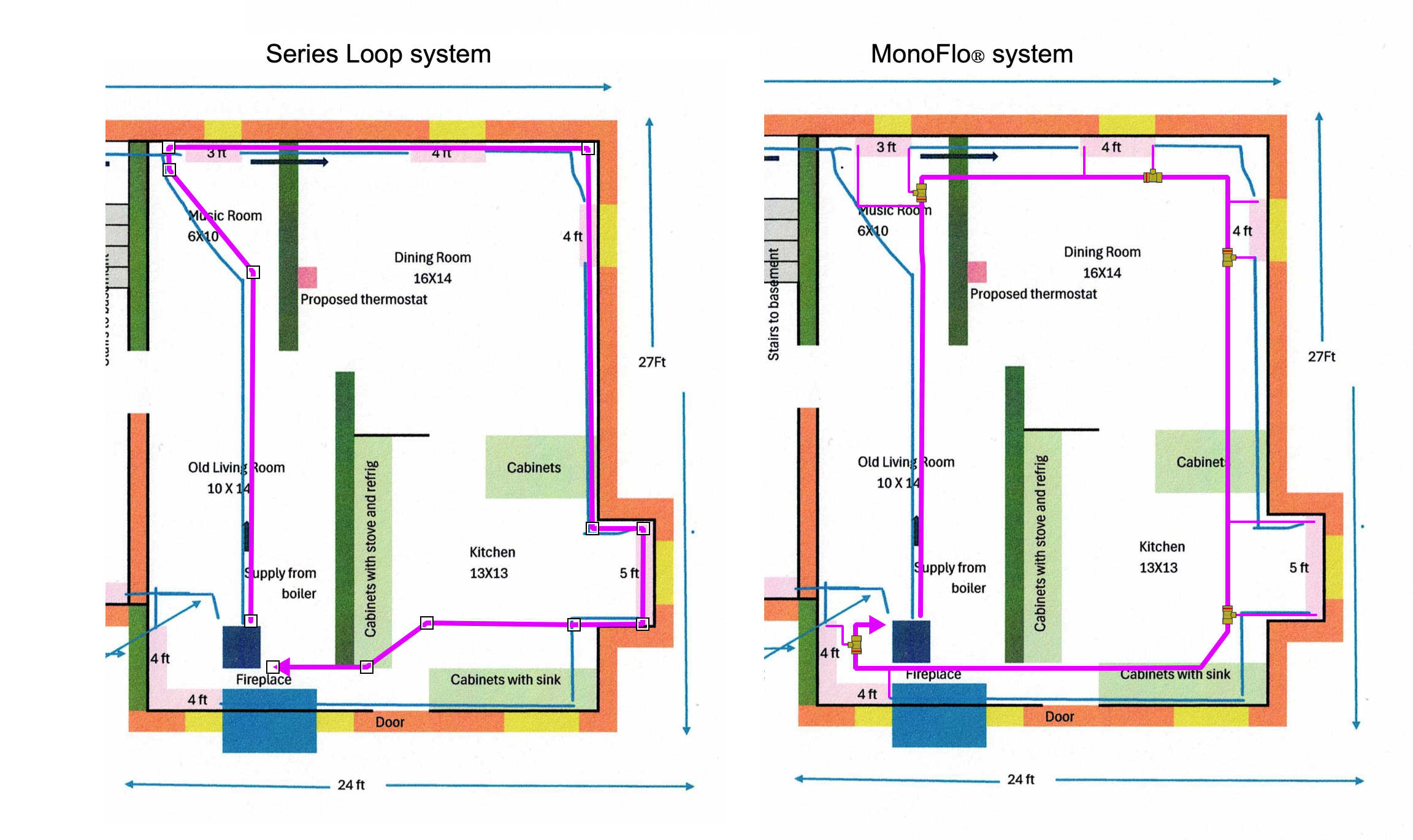

    I didn't realise you have a  Monoflo® tee system on the first floor of your original home.  When replacing the boiler with one that comes with a Taco 007 circulator and adding additional zones to the second floor and then again to the porch over the life of the system, you can't be sure that the pump that comes with the boiler can do all that work.  My original comments about the 75 feet of baseboard maximum on a 3/4" loop do NOT apply to a Monoflo® system.  What size is the pipe for the first floor zone?  For that size system it could be 3/4" with 3/4 x 1/2 monoflo tees to the section of radiator that is no longer than 25 feet of element each.   Most systems like that were about 12 to 15 feet each off of the main pipe.
    If you have a 1” main pipe with 1” x ¾”  Monoflo® tees then that is a different story.   More info needed for the calculations.

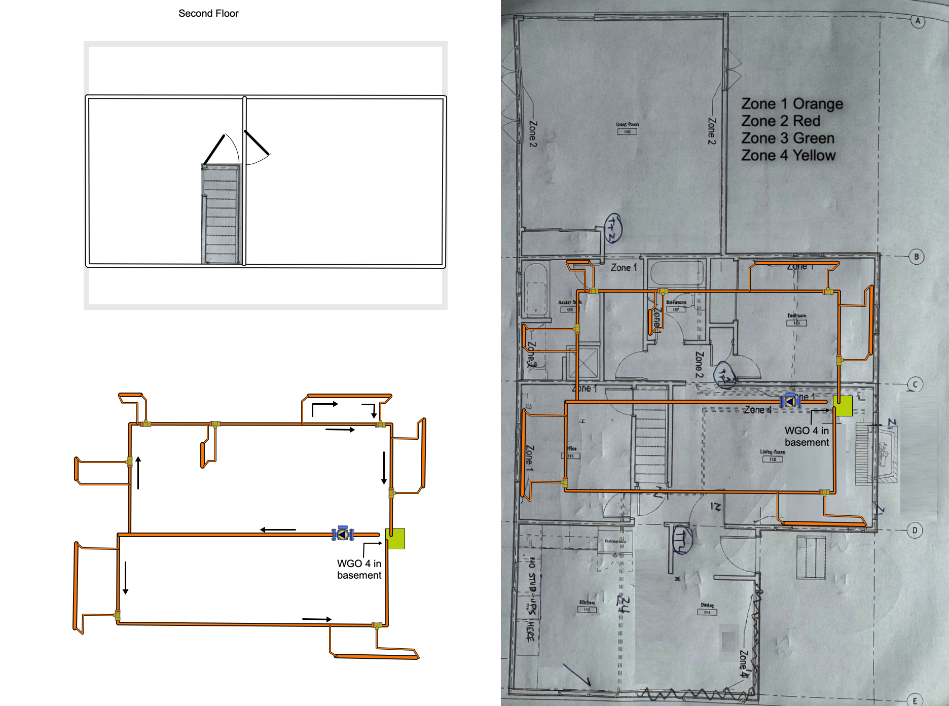

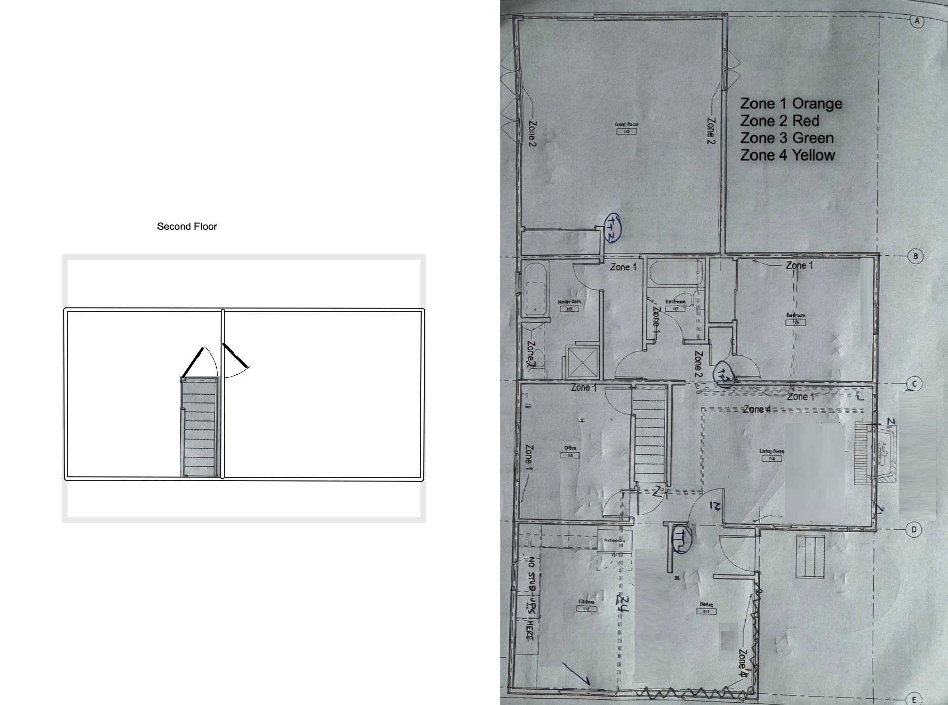

    EdTheHeaterMan Member Posts: 12,125

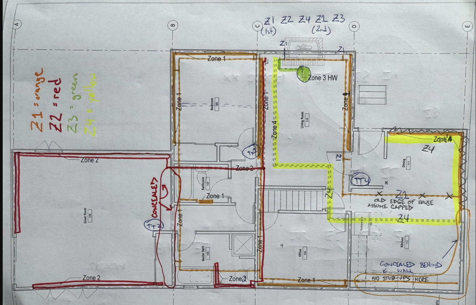

    I’m trying to understand your drawing. You mentioned that the house is a 1½-story Cape, and that two of the zones serve the second-floor rooms, each with its own thermostat. However, the sketch appears to show a single-story layout, with 3 of the zones located on the first floor. and the 4 zone for the water heater
    Could you clarify how the second-floor zones are arranged, or update the drawing to show the second floor as well?
    I have come up with this but do not know where the second floor radiators are
    When showing the radiator locations it would be helpful to show only the radiator locations and not the pipes below the floor. Also what room the thermostat on the first floor zone is located.

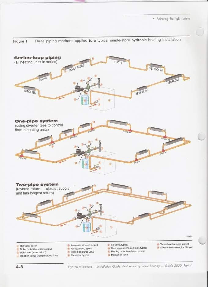

    This is what a typical MonoFlo® system using baseboard radiators might look like in your home.
    This is the Orange zone 1 in your home.  It appears that your original 900 sq ft cape cod has had more than one addition over the life of the home.  The new kitchen was added to what is normally the front of the house.  The office appears to be where the original small dining room was.  And the master bath was once the kitchen.  The Great Room which I assume is the Master Bedroom looks like it could have been a two car garage on the back of the house at one time.  With all these changes, there is a very significant possibility that your Monoflo® system is no longer in harmony with the other zones in the home.
    Lets just assume that the original Zone 1 Monoflo® system is still balanced.  I might be inclined to place that zone on its own circulator.  That would eliminate any problem with the other zones using all the pump’s flow and head at the expense of the more restrictive Monoflo® system zone.  That may be the only real solution to your problem of balance, if getting all the air out of the system does not get you where you need to be.
    Remember this important fact: if you try to get air out of the system and no air comes out, then you don't have an air problem.

    measuring temps gives you a decent way to guess combined with doing the math for the resistance of the piping.
    if you have enough flow the delta between the supply and return end of the emitter should be relatively small.
    i would strongly encourage you to do the heat loss calculations to know what you are shooting for.

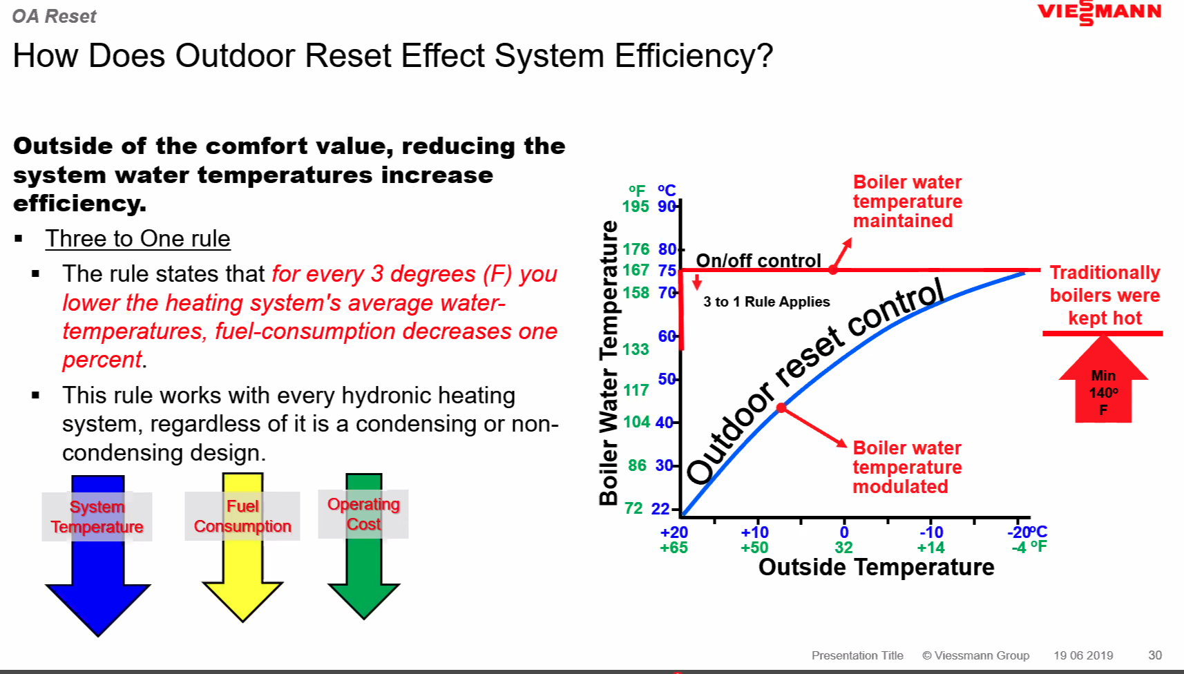

    You can safely run 190- 200° if you need to. With and outdoor reset control it would run those high temperatures only on design days, hopefully.
    But with increased operating temperature boiler efficiency drops. Another reason to consider ODR.
