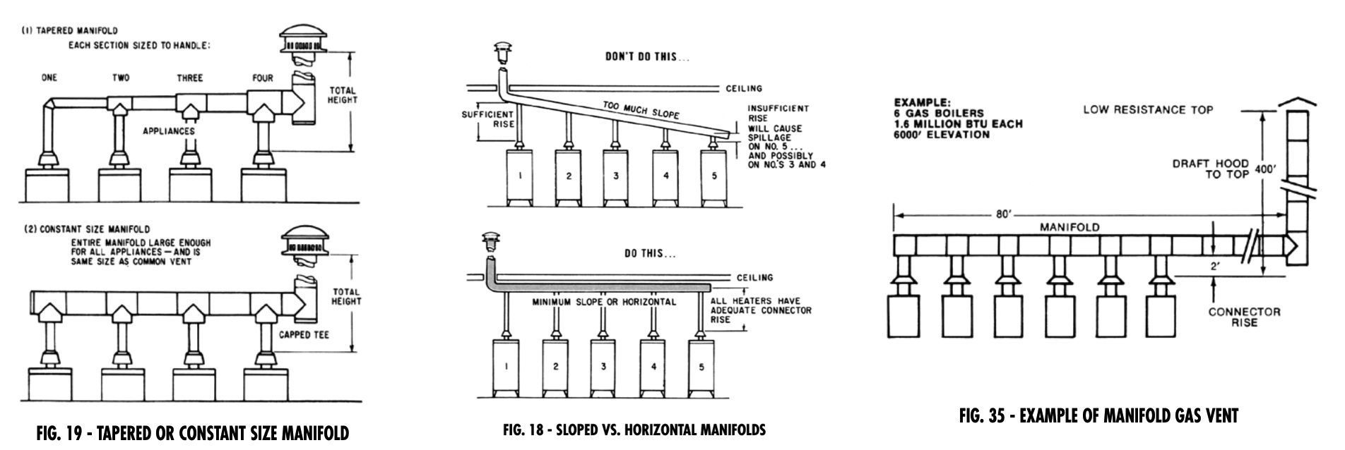

    EdTheHeaterMan Posts: 12,952
    Yep. it happens and there are instructions and charts and diagrams on how to do it:
    I just don't see any place that include one oil appliance with several gas appliances. That said, @pegbwhite is an example of one that does. Now what are the ways to fix this? We are waiting for more info from @pegbwhite

    The code allows common venting of Liquid and Gaseous fuel-fired appliances… IF:
    The chimney is sized for all 6 firing simultaneously.
    The respective vent and chimney connectors are sized for the combination of appliances downstream or towards the chimney. For instance, let's say on one side you have one oil-fired furnace that shares a common connector before entering the chimney. Then that connector would need to be able to handle both simultaneously. However, if there is another appliance upstream, meaning away from the chimney but shares the common connector then from the furthest appliance towards the chimney the connector would have to increase. Now, the fun part is, if you look at the sizing charts in the gas code, they will place limits on connectors being either too small or too big for various combinations.
    The next part of IF would be that ALL attached appliances have Primary Safety Controls. That term is up for debate. For years, it simply meant the oil burner had to have a CAD cell/ primary control, which did not do a blooming thing to ensure combustion safety or success. Now NFPA 31 calls for blocked vent switch, which is basically a high limit switch in the connector just downstream of the oil-fired appliance. The typical CAT I draft hood-equipped water heater does NOT come with a spill switch nor is there a reliable effective means of providing circumferential protection. What does work extremely reliably is to remove the draft hood and replace it with a bullhead tee to a double acting barometric damper with a spill switch at the mouth of the gate. This switch should be wired to knock out the burner or the pilot(preferred, depending upon the design.
    IF,,,,, you have sufficient draft pressure.
    When you have a sextopus, it may work great or it may blow back out the draft hood of an attached appliance. Having adequate vent rise helps in this regard but everything must be properly sized, and the chimney must be capable of providing the requisite draft pressure for just one appliance or all, year-round. Good luck. Again, consider indirect tanks instead of dangerous draft hood equipped WH's.
