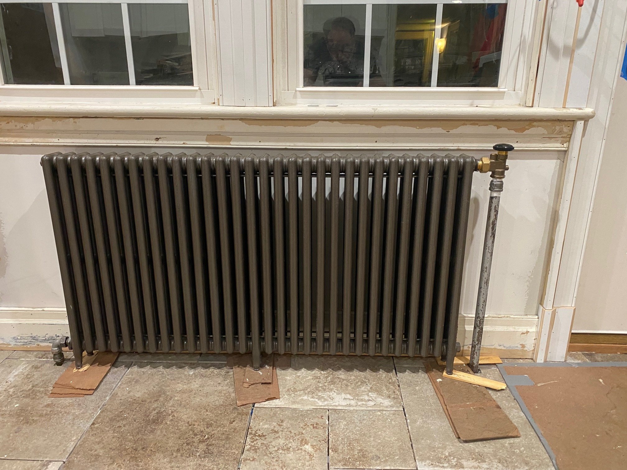

Hi,
I have a 30's Arco Model K vapor system. It's worked well since it was properly vented and adjusted by Steamhead and Gordo perhaps 15 years ago.
System always cycles off on temperature. Pressure stays at a max of about 3.5 ounces.
I would say that 12 out of the 16 radiators in this house remain cool at the lower half. And this is with orifices and valve stems wide open.
Any idea of why my lower halves remain cool?
The three Gorton #2's at the end of the system (sorry I forgot what it's called) always remain open.
So..I am always able to get the house to a comfortable temperature. But when I crank up the temp as an experiment, say to 76 degrees, and the radiators remain cool on the bottom isn't this abnormal?
I'm concerned from the standpoint of efficiency.
Note: 15 years ago I rebuilt all the old valves in the system. Now, a bunch of them are failing again and I am replacing them with Mepco SWRF-B's that have an adjustable orifice..
This radiator was recently removed, sandblasted and painted as it is going into a re-modeled kitchen. It will be removed again while the kitchen remodel is finished. Just wanted to re-fit it with new valve to make sure it works OK..
thanks,
Todd

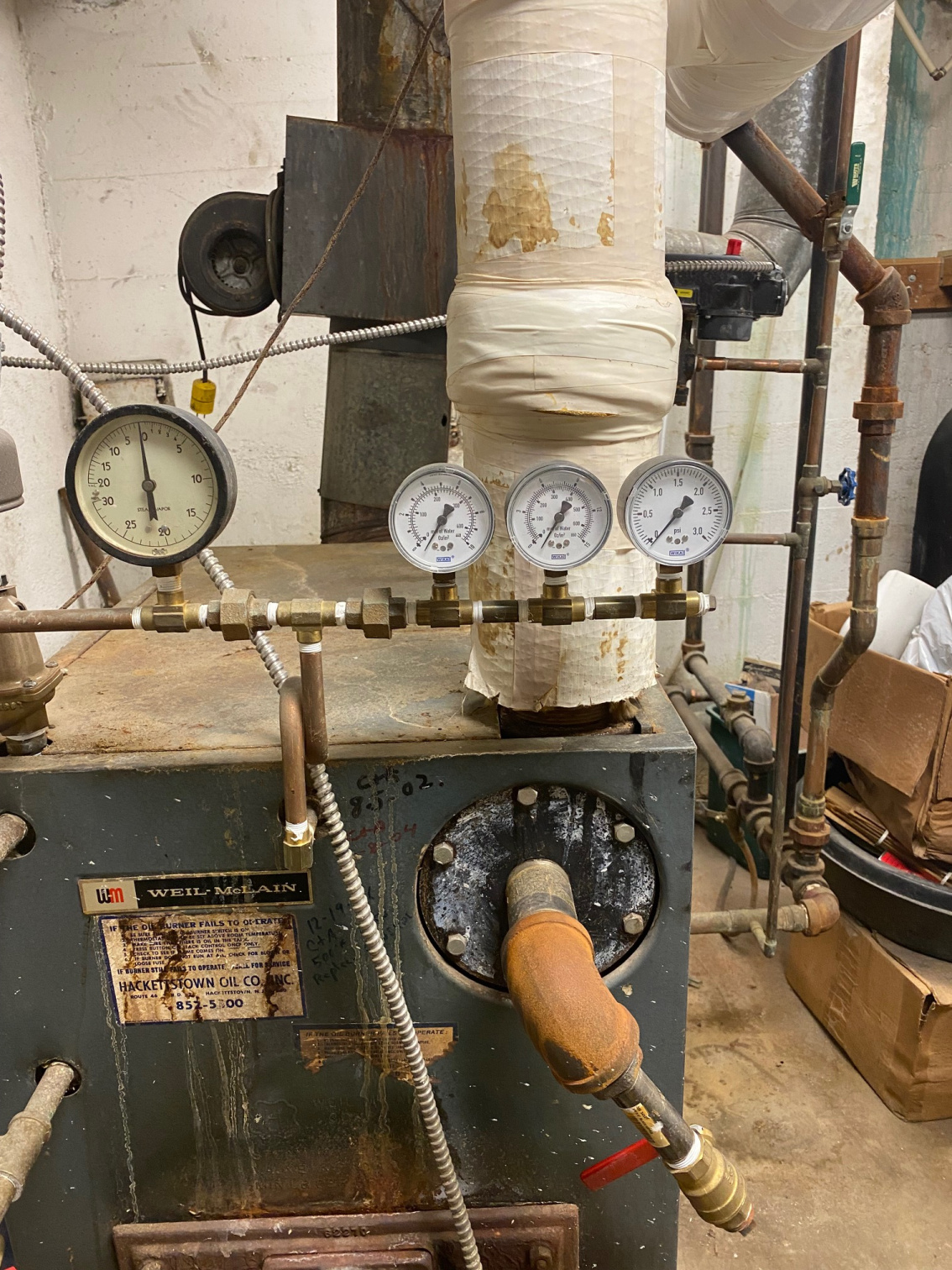

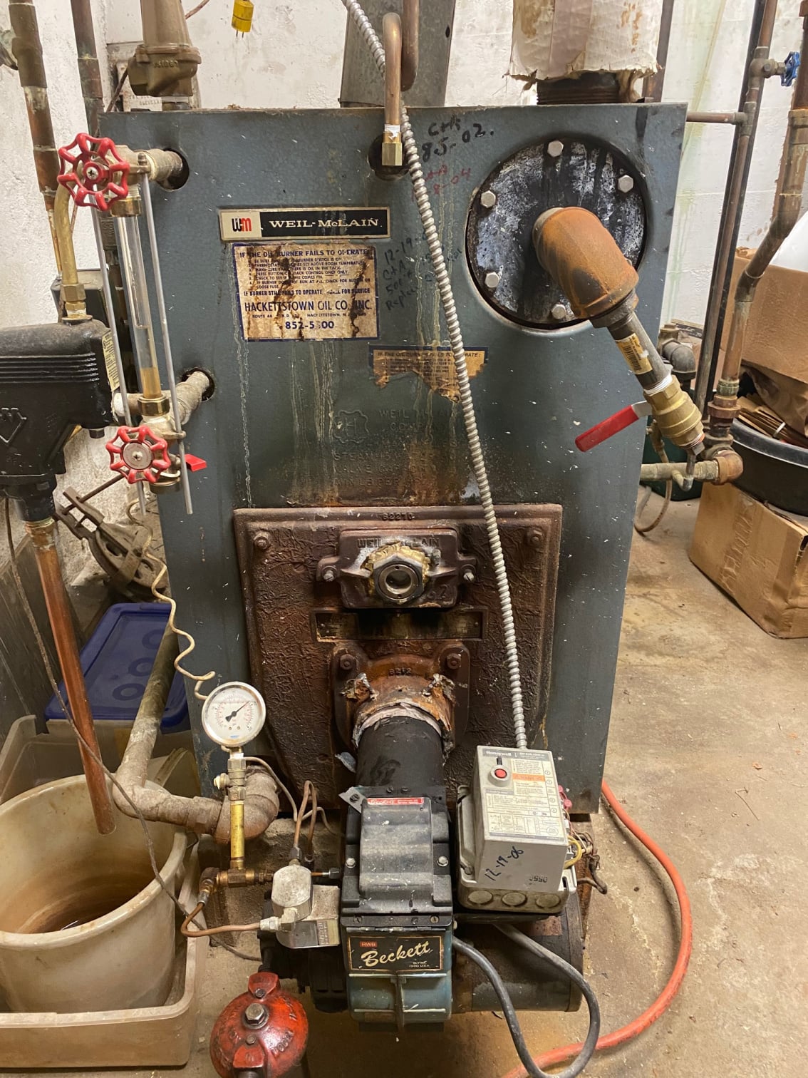

    The Gortons handle the air leaving the radiators. If the air can't get out, the steam can't get in.
    If they are working and the rads still don't heat well, check the boiler. If the fire-side is full of soot, the heat isn't reaching the water.

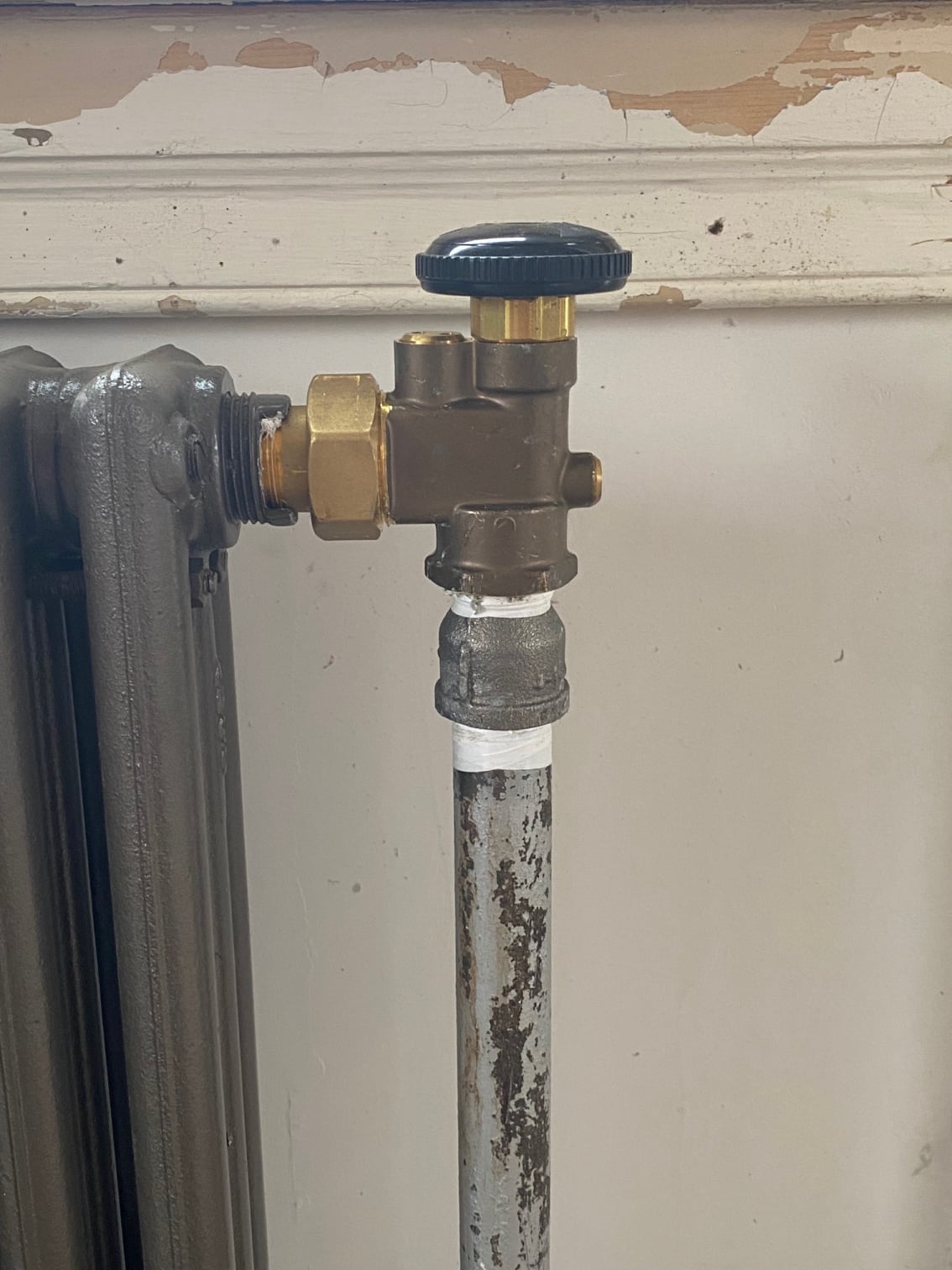

    Mepco's are orifice valves as are the original model K's. They both are adjustable. If the Mepco orifices are adjusted to keep steam out of the returns I don't understand how they can throw the system out of balance. Or why they would differ, if adjusted correctly, in any way from the originals.
    And as I've been saying throughout this thread, the radiators are NOT heating all the way to the returns. With the originals or Mepco's.
    And the system has been acting like this well before I added 2 Mepco's to it. The rest are original valves that I will replace with the Mepco's as they fail. I'm just not in a rebuilding mood anymore…

    Also, you are mentioning "Mepco metering valves". I think those are just standard valves, no?
    I am using these: they have an adjustable orifice like the Model K's. You need a special tool to adjust the internal orifice. In this way you can close the valve throat all the way if you'd like to…
    https://www.mepcollc.com/product/swrf-b-regulator/
    the adjustment is the metering. you adjust a needle that meters a specific amount of steam in to the radiator (in the k type valves)based on constant pressure. the mepco valves might just have a stop that limits the travel of the stem like some balancing valves.
    if the new valve is adjusted to let more steam in than the old vale was then that radiator will heat more. it may not heat to the return but if it is getting more steam than it was before then that radiator will heat more and the other radiators will heat less since there is the same amount of steam. You have to have them adjusted to the same effective orifice size to meter the same amount of steam in for the system to behave the same.
    of course you may have need to do some balancing before that.

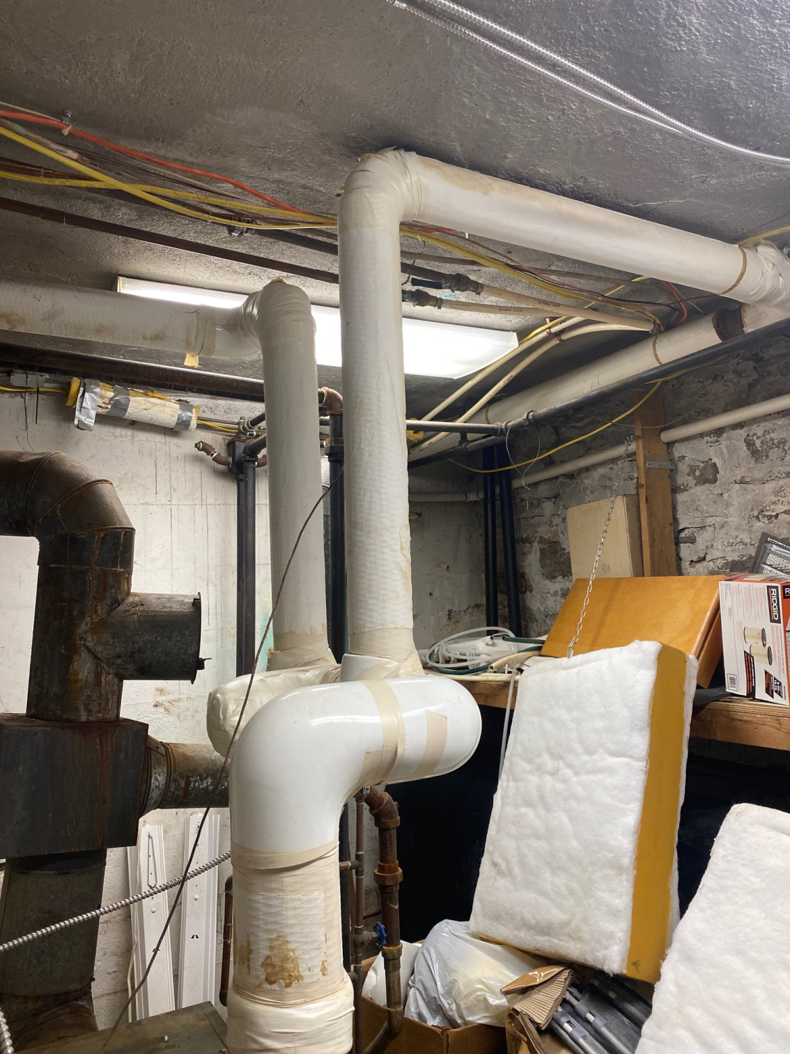

    But, as Steamhead says, check for soot. This boiler hasn't been cleaned in over 10 years and I'm guessing it's a mess down there. I'll have someone come out and clean it when heating season ends.
    I also saw that much of the insulation behind the metal boiler cover is missing. I'm probably getting plenty of heat loss from that as well.
