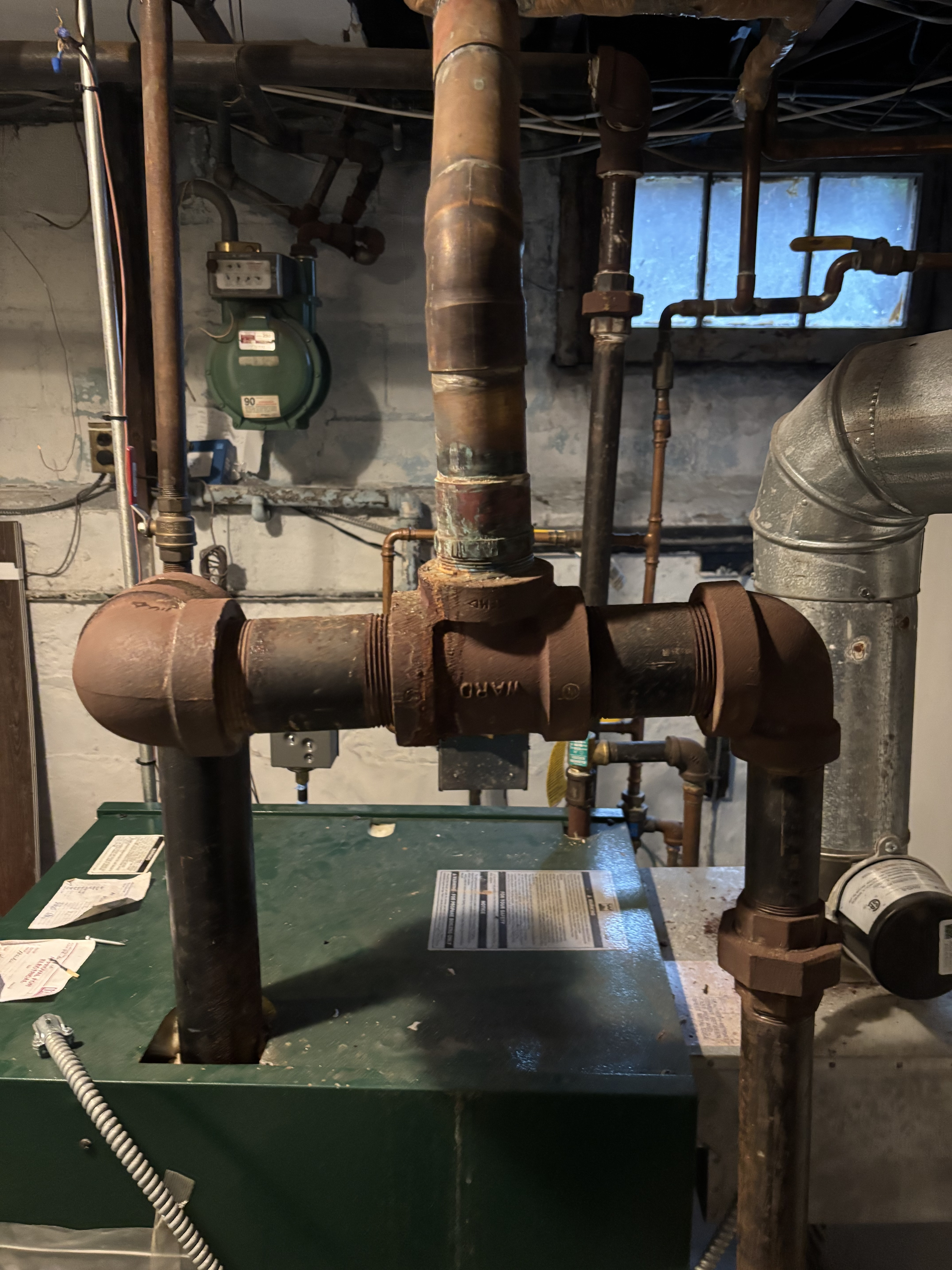

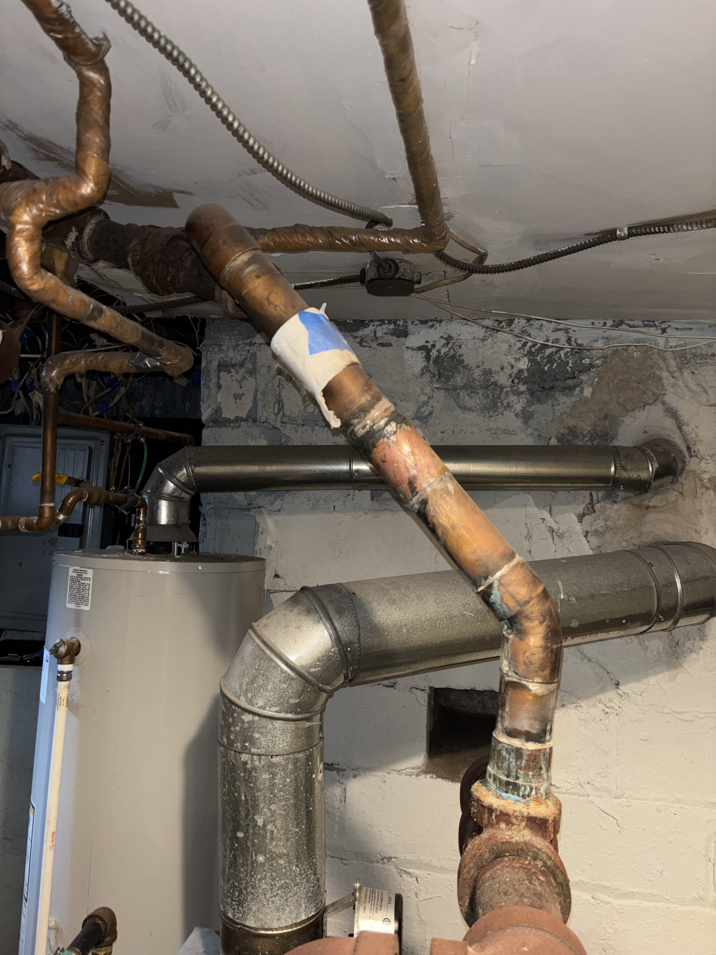

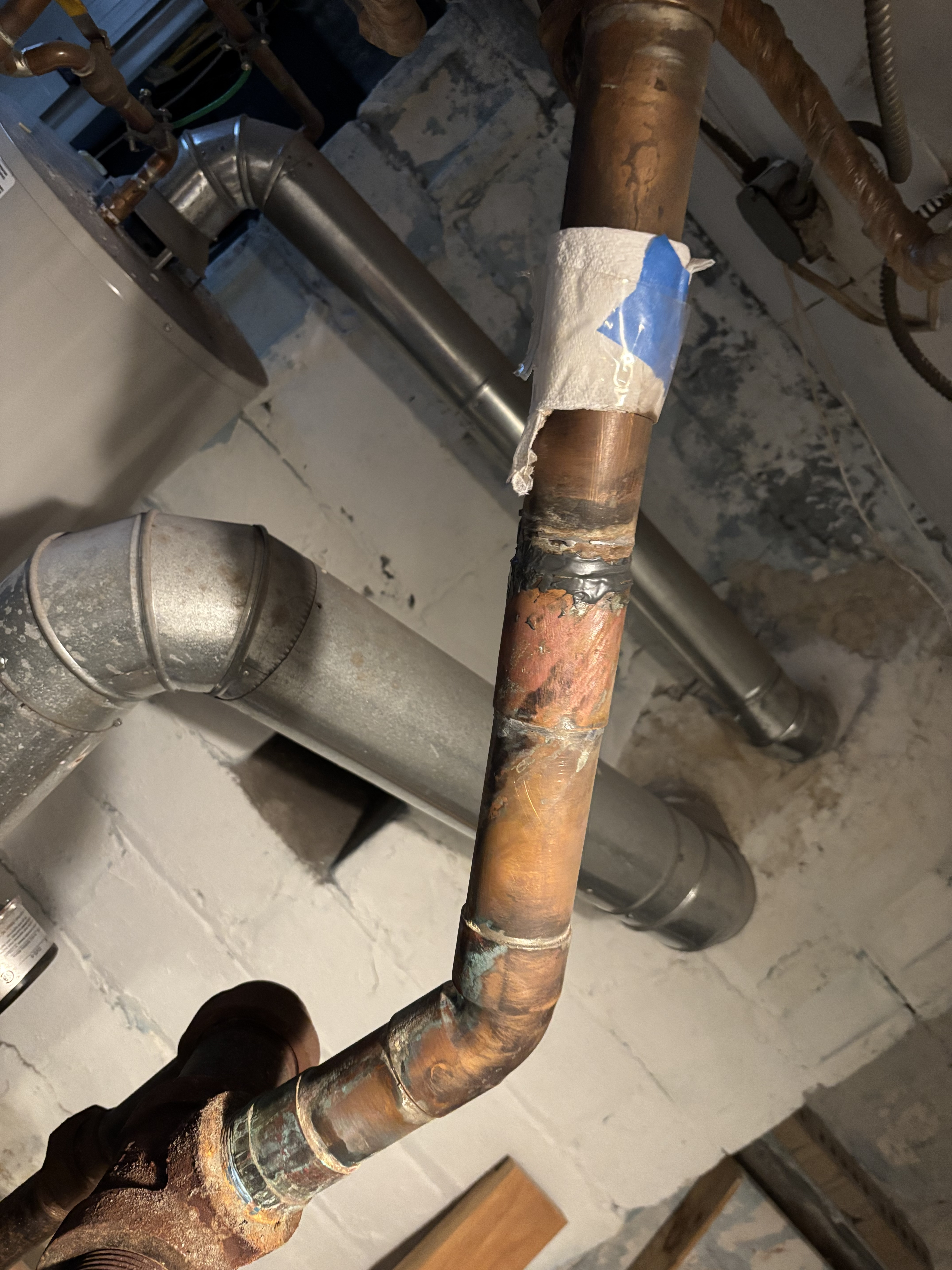

New issue related to a boiler in a house that my daughter bought last year. (Link to prior issue/post below).
Have now realized the system is losing what seems to be a lot of water. One week in February it took 3 or 4 gallons. All the valves and vents seem fine and no obvious leaks in the dry return or the near boiler piping. Boiler is only 1 year old, so I did not suspect that it was cracked but figured I would over fill with water just to check. Boiler was fine, but water started to leak from the (bad, bad, bad) copper piping above the header (see pic).

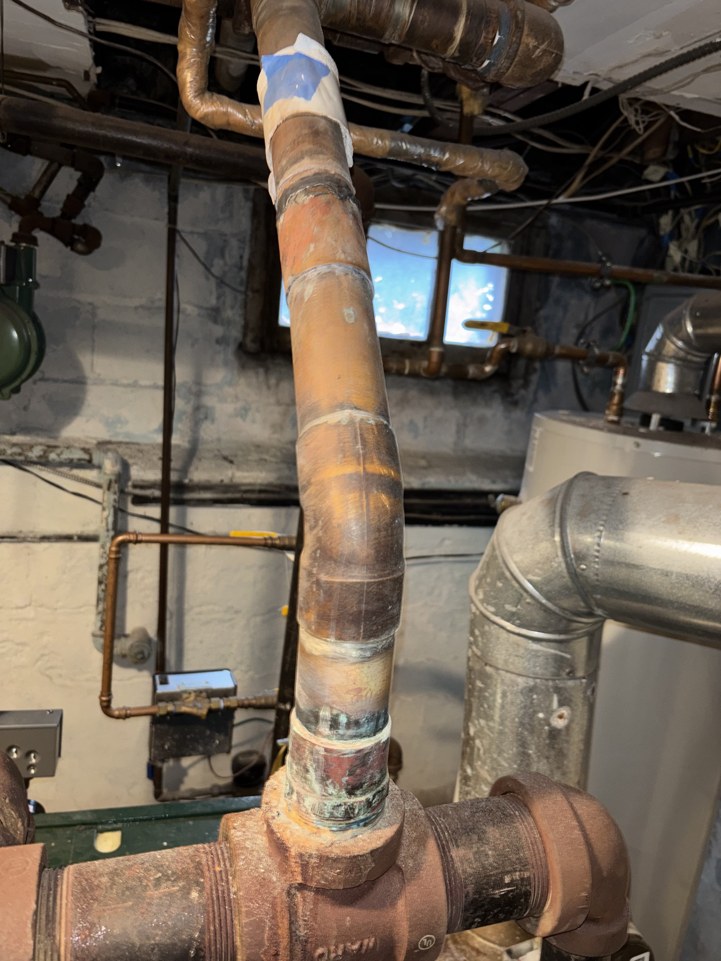

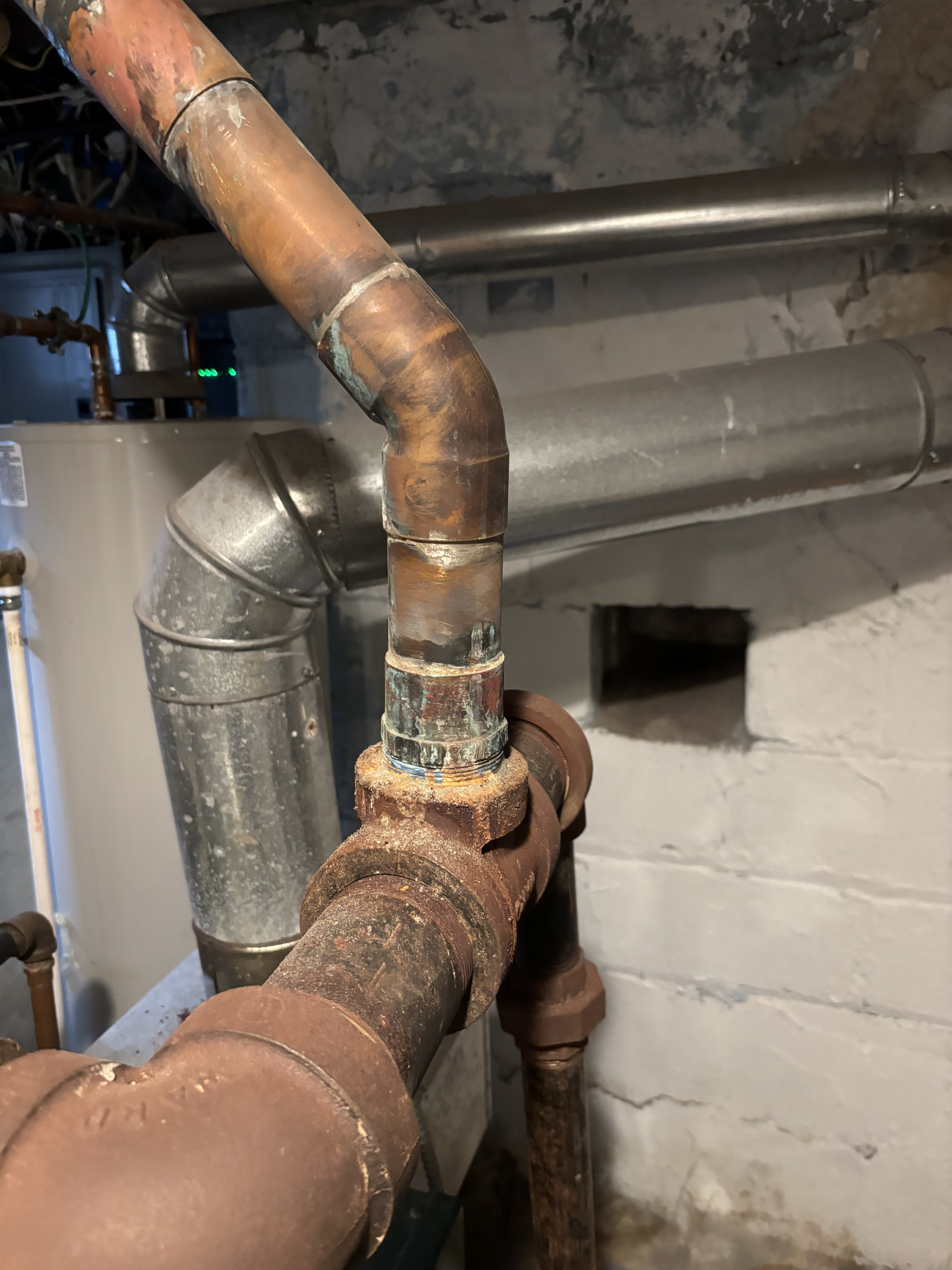

I would have expected to see steam leaking from there, but there is nothing obvious. After trying multiple things to detect the steam I ended up wrapping some clear, heavy plastic around the joint and could see water droplets forming underneath. So steam is escaping. I presume the hot pipe is causing it to evaporate as soon as it escapes.
The correct answer is to replace that copper with threaded pipe, but not sure that is in her budget at the moment. So two questions.....
1) Is there a way to plug up that leak in the meantime?
2) Is there a better way to detect leaks like this? Not sure is there are others

    Finally we have an example of why you don't use copper on steam lines! Thank you, thank you!
    If it cheers you up any, I'd bet that that one leak may account for almost all of your lost water…
    Which doesn't help you any.
    You might try cleaning the pipe thoroughly and using this stuff:
    Amazon.com: Self Fusing Silicone Tape 2 Rolls 1 in x 10' Black Waterproof Rescue Tape Rubber Leak Silicone Self-amalgamating Tape for Plumbing, Sealing Pipes, Hose Repair, Outdoor Coax and Tool Fixation : Industrial & Scientific
    I've found that sometimes it works… and sometimes it doesn't.

    It looks like that coupling has slopped right out of or off of the pipe. You could try lifting the piping up at see if you can expose more of the piping. Clean what's visible flux and pull back together and resolder. That would be my first approach as a temporary fix.
  • ChrisJ
    ChrisJ Member Posts: 17,519
    If that was in my house, I'd pull it apart, clean all of it very well and solder it back together. In my case, I may even try to braze it using 15%silphos, but not everyone has that option.
    It's a straight run with no turns and I'm betting it was soldered very poorly.
    That's based on what I see in that picture.
    I'm almost afraid to ask though, what does the rest of the piping and boiler look like? That could easily be a deal breaker.

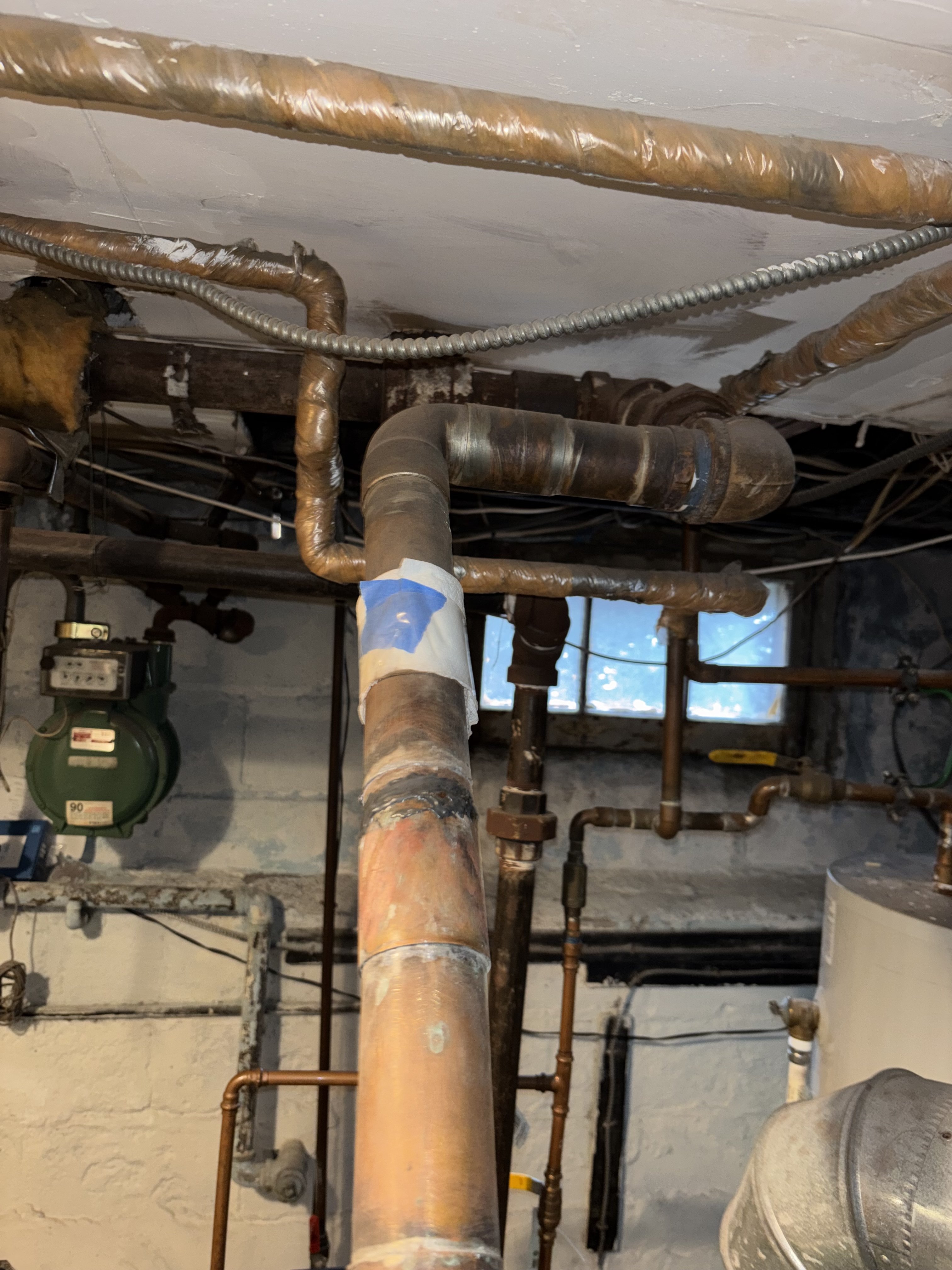

    What is the chance that you can post a picture from further back so we can see all the near boiler piping? perhaps from more than one side and from more than one level.

    Yeah that solder job was a horrific textbook example of a cold solder joint. I agree. Clean it with appropriate abrasive, flux it, and resolder it. Probably will need a lot of BTU in the torch and MAP gas would probably be a bare minimum.

    Use Iron pipe & fittings. Make sure there are swing joints. With so little to look at, it is hard to know what is going on there. …and Just because there were some copper steam pipes existing from the previous incorrectly installed boiler, does not mean that this three year old boiler can be connected without using the proper installation parts and procedures. (if your friend jumps off of a bridge…)

    I took a look at some photos from another discussion. It appears was installed with iron fitting and threaded pipe with very good design. The only copper pipe was on the return and some of that return looks like it is dry. What part of the return is leaking? The dry part, or the wet part below the water line? I still believe there may be some benefit from contacting the installer.

    There is a reason I don't like sweating copper, I'm no good at it! This is what all my solder joints would look like.
    The quick/cheaper fix is to have someone take apart those copper joints, clean and resolder. It will help for now….but the thermal expansion of the copper will eventually make the joint fail again. Might be a year…or 10. Long term fix is black iron pipe.
    And steam leaks are a bit tricky. We think of steam like a pot of boiling water sending tons of water vapor up into the air. In a closed boiler system the water vapor is designed so it drops out and what we have left is "dry steam". There is a lot less water content in it so we don't see steam billowing from leaks in pipes.
    A good way to find leaks is with a mirror. The hot (invisible) steam will hit the cool mirror and it will fog it up. Go around and check all the elbows, valves and vents. But I bet that failed solder joint is the big one.

    After seeing the rest of the installation. I happen to agree. That looks like a great job.

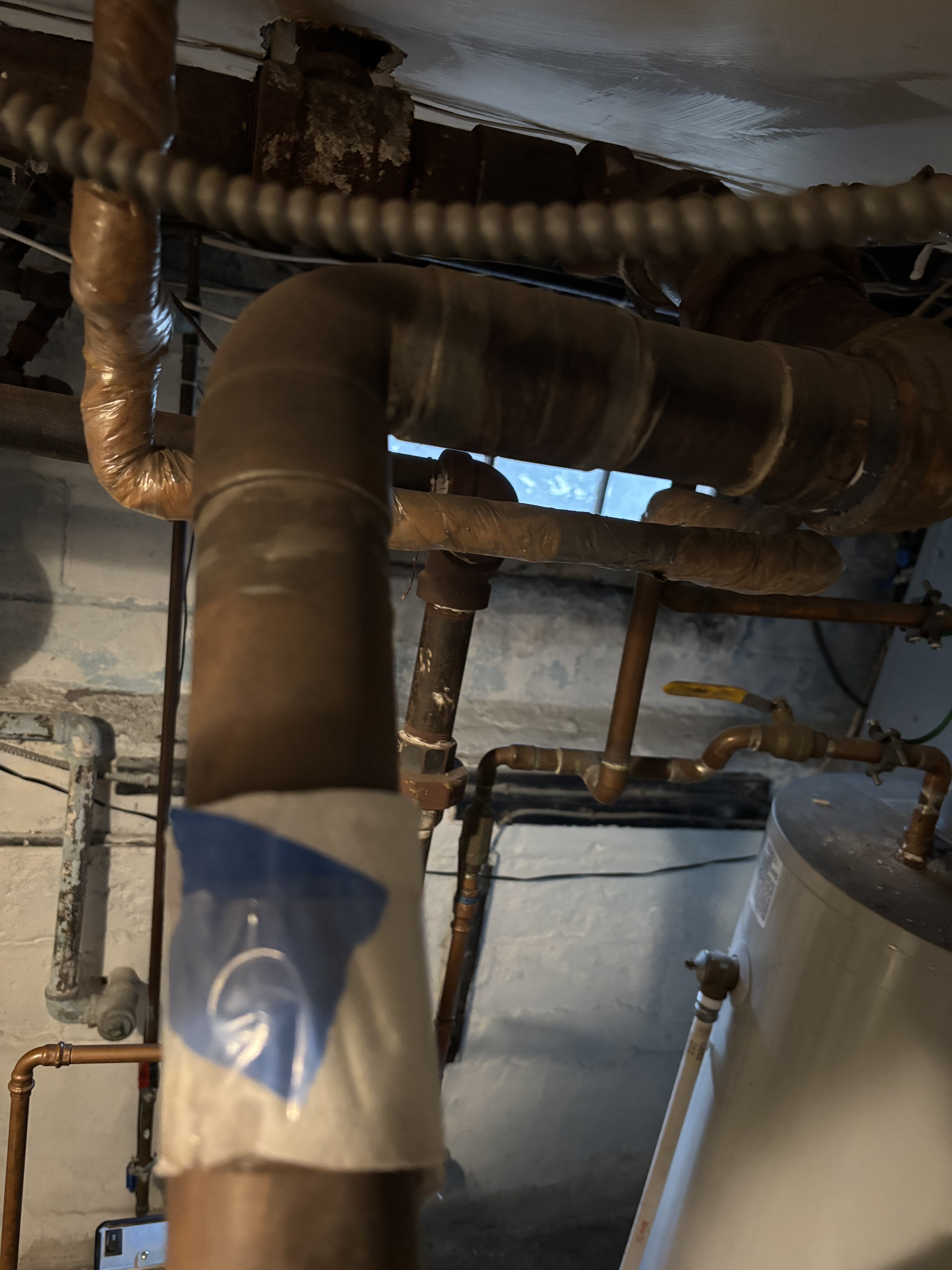

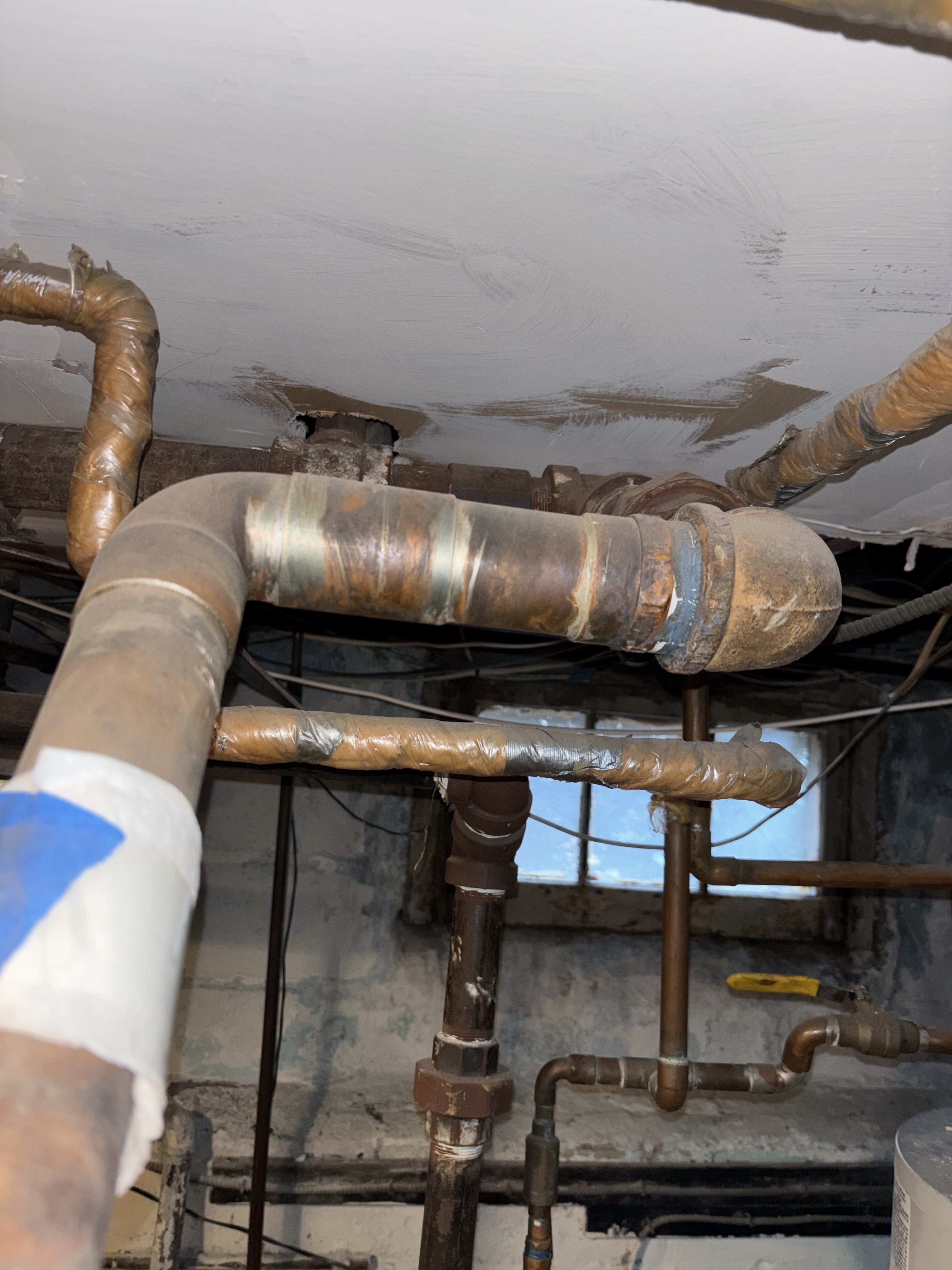

    I have attached a better photo. You should be able to make out that the header is iron, the transitions to copper and then back to iron. I can get more/better next time I am over there.
    I am comfortable with soldering 1/2 and 3/4 water lines, but this is probably beyond my paygrade. I did try cleaning it and applying JB Weld - not sure if that was a bad idea or not.
    I am also perplexed by trying to test for the leak. Overfilling the boiler is cumbersome and I tried the mirror approach with no luck.
    For what it's worth, permits recorded with the town show the prior boiler installed less than 10 years ago and the current one last year. So I suspect there had been a leak that caused permature failure.
