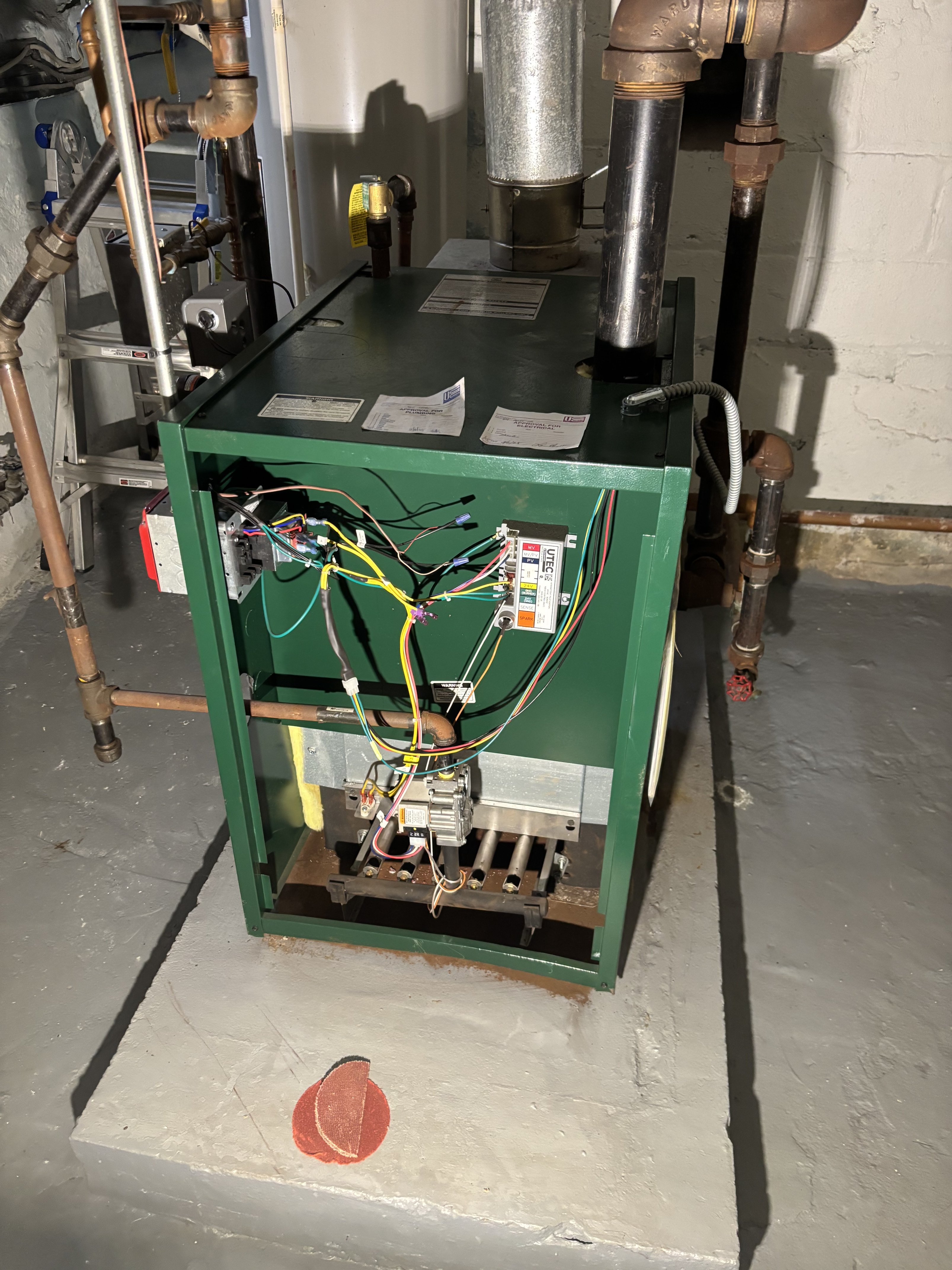

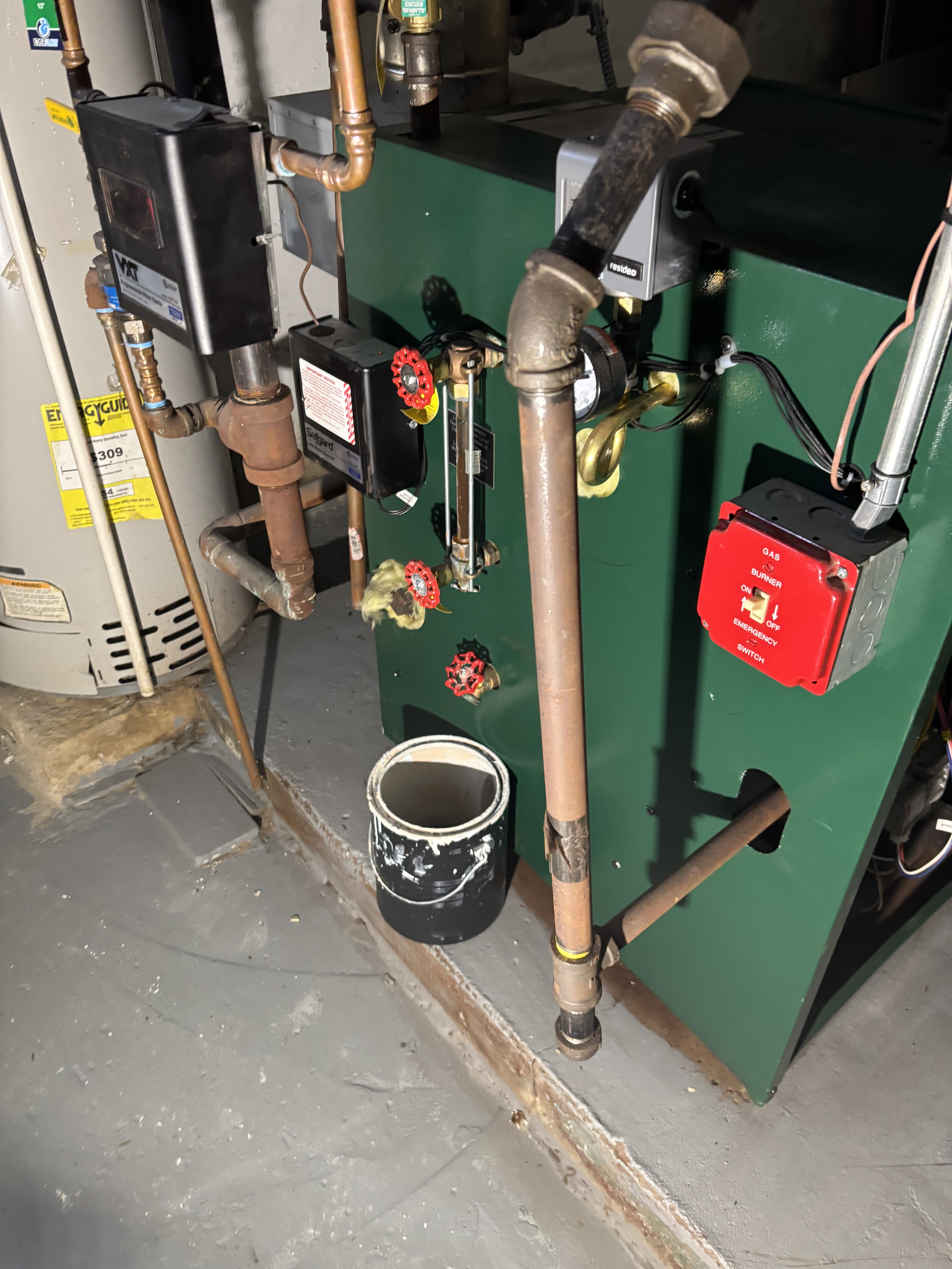

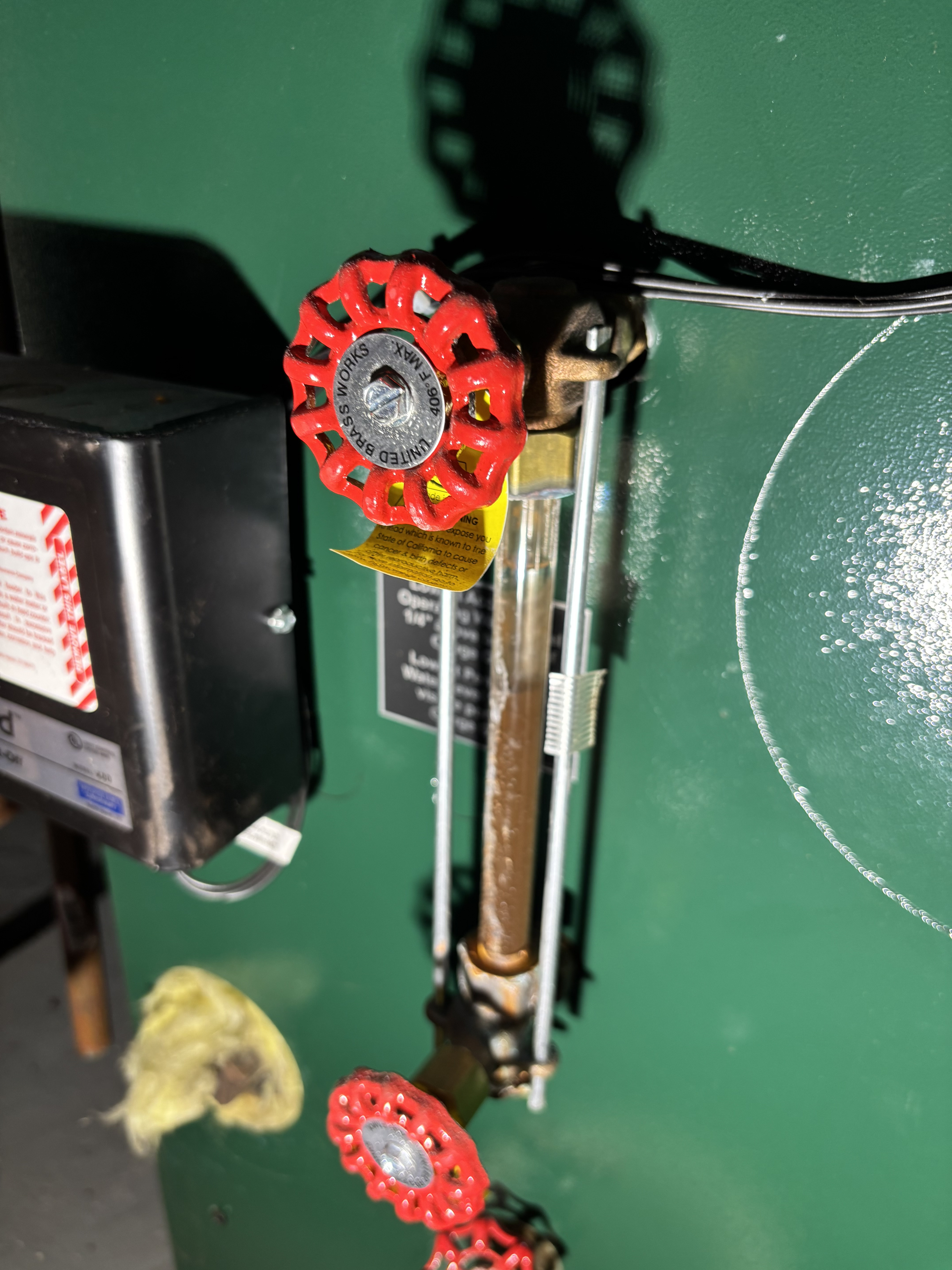

My daughter recently purchased circa 1925 home. New (per inspection sticker) Williamson GSA-125 installed by prior owner. Site glass very dirty so I am assuming post install cleaning was not done. Williamson install manual says nothing about cleaning.
This past winter I went thru skimming/cleaning Utica boiler in my own home, so I understand the basics.
Any advice would be appreciated.

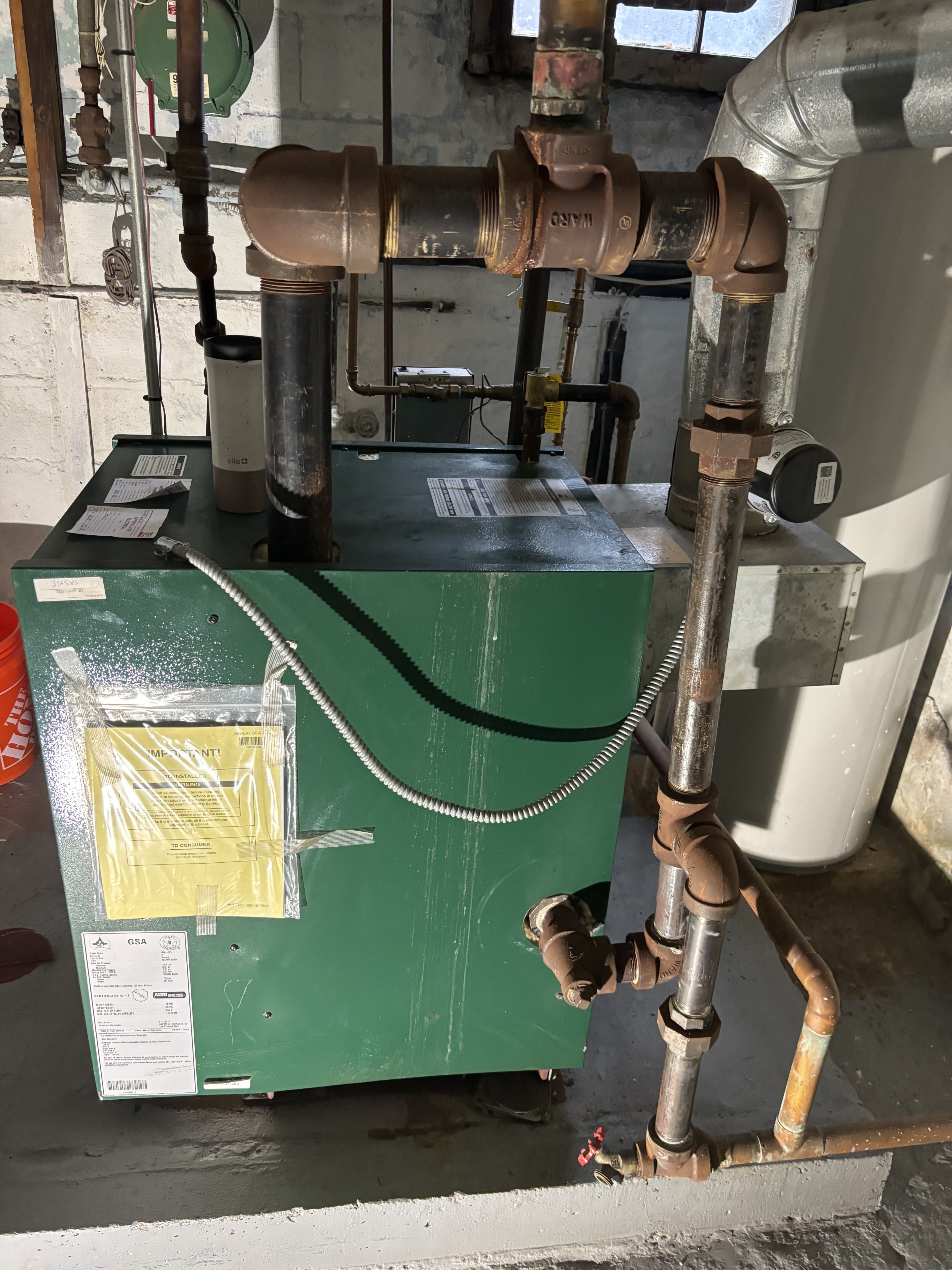

One note. Per attached photos I do not see a skim port.
The skim tapping is over here. You would need to remove the 1.5" plug. Might not be that easy to remove. Fairy eazy with an impact wrench and proper socket. You can try the following before skimming. Dump a bunch of 8-way boiler cleaner in boiler. Maybe 15-20 ounces. Run boiler unil it's starts to steam. Shut off, wait few minutes then turn boiler back on. Idea is to keep boiler hot but not steaming. Do this for an hour. Drain boiler. Refill and drain, refill and drain.... Until water is clean. This is not a replacement for skimming but it goes a long long way.
